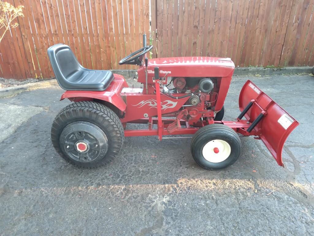

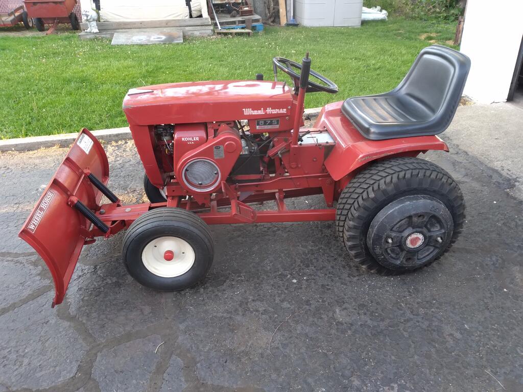

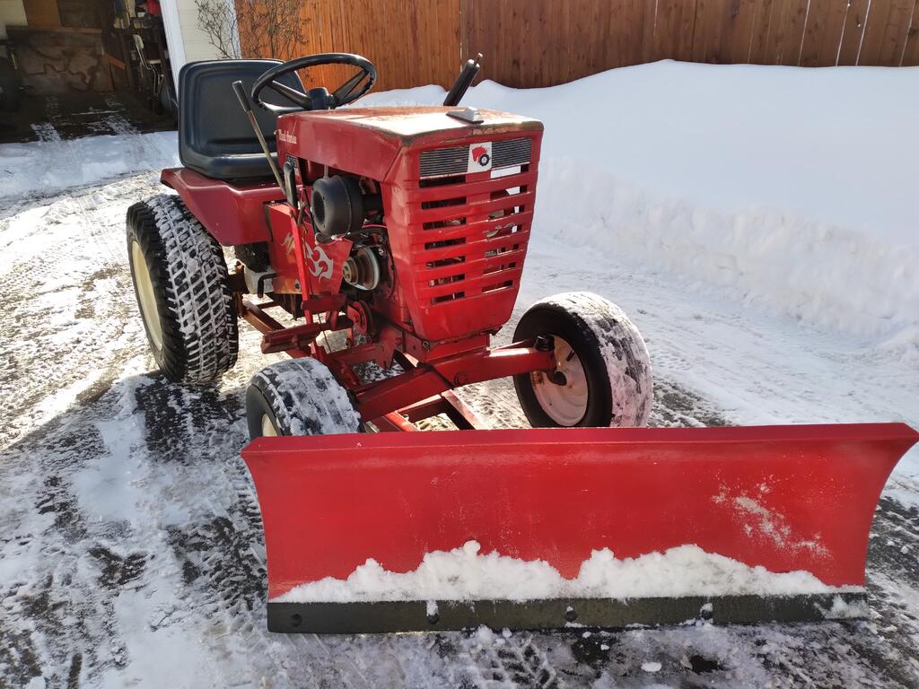

D_Mac 9,337 #15752 Posted May 15, 2022 Got a good summer price on these rear wheel weights today. 55 lbs each. They will help out when it comes time to push some snow again. Call this 875 " Fire & Ice " 4 6 Share this post Link to post Share on other sites
Ed Kennell 46,550 #15753 Posted May 15, 2022 3 minutes ago, D_Mac said: What's causing the plow angle to be restricted on this set up? Share this post Link to post Share on other sites
D_Mac 9,337 #15754 Posted May 15, 2022 (edited) 8 minutes ago, Ed Kennell said: What's causing the plow angle to be restricted on this set up? Nothing, plow works great. Swings easily to the left or the right. Looks like it hits the tire in the photo but it dosnt touch it when locked in either direction. Edited May 15, 2022 by D_Mac 2 2 1 Share this post Link to post Share on other sites

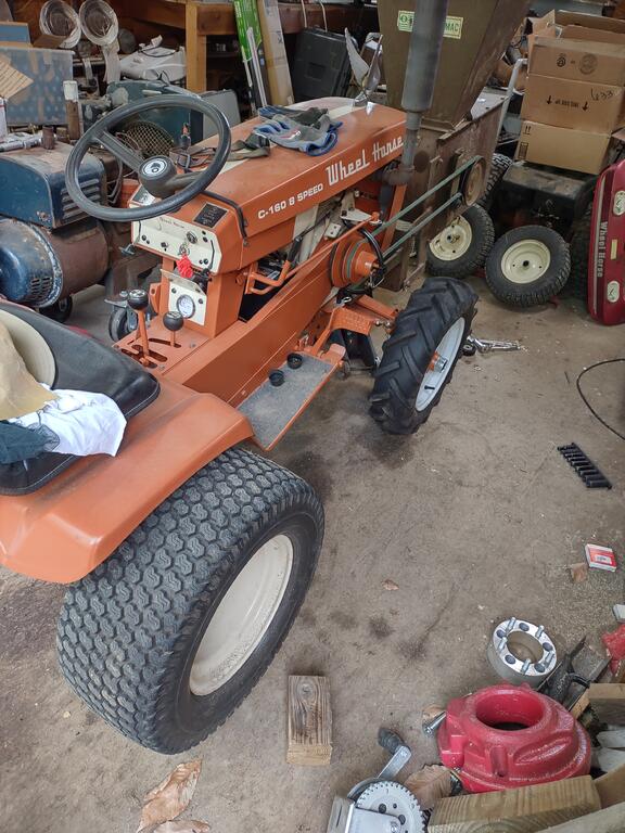

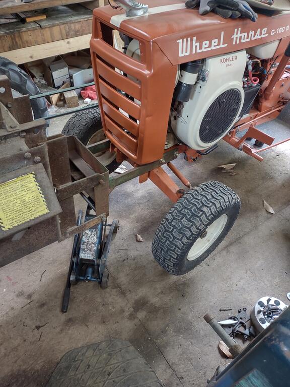

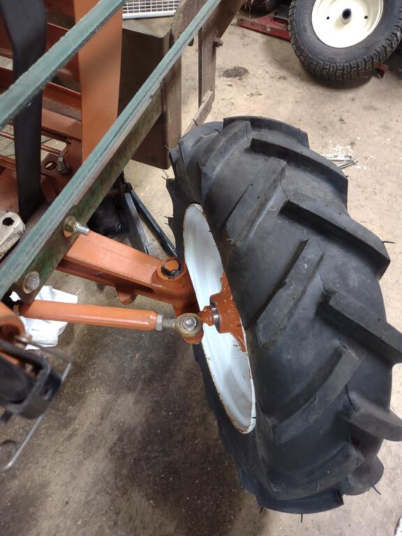

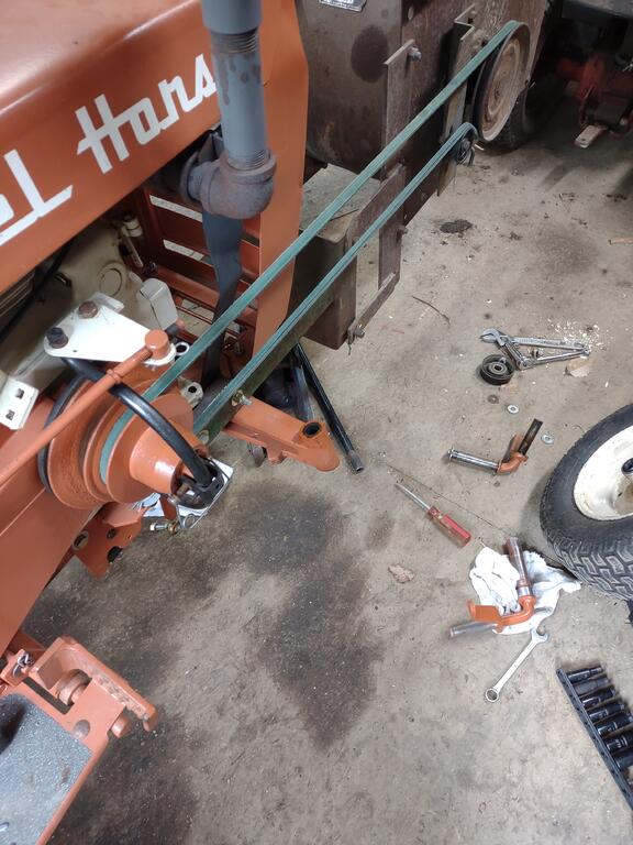

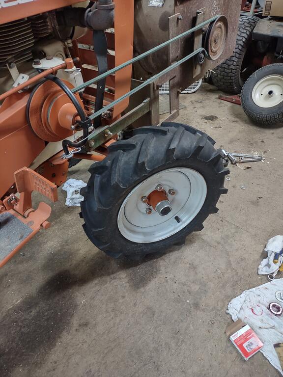

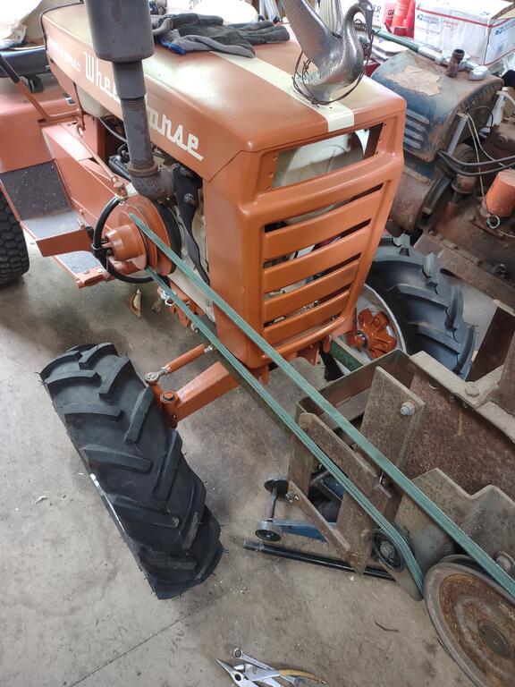

ebinmaine 79,633 #15758 Posted May 16, 2022 I got some shop time today while the BBT and her Mom did more work in the new garden site. They got the rest of the fenceposts in and started spreading out some Promix. They were using the tent room as a mobil bug net. I spent a decent portion of the day getting the swap of front spindles and 5 lug hubs done on the Cinnamon Horse C160. It now has 6-12 AG tires up front. I ordered tubes for it. Should be in next week. Also worked on, and worked with, the Mackissic chipper. I found that with the giant BEAST of a chipper out front the drive traction is pretty much non existent. I'll be putting the fluid filled 23 x 10.50 x 12 AGs. Also steel weights. That'll add 250+ lbs to the back end. 1 14 Share this post Link to post Share on other sites
Snoopy11 5,731 #15759 Posted May 16, 2022 3 minutes ago, ebinmaine said: I'll be putting the fluid filled 23 x 10.50 x 12 AG So... 'splain this to me like I am 3.... You are going to be putting ag's on the rear... correct?? Don 1 Share this post Link to post Share on other sites
ebinmaine 79,633 #15760 Posted May 16, 2022 3 minutes ago, Snoopy11 said: So... 'splain this to me like I am 3.... You are going to be putting ag's on the rear... correct?? Don Yepp 1 1 Share this post Link to post Share on other sites
Snoopy11 5,731 #15761 Posted May 16, 2022 Just now, ebinmaine said: Yepp I thought I had that right. Should getchya some good traction... Whatchya thinkin' for brand... BXT... or whot? Don Share this post Link to post Share on other sites
ebinmaine 79,633 #15762 Posted May 16, 2022 4 minutes ago, Snoopy11 said: I thought I had that right. Should getchya some good traction... Whatchya thinkin' for brand... Oh... I have the set already. Carlisle (Trupower??). Same ones I've been running for several years on several tractors. 3 Share this post Link to post Share on other sites
Oldskool 6,678 #15763 Posted May 16, 2022 10 hours ago, ebinmaine said: I spent a decent portion of the day getting the swap of front spindles and 5 lug hubs done on the Cinnamon Horse C160. What huds did you use for this? Share this post Link to post Share on other sites
squonk 47,362 #15764 Posted May 16, 2022 Turn those AG's around Eric for better steering stability. I have or have had AG' s with the direction printed right on the sidewalls and they say to reverse them for non driving wheels. 2 1 Share this post Link to post Share on other sites
ebinmaine 79,633 #15765 Posted May 16, 2022 14 minutes ago, Oldskool said: What huds did you use for this? They're just generic fleeeBay parts. I searched for 2000 lb trailer axle hubs and stubs and bought the least expensive ones I could find. 9 minutes ago, squonk said: Turn those AG's around Eric for better steering stability. I have or have had AG' s with the direction printed right on the sidewalls and they say to reverse them for non driving wheels. I was thinking about doing that and kind of forgot. 😀. I need to pop these wheels and tires off and put tubes in them so I'll do it then.... 2 Share this post Link to post Share on other sites

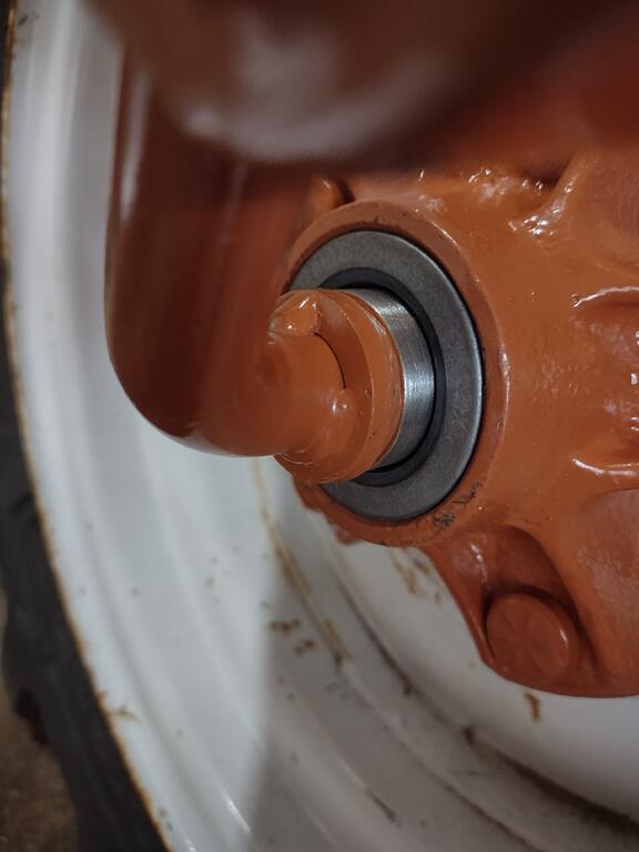

Lee1977 7,709 #15771 Posted May 16, 2022 Eric you really should reinforce those front hubs. 6 2 1 Share this post Link to post Share on other sites
ebinmaine 79,633 #15772 Posted May 16, 2022 56 minutes ago, Lee1977 said: reinforce You're absolutely right Lee. I saved a link to this post so I can come back and reference it. Thank you. 3 Share this post Link to post Share on other sites
Monstrosity 1,147 #15773 Posted May 16, 2022 17 hours ago, ebinmaine said: I got some shop time today while the BBT and her Mom did more work in the new garden site. They got the rest of the fenceposts in and started spreading out some Promix. They were using the tent room as a mobil bug net. I spent a decent portion of the day getting the swap of front spindles and 5 lug hubs done on the Cinnamon Horse C160. It now has 6-12 AG tires up front. I ordered tubes for it. Should be in next week. Also worked on, and worked with, the Mackissic chipper. I found that with the giant BEAST of a chipper out front the drive traction is pretty much non existent. I'll be putting the fluid filled 23 x 10.50 x 12 AGs. Also steel weights. That'll add 250+ lbs to the back end. Is there a hub kit? Or you made these work? Interested in doing this myself. 2 Share this post Link to post Share on other sites
ebinmaine 79,633 #15774 Posted May 16, 2022 18 minutes ago, Monstrosity said: Is there a hub kit? Or you made these work? Interested in doing this myself. Little bit of both. What I got was a hub and stub kit off of the interwebs. It's for a 2000 lb trailer axle so it has 1" ID bearings inside and outside. The seal surface that you can see from the outside is 1.25" OD The particular setup I ordered came with round shaft type stub axles, hubs, four bearings and two seals, 10 lug nuts, castle nuts and cotter pins, outer dust cover. I ordered this a while back so I don't know what current availability is. Make sure you get a complete kit with ALL above parts. What you do to prep the stub axles is cut off most of the part that would normally be welded to the trailer and then drill a ¾ hole down through the middle of the 1-in shaft about to where the threads begin. Maybe 3-in deep. One of the generous Red square members did that for me. To fasten the trailer stub shaft to the tractor spindle you can either weld the end or use JB Weld. Scroll back a few posts and you'll see where @Lee1977 recommends doing a reinforcement bracket. I agree with that recommendation. 1 Share this post Link to post Share on other sites
