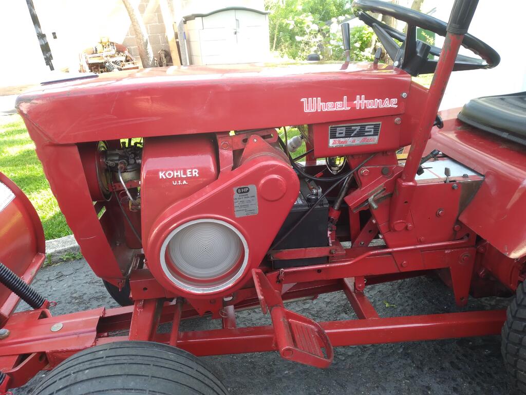

D_Mac 9,339 #15701 Posted May 13, 2022 Fired up the 875 today. Hasn't been started or driven since the last time I used it this winter to plow some snow. Remember this tractor was purchased as a parts machine. It had a blown engine and @squonkpicked up a replacement engine for me at last years Big Show. Thanks to who ever sold it to Mike and thank you Mike for selling it to me. It runs great and it saved this tractor from being disassembled. I also tried to take Jeffrey for a ride in the back of the 1075 and trailer. He kept jumping out to bite the tires. His loss. 2 3 8 Share this post Link to post Share on other sites

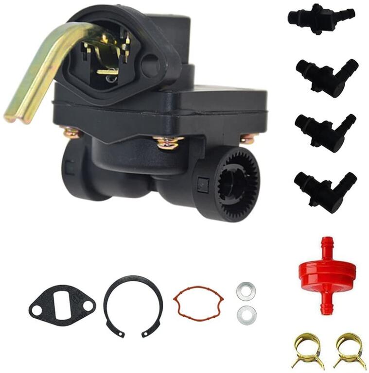

Mike C160 251 #15709 Posted May 14, 2022 On 1/15/2018 at 4:40 PM, squonk said: Went to Napa and grabbed one. This one pumps. Got the 160 running and finished up the driveway clean up but it's not right. I think there's some carbunkles in the carb. It sat pretty much since the show 2 years ago. Carb's been apart a few times already and it looks like it's going under the knife again. I need 1/4 choke to run it at full throttle. Then no choke at half. I use non ethanol in it but storing it with fuel in the bowl may have been an issue. I hate working with gas in the winter! What kinda pump did you install? I put one of those black mechanical ones on my C160 I got off ebay. It lasted less than 2 hours before it filled the crank case with gas... I know i can get a rebuild kit for the old mechanical one, but reviews on it arent great either... Cheers Share this post Link to post Share on other sites
ebinmaine 80,191 #15710 Posted May 14, 2022 3 minutes ago, Mike C160 said: What kinda pump did you install? I put one of those black mechanical ones on my C160 I got off ebay. It lasted less than 2 hours before it filled the crank case with gas... I know i can get a rebuild kit for the old mechanical one, but reviews on it arent great either... Cheers @Monstrosity just rebuilt a metal fuel pump too. Share this post Link to post Share on other sites
Monstrosity 1,153 #15711 Posted May 14, 2022 (edited) 5 minutes ago, ebinmaine said: @Monstrosity just rebuilt a metal fuel pump too. @Mike C160 Yup just got a kit from Amazon. Granted the rubber material was too large and the holes didn't line up. So I used a flush cutter and elongated the holes inward. 👌 no leaks Edited May 14, 2022 by Monstrosity 2 Share this post Link to post Share on other sites
ebinmaine 80,191 #15712 Posted May 14, 2022 1 minute ago, Monstrosity said: @Mike C160 Yup just got a kit from Amazon. Granted the rubber material was too large and the holes didn't line up. So I used a flush cutter and elongated the holes inward. 👌 no leaks @Handy Don recently learned that the holes are lined up ONLY when the arm is pulled down to activate the pump. This puts the rubber in position to create maximum fuel movement. 2 1 Share this post Link to post Share on other sites
Mike C160 251 #15713 Posted May 14, 2022 4 minutes ago, Monstrosity said: @Mike C160 Yup just got a kit from Amazon. Granted the rubber material was too large and the holes didn't line up. So I used a flush cutter and elongated the holes inward. 👌 no leaks Let us know if its lasts. I have the same kit. But I see some bad reviews about the rubber not lasting... Cheers Share this post Link to post Share on other sites
Mike C160 251 #15714 Posted May 14, 2022 1 minute ago, ebinmaine said: @Handy Don recently learned that the holes are lined up ONLY when the arm is pulled down to activate the pump. This puts the rubber in position to create maximum fuel movement. Thats a great tip. Thanks for sharing. Thats some make or break information. Cheers 1 Share this post Link to post Share on other sites
ebinmaine 80,191 #15715 Posted May 14, 2022 Just now, Mike C160 said: Thats a great tip. Thanks for sharing. Thats some make or break information. Cheers Might also cause some of the bad reviews. There's a company in Massachusetts called Then and Now Automotive ((??)) That sells a rebuild kit with a good reputation. 1 1 Share this post Link to post Share on other sites
Mike C160 251 #15716 Posted May 14, 2022 (edited) 3 minutes ago, ebinmaine said: Might also cause some of the bad reviews. There's a company in Massachusetts called Then and Now Automotive ((??)) That sells a rebuild kit with a good reputation. Kohler Fuel Pump Kits | Product categories | Then and Now Automotive (then-now-auto.com) found em. Now to figure out witch pump i have. Edited May 14, 2022 by Mike C160 1 Share this post Link to post Share on other sites
Monstrosity 1,153 #15717 Posted May 14, 2022 6 minutes ago, ebinmaine said: @Handy Don recently learned that the holes are lined up ONLY when the arm is pulled down to activate the pump. This puts the rubber in position to create maximum fuel movement. I tried that but the gasket wouldn't seal properly on this kit from what I tried maybe he had better luck 1 Share this post Link to post Share on other sites
squonk 47,837 #15718 Posted May 14, 2022 (edited) 6 hours ago, Mike C160 said: What kinda pump did you install? I put one of those black mechanical ones on my C160 I got off ebay. It lasted less than 2 hours before it filled the crank case with gas... I know i can get a rebuild kit for the old mechanical one, but reviews on it arent great either... Cheers You either got a too high PSI pump or have a worn needle in the carb. I use Napa 610-1051 Facet posi flo. Edited May 14, 2022 by squonk 1 Share this post Link to post Share on other sites

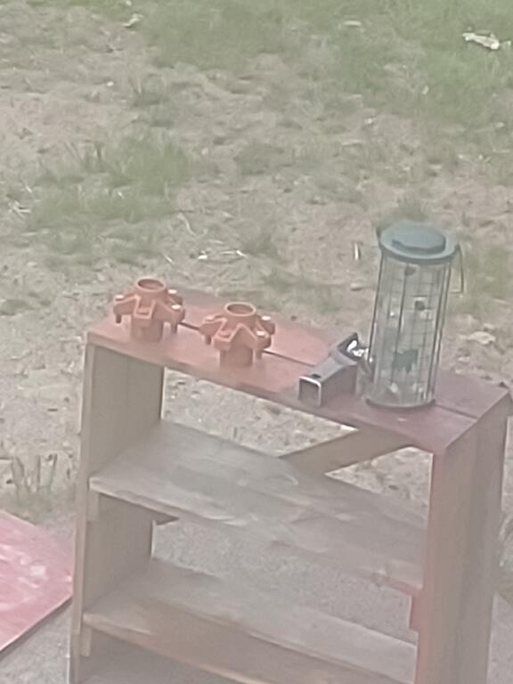

ebinmaine 80,191 #15719 Posted May 14, 2022 The Paint Department BBT got the spindles (with trailer stubs) and 5 lug hubs painted up to match the Cinnamon Horse C160-8. Should have time to get that situated this weekend. 6 Share this post Link to post Share on other sites

Mike C160 251 #15721 Posted May 14, 2022 6 hours ago, squonk said: You either got a too high PSI pump or have a worn needle in the carb. I use Napa 610-1051 Facet posi flo. Sadly no. I Installed this black plastic lump and the diaphragm failed and it poured fuel thru the mechanical lever into the crank case. There was no Carb flooding. Just a junk pump. Share this post Link to post Share on other sites
Handy Don 17,261 #15722 Posted May 14, 2022 (edited) 12 hours ago, Monstrosity said: I tried that but the gasket wouldn't seal properly on this kit from what I tried maybe he had better luck The mating faces of my pump's body had high spots. I had to carefully flatten them to be sure they would seal. The diaphragm rubber is not very thick . If your diaphragm was flat when you clamped the body together, then the rubber now must be stretched for every pumping cycle (the pump is driven by the camshaft so one pump per two revs of the engine). This puts extra strain on the pump mechanism arm and hinge pin to work against the rubber and the return spring and it fatigues the rubber to failure fairly quickly. With the diaphragm "scrunched" inward, by aligning its pre-punched holes with the mounting screws, the rubber is always relaxed and only flexed for each cycle. The slight wrinkles in the edges of the diaphragm between the screws caused by the scrunching get smoothed out as the body gets clamped together. Tighten the screws a little at a time in rotation to bring the body halves together evenly. Edit: if you have a vacuum only pump, not a mechanical, then without scrunching the diaphragm it simply won't work Edited May 14, 2022 by Handy Don 5 Share this post Link to post Share on other sites
