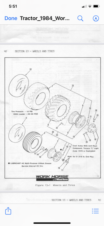

Horse Newbie 7,405 #15282 Posted April 13, 2022 5 hours ago, JoeM said: NO NO NO Never! You want it to stay together, not come apart! An integral part of the attachment system is the hub surface grip area on the shaft. The set screws apply the tension not the retenson. That is why it is critical for the hub bore and shaft to be on size. The shaft and hub will hold the best dry. Well maybe I should not have coated the axles with anti-seize , but Wheel Horse told me to… 4 1 Share this post Link to post Share on other sites

lynnmor 9,042 #15287 Posted April 13, 2022 @Ed Kennell, now that you have a good mark on the axle where the set screw hits, grind or file a flat on it to prevent the upset metal from being a problem next time. I use a rust inhibitor on the axles, usually my go to is Rustlick 631. I'm not that opposed to Never Seez products but I have seen them turn into an unrecognizable dry sludge over time. The reason for the second set screw is that the axle to hub is a slip fit, meaning that the hole is slightly larger than the shaft. With one set screw the points of contact will be the set screw and the opposite side of the hub. With a second set screw those screws and the side opposite the mid point of the screws. Think of a three legged stool versus on with only two legs and you will begin to understand the benefit of the three point contact. The oil drain plug in the transmission often stands proud of the housing. I grind down the plug a small amount and tap the hole deeper to get it at least flush. Some implements do hit the plug,even if flush, so it is a good idea to cut some clearance in the implement. 3 3 Share this post Link to post Share on other sites

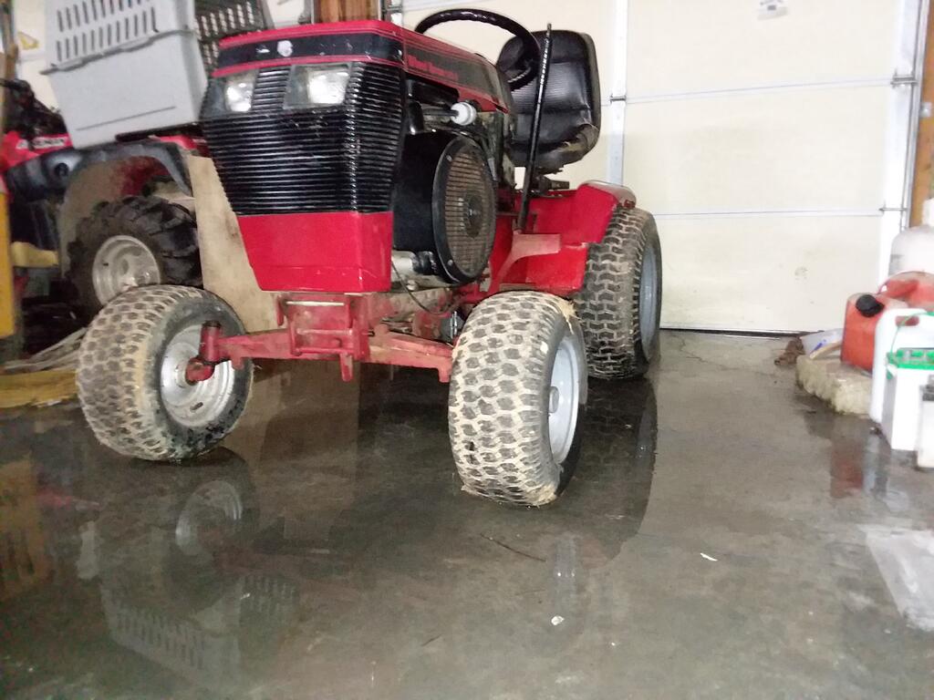

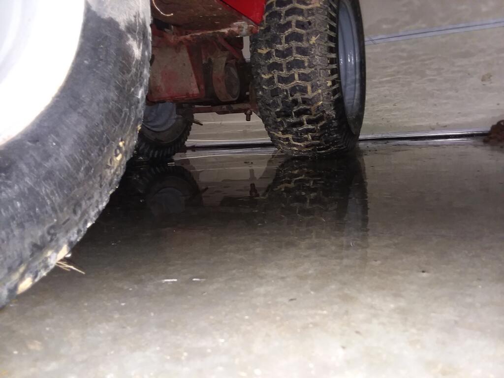

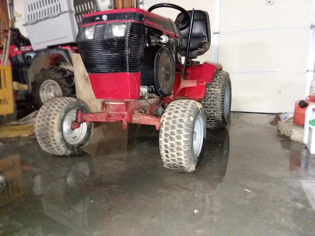

TJ5208 1,841 #15300 Posted April 14, 2022 The storms we had last night did this the wind blew against the doors and the doors leaked water on the bottom. 1 Share this post Link to post Share on other sites
