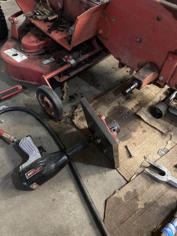

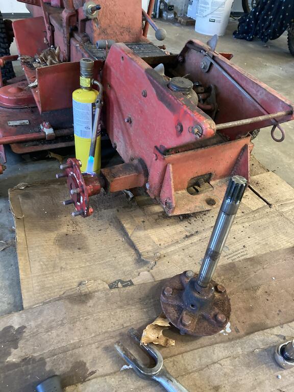

TonyToro 1,190 #14886 Posted March 12, 2022 With @TonyToro Jr. …Well after a few days of soaking and about 10 minutes per side with heat, I got the hubs off. One side came out with the axle attached 😂. so tomorrow that one will have to get pressed out. These hubs are off the donor Commando V8. Now I’m undecided if I want to part it out or turn it into a yard racer? 2 1 1 Share this post Link to post Share on other sites
Maxwell-8 4,371 #14887 Posted March 12, 2022 9 hours ago, TonyToro said: With @TonyToro Jr. …Well after a few days of soaking and about 10 minutes per side with heat, I got the hubs off. One side came out with the axle attached 😂. so tomorrow that one will have to get pressed out. From experience, that is a lot easier Check the condition of the C-clip or even better replace it. You will have to open up the diff and make sure you got the old one out. 3 Share this post Link to post Share on other sites
lynnmor 9,042 #14888 Posted March 12, 2022 12 hours ago, TonyToro said: With @TonyToro Jr. …Well after a few days of soaking and about 10 minutes per side with heat, I got the hubs off. One side came out with the axle attached 😂. so tomorrow that one will have to get pressed out. These hubs are off the donor Commando V8. Now I’m undecided if I want to part it out or turn it into a yard racer? So you forced the axle out of the transmission using a pickle fork? The c-clip must still be in there and the axle may be damaged. Open the rear and fix the damage. 3 Share this post Link to post Share on other sites
pfrederi 21,204 #14889 Posted March 12, 2022 12 hours ago, TonyToro said: With @TonyToro Jr. …Well after a few days of soaking and about 10 minutes per side with heat, I got the hubs off. One side came out with the axle attached 😂. so tomorrow that one will have to get pressed out. These hubs are off the donor Commando V8. Now I’m undecided if I want to part it out or turn it into a yard racer? I do not see the groove for the Snap ring. Some older units used a roll pin instead but I do not see a hole for that either. In any event you have to open it up... 3 Share this post Link to post Share on other sites
TonyToro 1,190 #14890 Posted March 12, 2022 3 hours ago, Maxwell-8 said: From experience, that is a lot easier Check the condition of the C-clip or even better replace it. You will have to open up the diff and make sure you got the old one out. It’s fine that it came out as it did. I don’t need the transmission. We are just taking parts from it for the gokart build. But this could be the reason the transmission was locked up. 😂👍 1 Share this post Link to post Share on other sites
TonyToro 1,190 #14891 Posted March 12, 2022 7 minutes ago, lynnmor said: So you forced the axle out of the transmission using a pickle fork? The c-clip must still be in there and the axle may be damaged. Open the rear and fix the damage. 😂 yup. That side was three wacks and out it came! The other side didn’t come out so easy. I had to use the puller on it. Heat and lube helped it off. I don’t need the transmission so it was ok that it came out as I’d did. They were super stubborn. My buddy wanted me to cut the axles and bring them to his shop so he could use is huge press and pop them out! 1 Share this post Link to post Share on other sites
TonyToro 1,190 #14892 Posted March 12, 2022 9 minutes ago, pfrederi said: I do not see the groove for the Snap ring. Some older units used a roll pin instead but I do not see a hole for that either. In any event you have to open it up... I don’t see either. But I’m not using the transmission. I’m just happy they are off! 1 Share this post Link to post Share on other sites

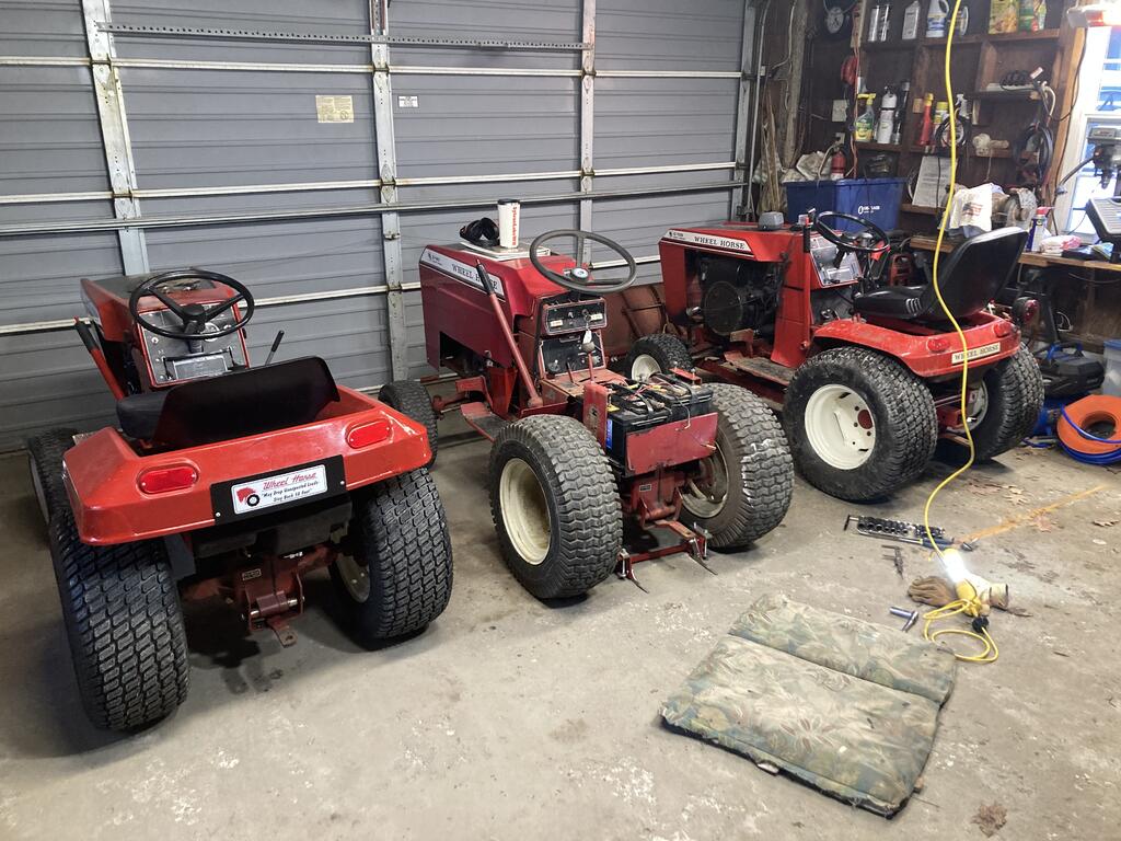

danweikert21 166 #14893 Posted March 12, 2022 Today i went to A to Z tractors and was very happy to get my shifting issue fixed I’ve posted on the forum before asking how to fix it and so while I was there today Lincoln took a look and fixed me right up. I guess my engine puly was off center and that was causing problems. I also got new foot rests that I’ve wanted for a long time. I also helped 857lover who is my buddy get his new trans swap finished. 5 2 Share this post Link to post Share on other sites
SylvanLakeWH 32,654 #14894 Posted March 12, 2022 Took the plow blade off the C 6.5 predator swap (I’m an optimist)… and arranged the garage for the wheel horses as it should be - sans Mrs. Sylvan’s car - for the High Holy Tractor Season… 1 5 Share this post Link to post Share on other sites
