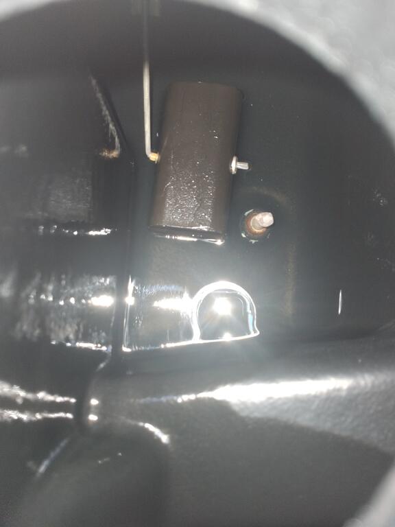

TJ5208 1,841 #14643 Posted February 20, 2022 Is the strainer supposed to be bent like that? 1 Share this post Link to post Share on other sites
TJ5208 1,841 #14645 Posted February 20, 2022 (edited) 2 minutes ago, squonk said: Well I tried to blow some air into the tank so I can get some fuel to the fuel pump and it bent down like that I just didn't know if it was post to or what. Edited February 20, 2022 by TJ Salyers 1 Share this post Link to post Share on other sites
squonk 47,840 #14646 Posted February 20, 2022 Ok now I know what you're working on. I see them bent all the time. I tear them out and use a good filter in the line. 3 Share this post Link to post Share on other sites
TJ5208 1,841 #14647 Posted February 20, 2022 Just now, squonk said: Ok now I know what you're working on. I see them bent all the time. I tear them out and use a good filter in the line. If you blow air back into the lines it fixes it. Just didn't know if it would cause fuel problems because it looks pretty clean. 1 Share this post Link to post Share on other sites
Horse Newbie 7,405 #14648 Posted February 20, 2022 @TJ Salyers… did you clean that fuel tank ? Share this post Link to post Share on other sites
Achto 32,305 #14649 Posted February 20, 2022 2 hours ago, TJ Salyers said: If you blow air back into the lines it fixes it. Just didn't know if it would cause fuel problems because it looks pretty clean. If you are able to make that screen change shape with air pressure, I'm going to take a guess & say that it is plugged. Air or fluid should pass through that screen as easily as air through a window screen. Pull the valve out & either clean the screen with some brake cleaner or rip it off & let the in line filter do its job. 5 1 Share this post Link to post Share on other sites
TJ5208 1,841 #14650 Posted February 21, 2022 @Achto Since I got it running right it just doesn't seem like it's getting any fuel to the fuel filter because it's almost completely dry when it's running would you just keep the screen or would you just rip it out. 1 Share this post Link to post Share on other sites
