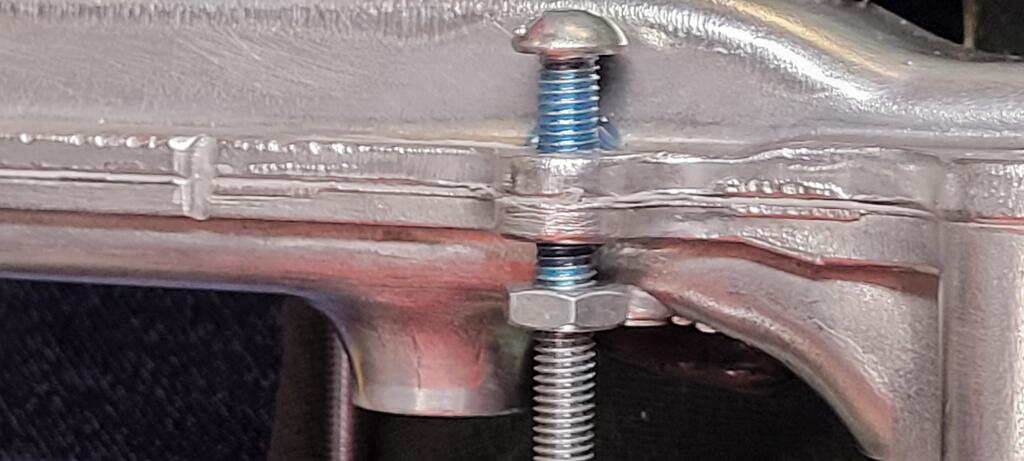

AMC RULES 37,260 #13976 Posted December 18, 2021 On 12/15/2021 at 4:14 AM, lynnmor said: There is no way that I would release the clamping without the two halves bolted together. If the halves spring open even a little, the sealant will no longer work. I drill thru both halves and use stainless steel screws, washers and locknuts. Tapping the aluminum may be OK, but that cast metal isn't as strong as bolting thru. So everyone knows, those "rivets" are simply protrusions from the one half, not a separate fastener. Drilled out the rivets, tapped the holes, blue Loc-tite on them threads, and then backed up with a nut. 3 Share this post Link to post Share on other sites

lynnmor 9,047 #13979 Posted December 18, 2021 24 minutes ago, AMC RULES said: Wasn't before all the overkill either. The thing is that the manifold is bolted down at the far ends and any stresses from that might tend to warp the castings a small amount. The carburetor bolts will squeeze the halves together but any movement in the mating surfaces will tend to break the seal. Yes, that sealing compound that was used will compensate for a tiny amount of that movement, but I would rather prevent it from the beginning. For those that never split the manifold, know that they are not precision machined anywhere. Anyway, your work is a vast improvement over stock. 2 Share this post Link to post Share on other sites
AMC RULES 37,260 #13980 Posted December 18, 2021 (edited) I have read here so many times about the gasket failing on these Onan intake manifolds leaking but I can tell you, it was no easy task to seperate the two halfs of this one. Highly doubt it ever had any sealing issue, and I believe it was only needing it's carb cleaned. It's crazy too, by just the addition of this little bit of attaching hardware, the thing seems to weigh twice as much. Edited December 18, 2021 by AMC RULES 1 Share this post Link to post Share on other sites

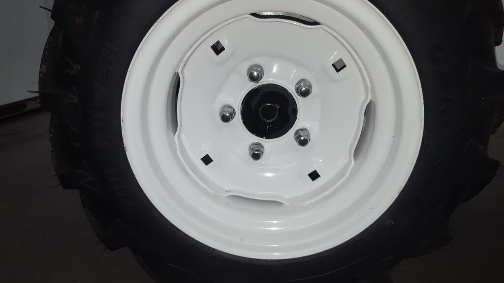

Gregor 4,848 #13984 Posted December 18, 2021 I swapped out the lug bolts on the 656 for lug nuts. I think I may have all the tractors done now. 7 3 Share this post Link to post Share on other sites

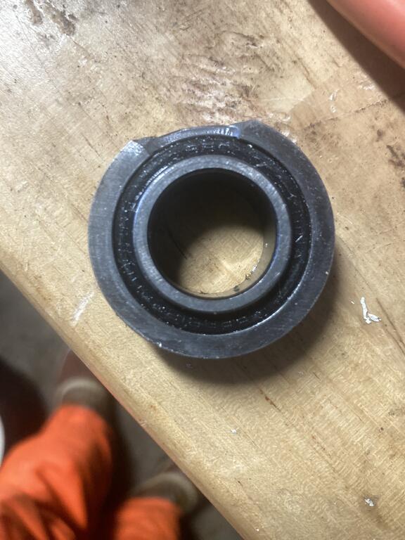

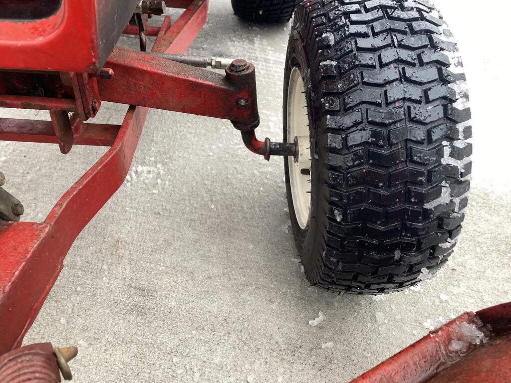

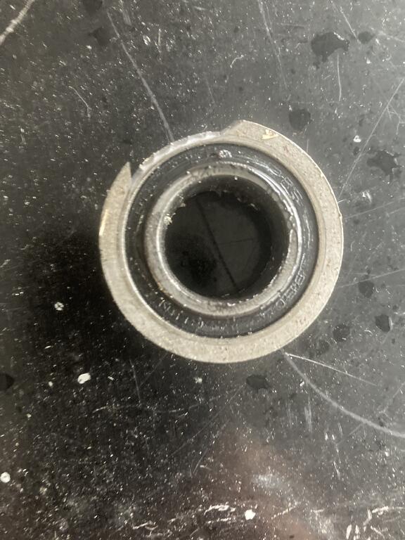

SylvanLakeWH 32,668 #13989 Posted December 18, 2021 Wheel bearing failure front left tire while plowing snow… errrrggghhh…! Finished with back up plow and then replaced bearings with old spare set… Lucky the tractor was 25’ from garage… wheel came off as I got it in garage pushing slowly with me foot holding the tire on… Both bearings failed same way. Design / manufacturing flaw? 4 Share this post Link to post Share on other sites

ebinmaine 80,841 #13992 Posted December 19, 2021 9 hours ago, Gregor said: I swapped out the lug bolts on the 656 for lug nuts. I think I may have all the tractors done now. Snazzy. We have lug nuts and studs on all our tractors. Soooo much easier when swapping wheels or even just the first and only time they'll be mounted. 2 Share this post Link to post Share on other sites

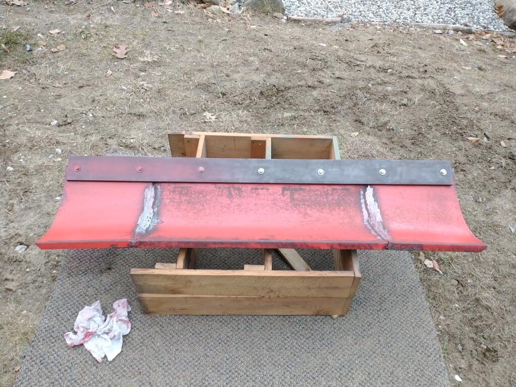

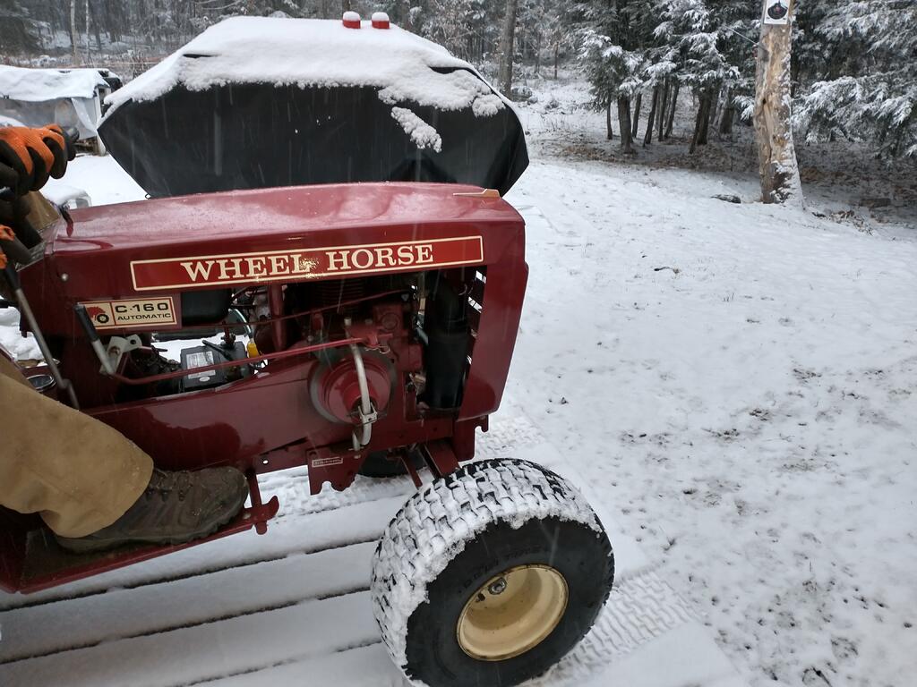

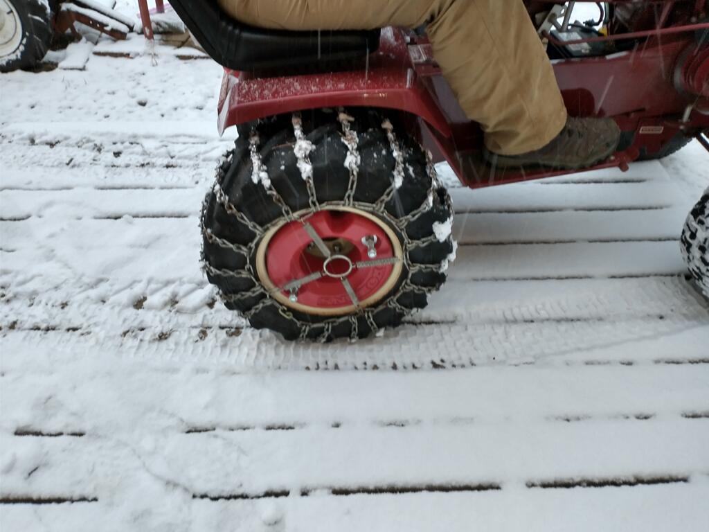

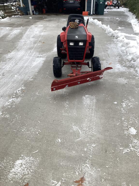

ebinmaine 80,841 #13993 Posted December 19, 2021 Spent all day working on the '75 C160 Automatic. Quite a few things done. Fluid filled tires and spacers. Steel weights. Chains on. Got the plow hitch modified for an automatic and installed. Plow is painted up. More pics & video tomorrow. We're getting a decent snowfall tonight. 5 13 Share this post Link to post Share on other sites
Snoopy11 5,731 #13994 Posted December 19, 2021 8 minutes ago, ebinmaine said: Plow is painted up That's not a 4 foot blade, is it? You aren't much taller than it... Don 1 2 Share this post Link to post Share on other sites
Snoopy11 5,731 #13995 Posted December 19, 2021 By the way @ebinmaine... that Horse there is so beautiful. That color is, just perfect. The gloss is like a mirror! Don 3 Share this post Link to post Share on other sites
Thor27 892 #13996 Posted December 19, 2021 6' blade? 2 Share this post Link to post Share on other sites
Snoopy11 5,731 #13997 Posted December 19, 2021 Just now, Thor27 said: 6' blade? No, gotta be 5' His head is 1' in itself... Don 2 Share this post Link to post Share on other sites
Thor27 892 #13998 Posted December 19, 2021 Just now, Snoopy11 said: No, gotta be 5' His head is 1' in itself... Don Kinda figured he was like 8 feet tall 2 Share this post Link to post Share on other sites

oliver2-44 11,766 #14000 Posted December 19, 2021 1 hour ago, ebinmaine said: Got the plow hitch modified for an automatic I wasn’t aware any mods were required 8speed vs automatic. What did you have to do to it? 1 hour ago, ebinmaine said: Share this post Link to post Share on other sites
