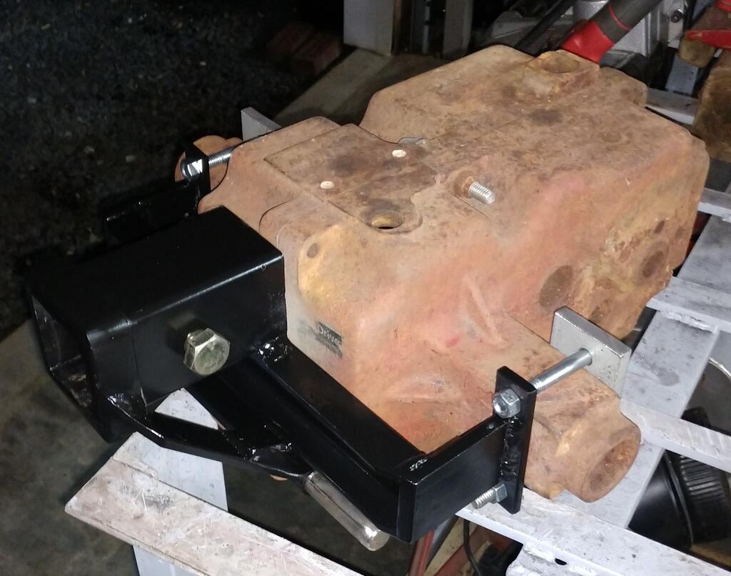

kpinnc 19,095 #12928 Posted September 27, 2021 (edited) I built my father in law a hitch so he can pull a trailer, and I'm gonna set up his leaf vac to work with it too. Just realized I missed a brace on the bottom. Guess I'll add it tomorrow. At least mine catches the slot hitch mount as well. Edited September 27, 2021 by kpinnc 2 7 Share this post Link to post Share on other sites
Moonshine*Connoisseur 498 #12929 Posted September 27, 2021 I truly like this design. 1 Share this post Link to post Share on other sites
kpinnc 19,095 #12930 Posted September 27, 2021 44 minutes ago, Moonshine*Connoisseur said: I truly like this design. I can't take credit- I just took what others have built and added the supports in the bottom. They probably are not needed, but I add support to the slot on every hitch I've built. 1 Share this post Link to post Share on other sites

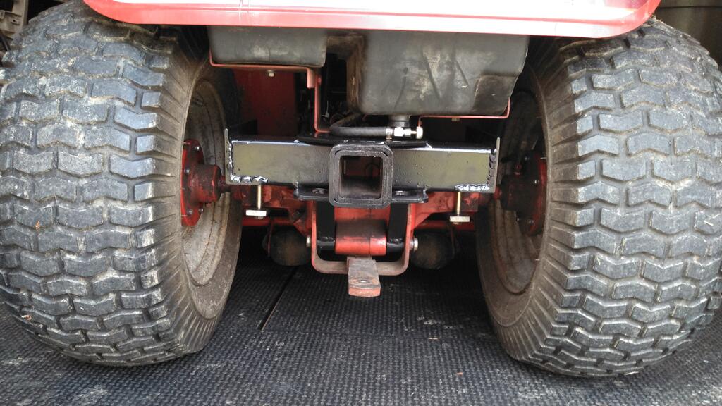

Bill D 3,199 #12931 Posted September 27, 2021 (edited) 1 hour ago, kpinnc said: I built my father in law a hitch so he can pull a trailer, and I'm gonna set up his leaf vac to work with it too. Just realized I missed a brace on the bottom. Guess I'll add it tomorrow. At least mine catches the slot hitch mount as well. Very nice. Here's my version. I designed it to allow use of the factory hitch as well. Edited September 27, 2021 by Bill D 1 6 Share this post Link to post Share on other sites
kpinnc 19,095 #12932 Posted September 27, 2021 14 minutes ago, Bill D said: Very nice. Here's my version. I designed it to allow use of the factory hitch as well. Nice! Starting to think you and I might be distant relatives- which is awful for you! 1 Share this post Link to post Share on other sites

JoeM 10,318 #12934 Posted September 27, 2021 3 hours ago, Bill D said: Very nice. Here's my version. I designed it to allow use of the factory hitch as well. And it looks like you could still have a snow plow bracket under that hitch as well too! All good work! 1 Share this post Link to post Share on other sites

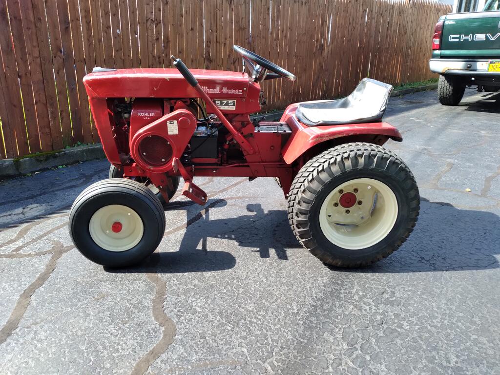

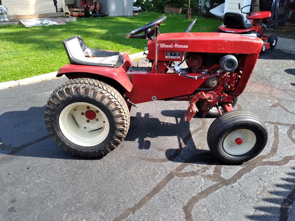

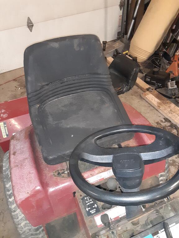

D_Mac 9,339 #12940 Posted September 28, 2021 Well nothing as exciting as fabricating a new hitch, but I did change the drive belt on the 875 that recently had an engine swap. Ran into a little issue with the ground wire but @squonkwas able to talk me through it. Tractor runs and drives great. Also swapped one of the steering gears while the engine was out. Steers nice and smooth now. I bought it as a parts machine, decided to invest the money to get it going again. Now I am on the fence about spending more money for a new seat for it. There no padding left and the cover has big hole in it. 5 3 Share this post Link to post Share on other sites
Lee1977 7,813 #12941 Posted September 28, 2021 4 minutes ago, D_Mac said: Now I am on the fence about spending more money for a new seat for it. There no padding left and the cover has big hole in it. Go ahead and get a new seat that metal is going to get cold this winter. 1 1 Share this post Link to post Share on other sites

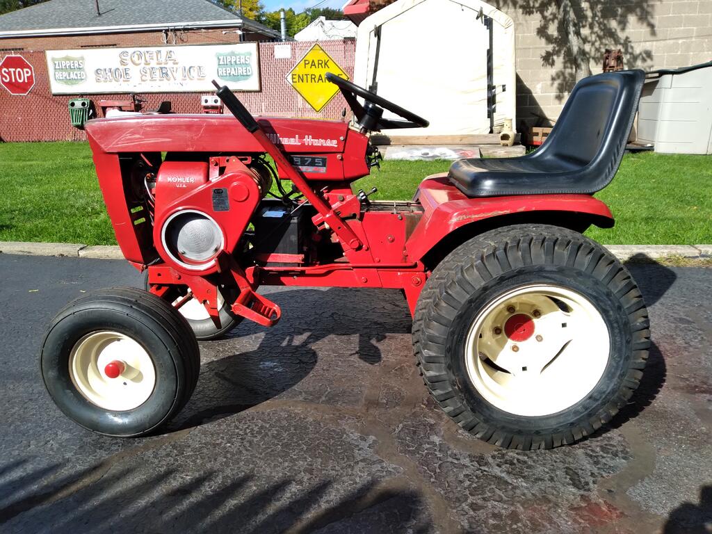

D_Mac 9,339 #12948 Posted September 28, 2021 (edited) Well... back at it again this morning. I did a little painting on the engine. Just trying to break up all the red. Then I went through my pile of old seats and came up with this one. I prefer the lower back because I am old and it's easier to swing your leg over a low back seat. Had to remove some studs and drill some new holes but it's on there now. Much more comfortable then just a plain metal pan. It still needs some work. Leaks gas around the sediment bowl. I have to address that, otherwise it's done. Edited September 28, 2021 by D_Mac 4 4 Share this post Link to post Share on other sites
