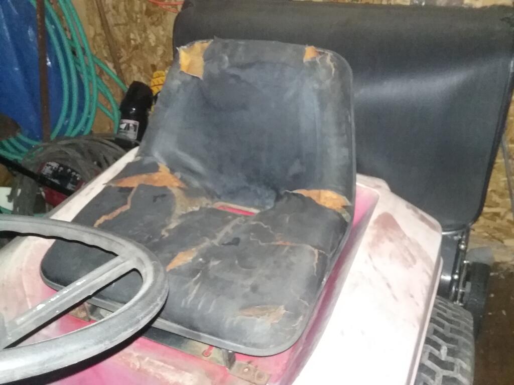

Oldskool 6,678 #12776 Posted September 15, 2021 22 minutes ago, 8ntruck said: Think applying mineral oil will bring this seat back? It may save what you have left? Share this post Link to post Share on other sites
cleat 9,333 #12777 Posted September 15, 2021 1 hour ago, 8ntruck said: Think applying mineral oil will bring this seat back? Sure, just soak it well then toss on a match and it will be good as new....... Just kidding, that one just might need a recover or outright replacement. Share this post Link to post Share on other sites
8ntruck 9,296 #12778 Posted September 15, 2021 21 minutes ago, cleat said: Sure, just soak it well then toss on a match and it will be good as new....... Just kidding, that one just might need a recover or outright replacement. Ok. Use mineral oil on the seat like kerosene for spot remover - apply to stain, soak overnight, apply match in the morning. Spot will be removed! Seriously, I am debating the possibilities of replacing it with a Northern Tool seat for a bill and a quarter, or recovering it myself for probably half of that. I'll learn more by recovering it. Think I will end up tearing the seat down to the shell to make sure there is enough there to be worth recovering. Besides, if I recover it, I can work up some sort of cool custom cover. 1 Share this post Link to post Share on other sites
ebinmaine 80,694 #12779 Posted September 15, 2021 6 hours ago, 8ntruck said: learn more by recovering Agreed. If you replace the foam be very careful to buy the correct density. We recovered the seat on Cinnamon Horse C160 and used a foam that's not dense enough. Very near might as well not be any. 1 Share this post Link to post Share on other sites
lynnmor 9,040 #12780 Posted September 15, 2021 6 hours ago, 8ntruck said: Seriously, I am debating the possibilities of replacing it with a Northern Tool seat for a bill and a quarter, or recovering it myself for probably half of that. I'll learn more by recovering it. Think I will end up tearing the seat down to the shell to make sure there is enough there to be worth recovering. Besides, if I recover it, I can work up some sort of cool custom cover. Recovering a molded seat like that is nearly impossible. I contacted one of the best shops in that business and he said just buy a new seat. Even if you could piece together a cover, will it be waterproof? 1 1 Share this post Link to post Share on other sites
ebinmaine 80,694 #12781 Posted September 15, 2021 24 minutes ago, lynnmor said: Recovering a molded seat like that is nearly impossible. I contacted one of the best shops in that business and he said just buy a new seat. Even if you could piece together a cover, will it be waterproof? Absolutely a valid point. To do it correctly would be a challenge to say the least. In my particular case I don't mind the wrinkles in the corners at all and because those are there my seat is waterproof. That said however, it doesn't even get left out in the rain so it doesn't really matter. Probably would have to do at least two or three smaller cushions individually to really do it right. Share this post Link to post Share on other sites

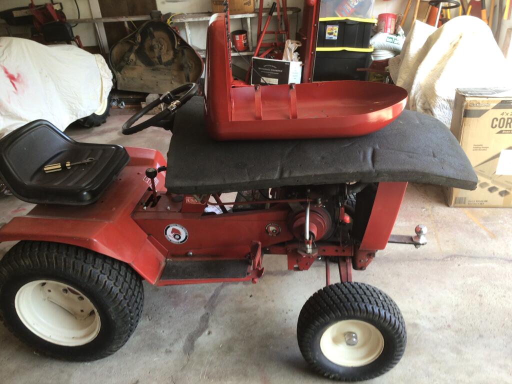

SylvanLakeWH 32,497 #12782 Posted September 15, 2021 (edited) Actually, I did a quick job on a seat like that and it works fine. Is it cushy? Nope. But it works for about $5 in vinyl… Used 1/2” pvc board and an old camping sleeping pad…wrapped vinyl and stapled. Held perfectly so far… See post 37 here: Edited September 15, 2021 by SylvanLakeWH 1 Share this post Link to post Share on other sites
Oldskool 6,678 #12783 Posted September 15, 2021 58 minutes ago, SylvanLakeWH said: Actually, I did a quick job on a seat like that and it works fine. Is it cushy? Nope. But it works for about $5 in vinyl… Used 1/2” pvc board and an old camping sleeping pad…wrapped vinyl and stapled. Held perfectly so far… I did the same thing on Project Snowdrift. Its fairly comfy and also water proof. I was looking online this morning for a universal preformed vinyl shell for low back seats. I didn't find one but was pretty sure I have seen them before. Maybe I wasn't using the proper search term? 1 Share this post Link to post Share on other sites
D_Mac 9,339 #12784 Posted September 15, 2021 Vinyl is tuff to bring back from being dry because it dosnt absorb anything you rub into it like leather would. 30 plus years in the leather repair business thought me at least that much. I always replace the seat with a new one. Keep looking you can find them on sale. Last one I got I got online for 75 bucks delivered. 1 1 Share this post Link to post Share on other sites

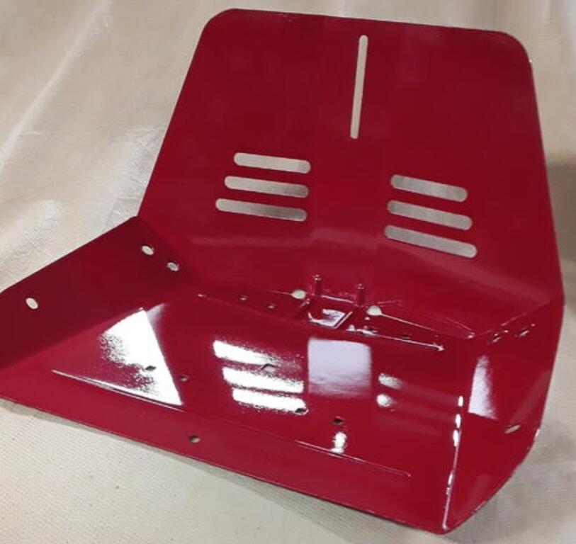

peter lena 10,065 #12791 Posted September 15, 2021 @cleat , https://www.agrisupply.com/universal-tractor-seat/p/14119/?sid=asf10&eid=Easf10&zmam=77232640&zmas=1&zmac=1&zmap=14119&eid=gl020116&sid=google&gclid=Cj0KCQjws4aKBhDPARIsAIWH0JWAxsFH-odpY4rTTTNe0cjcugegzqyuYNHSdQ7QiQqjk5dTFL1AQAgaAuUWEALw_wcB have 3 of these seats on my horses , move down on page to seat base measurements , measure yours , wheel horse is there , 7 x 7 1/2 " , have them for years now , no problems , good price too , pete 1 Share this post Link to post Share on other sites
8ntruck 9,296 #12792 Posted September 16, 2021 (edited) 16 hours ago, lynnmor said: Recovering a molded seat like that is nearly impossible. I contacted one of the best shops in that business and he said just buy a new seat. Even if you could piece together a cover, will it be waterproof? I was thinking of doing a bottom pad and a back pad. Waterproof? Not too worried about that, as inside storage is planned. Mulling over how to build backing boards to match the contour of the seat shell. Get a bunch of veneer (sp?) and lay up my own 'plywood' using the seat shell for a form? @Wheel Horse 3D - that looks like a Red & Green inspired solution. Edited September 16, 2021 by 8ntruck Share this post Link to post Share on other sites

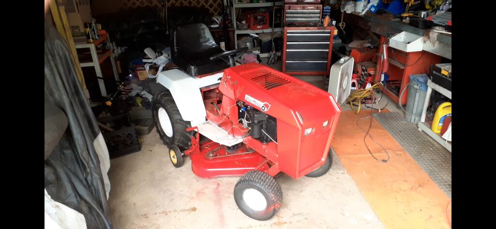

Maxwell-8 4,371 #12794 Posted September 16, 2021 (edited) I finaly after owning my first horse for 10 months got a ride out here whitout any issues, don't mind the fuel tank tho.. Have been waiting on parts, and then the next thing in line failed. But dang, I like riding this horse already the most, more then the 312,314 or C175. seating position is more relaxed Edited September 16, 2021 by Maxwell-8 3 3 Share this post Link to post Share on other sites

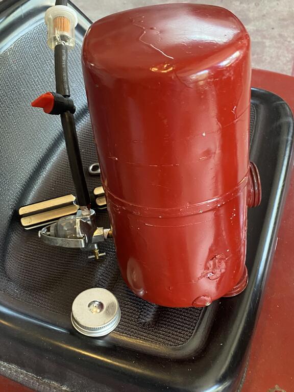

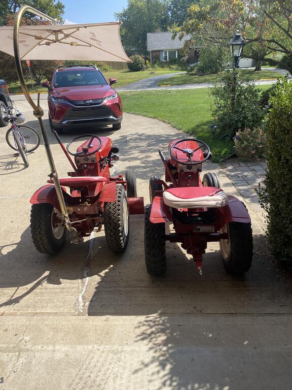

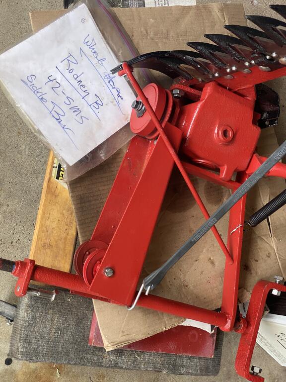

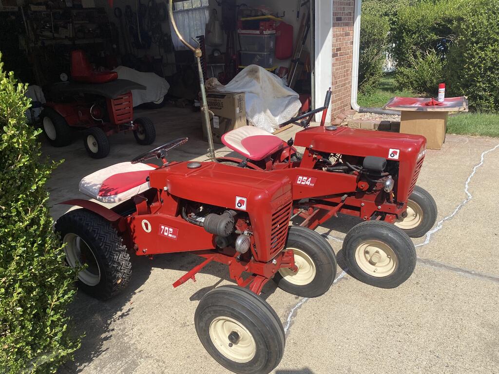

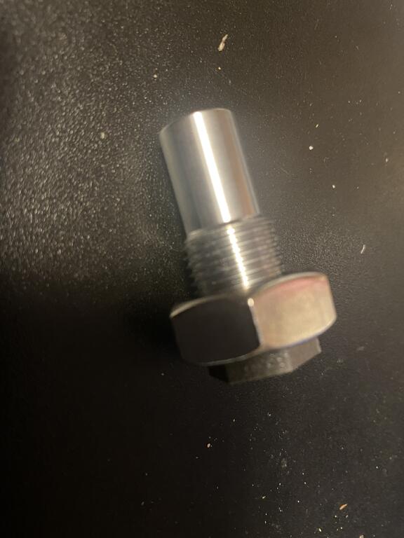

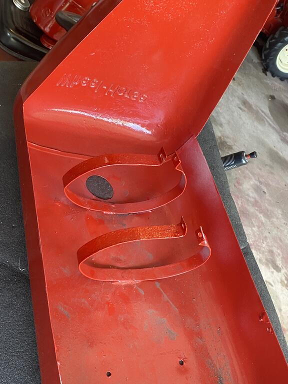

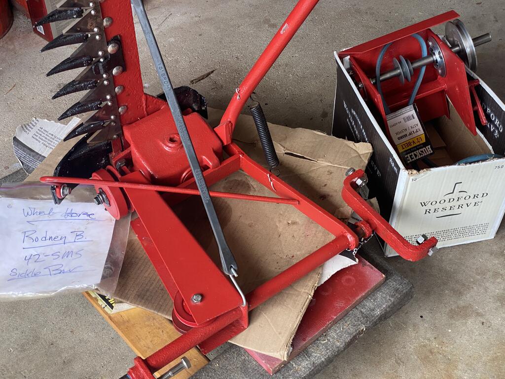

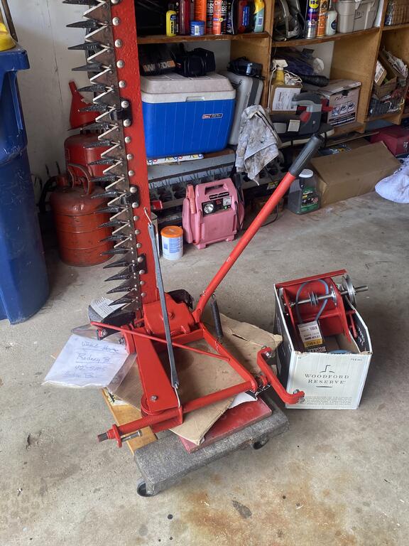

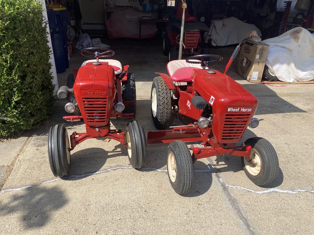

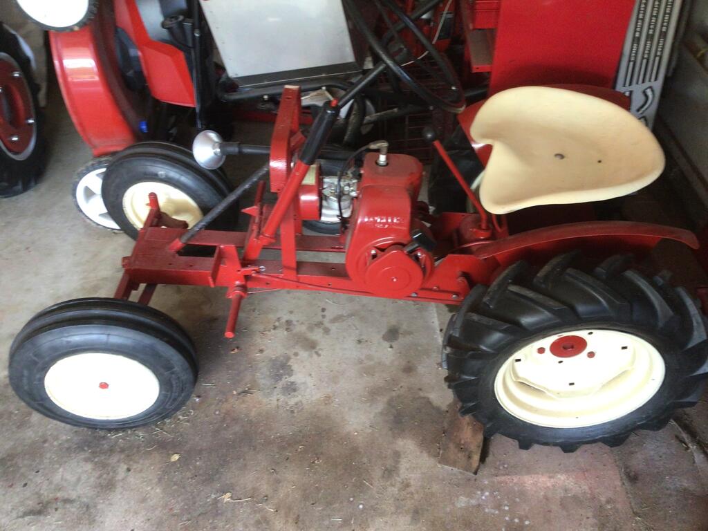

Lane Ranger 12,105 #12800 Posted September 16, 2021 Finished my 42-SMS Sickle Mower rebuild for Rodney Burger (lawnman_56) Turned out pretty good. I put one of my new sickle drive pins in the wobble box and blade. I have a few for sale listed in Red Square Classifieds. I also ran the 702 and 854 . Cleaned them up to take to a couple shows this fall. I also started to install my gas tank on my restored Wheel Horse RJ hood. I had to cut off the rusted bolts on the gas tank straps Going to install tank, sediment bowl and new gas line. Hood will go on RJ in pictures. 2 7 Share this post Link to post Share on other sites
