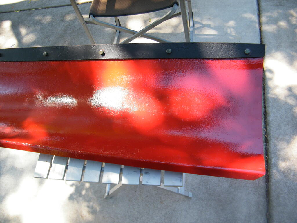

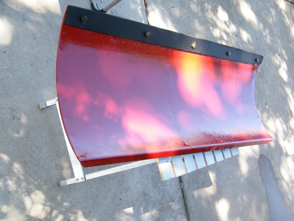

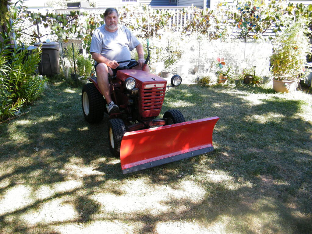

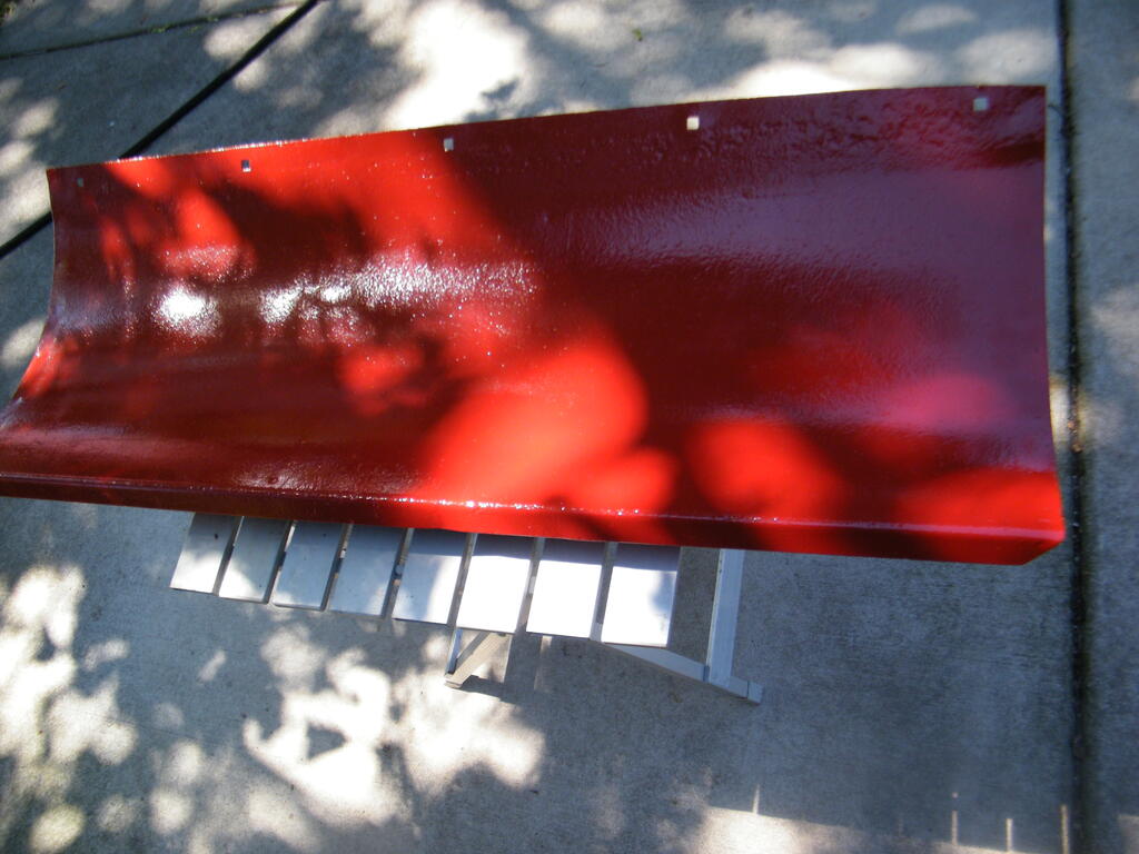

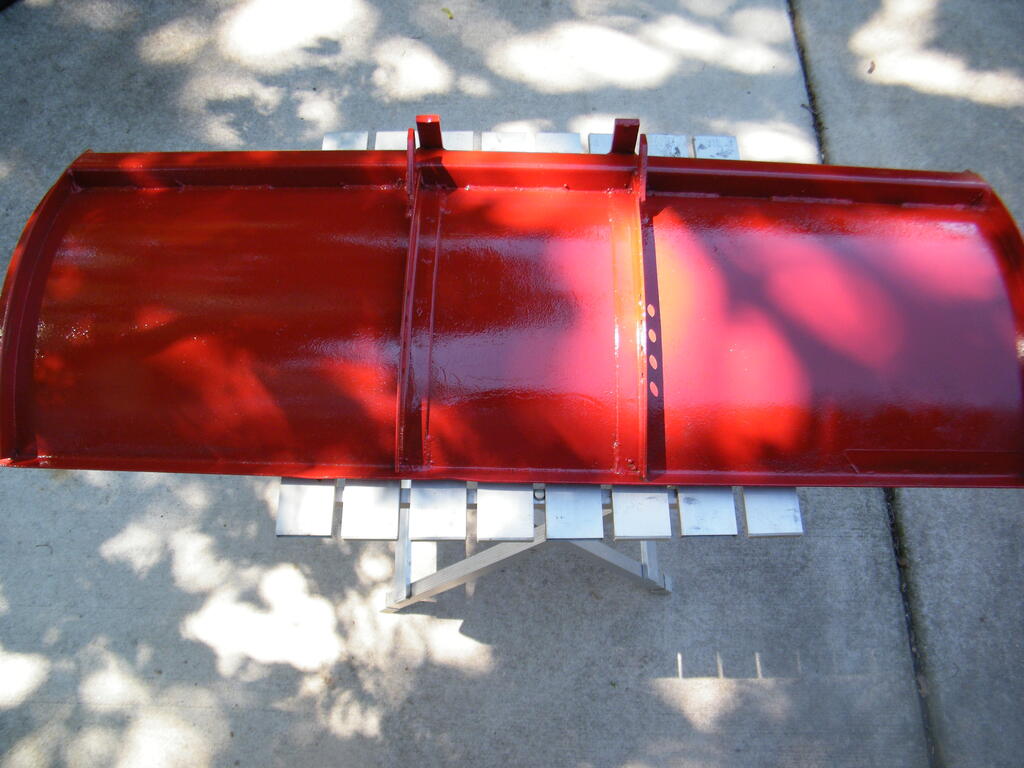

stevasaurus 23,891 #12688 Posted September 6, 2021 Cleaned up the snow blade on my 857. Regal Red painted with a 3" roller and the help of a brush. No snow sticking this year. 13 6 Share this post Link to post Share on other sites

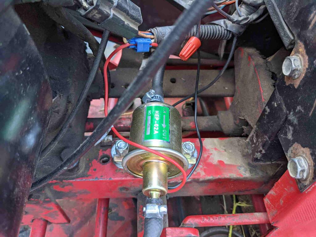

balconio 606 #12691 Posted September 6, 2021 (edited) My 312-8 with 1654 hours got a new electric fuel pump today. The cheapest one I could find on Amazon, $9.98 for an "HEP-02A" pump. Some kind Wheel Horse engineer designed the frame with 2 perfect mounting holes, knowing I'd be ditching their mechanical pump 30+ years later for a $10 Chinese deal 🙄. I have an inline fuel filter before and after the pump- the 2nd one was really just used as a hose splice where I bypassed the old pump. No relay, this only draws 1 amp so I didn't see the need. I do need to wire an inline fuse though and solder it up. Also for those who've gone electric, did you remove the old pump or just leave it as is? Edited September 6, 2021 by balconio 2 2 Share this post Link to post Share on other sites
8ntruck 9,420 #12692 Posted September 6, 2021 I had the top off of my mechanical pump when I decided to replace it. I used the fuel hose barbs on the electric pump, so I made a block off plate to replace the top of the fuel pump. Share this post Link to post Share on other sites
Gregor 4,848 #12693 Posted September 6, 2021 I have tried those $10 Amazon pumps. They didn't work out well for me, hope you have better luck. I always block off the original pump opening. 3 Share this post Link to post Share on other sites
pfrederi 21,339 #12694 Posted September 6, 2021 (edited) 42 minutes ago, Gregor said: I have tried those $10 Amazon pumps. They didn't work out well for me, hope you have better luck. I always block off the original pump opening. 500 ft from the shop $10 pump failure... Facet posiflo made in USA is all I use now Some i made block offs some i left... Edited September 6, 2021 by pfrederi 3 3 Share this post Link to post Share on other sites

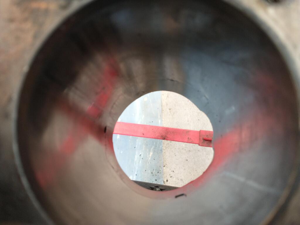

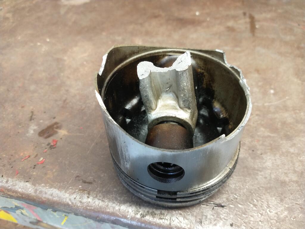

squonk 48,417 #12696 Posted September 7, 2021 As they used to say in NASCAR. "She done blowed up Cale!" Tore @D_Mac 's blown 875 engine apart to save anything salvageable. Block not only had a chunk out of the cylinder but it is cracked about 3/4 of the way around! Piston is going in my "Haul of Fame! 1 7 Share this post Link to post Share on other sites
Handy Don 17,729 #12697 Posted September 7, 2021 I reckon that cylinder 'bout lost it head, sir! 2 Share this post Link to post Share on other sites
Pullstart 71,542 #12698 Posted September 7, 2021 21 hours ago, balconio said: Also for those who've gone electric, did you remove the old pump or just leave it as is? I’ suggest a block off. If the pump diaphragm is torn, it could be a point of entry for debris and whatnot. At the very least, put a short hose from one end to the other. 1 Share this post Link to post Share on other sites
stevasaurus 23,891 #12699 Posted September 7, 2021 Nice paper weight collection you have there Mike. 3 Share this post Link to post Share on other sites
Stormin 9,988 #12700 Posted September 7, 2021 Drill holes in the piston crowns and you'll have handy pencil/pen holders. 2 2 2 Share this post Link to post Share on other sites
