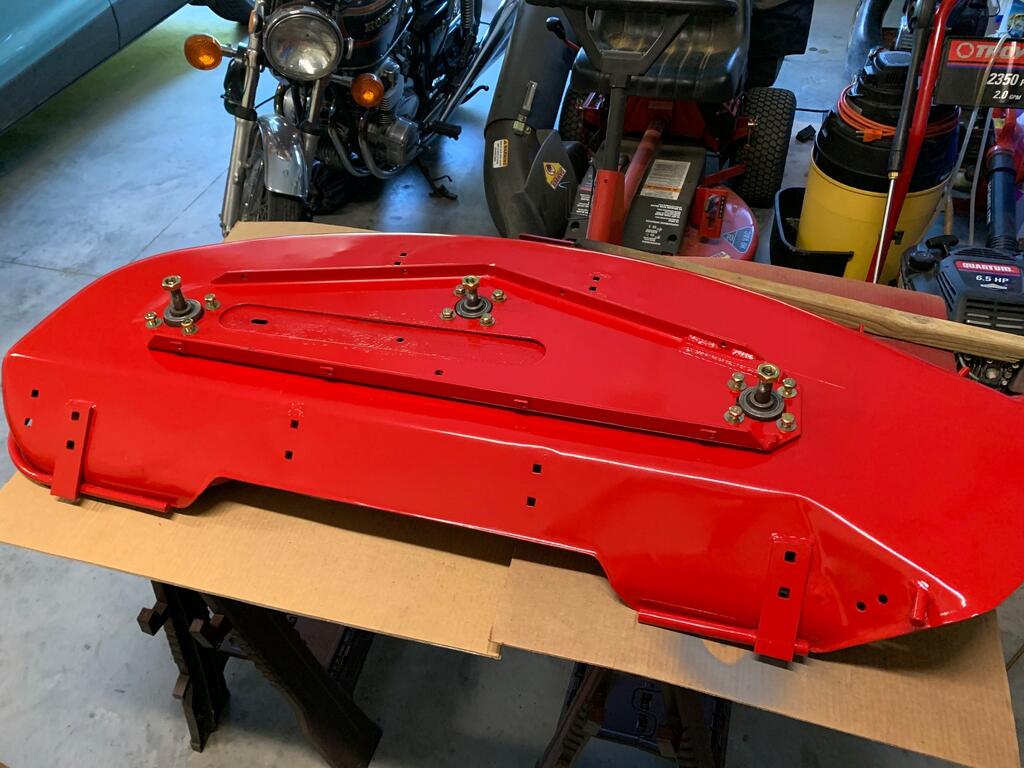

Ifixoldjunk 778 #12551 Posted August 22, 2021 I finally replaced the rotten Frankenstein deck on my Dixie horse tractor. Scored a nice solid 42 side discharge. only has one little pin hole, which is a major improvement over the last one. 6 2 Share this post Link to post Share on other sites

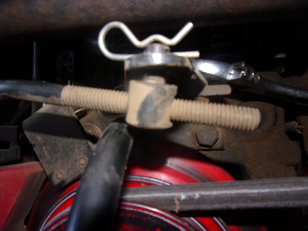

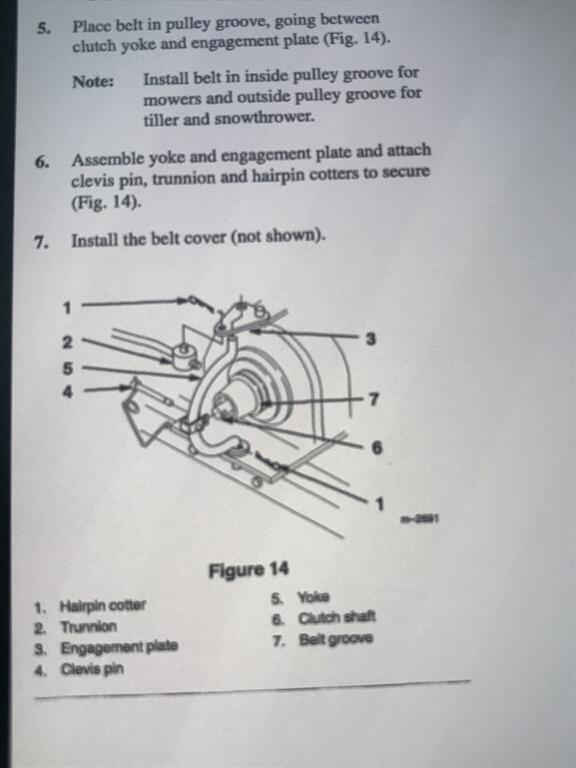

Lane Ranger 12,151 #12558 Posted August 23, 2021 (edited) On 8/20/2021 at 12:05 PM, WheelHorse520H said: I see that, but what I just noticed was we have different heat shields, mine has a cutout for the trunnion. This is from the 520 Operating Manual that lynmorr referenced earlier. The trunnion pushed up from bottom on the drawing and pin on top. I will check mine again as maybe the back bolt and nut on right need tightening to align the trunnion better on the plate. But my PTO worked fine after adjusting the trunnion on the threaded rod. It does what it suppose to do. Edited August 23, 2021 by Lane Ranger 4 Share this post Link to post Share on other sites

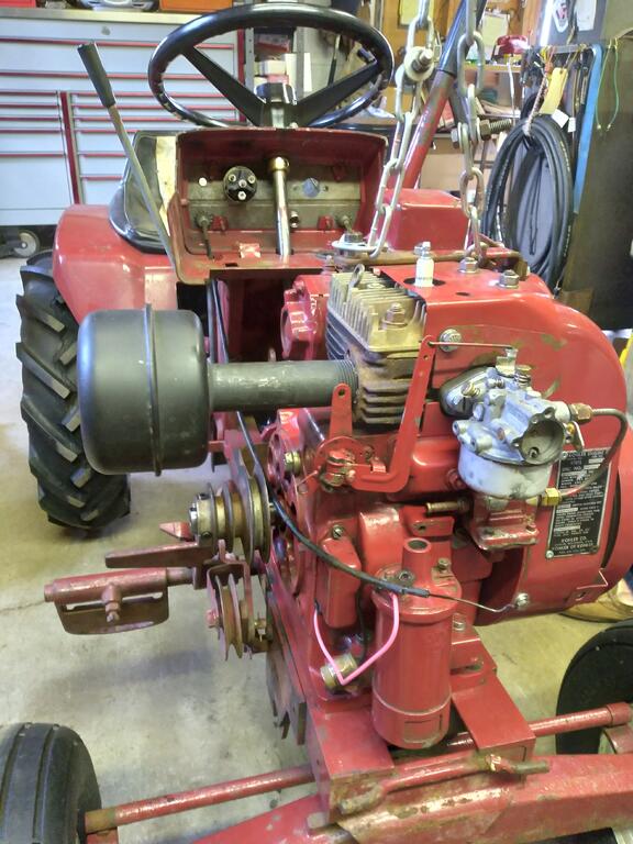

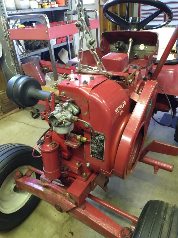

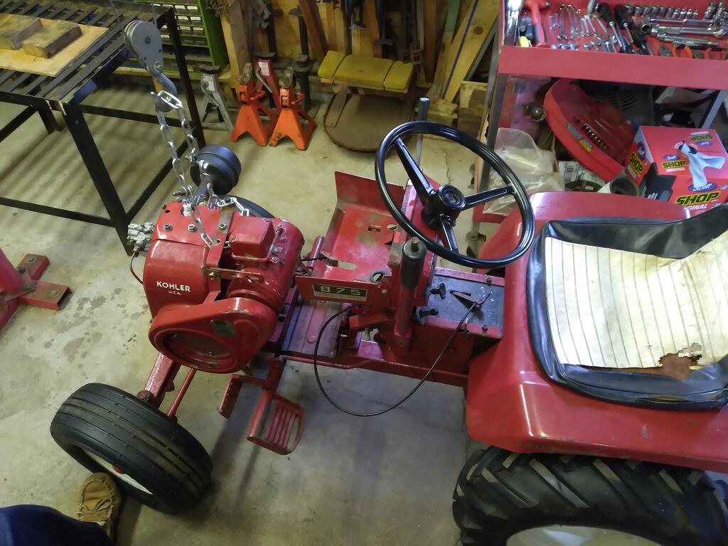

D_Mac 9,339 #12559 Posted August 23, 2021 Got the engine in the 875. Needs everything connected. Getting there slowly but surely. Sure hope the engine is a good one !!! Steering gear is on. Carb cleaned and rebuilt. Need to clean the gas tank. Not going to do any touch up painting until I know it runs. Picked up a new battery, air filter, drive belt, transmission filter, gas filter. Got almost as much into filters then I paid for the tractor !!! 6 2 Share this post Link to post Share on other sites

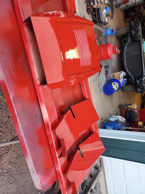

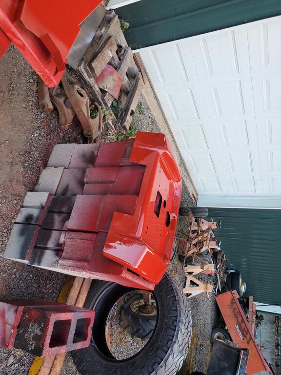

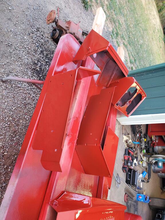

Thor27 892 #12561 Posted August 23, 2021 Shot some red lastnight. 4 3 Share this post Link to post Share on other sites

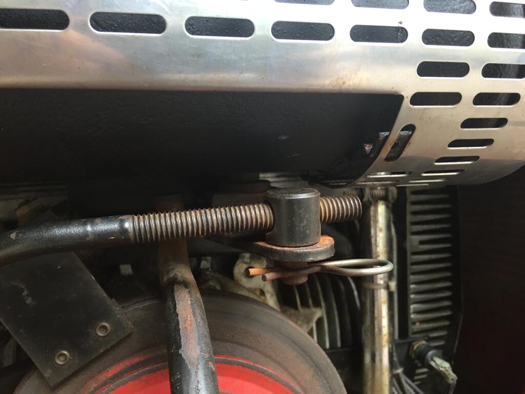

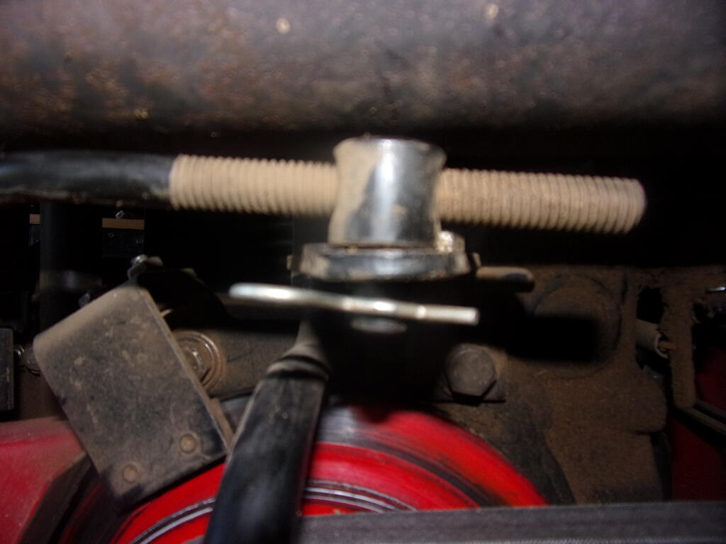

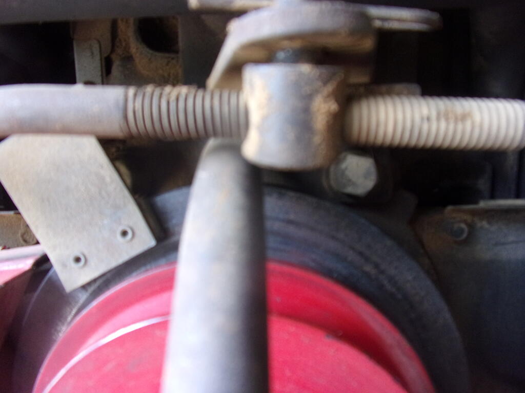

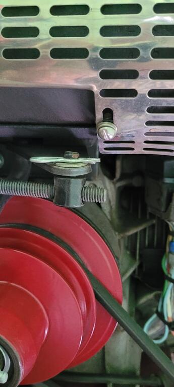

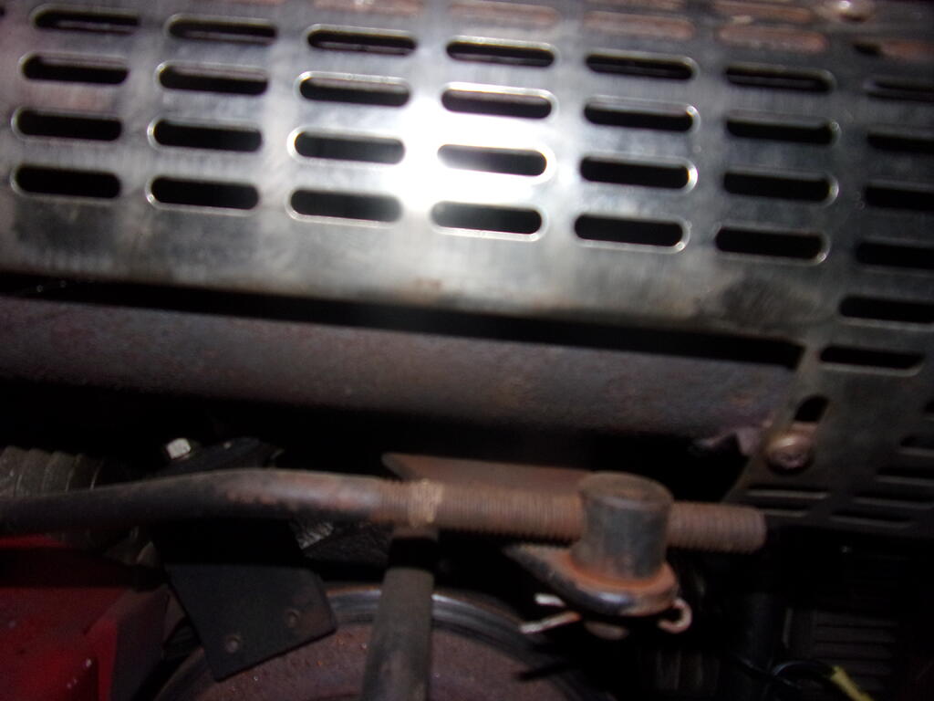

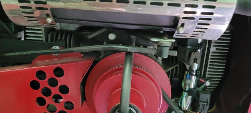

Ed Kennell 47,626 #12566 Posted August 23, 2021 (edited) 8 hours ago, Lane Ranger said: This is from the 520 Operating Manual that lynmorr referenced earlier. The trunnion pushed up from bottom on the drawing and pin on top. I will check mine again as maybe the back bolt and nut on right need tightening to align the trunnion better on the plate. But my PTO worked fine after adjusting the trunnion on the threaded rod. It does what it suppose to do. I took a few more pics of the PTO engagement trunnion on my tractors. I have no idea how they were assembled from WH factory as I was not the origonal owner. My '88 520 would work either way. It just looks better on the top. I tried the trunnion on the bottom on my 312 and 417. The 417 will engage but the trinnion is riding on the PTO hoop. The 312 will engage, but the trunnion is closer to the PTO hoop than I like and at a terrible angle with the lever. To change the position of the trunnion, it is necessary to loosen the bolt in the lever to get enough clearance with the muffler to insert the trunnion on top. After it is in the hole, there is plenty of clearance with the muffler. I will leave all mine on top...they all work there and My logic tells me the rod and trunnion should be supported by the shoulder on the trunnion and not by a hairpin clip. If some keep the trunnions on the bottom as WH instructs, I recommend putting a washer under the hairpin clip for a bearing surface and to help keep the trunnion square in the lever. Paul Harvey "And that's the rest of the story" Edited August 23, 2021 by Ed Kennell 6 Share this post Link to post Share on other sites
Handy Don 17,581 #12567 Posted August 23, 2021 13 minutes ago, Ed Kennell said: My logic tells me the rod and trunnion should be supported by the shoulder on the trunnion and not by a hairpin clip. 13 minutes ago, Ed Kennell said: I recommend putting a washer under the hairpin clip for a bearing surface and to help keep the trunnion square in the lever 1 Share this post Link to post Share on other sites
cleat 9,388 #12568 Posted August 23, 2021 This is one of my 520's They are all the same. Trunnion below with a washer and hairpin clip above. They work great. 4 1 Share this post Link to post Share on other sites

WheelHorse520H 710 #12571 Posted August 23, 2021 1 hour ago, Ed Kennell said: My logic tells me the rod and trunnion should be supported by the shoulder on the trunnion and not by a hairpin clip. Mine too, that’s probably what the PO thought when I got mine. I noticed it seems to lock the PTO lever better because it is pulling up on the back of the PTO lever. Rather than pulling the back down and the handle part of the lever back and towards the operating. I can see why one would choose both and I think it is a personal preference as to where the trunnion sits. @slufoot733 quit it!! Your makin’ me jealous! 1 Share this post Link to post Share on other sites
