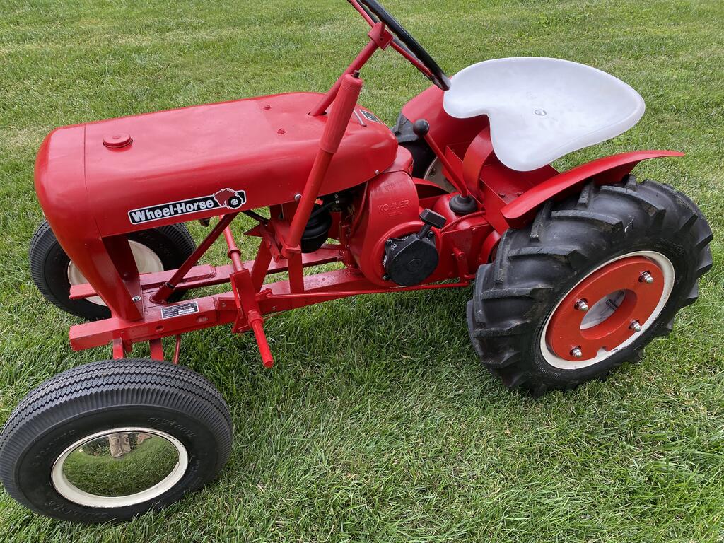

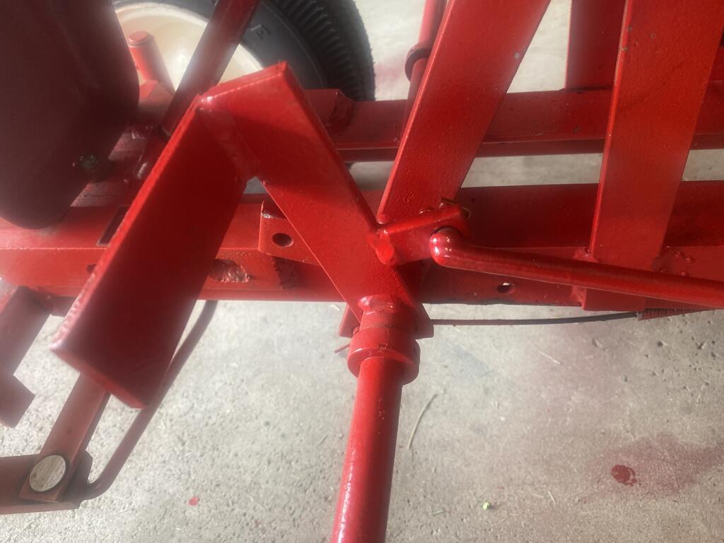

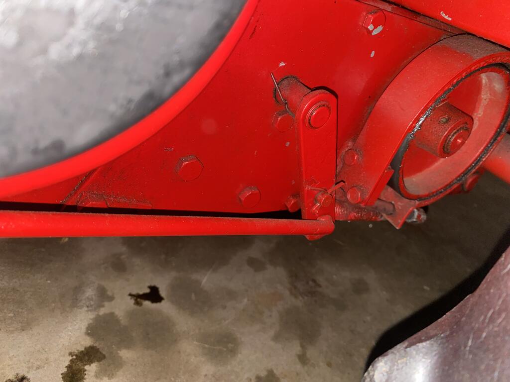

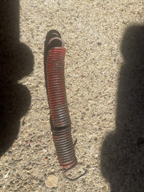

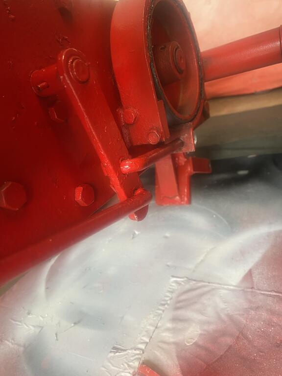

Lane Ranger 12,151 #11676 Posted June 1, 2021 I got the West Virginia RJ clutch/brake set better (less grabbing) . I put a roll pin in the clutch idler arm as there was a cotter key in there . It did not operate correctly with the cotter key. I also changed the old clutch spring to a new one. 9 3 Share this post Link to post Share on other sites
KensSmallEngines 4 #11677 Posted June 1, 2021 Did it solve the wheely popping issues so common on these? 1 Share this post Link to post Share on other sites
Lane Ranger 12,151 #11678 Posted June 1, 2021 Ken : so far yes ! I will wait to tell the story at the Big Show on “my wheelie popping “ experience with this one! I have a couple that will pop in third gear but this one popped second worse than any third gear pop I ever experienced! The head bolts snd gas had to be torqued on this and after that was done a new throttle cable. The think starts first or second pull on low choke setting and has quite a bit of power. 3 1 Share this post Link to post Share on other sites

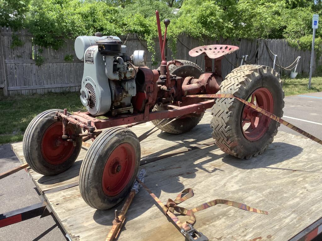

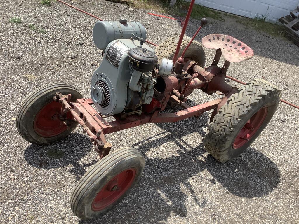

Pullstart 71,393 #11679 Posted June 1, 2021 Unloaded my new toy this afternoon. A little more than 200 miles round trip and over state lines. 4 15 Share this post Link to post Share on other sites

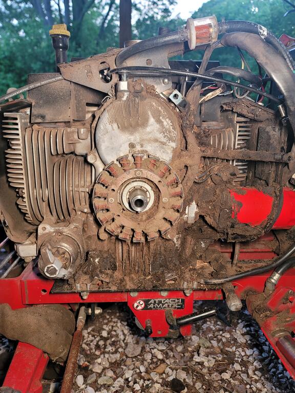

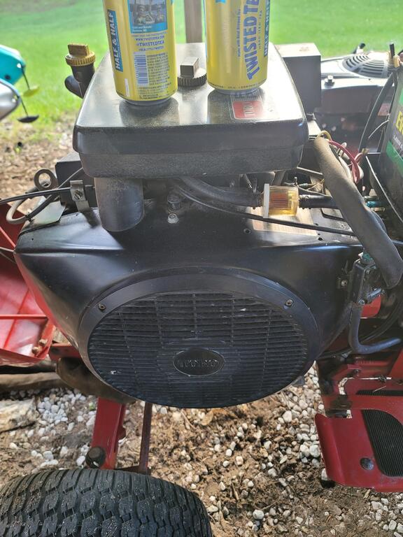

Jhook 849 #11680 Posted June 2, 2021 Started tearing into my 416h that lost spark backfired and died during my first mow with it 6 Share this post Link to post Share on other sites
Gregor 4,848 #11681 Posted June 2, 2021 Sounds suspiciously like a partially sheared flywheel key. 1 Share this post Link to post Share on other sites
Jhook 849 #11682 Posted June 2, 2021 13 minutes ago, Gregor said: Sounds suspiciously like a partially sheared flywheel key. Ill take a look at the key tomorrow. I was planning on it being the ignition module since i tested coil and ran a jumper wire bypassing all safetys with no luck Share this post Link to post Share on other sites
D_Mac 9,339 #11683 Posted June 2, 2021 2 hours ago, pullstart said: Unloaded my new toy this afternoon. A little more than 200 miles round trip and over state lines. Nice but where is the rest of it? 6 Share this post Link to post Share on other sites
Pullstart 71,393 #11684 Posted June 2, 2021 27 minutes ago, D_Mac said: Nice but where is the rest of it? That’s all there is! It’s pretty much the tractor that became the legacy you know as Wheel Horse 2 2 Share this post Link to post Share on other sites
Gregor 4,848 #11685 Posted June 2, 2021 3 minutes ago, pullstart said: That’s all there is! It’s pretty much the tractor that became the legacy you know as Wheel Horse Is that all there ever was? 1 Share this post Link to post Share on other sites
ebinmaine 80,984 #11686 Posted June 2, 2021 5 hours ago, Gregor said: Is that all there ever was? Yepp 1 Share this post Link to post Share on other sites
Pullstart 71,393 #11687 Posted June 2, 2021 9 hours ago, Gregor said: Is that all there ever was? 3 hours ago, ebinmaine said: Yepp Back when OSHA was what you half got out of your mouth before the threshing machine tore your leg off... No seat suspension, no brakes, no steering wheel, no foot rests, or any of that other stuff that gets in the way of what you’re trying to accomplish. 1 3 6 Share this post Link to post Share on other sites

Snoopy11 5,731 #11693 Posted June 2, 2021 13 hours ago, pullstart said: That’s all there is! It’s pretty much the tractor that became the legacy you know as Wheel Horse Sure lives up to its name... torquie horse with wheels... Don 2 Share this post Link to post Share on other sites

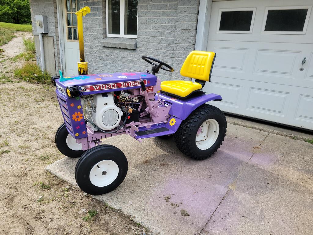

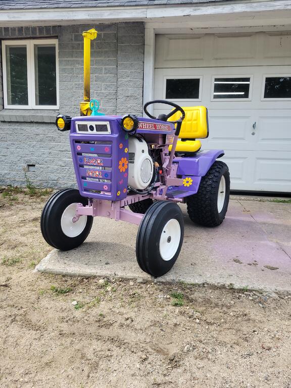

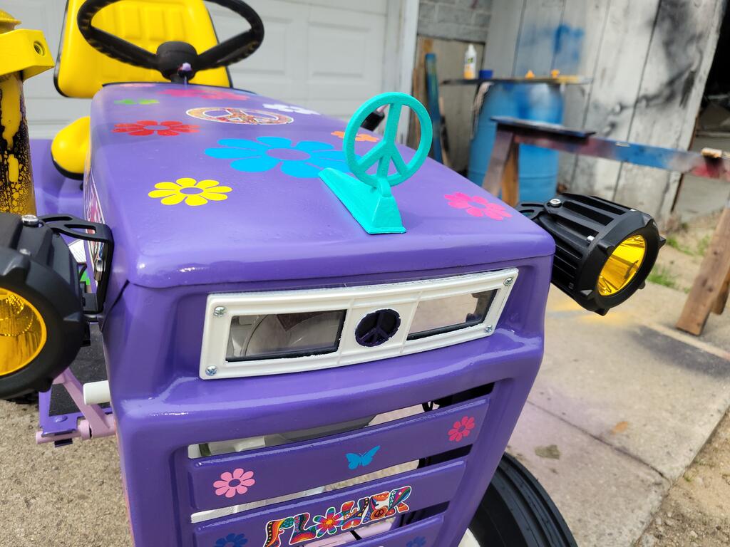

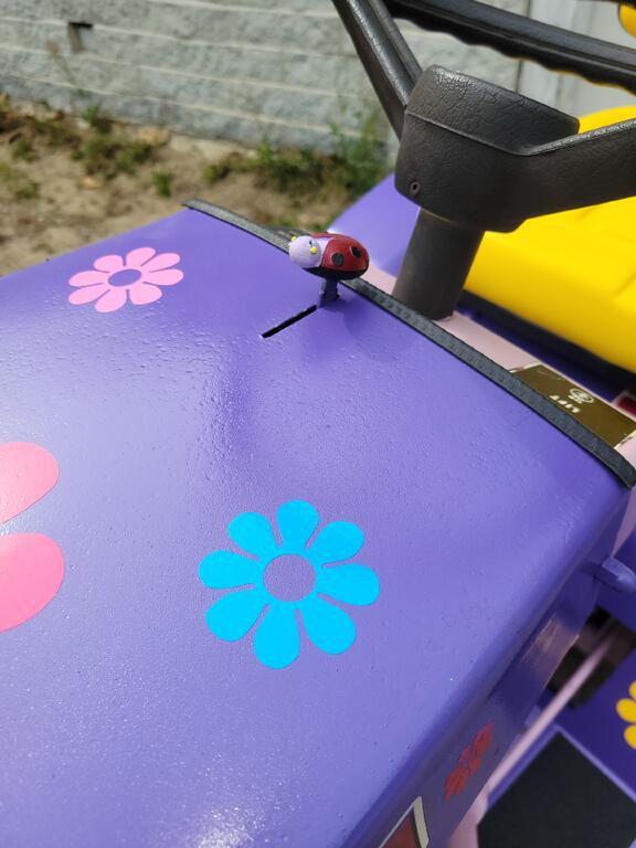

OldWorkHorse 3,156 #11698 Posted June 2, 2021 So other then a couple small things like painting the rear rims re doing the stack that melted guess header heat wasn't hot enough? 🤦♂️.... oh and a transmission rebuild.... the B-80 "FlowahPowah" is complete! From its quick make over! Hopfuly with the help from @ebinmaine shell be done marking its territory and back in action! Thanks @Wheel Horse 3D for the custom hood ornament and headlight Lens and hood latch! Got to touch the lens up but all in all looking good the other half and the daughters love it and want to drive it already! Gonna try and keep it somewhat clean till the owls head show in July! Also had a custom made steering wheel insert but I seem to have put that sumwhere 🤔 so photos of that when it's all fully done! OK now back to the 1257HEAVY. 4 6 2 1 Share this post Link to post Share on other sites
OutdoorEnvy 1,817 #11699 Posted June 2, 2021 That is really cool oldworkhorse! Job well done all around. If you line it up with others at the show you'll be know which ones yours for sure I hope it brings years of enjoyment to the family. Thanks for the post 2 1 1 Share this post Link to post Share on other sites
