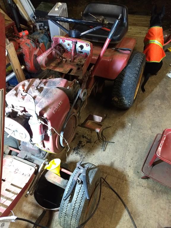

ebinmaine 81,223 #1103 Posted September 9, 2018 So here's where we're at with the 1267 for the night. The oil is draining out. Air filter will need to be replaced. The PTO and lever assembly has been removed because I will have no implements to drive. I pulled the gas tank out and all the wiring out and vacuumed out a rodents nest. Ignition switch will be replaced with a 5 post later model. Replaced the seat with the one from the mini farm tractor project. 1 Share this post Link to post Share on other sites

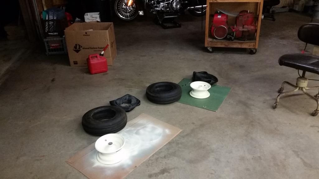

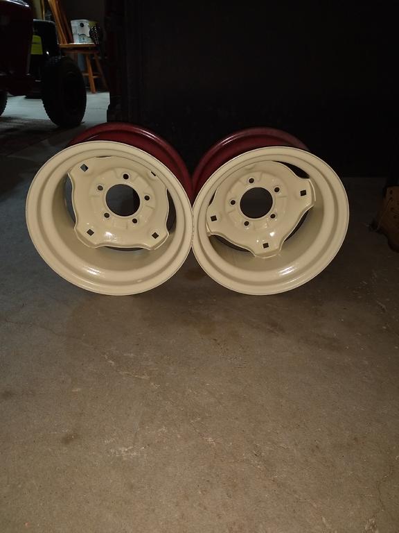

ebinmaine 81,223 #1105 Posted September 10, 2018 My honey took a few minutes today to clean up the wheels that were on the farm tractor hand-built custom project. I had taken those off to swap the ags on to it so I could roll it around. I used my HF manual tire changer to remove the junk tires and then she cleaned them all up and sprayed the two outsides Navajo white. These will have a set of 23 x 10.5 turfs with chains and be mounted on to the 1267. 1 1 Share this post Link to post Share on other sites

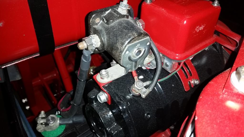

WHX?? 58,378 #1107 Posted September 10, 2018 16 hours ago, ebinmaine said: Ignition switch will be replaced with a 5 post later model You do realize you will have to go with a starter solenoid right EB? 1 Share this post Link to post Share on other sites
ebinmaine 81,223 #1108 Posted September 10, 2018 8 minutes ago, WHX20 said: You do realize you will have to go with a starter solenoid right EB? Yepp Yepp. Already borrowed one from a C81. Share this post Link to post Share on other sites

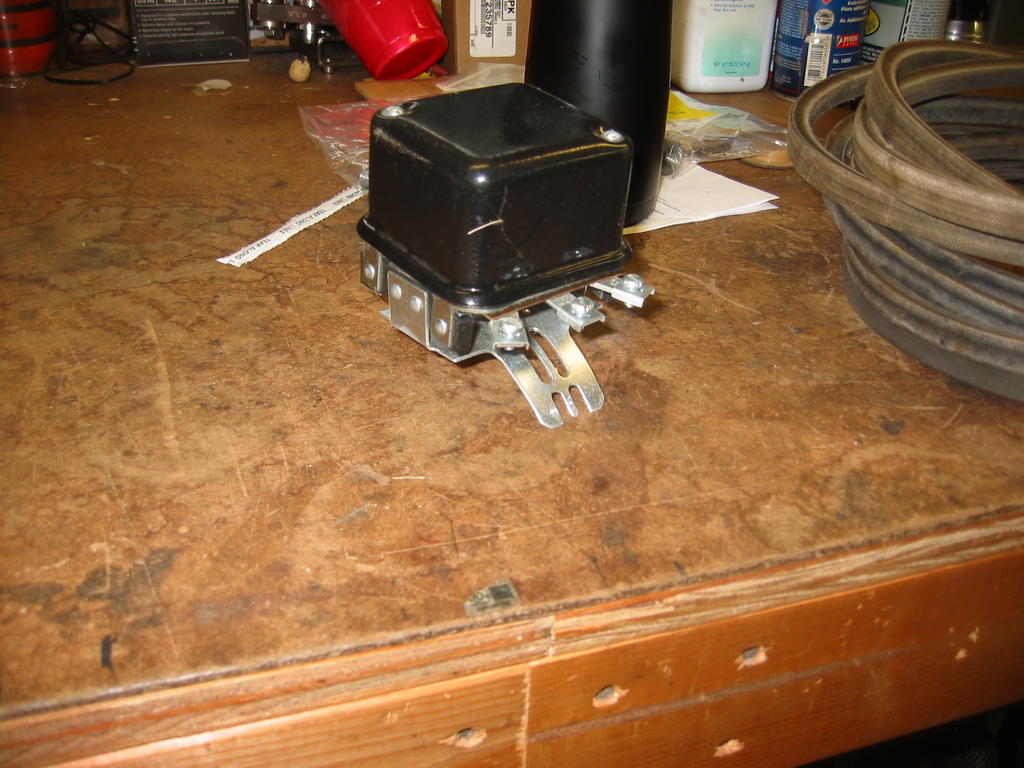

ebinmaine 81,223 #1109 Posted September 10, 2018 9 minutes ago, WHX20 said: You do realize you will have to go with a starter solenoid right EB? Also... Should this rig have a voltage regulator of some sort?? Share this post Link to post Share on other sites
pfrederi 21,336 #1110 Posted September 10, 2018 3 minutes ago, ebinmaine said: Also... Should this rig have a voltage regulator of some sort?? Yes you need a saddle mount regulator. 1 Share this post Link to post Share on other sites

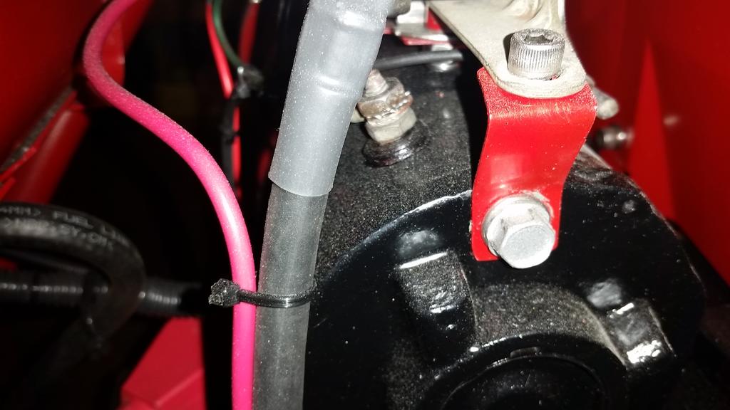

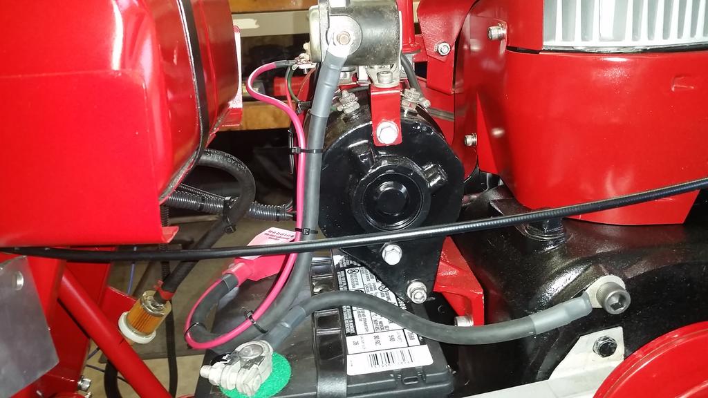

WHX?? 58,378 #1111 Posted September 10, 2018 (edited) No the SG reg will work just fine . I believe Richard @953 nut has a nifty wiring diagram for doing that conversion. My 1067 had this done by a PO years ago so I just left it as is when I restoed her and it works good. BTW those original 70 amp switches are still available and fairly cheap if you want to stay original. Some pics of my conversion. Custom made battery cables courtesy of @Achto Edited September 10, 2018 by WHX20 2 2 Share this post Link to post Share on other sites
pfrederi 21,336 #1112 Posted September 10, 2018 I didn't see a regulator on the genny in his picture.... 1 Share this post Link to post Share on other sites
WHX?? 58,378 #1113 Posted September 10, 2018 1 minute ago, pfrederi said: I didn't see a regulator on the genny in his picture.... Good eye Paul I missed that... Share this post Link to post Share on other sites
WHX?? 58,378 #1114 Posted September 10, 2018 By the way Dan @Achto that Gen light on at the last show was due to a loose connection on the back SG post. Star washers weren't enough to keep it tight. 2 Share this post Link to post Share on other sites
Achto 32,950 #1115 Posted September 10, 2018 2 minutes ago, WHX20 said: Gen light on at the last show was due to a loose connection on the back SG post. Star washers weren't enough to keep it tight. Easy fix then. 2 Share this post Link to post Share on other sites
WHX?? 58,378 #1116 Posted September 10, 2018 1 minute ago, Achto said: Easy fix then. Yepp Yepp... let us know if you need that reg EB got a to some dandies... 1 1 Share this post Link to post Share on other sites

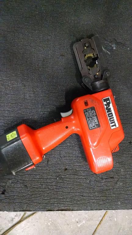

ebinmaine 81,223 #1117 Posted September 10, 2018 30 minutes ago, pfrederi said: I didn't see a regulator on the genny in his picture.... You are correct Paul ....for some reason there is no regulator on this tractor. The starter generator on this tractor is a different, darker color. Perhaps wherever it came from there was a regulator mounted remotely and it was just never installed. 14 minutes ago, WHX20 said: Yepp Yepp... let us know if you need that reg EB got a to some dandies... Should be all set Jim but thank you. Not looking to stay original on this particular tractor and having that much amperage go through an ignition switch has always kind of bugged me. I'm pretty sure I have at least one or two of those Regulators around from that big auction pile. I'll take a look at those diagrams from @953 nut. I'm pretty sure I saved them in my email somewhere. @Achto if you could do me and probably several others a huge tremendous and also large favor. I was just thinking yesterday that one of the skills I need to pick up with working on these tractors and other things is to be able to build a battery cable. I don't know if I have the tools or whatever but I need to learn how to install the lug ends appropriately. I've learned how to do the ignition wires thanks to @squonk And I've figured out how to make a nice watertight harness with a good quality crimper that I picked up because of somebody on this website. I forget who. My apologies to whoever that was. Next skill to learn... Great battery cables. How's about a short tutorial and what kind of crimper do I need? 1 Share this post Link to post Share on other sites

953 nut 70,542 #1120 Posted September 11, 2018 7 hours ago, ebinmaine said: I'll take a look at those diagrams from @953 nut. I'm pretty sure I saved them in my email somewhere. Here they are. 1 1 Share this post Link to post Share on other sites

Achto 32,950 #1122 Posted September 11, 2018 10 hours ago, WHX20 said: hey wasn't ther a president who once said walk softly and carry a big lunch bucket?!?!?!? Now Jim @WHX20 , employee theft is not nice. Having permission to use a nice Panduit cordless crimper with 6tons of pressure is quite nice though. The cable ends are fairly cheap, the tool to crimp them is not so cheap. 1 2 Share this post Link to post Share on other sites
