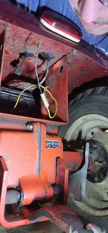

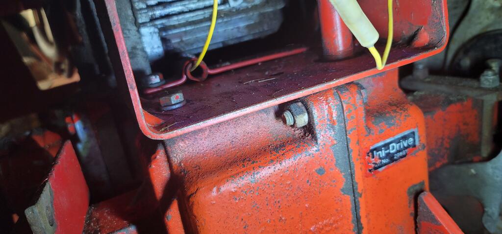

haydendavid380 759 #10609 Posted April 19, 2021 Getting ready to start tinkering with the hitch kit for the 160. I thought most hydros didn't have a tube for the cable, and wanted to double check that I didn't have one before I ordered on. I think I found one already on it but there's a wire running through it to the tail light. Shouldn't that be plugged into the connector next to the light in the seat pan? 1 Share this post Link to post Share on other sites

Jeff-C175 7,211 #10612 Posted April 19, 2021 6 minutes ago, haydendavid380 said: I think I found one already on it but there's a wire running through it to the tail light. Looks like the tube is there already on yours. But that wire shouldn't be there. Mine doesn't have the tube and it's a perfect fit for the fuel line from the tank, so instead of the lift cable tube which I don't need, when I put the new fuel lines in I ran it under that bracket as a 'clamp'. That wire looks 'newer' and someone thought it was a good idea to run it through the lift cable tube. Share this post Link to post Share on other sites

Lee1977 7,750 #10618 Posted April 19, 2021 1 hour ago, Jeff-C175 said: Looks like the tube is there already on yours. But that wire shouldn't be there. Mine doesn't have the tube and it's a perfect fit for the fuel line from the tank, so instead of the lift cable tube which I don't need, when I put the new fuel lines in I ran it under that bracket as a 'clamp'. That wire looks 'newer' and someone thought it was a good idea to run it through the lift cable tube. If the tube is there and never used it is most likely so rusted that it will destroy a new cable. The one on my 520-H was so rusted i could not get a cable through, I did get it to partially open up but decided it was too rusty to use. I ordered a new tube from Wheel Horse Part & More when I ordered the sleeve hitch for it. 2 Share this post Link to post Share on other sites
haydendavid380 759 #10619 Posted April 19, 2021 20 minutes ago, Lee1977 said: If the tube is there and never used it is most likely so rusted that it will destroy a new cable. The one on my 520-H was so rusted i could not get a cable through, I did get it to partially open up but decided it was too rusty to use. I ordered a new tube from Wheel Horse Part & More when I ordered the sleeve hitch for it. The wire and connector slide out through the tube no problem. I'm the third owner of this tractor from what I can ascertain. The original own took exceptionally good care. Complete maintenance records, and under the grime it's in wonderful shape. The last piece of dealer paperwork was dated in 2011. The guy I got it from said he got it from him and used it for a year and it sat in the barn for a year because the C-160 wasn't big enough. It appears he ran it hard and put it away wet. Caked thick field weeds and grass in every nook and crany. I believe what he said because there's no rot under all the grass. Once I get it off it looks like brand new paint underneath. The deck is crammed with grass, but solid as a rock. 3 Share this post Link to post Share on other sites

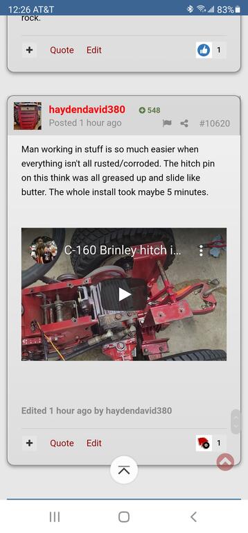

haydendavid380 759 #10620 Posted April 19, 2021 (edited) Man working in stuff is so much easier when everything isn't all rusted/corroded. The hitch pin on this think was all greased up and slide like butter. The whole install took maybe 5 minutes. Edited April 19, 2021 by haydendavid380 3 Share this post Link to post Share on other sites
redtruck 1 #10621 Posted April 19, 2021 21 minutes ago, haydendavid380 said: Her şey paslanmadığında / aşınmadığında, bir şeyler üzerinde çalışan adam çok daha kolay. Bu düşüncenin üzerindeki bağlantı pimi tamamen yağlanmış ve tereyağı gibi kaymış. Kurulumun tamamı belki 5 dakika sürdü. good luck to you Share this post Link to post Share on other sites
haydendavid380 759 #10622 Posted April 19, 2021 1 hour ago, redtruck said: good luck to you That's wierd, didn't look that way on my end Share this post Link to post Share on other sites
