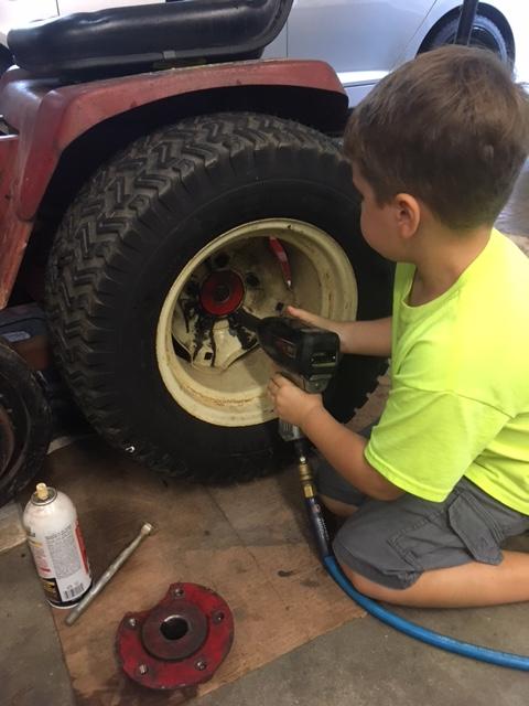

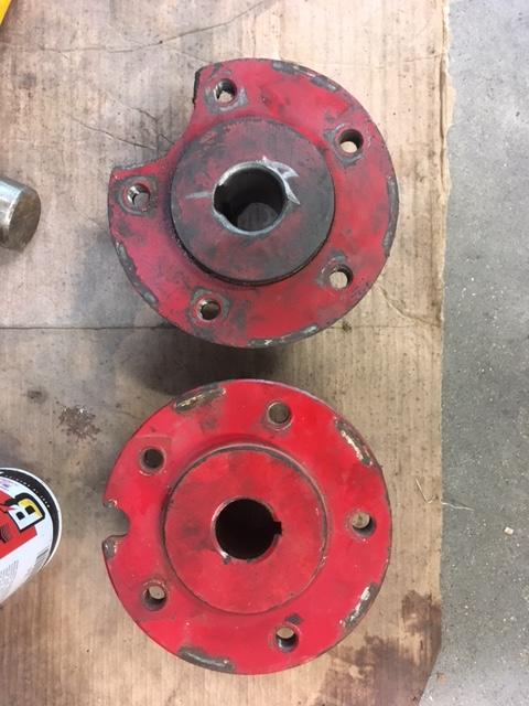

TonyToro 1,199 #1004 Posted August 14, 2018 Installed the hub on the Raider 12 from a terrific member. Thank you Shuboxlover. 2 3 Share this post Link to post Share on other sites
ebinmaine 81,223 #1005 Posted August 14, 2018 @TonyToro You look a little younger than I expected... 5 Share this post Link to post Share on other sites
TonyToro 1,199 #1006 Posted August 14, 2018 1 minute ago, ebinmaine said: @TonyToro You look a little younger than I expected... Lol That is the owner and driver of that high performance pulling machine. He broke it, he had to fix it. 4 1 Share this post Link to post Share on other sites
ebinmaine 81,223 #1007 Posted August 14, 2018 2 minutes ago, TonyToro said: Lol That is the owner and driver of that high performance pulling machine. He broke it, he had to fix it. Ooooo..... I LOVE that !!! That's fantastic. Fair is fair. Teach them young. You want to play with big toys? Yes! Absolutely. And you can fix them too. 3 Share this post Link to post Share on other sites

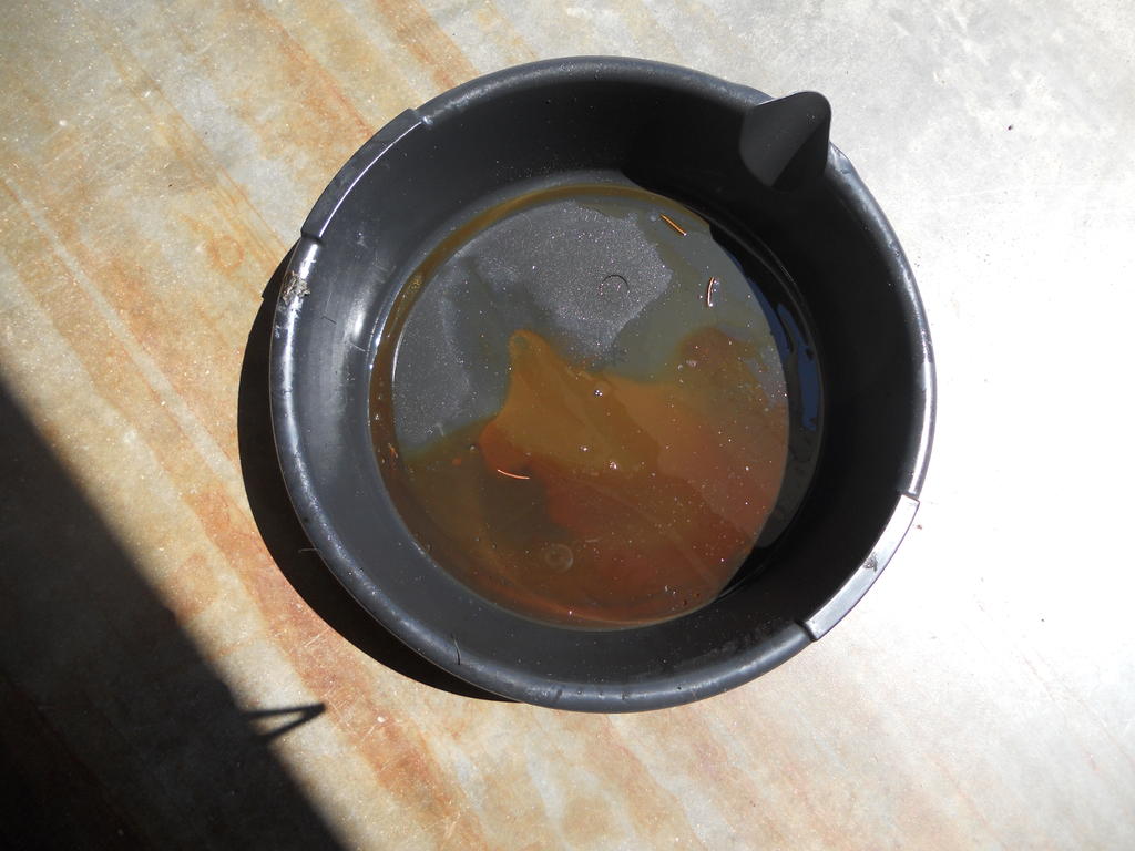

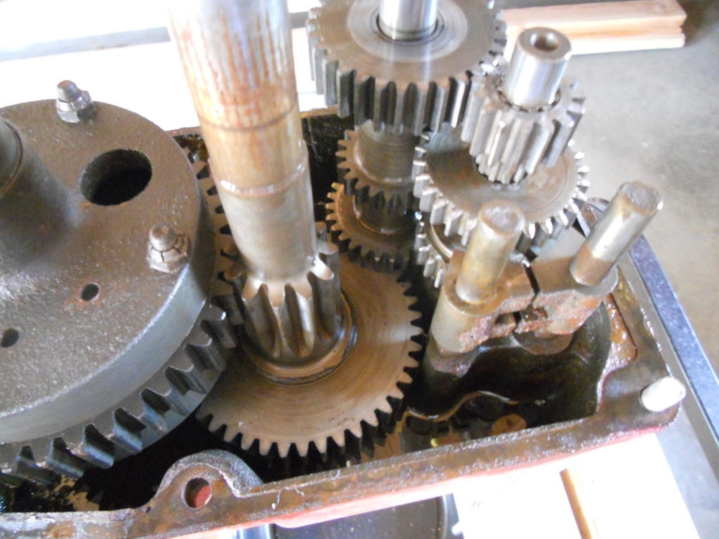

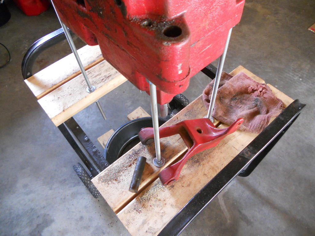

Racinbob 13,286 #1008 Posted August 14, 2018 (edited) I was 'forced' to wait until this coming Monday to get a dumpster set in the drive for my next major remodel so I decided to see if I could get the transmission opened up on the 854 I picked up at the show. For the past month I've been soaking the hitch pin and brake drum. The brake drum was missing the retaining clip but was seized so bad it didn't need it. It fought me bad the entire way off the shaft but I finally got it. For the first time ever I gave up on the hitch pin and cut it off. Fortunately it was seized on the hitch more that the case. The remains of the pin drove out fairly easy. When I drained this it only had, at the most, about 1/4 cup of sludgy oil in it. I feared the worse for what I'd find but my fears didn't come true. It was in great condition including the inner teeth on the 3523 gear and all the bearings. There was in/out play on the input shaft when the shifter was in the 3rd gear detents so I shimmed it to eliminate that. It had the first style shift rails so I replaced them with a second generation set with the flats to help with the suction thing. I didn't have a set of the newer style with the deeper neutral detent so I decided to settle with what I had. I but I want to get new case bolts. The ones I took out are pretty cruddy. Edited August 19, 2018 by Racinbob 1 6 1 Share this post Link to post Share on other sites

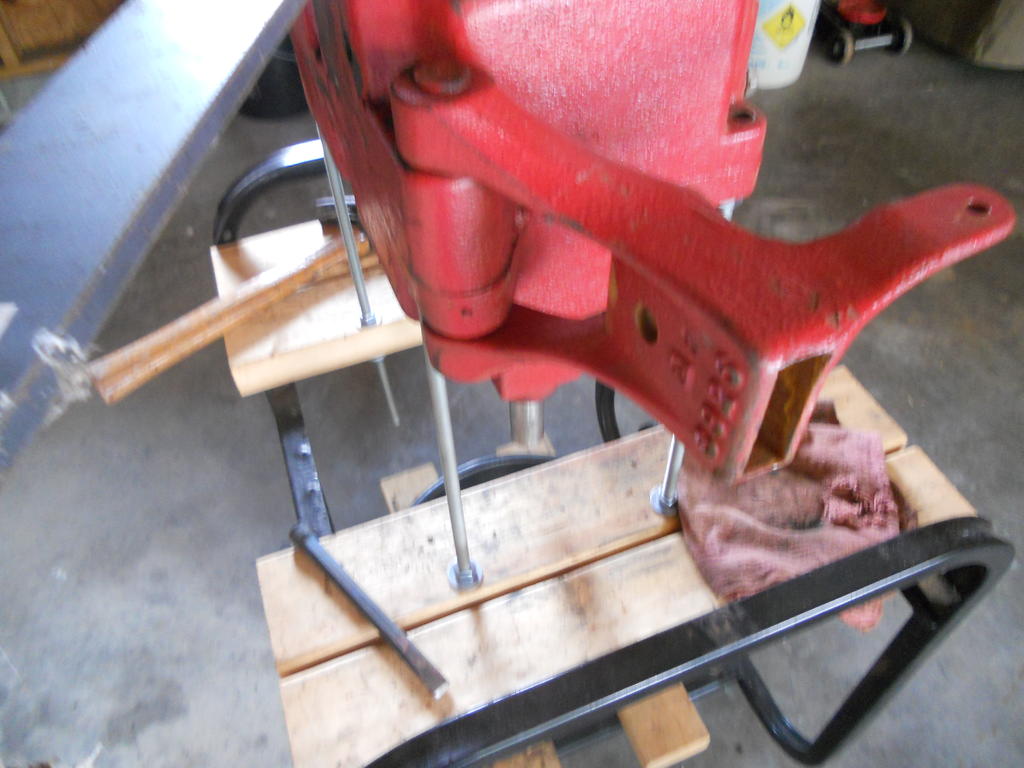

ebinmaine 81,223 #1011 Posted August 14, 2018 2 minutes ago, WHX20 said: on the tranny stand! I'll second that @Racinbob I'm curious to know what you used for Hardware to set that up? Share this post Link to post Share on other sites
Racinbob 13,286 #1012 Posted August 14, 2018 26 minutes ago, WHX20 said: Usually a leaky seal will keep that from happening. Yup, but this is all that came out when I drained it a couple weeks ago. Nothing to leak. This machine has been neglected terribly. I found several things before I bought it and many more after I got her home. Rest assured I'll get her nursed back to good health. 26 minutes ago, ebinmaine said: I'm curious to know what you used for Hardware to set that up? Pretty simple. 3/8" rod and nuts. The cart is an old generator frame. I simply laid out for the four holes using a gasket. I adjust the nuts up to clear the rod when scraping the old gasket and down to let the rod protrude to hold the new gasket in place. 5 Share this post Link to post Share on other sites

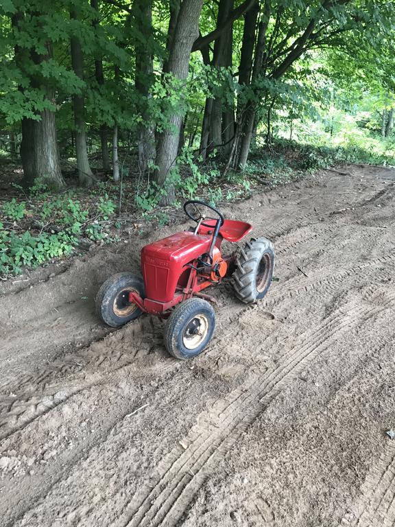

Tach-a-matic 357 #1019 Posted August 17, 2018 the ground is soft so tried this and it worked okay . 2 Share this post Link to post Share on other sites

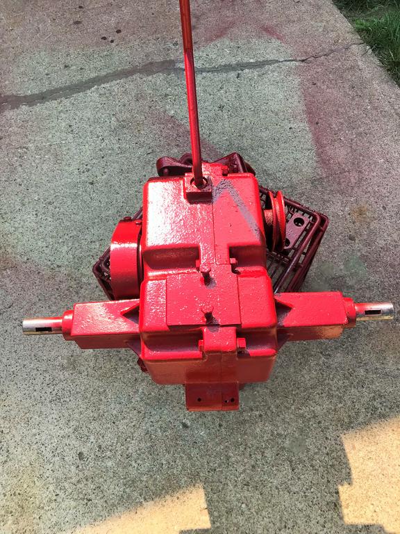

ohiofarmer 3,537 #1020 Posted August 18, 2018 Got the Raider 10 put back together after removing the transmission to replace the broken dog point screw for the shifter. Having a table lift that raises to 42" really helps the knees. Changed out the gear oil while I was at it. R&R'd the deck and the luxury of standing beside it during assembly brings a smile to an old man's face. That rig is a little tank! No mower I ever had will take down the tall grass like that little machine. I went to load it up on the trailer and the truck died after going only ten feet. Some sort of sensor for the turbo. I am gonna drive the tractor two miles to mow the tall mess of grass tomorrow. Finally a rain free day coming.. Gonna take the mother of all leaf blowers to manage the waste grass blowing it to the tree line. Wish me luck. 3 Share this post Link to post Share on other sites

squonk 48,409 #1022 Posted August 18, 2018 19 hours ago, Tach-a-matic said: the ground is soft so tried this and it worked okay Somewhere a soccer mom is chasing you for stealing her flower bed edging and exercise equipment. . 1 4 Share this post Link to post Share on other sites

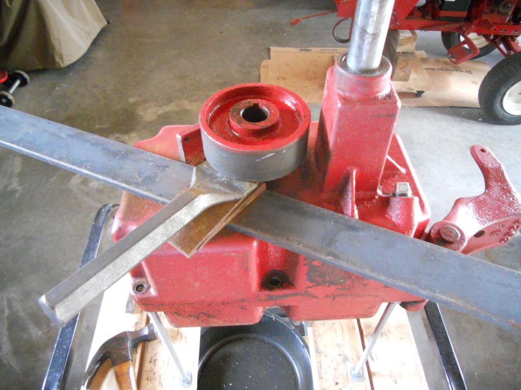

953 nut 70,542 #1023 Posted August 18, 2018 On 8/14/2018 at 3:56 PM, Racinbob said: The brake drum was missing the retaining clip but was seized so bad it didn't need it. It fought me bad the entire way off the shaft but I finally got it. I had this problem and found that a couple of "Pickle Forks" and a BFH tool will get the job done. PS, love the transmission repair stand too. 4 2 Share this post Link to post Share on other sites
