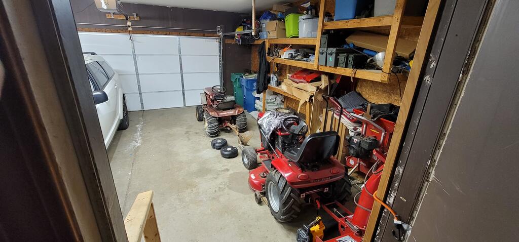

ashtonosborne2019 18 #9851 Posted March 21, 2021 1 hour ago, haydendavid380 said: My work bench was a little cluttered and a cluttered bench makes it difficult to work on horses. Wife said I might as well clean and organize the garage. Spent the afternoon on the garage and my bench now has more stuff on it than when I started. I'm convinced I can squeeze another tractor in there now though, so the jokes on her 🤣 there will always be space for more horses in the garage 1 Share this post Link to post Share on other sites

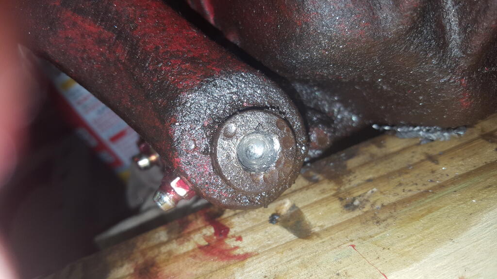

Gregor 4,848 #9866 Posted March 21, 2021 (edited) I drilled, tapped, and installed 4 grease zerks. I also drilled a center hole in the shaft. I hit it with my air hammer every now and then. All I have for heat is a butane torch with MAPP gas. I really don't think it will get anything hot enough to make a difference, so I haven't tried it. If I don't get anywhere this way, out comes the sawzall. Edited March 21, 2021 by Gregor 2 Share this post Link to post Share on other sites

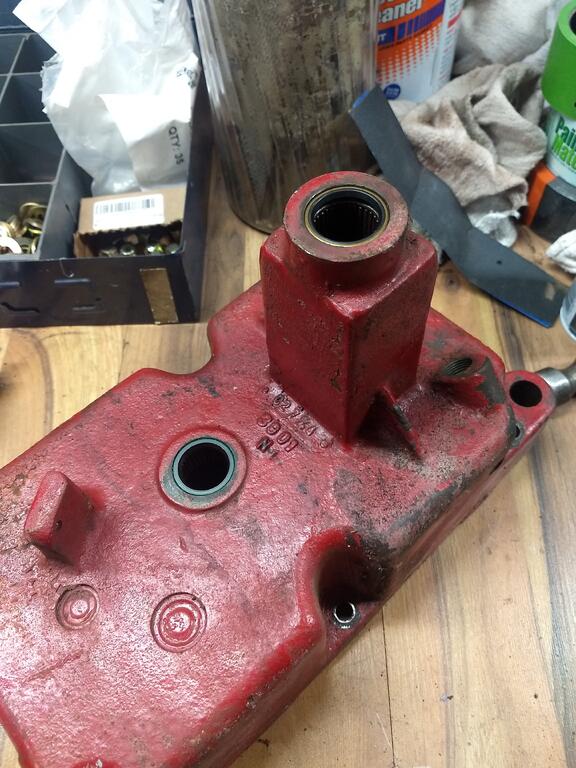

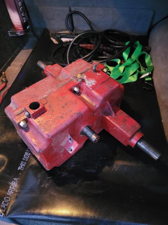

ebinmaine 79,761 #9870 Posted March 21, 2021 Had some adventures putting together a transmission for/with @OldWorkHorse Steve today. We were rebuilding one good 3 speed from two transmissions that both needed different things. Transferred some bearings and added new seals. The adventures part was when we went to install the 11/44 gear. A PO with a welder and not quite enough machining experience had done a repair on the casting around the bearing that holds that gear. It looked good to both of us from the plain eye and felt "ok" ish. After installing the hoobie doobie balls and a couple other gears we discovered that the bearing was almost round. Well. @#$/&#(@). Fine then. So we commenced to cleaning up the other half a transmission and removed/reinstalled the bearings. Again. Steve has a new bearing installer. Wicked handy tool!!! Well we got the whole thing put together despite ourselves and off he went with a decent complete 3 speed. 3 6 1 Share this post Link to post Share on other sites
OldWorkHorse 3,156 #9871 Posted March 21, 2021 @ebinmaine thank you again! Was fun and after all that I'm a transmission expert lol! But glad she's all back together and good for another 50+ years hopfuly! Can't wait to install it probly tomorrow my horse tinkering hours are up for today. 🍻 2 1 Share this post Link to post Share on other sites

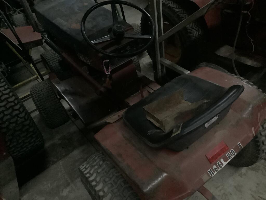

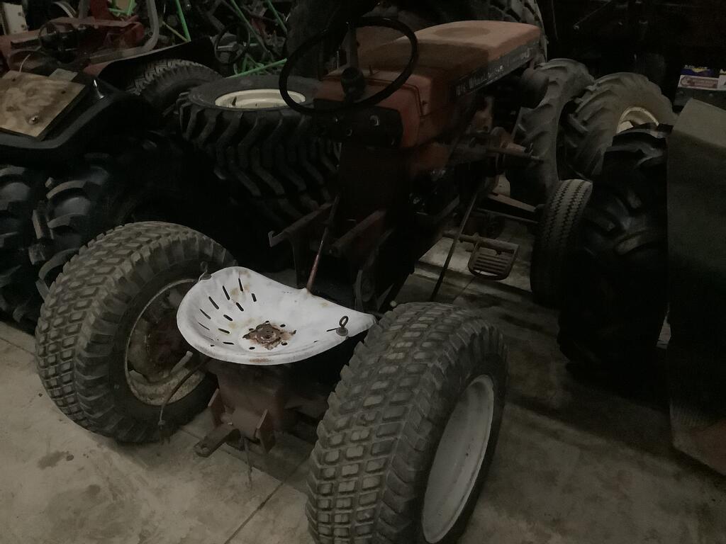

Pullstart 70,821 #9875 Posted March 22, 2021 Other than a bit of clean up with the loader tractor, I just did organizing, classified ads and project parts prep/finding. “Screamin Jimmy” might not need the second pedal any more (until Rylee’s kids are ready to learn some day!) so I found a spare floorboard and a battery box as the one one the tractor is beat up. I have totes from the 2019 Big Show I haven’t gone through completely so figured I’d clean up shop a bit. I Horse traded Rylee for “Filly” the 1076 a while back, then helped a fellow member with the transmission out of it. A three speed is bolted to it for roll around purpose. That white seat makes me think future lowrider project! Funny thing, this is another transmission from a Commando 800 and the axle shafts are extremely wide! 5 1 1 Share this post Link to post Share on other sites
