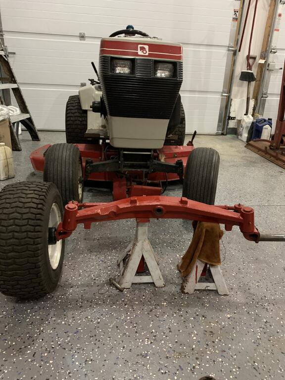

Tach-a-matic 357 #9756 Posted March 16, 2021 This evening I took the plastic pan off the C-125 in preparation for a metal one checked hydro fluid and it looks brand new woo-hoo! 6 out of 8 holes line up will have to enlarge these two right ones to make it work. Nothing is bent that I can tell and put on a new deck drive belt 7 1 Share this post Link to post Share on other sites
cleat 9,342 #9757 Posted March 16, 2021 Hole issue is no big deal, just give it a push over and the holes should line up good enough. The bracket underneath is a big U shape so it moves pretty easy. 3 1 1 Share this post Link to post Share on other sites
Tach-a-matic 357 #9758 Posted March 16, 2021 will try moving the bracket first! 1 Share this post Link to post Share on other sites
WVHillbilly520H 10,379 #9759 Posted March 16, 2021 10 minutes ago, Tach-a-matic said: will try moving the bracket first! Only finger tight until you get all 4 started. 2 Share this post Link to post Share on other sites

Horse Newbie 7,405 #9763 Posted March 16, 2021 49 minutes ago, Tach-a-matic said: will have to enlarge these two right ones to make it work. Mine on my 520H were sorta like that... I used a scratch awl to align one hole, then started the bolt in the other...didn't have to enlarge the holes... 3 Share this post Link to post Share on other sites

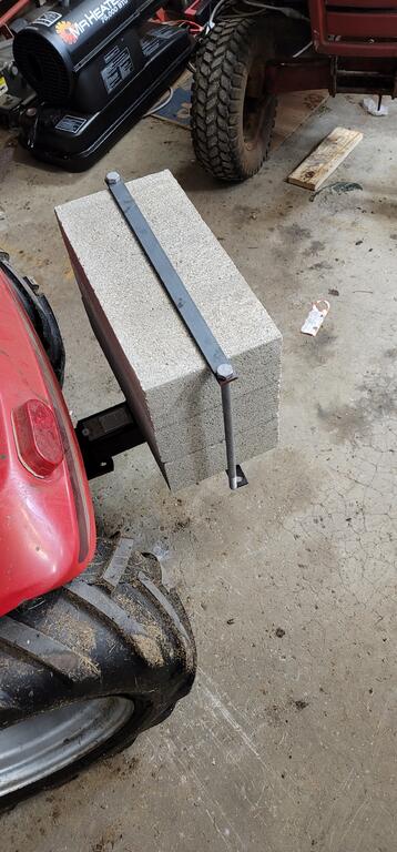

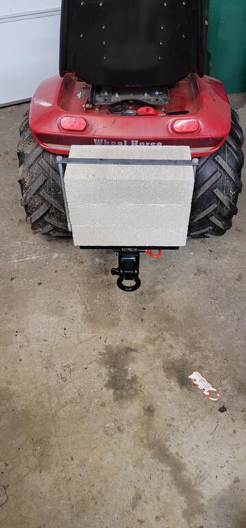

haydendavid380 759 #9764 Posted March 16, 2021 Working on some front weight for the B80 to do some plowing. Sticking it on the front with this 4 2 Share this post Link to post Share on other sites
Jeff-C175 7,211 #9765 Posted March 16, 2021 (edited) 1 hour ago, Tach-a-matic said: have to enlarge these two right ones to make it work You should be able to flex the brackets far enough to line up the holes. Posted before seeing others said it first, sorry! Edited March 16, 2021 by Jeff-C175 2 Share this post Link to post Share on other sites

ebinmaine 80,767 #9767 Posted March 16, 2021 6 hours ago, haydendavid380 said: Working on some front weight for the B80 to do some plowing If you have a gravel drive use roller chains. Works wonders. I put about 85 to 90 lbs on Trina's 867 Pigpen's front end this year. Works just about right. Share this post Link to post Share on other sites
