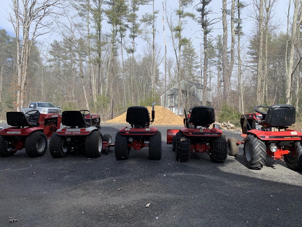

Raposo 532 #9728 Posted March 15, 2021 Lined up a couple of them left to right - M20, Briggs 18 twin, M16, Command 15, M12 1 8 Share this post Link to post Share on other sites

ebinmaine 80,091 #9730 Posted March 15, 2021 16 minutes ago, Raposo said: Lined up a couple of them left to right - M20, Briggs 18 twin, M16, Command 15, M12 What series of tractor is that M20 in? Share this post Link to post Share on other sites
Raposo 532 #9731 Posted March 15, 2021 Just now, ebinmaine said: What series of tractor is that M20 in? It’s a C175 that had a series 1 in it that went bad and now has a magnum 20, she sounds sexy! 1 2 Share this post Link to post Share on other sites
ebinmaine 80,091 #9732 Posted March 15, 2021 3 minutes ago, Raposo said: It’s a C175 that had a series 1 in it that went bad and now has a magnum 20, she sounds sexy! I'll bet!! I'd love to see more pictures and information on that one. That's got to be a rugged bugger with that engine in there. @JCM Jim is pretty fond of his big Kohler twins too. 1 Share this post Link to post Share on other sites

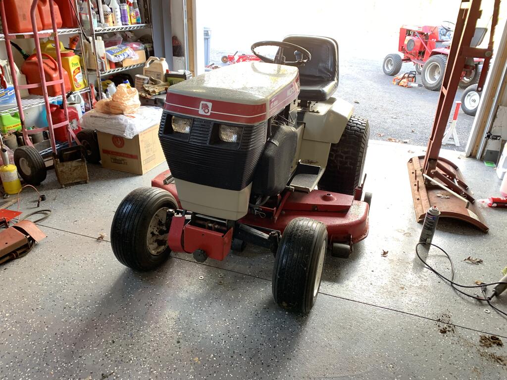

kpthorsefan 34 #9733 Posted March 15, 2021 Got the C-141 out, not seen the light of day for about 6 years took the cover off and a quick wipe. 4 10 1 3 Share this post Link to post Share on other sites

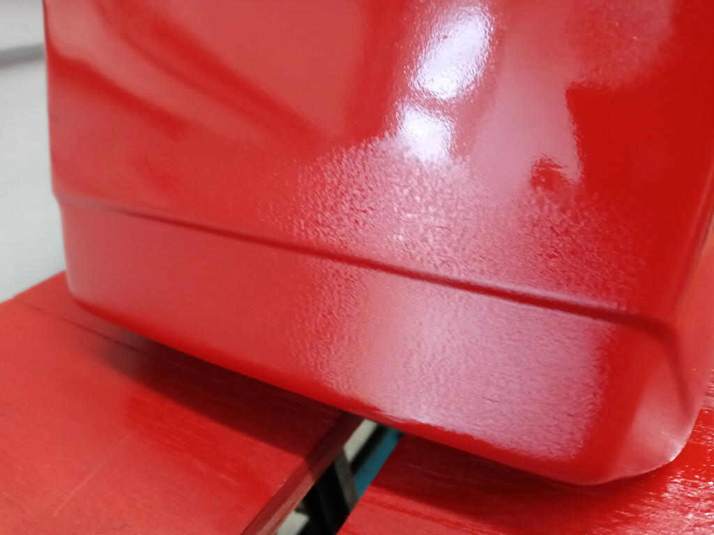

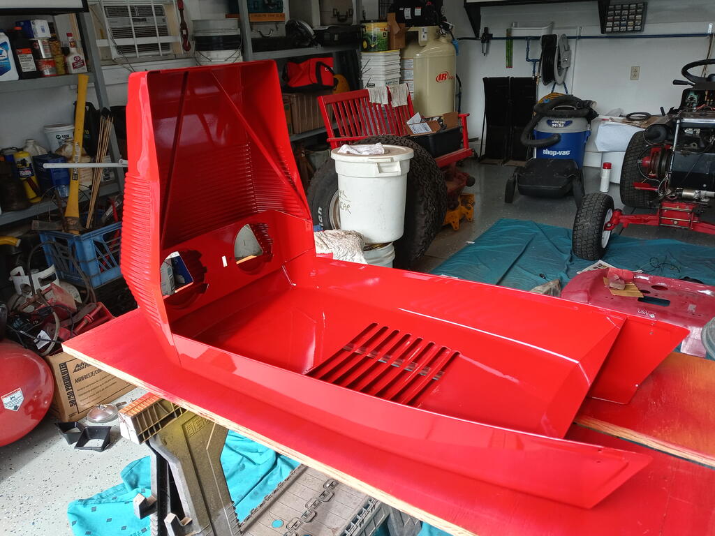

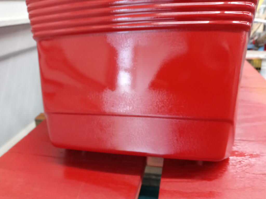

Horse Newbie 7,405 #9739 Posted March 15, 2021 So before I put on my new decals from @Vinylguy I decided to paint my hood and seat pan Rustoleum Regal Red... The under side of the hood turned out great, but I got some "cracking" on the outside of the hood. Can someone take a look at these pics and tell me what may have caused it ? I want to avoid it happening on the seat pan if I can. Thanks, Tim (Horse Newbie) 1 Share this post Link to post Share on other sites
76c12091520h 4,282 #9740 Posted March 15, 2021 The dreaded Rust-Oleum paint problems, nothing you can do now but take it all off and start over. As far as preventing it from happening again, use only Rust Oleum paint and undercoats, and do not allow the initial coats of color to sit too long before applying the next coats. I've used that stuff on and off for over 35 years with mixed results and no rhyme or reason to the problems that pop up using it ( and I paint cars for a living so I have a little bit of an idea what I'm doing). Maybe if you can tell us EXACTLY what steps you took and every product you used up to this point, somebody can shed some light on it. 4 Share this post Link to post Share on other sites
Jeff-C175 7,209 #9741 Posted March 15, 2021 21 minutes ago, Horse Newbie said: Can someone take a look at these pics and tell me what may have caused it ? I've always presumed that I didn't wait long enough between coats for the previous coat to fully cure. Did you do a second coat? I've had it happen too many times to me also. I've found that going to very thin first coat and waiting a week before the second coat has better results. 1 Share this post Link to post Share on other sites
Jeff-C175 7,209 #9742 Posted March 15, 2021 (edited) 19 minutes ago, 76c12091520h said: do not allow the initial coats of color to sit too long before applying the next coats @Horse Newbie I just looked at the 'structions on the can. "Apply a second coat, or Clear coat, within 1 hour, or after 48 hours" Even if it's 'dry to the touch', it's not cured enough that the solvents in subsequent coats will not 'attack' the previous coats. And... in cooler weather, you need to wait even longer! You might not have to take it all off though. I would let it sit for a week, even maybe set it out in the sun for a day or two, then try wet sanding to smooth it all out. Then wait some more... then spray LIGHT coats within minutes of each other. Don't wait long enough for the surface to 'flash'. Edited March 15, 2021 by Jeff-C175 4 Share this post Link to post Share on other sites
WVHillbilly520H 10,379 #9743 Posted March 15, 2021 (edited) @Horse Newbie, to me it looks like the paint (or one of it's ingredients) had a reaction to the the base layer, enamel over lacquer or vise versa, and/or the panel temperature (setting in the sun?) while spraying it, I know the Majic brand from TSC is really bad for that waiting too long between coats on the 44" 2stage I did several years ago, the 414 I did last summer I used ACE hardware brand spraybombs. Edited March 15, 2021 by WVHillbilly520H 2 Share this post Link to post Share on other sites
WVHillbilly520H 10,379 #9744 Posted March 15, 2021 1 minute ago, Jeff-C175 said: @Horse Newbie I just looked at the 'structions on the can. "Apply a second coat, or Clear coat, within 1 hour, or after 48 hours" Even if it's 'dry to the touch', it's not cured enough that the solvents in subsequent coats will not 'attack' the previous coats. And... in cooler weather, you need to wait even longer! ... 1 Share this post Link to post Share on other sites
953 nut 68,180 #9745 Posted March 15, 2021 44 minutes ago, Horse Newbie said: Can someone take a look at these pics and tell me what may have caused it ? With most spray products the second coat needs to be applied within one hour OR after 48 hours at ideal conditions as called out on the container. The wrinkling could be from some contamination (oil, grease residue or even the oils on your hands). Also, it is not a good idea to spray paint both sides of the same item at once. The evaporation of VOCs will cool the metal and may generate problems. 4 Share this post Link to post Share on other sites
Horse Newbie 7,405 #9746 Posted March 15, 2021 35 minutes ago, 76c12091520h said: Maybe if you can tell us EXACTLY what steps you took and every product you used up to this point, somebody can shed some light on it. I sanded the original paint with 800 grit paper...wiped it down with a clean, soft lent free pair of old undies(just kidding) cloth, blew it off with compressed air, and painted... Wonder if the compressed air had oil in it...I do have a filter/ drier in my air system. Or maybe chemical residue from decal removal attempts ???? 1 Share this post Link to post Share on other sites
Horse Newbie 7,405 #9747 Posted March 15, 2021 29 minutes ago, Jeff-C175 said: I've always presumed that I didn't wait long enough between coats for the previous coat to fully cure. Did you do a second coat? I've had it happen too many times to me also. I've found that going to very thin first coat and waiting a week before the second coat has better results. No, first coat...started by barely misting the surface until it started getting red, then painted as I did the underside of the hood, and that turned out good... The part that "cracked" was a different can though... Share this post Link to post Share on other sites
Horse Newbie 7,405 #9748 Posted March 15, 2021 24 minutes ago, Jeff-C175 said: @Horse Newbie I just looked at the 'structions on the can. "Apply a second coat, or Clear coat, within 1 hour, or after 48 hours" Even if it's 'dry to the touch', it's not cured enough that the solvents in subsequent coats will not 'attack' the previous coats. And... in cooler weather, you need to wait even longer! You might not have to take it all off though. I would let it sit for a week, even maybe set it out in the sun for a day or two, then try wet sanding to smooth it all out. Then wait some more... then spray LIGHT coats within minutes of each other. Don't wait long enough for the surface to 'flash'. This was the first coat...bummed me out ! Share this post Link to post Share on other sites
Jeff-C175 7,209 #9749 Posted March 15, 2021 Just now, Horse Newbie said: This was the first coat I don't think I've ever had the crackling happen on a first coat so I'm as poozzled as you are! Did you wipe down with denatured alcohol to remove any residual hand oils or anything? 2 Share this post Link to post Share on other sites
Horse Newbie 7,405 #9750 Posted March 15, 2021 29 minutes ago, WVHillbilly520H said: @Horse Newbie, to me it looks like the paint (or one of it's ingredients) had a reaction to the the base layer, enamel over lacquer or vise versa, and/or the panel temperature (setting in the sun?) while spraying it, I know the Majic brand from TSC is really bad for that waiting too long between coats on the 44" 2stage I did several years ago, the 414 I did last summer I used ACE hardware brand spraybombs. Hood not sitting in sun...do you know whether the original paint was lacquer or enamel ? Share this post Link to post Share on other sites
