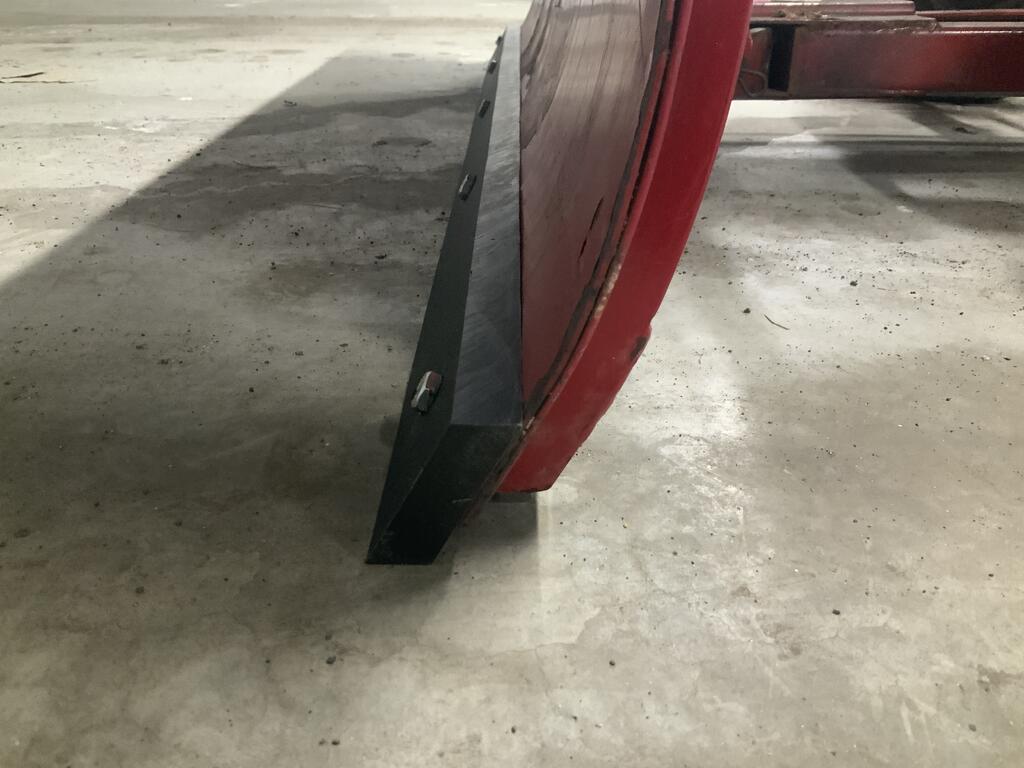

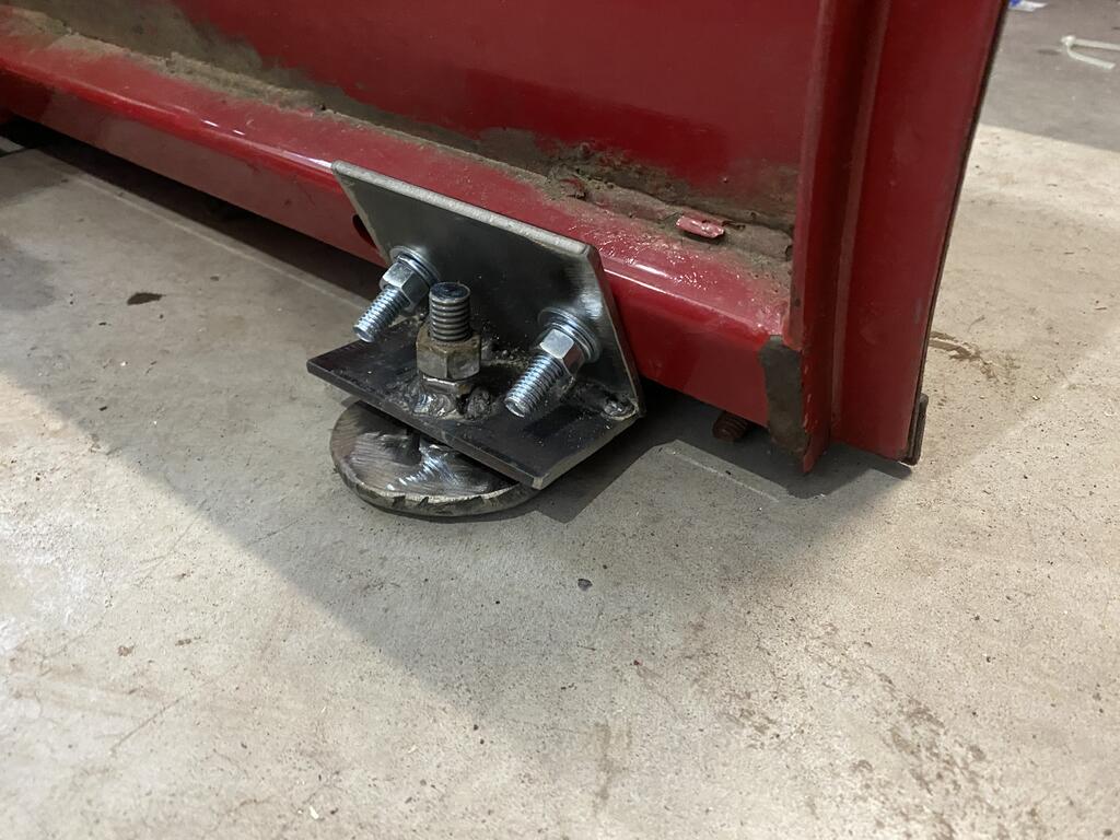

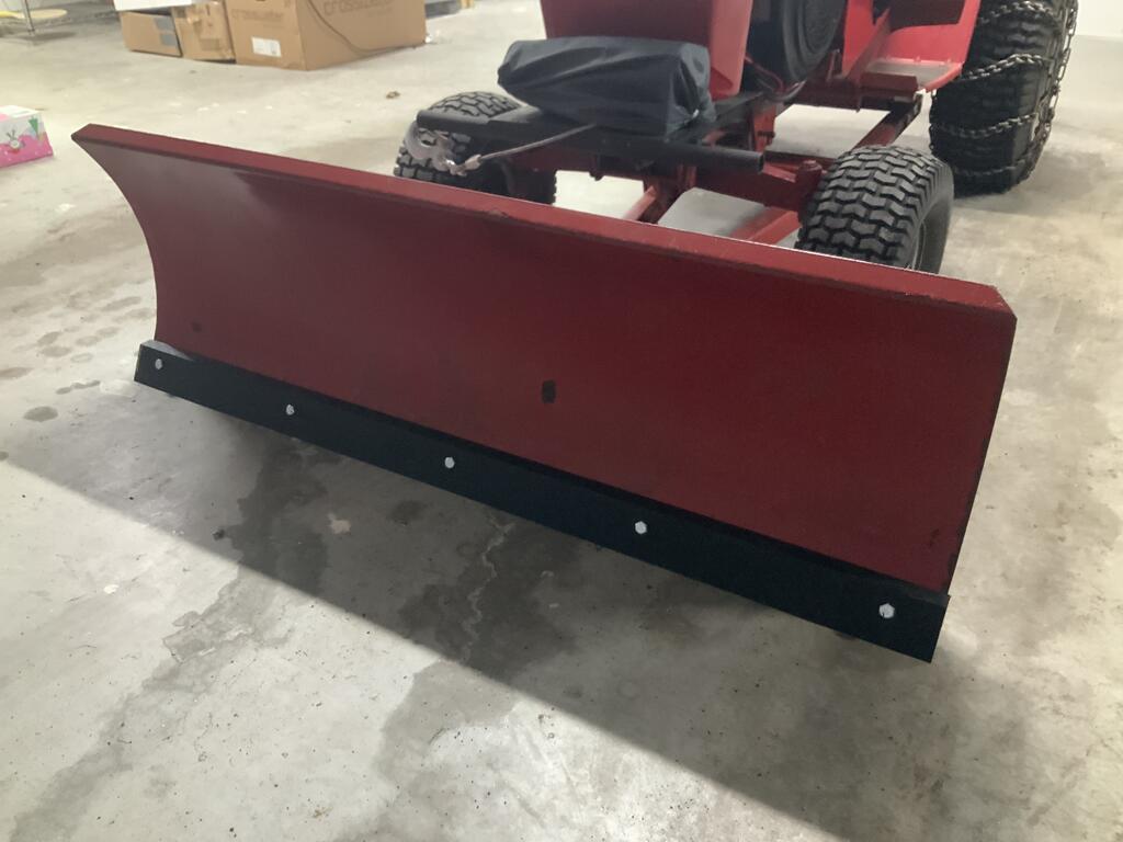

BeninCT 451 #9327 Posted February 17, 2021 On 2/15/2021 at 7:40 PM, cschannuth said: Put a plastic wear bar on that dude and drop the blade all the way down on the asphalt so it cleans off the snow completely. You can set the feet so that they will stop your blade from going too low and damaging your driveway when the plastic wear bar eventually wears away. Thanks for the kick in the pants. I realized today that I had half a sheet of 3/4 King Starboard (PE plastic sheet) in my shop and literally 20 mins later I had this. Will try it out tomorrow I think. 4 3 Share this post Link to post Share on other sites
ebinmaine 80,856 #9328 Posted February 17, 2021 13 minutes ago, BeninCT said: 3/4 King Starboard Oh man That stuff is AWESOME 1 Share this post Link to post Share on other sites

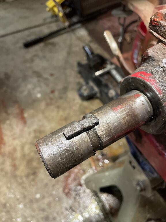

ebinmaine 80,856 #9329 Posted February 18, 2021 1 hour ago, MichiganCO said: I’m having a issue with it. It’s a c-100 8 speed 10HP. Placed in high range and then shift into 2nd and 3rd gear it seems to be as slow as 1st gear. Yesterday it was running amazing and today it’s slow and barely can move Have you before that the hub keys are all whole? I'm wondering if you have sheered a key. Does the engine run the same all the time? Share this post Link to post Share on other sites
BeninCT 451 #9330 Posted February 18, 2021 20 minutes ago, ebinmaine said: Oh man That stuff is AWESOME And expensive. I think the 4x8 sheet was $380 2 year ago and I only needed half. will be fun to see how it goes. Roughly made plow feet for sale.... 3 1 Share this post Link to post Share on other sites
MichiganCO 4 #9331 Posted February 18, 2021 Engine is running smooth and no changes. I’ve read couple posts about key being sheared just can’t seem to find it on the hub. Maybe I don’t no what I’m looking for honestly Share this post Link to post Share on other sites
ebinmaine 80,856 #9332 Posted February 18, 2021 17 minutes ago, MichiganCO said: Engine is running smooth and no changes. I’ve read couple posts about key being sheared just can’t seem to find it on the hub. Maybe I don’t no what I’m looking for honestly Inside the hub. It's what keeps it rolling with the axle. Share this post Link to post Share on other sites
MichiganCO 4 #9333 Posted February 18, 2021 Ok so basically take the wheel off and the hub to see if the key has been sheared. Share this post Link to post Share on other sites
cschannuth 3,821 #9334 Posted February 18, 2021 2 hours ago, BeninCT said: Thanks for the kick in the pants. I realized today that I had half a sheet of 3/4 King Starboard (PE plastic sheet) in my shop and literally 20 mins later I had this. Will try it out tomorrow I think. Awesome! 3 1 Share this post Link to post Share on other sites
MichiganCO 4 #9335 Posted February 18, 2021 Woodruff looks great but the set screw was loose. Could the set screw really be the factor Share this post Link to post Share on other sites
Jeff-C175 7,211 #9336 Posted February 18, 2021 (edited) 15 minutes ago, MichiganCO said: looks great That key looks pretty well hammered in my eyes! What's the inside of the hub look like? That groove was from the set screw wearing it down, I don't think that's supposed to be there. It could be previous damage too. I could never get those setscrews tight enough with a combo wrench, had to purchase an 8 point socket to get about 30 ft lb of torque on the screw. Newer hubs have two set screws. Edited February 18, 2021 by Jeff-C175 3 Share this post Link to post Share on other sites
MichiganCO 4 #9337 Posted February 18, 2021 When I examined the wheel I could see the key. From the outside of the wheel. Share this post Link to post Share on other sites

ebinmaine 80,856 #9339 Posted February 18, 2021 5 hours ago, MichiganCO said: When I examined the wheel I could see the key. From the outside of the wheel. Yeah that's not normal for sure. What's the inside of the hub look like? Share this post Link to post Share on other sites
haydendavid380 759 #9340 Posted February 18, 2021 9 hours ago, BeninCT said: And expensive. I think the 4x8 sheet was $380 2 year ago and I only needed half. will be fun to see how it goes. Roughly made plow feet for sale.... I was going to say, if a foot of it for my couple ducers was like $60. You must be rich to have a sheet! 1 Share this post Link to post Share on other sites

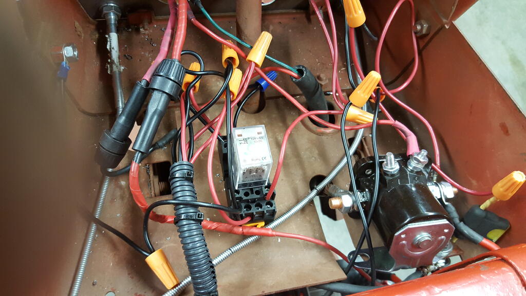

Pullstart 71,350 #9342 Posted February 18, 2021 On 2/12/2021 at 7:08 PM, Gregor said: I couldn't find the DPDT switch I wanted, so I installed a 4PDT relay. I am controlling the relay with an on/off push button switch. The push button switch is mounted in front of the PTO pedal. Tap the pedal, the plow comes up. tap it again, the plow goes down. Again, it aint purdy, but it works. This is 4 pages back already so it might have been brought up in the meantime... but great idea! I’d love to see a video in action, or more pictures to show the process! On 2/13/2021 at 1:29 AM, tom2p said: I've read this - and it might be true in some situations but I've personally never found it to be true - the wider tire always provided better traction in the snow for me trucks with a snow plow plowing snow SUVs with loaded trailer on snow quads on snow motorcycles on snow (without spikes - not fun) same thing here. 4 pages old. I’m behind! My most favorite snow tires for my many plow trucks I’be had, have been 235/85-16 Cooper Discovery tall and skinny. Those compared to say a 265/75-16? 235’s all day long! I have 4 chains to fit them, and they became unstoppable! I could plow in 2wd, where I normally couldn’t go in 4wd! 1 Share this post Link to post Share on other sites

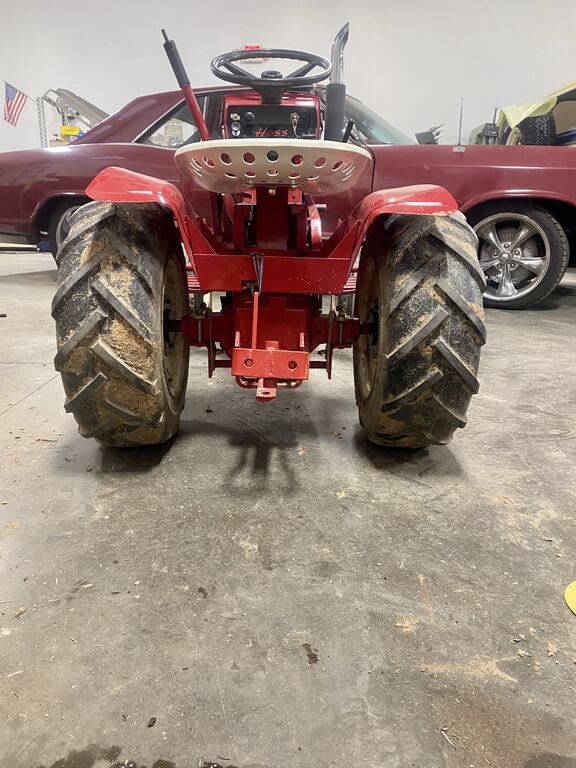

Pullstart 71,350 #9343 Posted February 18, 2021 On 2/15/2021 at 4:11 PM, Greentored said: I recently learned about different rear wheel offsets and now realize why the rear track width on Hoss was so wide. Quick (probably permanent ha) fix- flipped the hubs. Gonna need to switch to the smaller 5/8” lugs to clear one set screw, but otherwise think it’ll be fine. Track width is much better, Hoss looks better, and oughtta sit in the furrow and line the plow up better too. Anyone else tried this? I’ve still got some pages of catch up to do, but @953 nut put Hot Wheels together with hubs inside out I believe. I’m not sure what hubs they are, they are 5 lug and 953’s came 4 lug. I haven’t ever removed them, but they occasionally walk out and need a correction, but he built it for a show cruiser and I tend to work it on occasion! On the picture with the plow, you can see where the tire starts to get the paint a little warm on the back of the fender. That’s my indication that I need to move the hub back out or get out of the furrows! 1 1 Share this post Link to post Share on other sites
Greentored 3,221 #9344 Posted February 18, 2021 16 minutes ago, pullstart said: I’ve still got some pages of catch up to do, but @953 nut put Hot Wheels together with hubs inside out I believe. I’m not sure what hubs they are, they are 5 lug and 953’s came 4 lug. I haven’t ever removed them, but they occasionally walk out and need a correction, but he built it for a show cruiser and I tend to work it on occasion! On the picture with the plow, you can see where the tire starts to get the paint a little warm on the back of the fender. That’s my indication that I need to move the hub back out or get out of the furrows! Good to hear! I had room to just move the hubs in, but the set screws would not be on top of the center of the key- didnt think that was a good idea. I also had a small concern about not having that center 'step' to locate the wheel, but hoping as long as the lugs stay snug it will be ok. 1 Share this post Link to post Share on other sites

Greentored 3,221 #9347 Posted February 18, 2021 9 minutes ago, pullstart said: We’re not driving on the highway... most of the time. I have a feeling the lug nuts or bolts will do a dandy job holding the wheel on! Side note, reading about LS swaps with older GM transmissions. Only 5 of the 6 bell housing bolts (10mm thread) fit, some people only run the side 4 for some reason... but on a 12” wide (-ish) bell housing, those 4 bolts can hold 4 digit horse power ratings together. I bet 5 lugs on a GT is excessive. That is a fact! Back when I was destroying one trans per summer (TH400) in big orange, I did another overhaul and swapped converter companies, got it all wrapped up, went to install, and noticed a 4" long crack in the bellhousing, got ticked off and threw it together anyhow. That was in 2001 and she's still going, including probably 500 dragstrip passes, many on slicks and lifting the tires. Cant say its not on my mind ha, but its been 20 years, im not messing with it. 3 1 Share this post Link to post Share on other sites
953 nut 69,700 #9348 Posted February 18, 2021 9 hours ago, MichiganCO said: Woodruff looks great but the set screw was loose. Could the set screw really be the factor Take a look at the inside of the hub you removed, it is probably chewed up and will need to be replaced. Lincoln at A-Z can fox you up. https://a-ztractor.com/ Also get a new rubber boot to go over the shift lever to keep the new gear oil clean. With a new woodruff key and a good hub your axle is serviceable though not great. Check the axle for any up-down or front/back play. In and out is OK but is there is any play there is probably a bad bearing. Whatever the problem is we have the people here who can guide you through the repair. 1 Share this post Link to post Share on other sites
