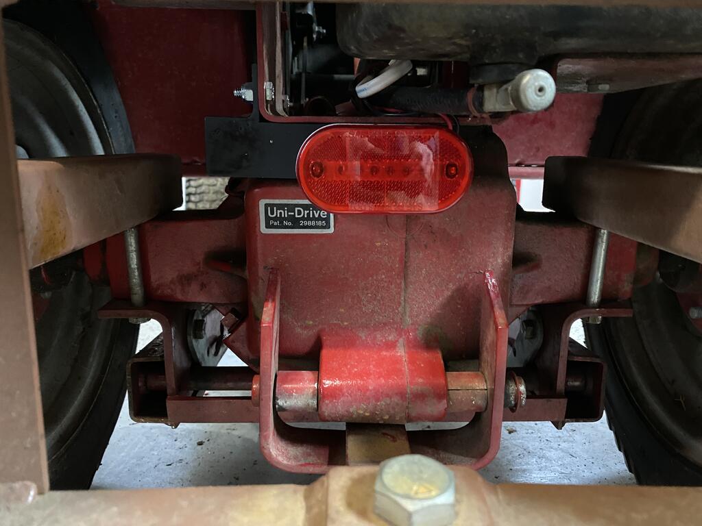

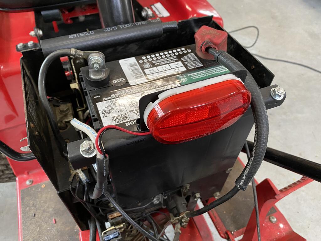

BeninCT 451 #8702 Posted January 16, 2021 (edited) Made up some brackets to hold some red marker lights and wired them up to the light switch so they are on with the headlights. Was going to change my rear reflectors but the lights i ordered were too small to use the rivet holes so went to plan B.. The one on the battery should give a cool red glow under the hood without being directly visible. Both will add to the visibly of the tractor at night which was the goal and no change to anything from the factory (wiring/drilling) Edited January 16, 2021 by BeninCT 2 3 Share this post Link to post Share on other sites
Ed Kennell 47,398 #8703 Posted January 16, 2021 3 hours ago, BeninCT said: Made up some brackets to hold some red marker lights and wired them up to the light switch so they are on with the headlights. Was going to change my rear reflectors but the lights i ordered were too small to use the rivet holes so went to plan B.. The one on the battery should give a cool red glow under the hood without being directly visible. Both will add to the visibly of the tractor at night which was the goal and no change to anything from the factory (wiring/drilling) 3 hours ago, BeninCT said: What am I seeing here? Is the axle bracket on backwards for a reason? 2 Share this post Link to post Share on other sites
ebinmaine 80,762 #8704 Posted January 16, 2021 45 minutes ago, Ed Kennell said: What am I seeing here? Is the axle bracket on backwards for a reason? Good eye Share this post Link to post Share on other sites
BeninCT 451 #8705 Posted January 16, 2021 55 minutes ago, Ed Kennell said: What am I seeing here? Is the axle bracket on backwards for a reason? Not sure machine is new to me! What is the axle bracket? Lol. Thx for pointing it out whatever it is I’d like to know and fix it By the way, this set of lights was suggested here by some as a direct replacement for the rear reflectors and the units I received are about 3/8 shorter than my rear reflectors which is why I mounted them elsewhere. Glad I did though happy to leave the tractor unmolested. 2 Share this post Link to post Share on other sites
ebinmaine 80,762 #8706 Posted January 16, 2021 16 minutes ago, BeninCT said: What is the axle bracket The part that holds the back of the plow to the rear axle. 1 Share this post Link to post Share on other sites
Ed Kennell 47,398 #8707 Posted January 16, 2021 The axle bracket is the fabricated device that is bolted to the rear axle for mounting of the snow plow frame or a rear tiller. Your bracket is rotated 180 degrees from normal. The two tabs that lock the plow frame to the axle bracket are normally to the rear. 1 Share this post Link to post Share on other sites
Handy Don 17,486 #8708 Posted January 16, 2021 4 hours ago, BeninCT said: <-- Rear <-- "Rock light" style You've gotten to where I was going a bit ahead of me! Thanks. Have been looking to hook up both a white "backup" light and useful "proximity" or "puddle" lighting. I have a floor-mounted hydro motion control and I'll be putting in a switch like the neutral-detect so the backup light comes on whenever headlights are on and the lever enters the "reverse" slot). I had just concluded the lamp might fit where you put your extra rear red. I do have to make sure it doesn't interfere with the rear lift, but I think it'll be ok. The puddle lighting is to be able to see what's going on next to the machine when mowing or navigating without having lights in your eyes. (Yeah, a true light bar could do this but overkill in my situation.) I'll be positioning one on each side to shine out and down, again on the headlight switch. I'll be upgrading the headlights to LED at the same time since one of the incandescents burned out the other day! 3 Share this post Link to post Share on other sites

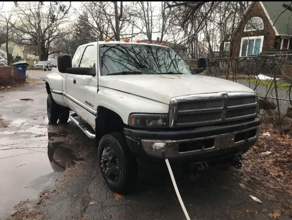

Jhook 849 #8713 Posted January 17, 2021 Am picking up a new horse hauler tomorrow if everything checks out. I absolutely hate towing my 4x6 trailer with my brand new jetta, i baby everything and even though it handles it no problem i just hate pulling more than 300 lbs with it being a 6 speed manual with almost no miles on it. So im headed southbound 65 miles in the flatbed to pick up a 96 ram 3500 4x4 with only 87k miles. My last v10 is still strong at 550k according to the current owner, i let it go with a bad clutch at 275k. I think this one should be able to handle at least 1 tractor in the bed 😂 4 1 Share this post Link to post Share on other sites

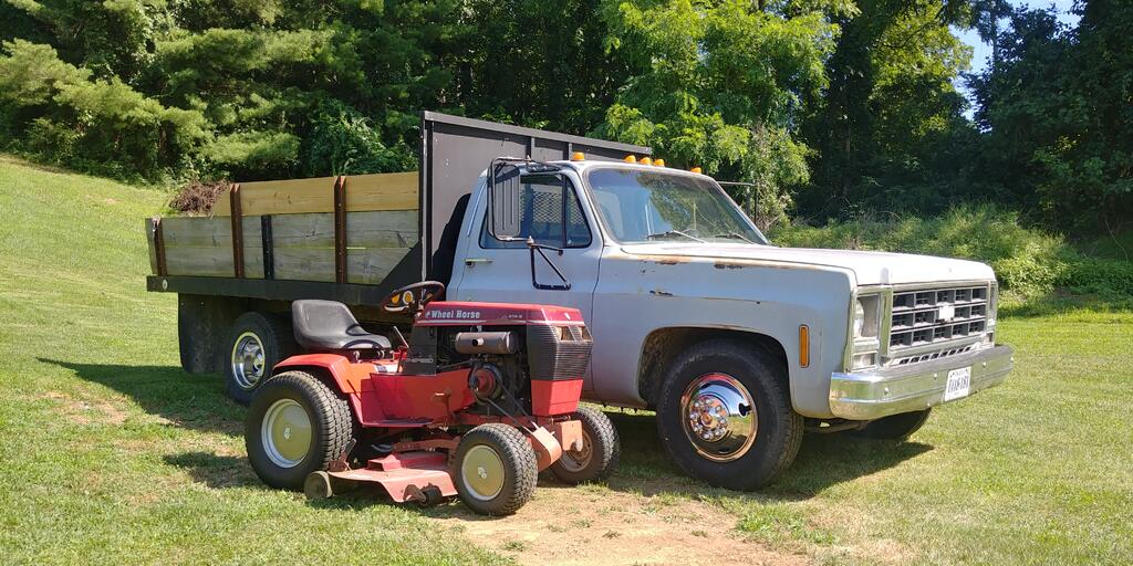

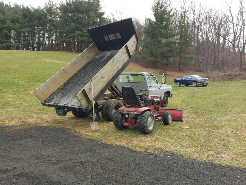

WVHillbilly520H 10,379 #8714 Posted January 17, 2021 27 minutes ago, Jhook said: Am picking up a new horse hauler tomorrow if everything checks out. I absolutely hate towing my 4x6 trailer with my brand new jetta, i baby everything and even though it handles it no problem i just hate pulling more than 300 lbs with it being a 6 speed manual with almost no miles on it. So im headed southbound 65 miles in the flatbed to pick up a 96 ram 3500 4x4 with only 87k miles. My last v10 is still strong at 550k according to the current owner, i let it go with a bad clutch at 275k. I think this one should be able to handle at least 1 tractor in the bed 😂 How many you reckon you could get in them bed of my ole hauler? 😂 5 1 Share this post Link to post Share on other sites
Handy Don 17,486 #8715 Posted January 17, 2021 3 minutes ago, WVHillbilly520H said: How many you reckon you could get in them bed of my ole hauler? 😂 Is this a trick question, like angels on the head of a pin? Neatly so they'd come out usable? Stacked like @pullstart's pickup? 1 1 Share this post Link to post Share on other sites

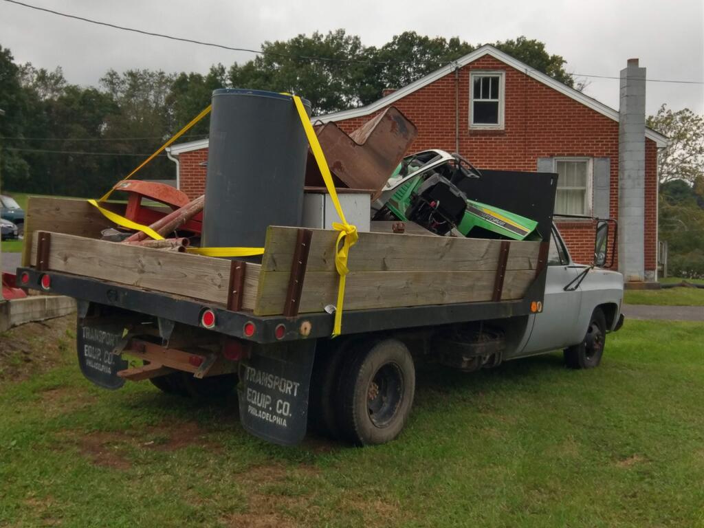

WVHillbilly520H 10,379 #8717 Posted January 17, 2021 7 minutes ago, Handy Don said: Is this a trick question, like angels on the head of a pin? Neatly so they'd come out usable? Stacked like @pullstart's pickup? No trick, 7'wX11' long and yes nearly and come off usable... unlike the 2 on this load. 2 1 Share this post Link to post Share on other sites
BeninCT 451 #8718 Posted January 17, 2021 13 hours ago, Ed Kennell said: The axle bracket is the fabricated device that is bolted to the rear axle for mounting of the snow plow frame or a rear tiller. Your bracket is rotated 180 degrees from normal. The two tabs that lock the plow frame to the axle bracket are normally to the rear. I found a pic online and looked under and you are right. I actually installed that piece with the plow I recently bought from another user so its on me! Easy fix will do. I think I thought that bar that connects the 2 sides would interfere with the longitudinals of the plow frame but sounds Ike it will clear. Thx 1 1 Share this post Link to post Share on other sites
BeninCT 451 #8719 Posted January 17, 2021 13 hours ago, Handy Don said: You've gotten to where I was going a bit ahead of me! Thanks. Have been looking to hook up both a white "backup" light and useful "proximity" or "puddle" lighting. I have a floor-mounted hydro motion control and I'll be putting in a switch like the neutral-detect so the backup light comes on whenever headlights are on and the lever enters the "reverse" slot). I had just concluded the lamp might fit where you put your extra rear red. I do have to make sure it doesn't interfere with the rear lift, but I think it'll be ok. The puddle lighting is to be able to see what's going on next to the machine when mowing or navigating without having lights in your eyes. (Yeah, a true light bar could do this but overkill in my situation.) I'll be positioning one on each side to shine out and down, again on the headlight switch. I'll be upgrading the headlights to LED at the same time since one of the incandescents burned out the other day! I wanted these to be seen but also to see the ground around me even if its not bright. I think they could be too bright if they were white lights and on all the time but maybe some yellow or red lights that were either brighter or maybe just more of them would fit your needs. Or a 2nd set of whites on another switch. Upgraded my headlights as well and everything flickers at low rpm so have to wire the lights straight from the battery and run ground wire to hood from batt - term. Should fix it. Been fun making little brackets and doing some welding but man my welding needs practice. My grinding skills more than make up for it though! 4 Share this post Link to post Share on other sites
