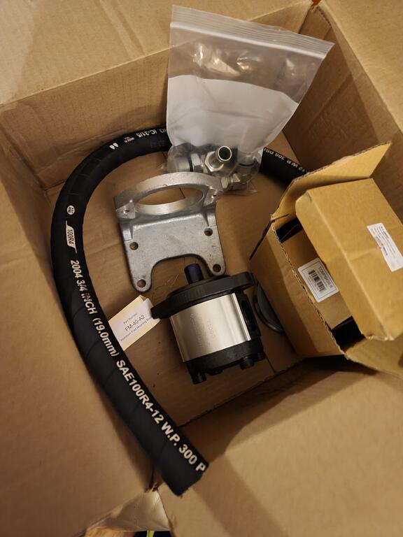

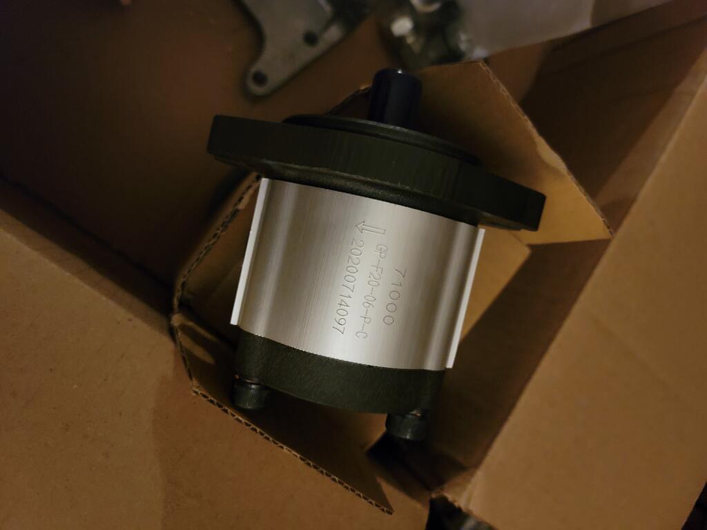

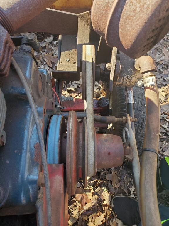

Jhook 849 #8556 Posted January 5, 2021 Got a hefty package in the mail today, new hydraulic pump, foot mount, inlet hose, fittings, and pulley for the charger 12. Will take some time this weekend to mock up the mount amd hopefully have it operational with the new pump sometime next week. This pump is quite a bit larger than the other one, and should pump around 5 gpm plus or minus. 6 1 Share this post Link to post Share on other sites
953 nut 66,467 #8557 Posted January 5, 2021 27 minutes ago, Jhook said: Will take some time this weekend to mock up the mount amd hopefully have it operational with the new pump sometime next week. The engine turns CCW on the PTO end and the pump appears to be a clockwise rotation. Is it going to be mounted outboard? 2 Share this post Link to post Share on other sites
Jhook 849 #8558 Posted January 6, 2021 2 hours ago, 953 nut said: The engine turns CCW on the PTO end and the pump appears to be a clockwise rotation. Is it going to be mounted outboard? Yes. The pump case will be pointed away from the engine. The pump shaft will be pointed towards the engine. Pic of current hack job setup for reference. I could have got the wrong direction but it seemed right that i need a clockwise pump? 1 3 Share this post Link to post Share on other sites

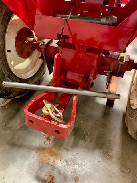

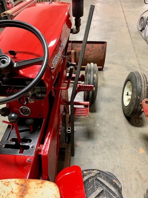

Greentored 3,220 #8559 Posted January 6, 2021 More and more intrigued as I see these 'power steering pump' posts. Certainly miss the hydro lift on the 520 when it comes to a yanking up a plow or disc harrow loaded with concrete blocks. Theres actually a chance of a decent snow here in NC Friday, so I dragged the blade out and began 'rebuilding' and mocking up to fit Hoss. No pretty restoration here, it will be 'function before style' and get a quick scuff and shot of whatever red I find laying around once its done. Never messed with a plow/dozer whatever blade, but the angle adjust arm and link were missing and the mount for it was torn off/broken. It its original spot it would appear one would really have to reach to grab that arm- is that how they were? Regardless, it wont be on this one- relocated the new mount further back and put a small 'kick' in the arm. Required putting a bit more bend on the PTO engage lever but otherwise clears the machine and my leg nicely throughout its travel range. Now that I hustle to finish this, it wont snow...... 3 6 Share this post Link to post Share on other sites

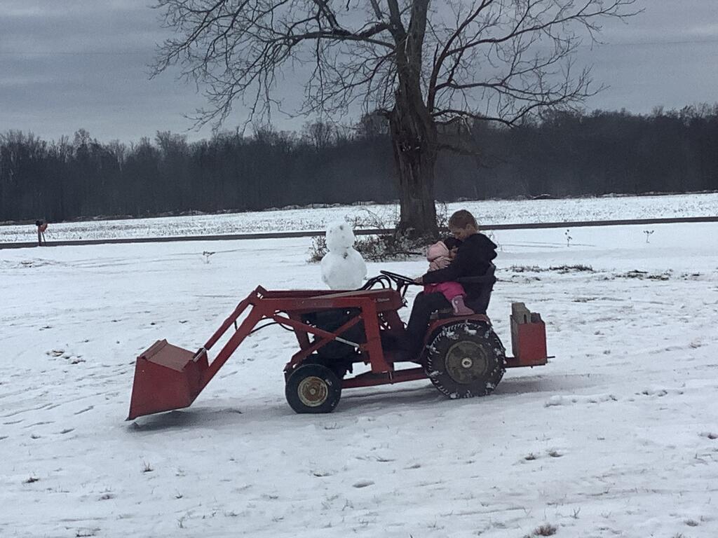

Pullstart 70,071 #8560 Posted January 6, 2021 Rylee took Leighty Bug for a stroll on the “tractor ride” today... 4 3 5 Share this post Link to post Share on other sites

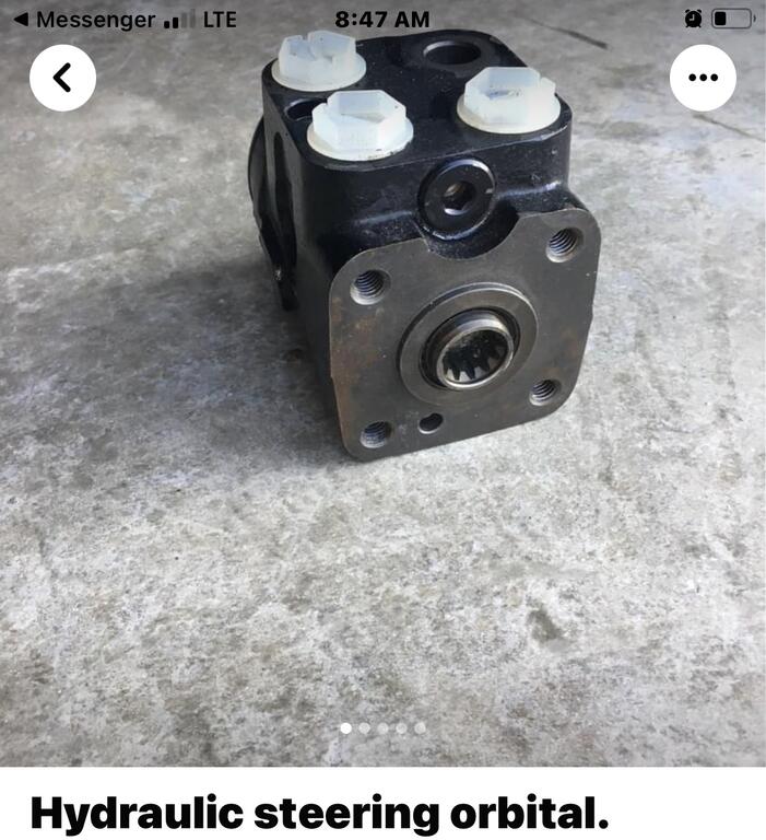

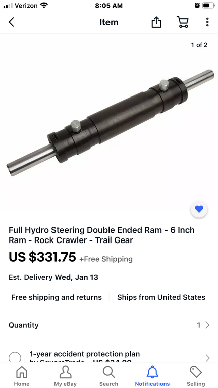

KrazeyOlDave 860 #8564 Posted January 7, 2021 Found a new orbital valve for my power steering setup. Need to save up a little more and buy the double ended ram. 3 Share this post Link to post Share on other sites

Shed 377 #8566 Posted January 7, 2021 35 minutes ago, KrazeyOlDave said: Found a new orbital valve for my power steering setup. Need to save up a little more and buy the double ended ram. https://www.surpluscenter.com/ try them out lots of hydraulic supplies and rams good pricing 2 1 Share this post Link to post Share on other sites

Handy Don 16,743 #8571 Posted January 7, 2021 23 hours ago, pullstart said: Rylee took Leighty Bug for a stroll on the “tractor ride” today... SO glad a ride in the bucket wasn't on her mind! 2 1 2 Share this post Link to post Share on other sites
ebinmaine 79,098 #8572 Posted January 7, 2021 @pullstart 1 hour ago, Handy Don said: SO glad a ride in the bucket wasn't on her mind! PLEASE don't let them do that. Ever. 1 1 Share this post Link to post Share on other sites

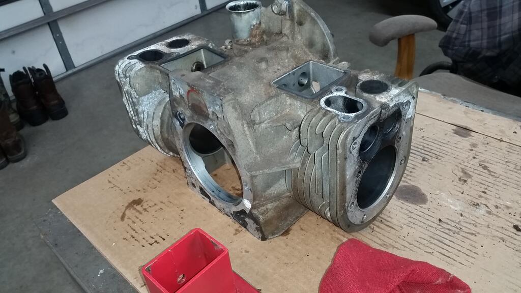

WHX?? 56,822 #8573 Posted January 8, 2021 Worked on gutting a Onan for refresh possibilities and got a package from the big brown truck driver today. Now I hate to call @Greentored a stooge for trading me this nice square pan for a round one. He might not know it but square pans are hens teeth, around here anyway. My 701 thanks you Green! Got a little clean up action started on Pullstart's K161 for the same 701 too. 5 2 1 Share this post Link to post Share on other sites

Achto 31,890 #8575 Posted January 8, 2021 Bad news on that Onan @WHX24 the cylinders are shaped like an egg at the top. About .007 out on the thrust surface. Crank looks like it just needs a polish & the one rod needs to be replaced. I'll call you with the details. 1 1 Share this post Link to post Share on other sites
