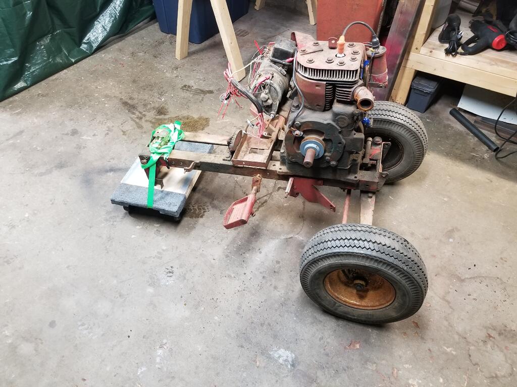

OldWorkHorse 3,156 #8035 Posted December 2, 2020 Turned my 1257 to a roller today.... 3 5 Share this post Link to post Share on other sites
ebinmaine 80,854 #8036 Posted December 3, 2020 32 minutes ago, OldWorkHorse said: Turned my 1257 to a roller today.... Well done Sir 👍 Share this post Link to post Share on other sites
OldWorkHorse 3,156 #8037 Posted December 3, 2020 8 minutes ago, ebinmaine said: Well done Sir 👍 Thank you. I new I'd figure this thing out sooner then later haha. Can almost see the finished project now hahaha 2 Share this post Link to post Share on other sites
ebinmaine 80,854 #8038 Posted December 3, 2020 2 minutes ago, OldWorkHorse said: Thank you. I new I'd figure this thing out sooner then later haha. Can almost see the finished project now hahaha Just a few more bolts and yer dunn.. 2 Share this post Link to post Share on other sites
OldWorkHorse 3,156 #8039 Posted December 3, 2020 1 hour ago, ebinmaine said: Just a few more bolts and yer dunn.. Got them in the mail thank to you 1 Share this post Link to post Share on other sites

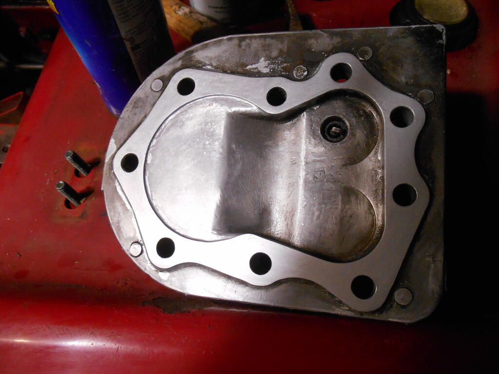

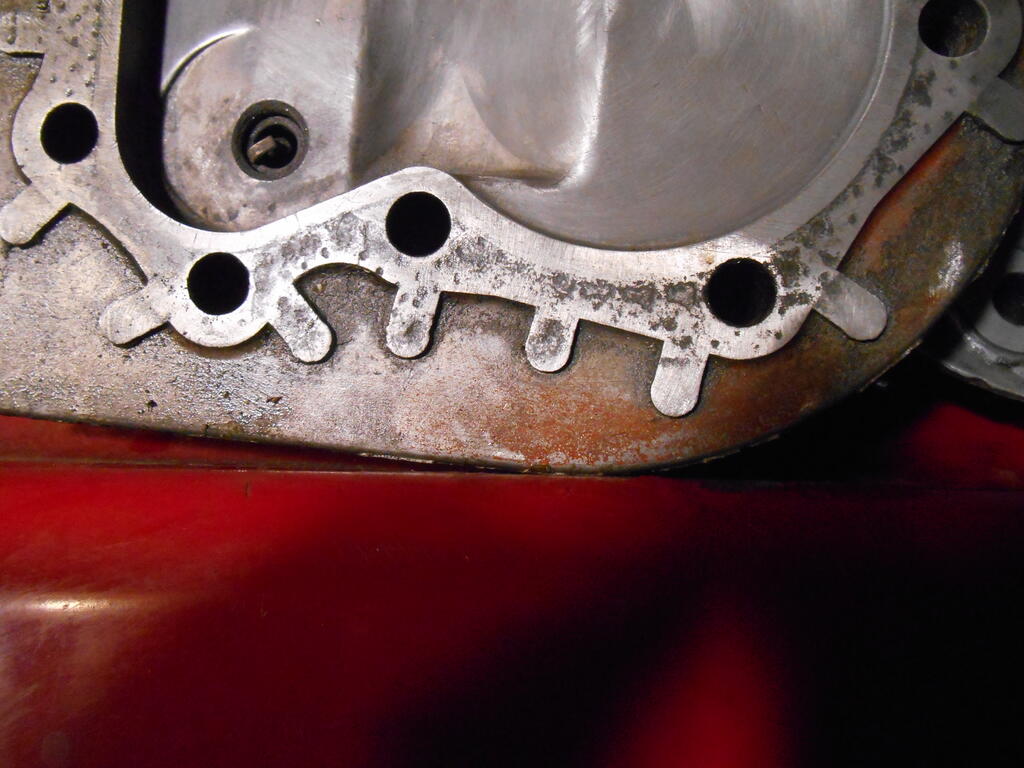

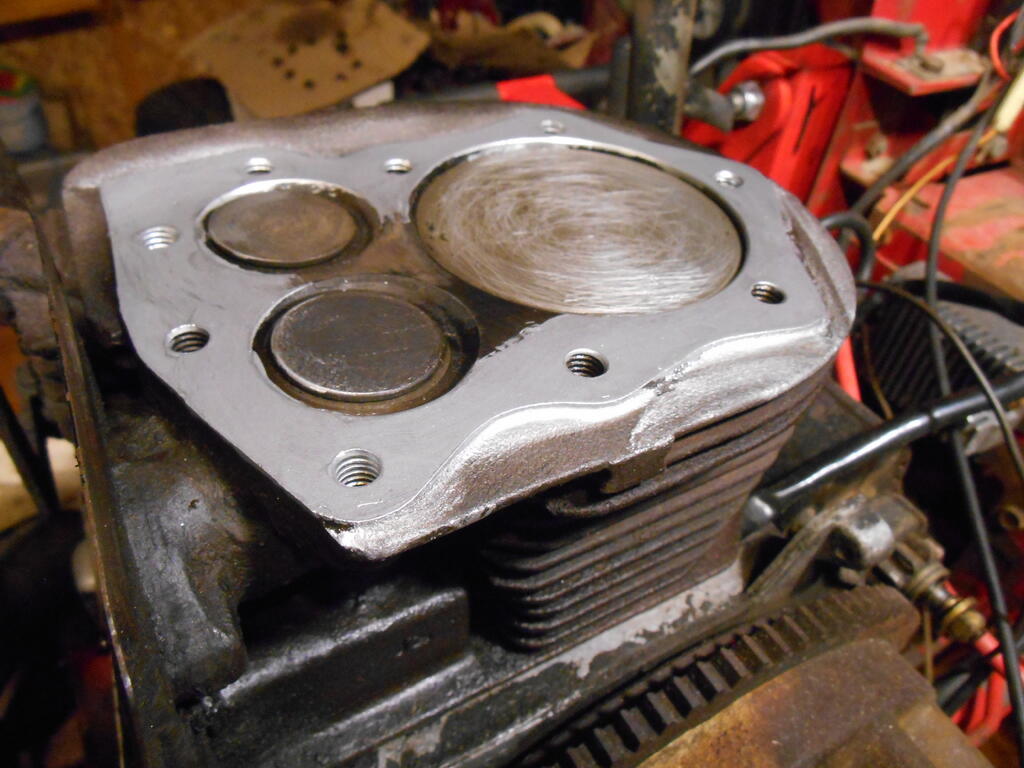

ohiofarmer 3,504 #8040 Posted December 4, 2020 (edited) Well, fellas, I am trying something a little different, and although it may sound crazy, it has it's origins in WWII. The guys who kept the fighters in the air did not have te best access to spare parts and they reused the metal head gaskets by first applying aluminum paint. So after flattening the decks of the cylinder head caps as much as possible, i took some rather well used and thick Rustoleum Aluminum paint and tried it out. The paint was really thick and nearly a paste, but it went on OK, and i discovered that my finger smoothed it right out flat as can be. I did the gasket as well and even in cold weather at about 50 degrees and sunny, they were nearly ready start to finish in about 30 minutes. The source for this info was the guys who use pulling tractors with the old cast iron Kohlers. i figure that I am not gonna hurt the tractor by trying it out. Don't worry, I cleaned the paint off where it did not belong... I also found out that the style of head shown here is about the best for a working tractor, but the ones with the centered spark plugs are sought after for pulling tractors i posted previously about using ultra high temp JB weld on the pitted head [first picture] don't do it. That stuff is pretty rough and does not harden correctly without heat. So this head cap is gonna be a test bed for regular JB weld and aluminum application while being checked at 5 hours.At least the inside edge has decent flatness and no corrosion. Edited December 4, 2020 by ohiofarmer 5 Share this post Link to post Share on other sites
Tractorhead 9,217 #8041 Posted December 4, 2020 Many ideas arise out of necessity. What is interesting is how long it lasts, But i can imagine it will work. 1 Share this post Link to post Share on other sites

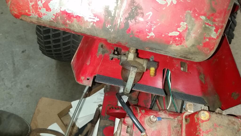

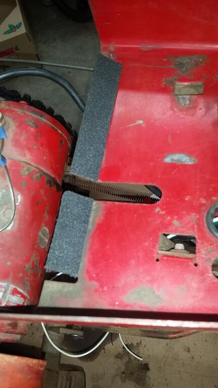

WHX?? 58,276 #8042 Posted December 4, 2020 Worked on the 1045 abit, put some cushion where the gas tank was rubbing. Shoulda put the tank in before bolting the motor back down tho! 6 Share this post Link to post Share on other sites

WHNJ701 4,173 #8046 Posted December 5, 2020 23 hours ago, ohiofarmer said: Well, fellas, I am trying something a little different, and although it may sound crazy, it has it's origins in WWII. The guys who kept the fighters in the air did not have te best access to spare parts and they reused the metal head gaskets by first applying aluminum paint. So after flattening the decks of the cylinder head caps as much as possible, i took some rather well used and thick Rustoleum Aluminum paint and tried it out. The paint was really thick and nearly a paste, but it went on OK, and i discovered that my finger smoothed it right out flat as can be. I did the gasket as well and even in cold weather at about 50 degrees and sunny, they were nearly ready start to finish in about 30 minutes. The source for this info was the guys who use pulling tractors with the old cast iron Kohlers. i figure that I am not gonna hurt the tractor by trying it out. Don't worry, I cleaned the paint off where it did not belong... I also found out that the style of head shown here is about the best for a working tractor, but the ones with the centered spark plugs are sought after for pulling tractors i posted previously about using ultra high temp JB weld on the pitted head [first picture] don't do it. That stuff is pretty rough and does not harden correctly without heat. So this head cap is gonna be a test bed for regular JB weld and aluminum application while being checked at 5 hours.At least the inside edge has decent flatness and no corrosion. Maybe @Vinylguy can make you a pratt & whitney sticker for it! Share this post Link to post Share on other sites
RandyLittrell 3,946 #8047 Posted December 5, 2020 On 12/3/2020 at 9:21 PM, ohiofarmer said: Well, fellas, I am trying something a little different, and although it may sound crazy, it has it's origins in WWII. The guys who kept the fighters in the air did not have te best access to spare parts and they reused the metal head gaskets by first applying aluminum paint. So after flattening the decks of the cylinder head caps as much as possible, i took some rather well used and thick Rustoleum Aluminum paint and tried it out. The paint was really thick and nearly a paste, but it went on OK, and i discovered that my finger smoothed it right out flat as can be. I did the gasket as well and even in cold weather at about 50 degrees and sunny, they were nearly ready start to finish in about 30 minutes. The source for this info was the guys who use pulling tractors with the old cast iron Kohlers. i figure that I am not gonna hurt the tractor by trying it out. Don't worry, I cleaned the paint off where it did not belong... I also found out that the style of head shown here is about the best for a working tractor, but the ones with the centered spark plugs are sought after for pulling tractors i posted previously about using ultra high temp JB weld on the pitted head [first picture] don't do it. That stuff is pretty rough and does not harden correctly without heat. So this head cap is gonna be a test bed for regular JB weld and aluminum application while being checked at 5 hours.At least the inside edge has decent flatness and no corrosion. I have reused kohler head gaskets by spraying aluminum paint on them and they are still running today. Randy 3 1 Share this post Link to post Share on other sites
ohiofarmer 3,504 #8048 Posted December 5, 2020 On 12/2/2020 at 6:30 PM, OldWorkHorse said: Turned my 1257 to a roller today.... I see you have the HFT furniture dolly rated at 1000 pounds. Weird thing is, when you go to the caster aisle in the store, the exact replacement caster is rated at under a hundred pounds. It makes you go Hmmmmmmm. Anyway, congrats on having a tractor to wrench on and a dry shop to do maintenance on your projects. 2 Share this post Link to post Share on other sites

OldWorkHorse 3,156 #8050 Posted December 5, 2020 (edited) 44 minutes ago, ohiofarmer said: It makes you go Hmmmmmmm. Anyway, congrats Lol yes I never push there stuff because probly fail way before rated but for light stuff to push around they get the job done! Side note I had a piece of 3/4 maple sheet that just happend be the perfect fit in between the carpet rails so that dolly is now I'm not good with math but rated at 10,000lbs? Edited December 5, 2020 by OldWorkHorse 1 1 Share this post Link to post Share on other sites
