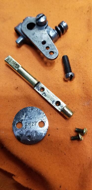

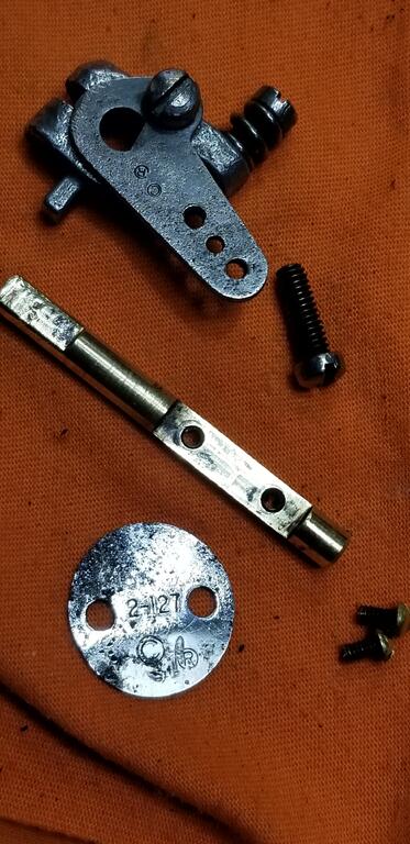

AMC RULES 37,260 #7855 Posted November 23, 2020 Carter model N resto... ...except for the seals, used most of the original hardware, didn't put a kit in it. 1 9 Share this post Link to post Share on other sites
ebinmaine 80,856 #7856 Posted November 23, 2020 19 minutes ago, AMC RULES said: Carter model N resto... Nice work sir 1 Share this post Link to post Share on other sites
Handy Don 17,535 #7857 Posted November 23, 2020 The quality of the original engineering, materials, and workmanship withstanding so many years of neglect really becomes obvious when enhanced by a patient and careful restoration. Nice work, there. 2 Share this post Link to post Share on other sites
sqrlgtr 4,060 #7858 Posted November 23, 2020 @AMC RULES did you happen to rebush throttle shaft while rebuilding the carter?I have one that really needs it and just wondering how bad of a project it would be... 1 Share this post Link to post Share on other sites
ebinmaine 80,856 #7859 Posted November 23, 2020 11 minutes ago, sqrlgtr said: @AMC RULES did you happen to rebush throttle shaft while rebuilding the carter?I have one that really needs it and just wondering how bad of a project it would be... What's the carburetor that you need to work on? I've done a couple of those and they're fairly straightforward. Least or most fun thing depending on how you look at it is probably getting the tiny little screws out of the throttle shaft. Probably have to grind the end off because they are staked in place. 1 Share this post Link to post Share on other sites

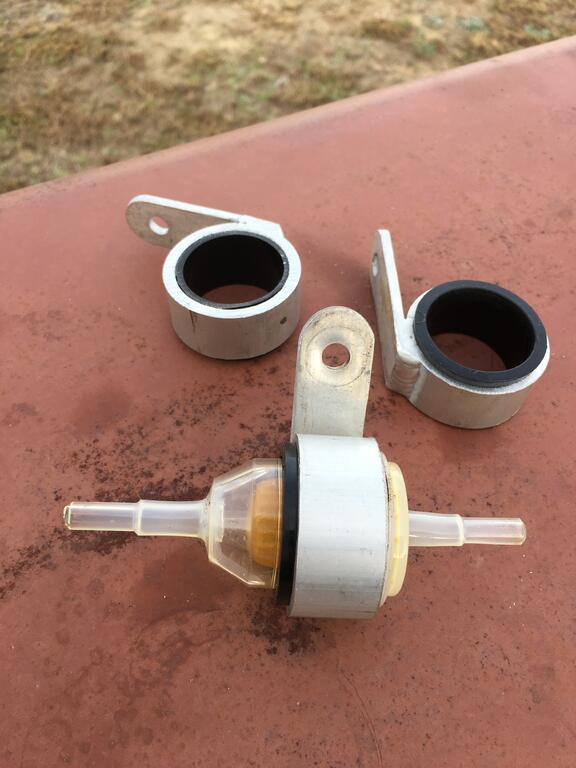

WHX?? 58,280 #7861 Posted November 23, 2020 23 hours ago, 19richie66 said: Finally finished some of my fuel filter brackets. Now I only need 104 more to keep my bros happy. 1 5 Share this post Link to post Share on other sites

ebinmaine 80,856 #7864 Posted November 23, 2020 29 minutes ago, WHX24 said: 104 I don't think that's unreasonable 1 Share this post Link to post Share on other sites

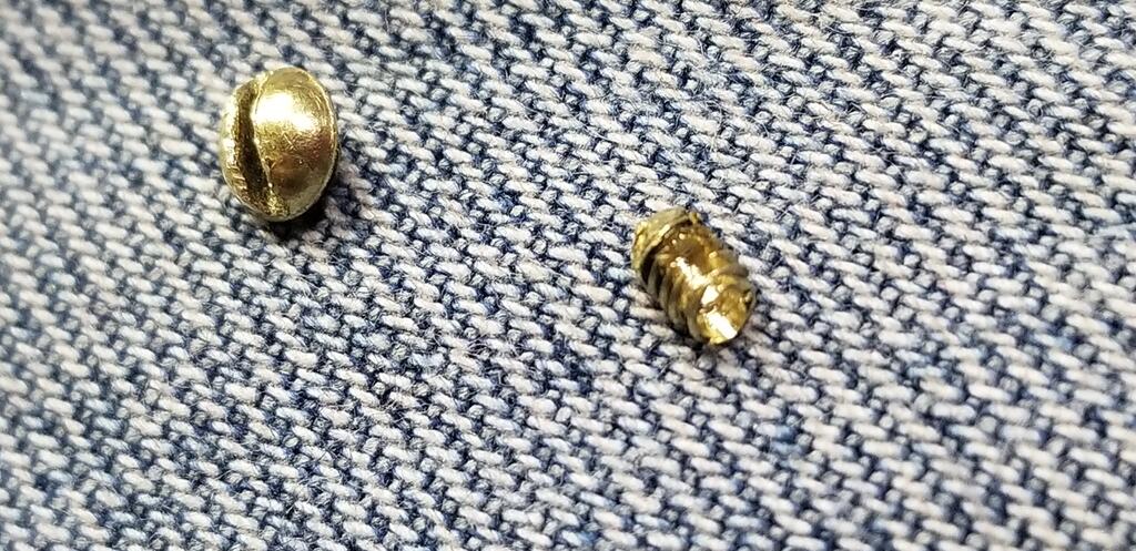

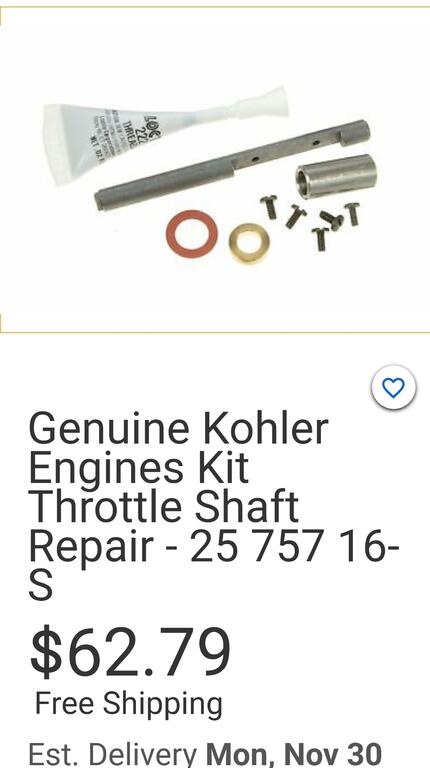

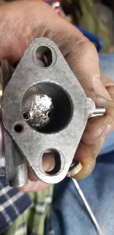

AMC RULES 37,260 #7865 Posted November 23, 2020 Well I was in the process of rebushing the throttle shaft before I twisted one of the brass screw heads off. See these prices?Talk about a subject that needs it's own thread. WOW! 1 Share this post Link to post Share on other sites
sqrlgtr 4,060 #7866 Posted November 23, 2020 12 minutes ago, AMC RULES said: See these prices?Talk about a subject that needs it's own thread. WOW! Must be gold screws lol...Did you have to drill carb body or just drop in bushing ???I Share this post Link to post Share on other sites

AMC RULES 37,260 #7868 Posted November 23, 2020 Thankfully, I was successful in drilling out that pesky broken off screw, thereby saving my throttle shaft. 1 1 Share this post Link to post Share on other sites
AMC RULES 37,260 #7869 Posted November 23, 2020 If you plan to rebush this carb, then yes, you're going to have to drill out this carb body to accept the bushing. 2 Share this post Link to post Share on other sites
