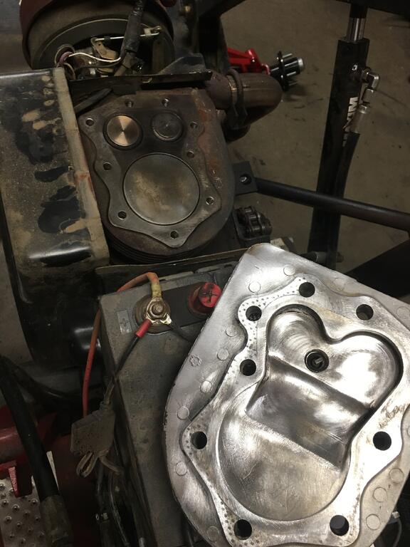

Horse Newbie 7,405 #7804 Posted November 21, 2020 (edited) 2 hours ago, KrazeyOlDave said: As my grand pappy used to say, much gooder @KrazeyOlDave Is that an aluminum head ? And how did you clean it...wire brush ? Edited November 21, 2020 by Horse Newbie Misspelling 1 Share this post Link to post Share on other sites

Pullstart 71,350 #7806 Posted November 21, 2020 19 minutes ago, Horse Newbie said: @KrazeyOlDave Is that an aluminum head ? And how did you clean it...wire brush ? yes, they are aluminum. It looks like a polish disc on a die grinder. Every head should be flat plate lapped with sand paper and oil to ensure flatness before re-installing too. 5 Share this post Link to post Share on other sites

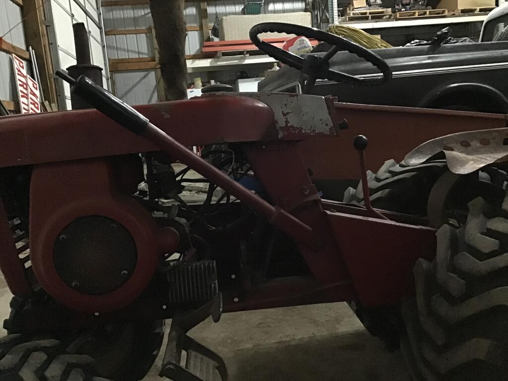

Pullstart 71,350 #7807 Posted November 21, 2020 Took a stroll on Poppy tonight. 5 Share this post Link to post Share on other sites
KrazeyOlDave 860 #7808 Posted November 22, 2020 55 minutes ago, Horse Newbie said: @KrazeyOlDave Is that an aluminum head ? And how did you clean it...wire brush ? Yep, low RPM wire brush on a die grinder. If you’re not experienced with using a die grinder on aluminum, don’t try on yours. I used to work in a pattern shop, many years of brain numbing grinding. 1 Share this post Link to post Share on other sites
KrazeyOlDave 860 #7809 Posted November 22, 2020 38 minutes ago, pullstart said: yes, they are aluminum. It looks like a polish disc on a die grinder. Every head should be flat plate lapped with sand paper and oil to ensure flatness before re-installing too. I’ve never had to do that with any good running engine with aluminum head, not even on our race bikes. If you break the bolts loose in the correct order, the head will be within .010 every time. The gasket is designed to make up the difference. You should never torque, run, cool and re-torque them either, not on aluminum heads. 1 Share this post Link to post Share on other sites
KrazeyOlDave 860 #7810 Posted November 22, 2020 41 minutes ago, pullstart said: Took a stroll on Poppy tonight. I like those rear tires, better photo of them? Share this post Link to post Share on other sites
Pullstart 71,350 #7811 Posted November 22, 2020 (edited) 5 minutes ago, KrazeyOlDave said: I like those rear tires, better photo of them? That photo isn’t necessarily about the foreground... Here’s a link to more detail on “Poppy” my 7 horsepower 552. there are pictures in my gallery too. Edited November 22, 2020 by pullstart Gallery link 1 Share this post Link to post Share on other sites

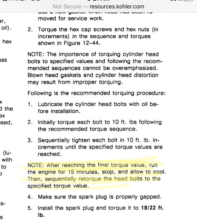

ebinmaine 80,856 #7813 Posted November 22, 2020 2 hours ago, KrazeyOlDave said: You should never torque, run, cool and re-torque them either, not on aluminum heads With all due respect, that's not been my experience. I've had a few Kohler K Series heads off/on the past few years. 8 HP through 16 HP. All singles. Between 1 and 3 bolts gained a bit after a heat cycle on ALL the engines I've done. I do realize there are different schools of thought on this depending on who you ask. I've never personally met anyone that doesn't do it but I'm not in the rebuilding or race world. The way I see it, retorque them. If they move, great. If not, great. You lost nothing but a few minutes of time. I can't comment on the sanding/planing for a good running engine as all the ones I've had apart did have slight gasket leaks. None of ours were out of plane by much but all got at least a touch up on the sandpaper taped to glass we use. 3 Share this post Link to post Share on other sites
19richie66 17,937 #7814 Posted November 22, 2020 straight out of the Kohler service manual. 👍 2 5 Share this post Link to post Share on other sites
lynnmor 9,047 #7815 Posted November 22, 2020 1 hour ago, 19richie66 said: straight out of the Kohler service manual. 👍 You might want to retorque the head bolts AFTER installing the spark plugs, they seem to start much better with the plugs in. 8 Share this post Link to post Share on other sites

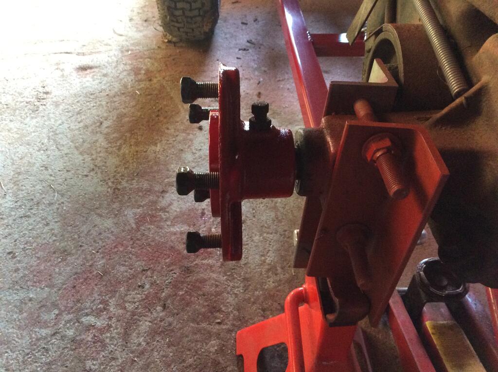

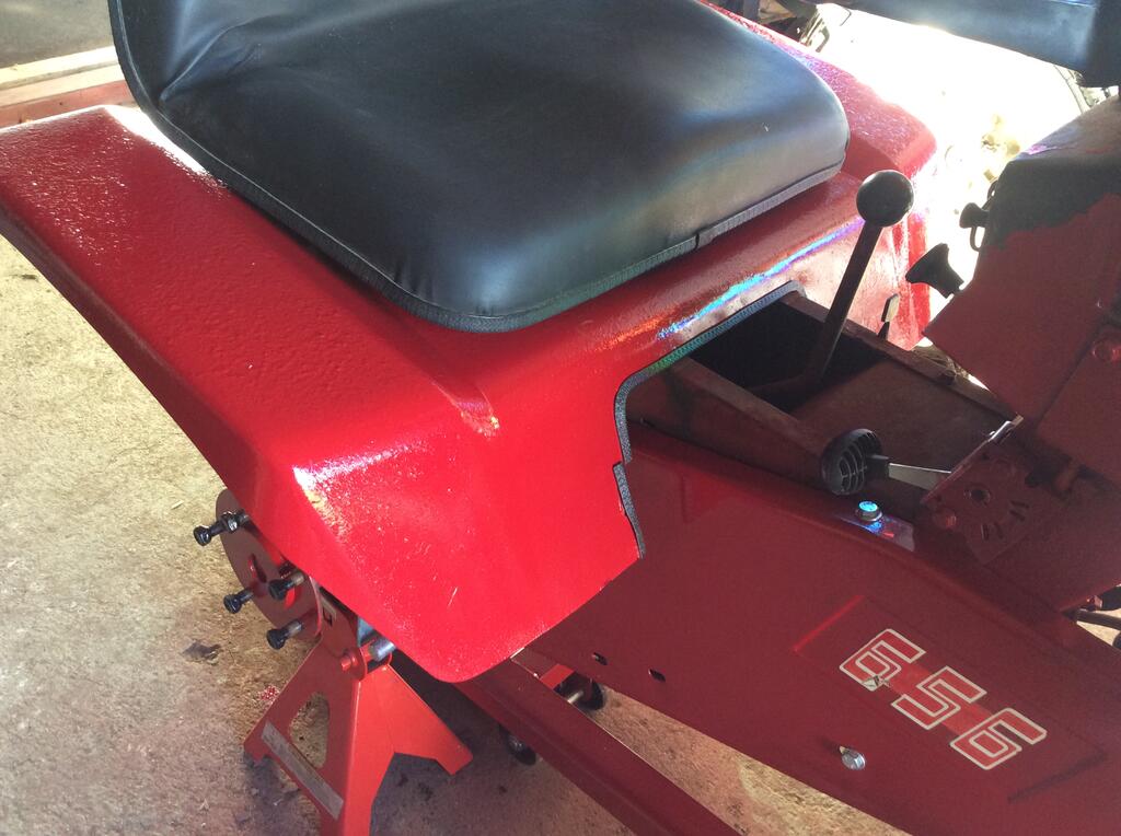

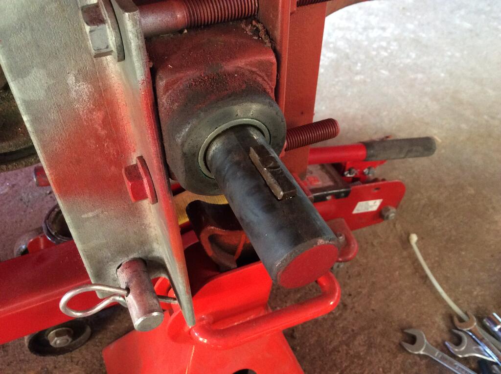

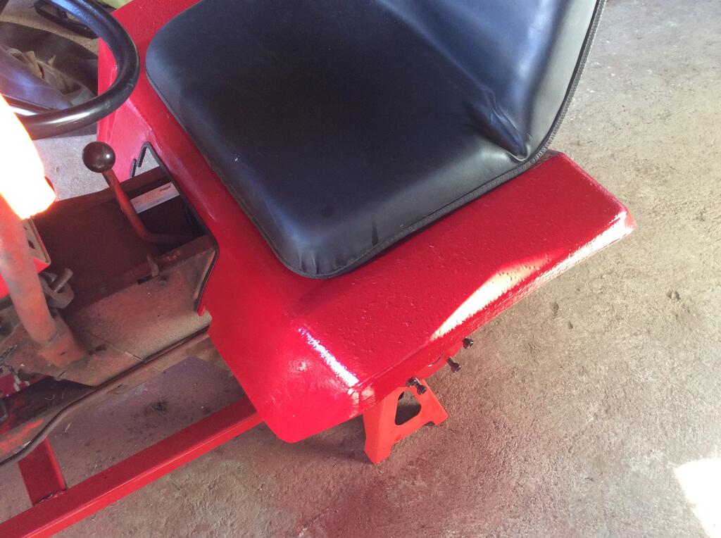

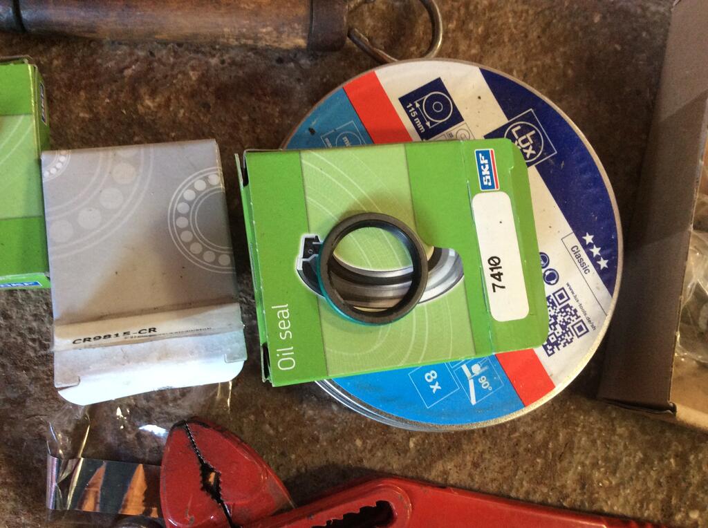

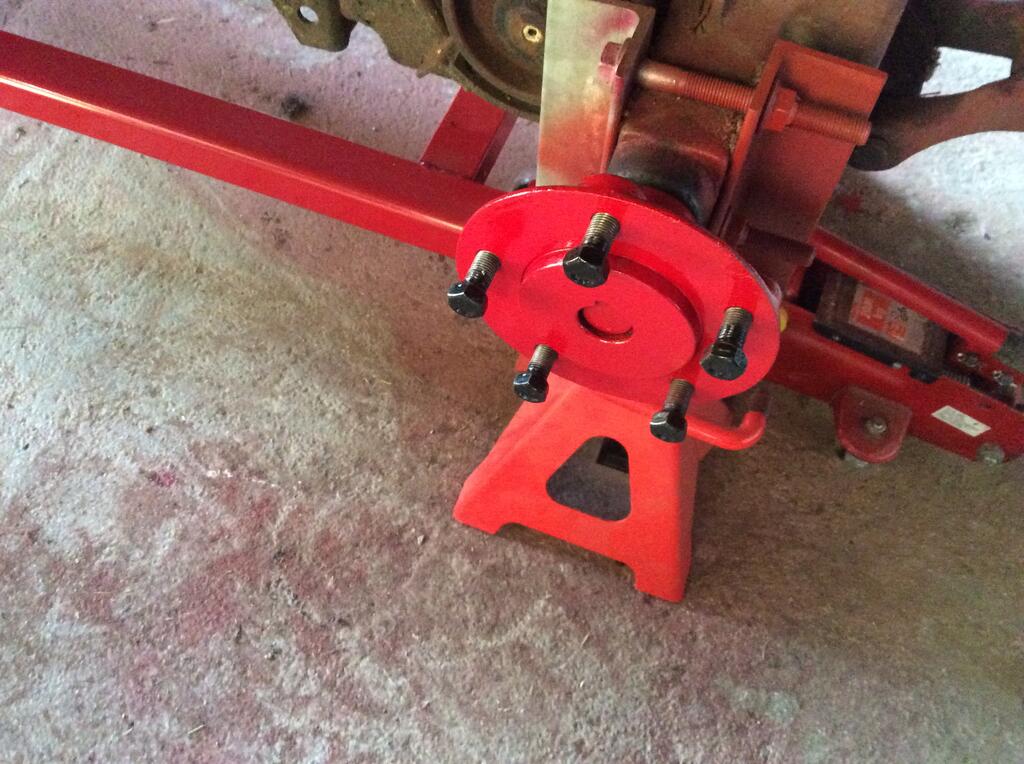

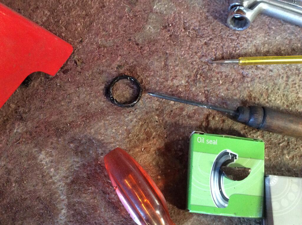

Tractorhead 9,217 #7818 Posted November 22, 2020 Did a few minor Works this Weekend. firstly painted the rear Seat Pan with structured Paint and after with Ral3003. While removing the Seat, to rework the Pan, two of the Seat Screws in the Seat are broke out. I found in my collection 4 boarded nuts, they fit perfectly in the now open Holes, than i decide to exchange all the nuts to M8. So i pointwelded them in and repainted the Seat bottom after that action again in Black to prevent Rust. I like it how the Structure turns out. Because i see last ride again few dribbs oil on the Floor, i changed the rear seal on left side. With the pic i was able to remove the old Seal, that depends just few seconds. while rubber loosened itself, a good choice to do that before doing any Winter Tasks. The Seals i bought are perfectly Fit, thanks to @stevasaurus for the collected Dimensions you gave me. With new Seals on, i remounted the painted Wheelhubs back on. a fine film of Coppergrease will hopefully help for later changes, to remove the hubs as easy as they loosening now. I decided to have an gap of 5mm between the Hubs and the Gearbox, to be able to remove them again with the Pulley remover i have, even if they rotten on. Back in with the Black tip painted Wheelscrews, so i just have to Wait for the Rear RIM‘s New tyre‘s are allready onsite. To tuneup the Seatpan optics a little more in optics, i decide to use a black border protection, what looks pretty nice. preheated with hot air Gun it fits smoothly in the shape. Next Task is to find two new Rubber stops, the fit in the holes above the Seatpan, because the old are squeesed hardly. At least i remounted the yesterday‘s reworked Pullstart cover, because the rope rips and i must rewind it, i decide to rework it at once. I love my Horse...😍 3 5 2 Share this post Link to post Share on other sites
Pullstart 71,350 #7819 Posted November 22, 2020 1 hour ago, Tractorhead said: I love my Horse...😍 It shows Stefan! Good work! I am not sure, but does the set screw need to be perfectly centered over the half moon key way? Maybe moving the hub outward affects that? 1 Share this post Link to post Share on other sites
ebinmaine 80,856 #7820 Posted November 22, 2020 22 minutes ago, pullstart said: It shows Stefan! Good work! I am not sure, but does the set screw need to be perfectly centered over the half moon key way? Maybe moving the hub outward affects that? It needs to be at, or quite close to, Center. Depends on the setup because some Horses I've seen have longer keyways which means you'd have to be right on center or things will move around. Some other Horses I've seen have a slight flat on the bottom of the round because the groove isn't quite deep enough to leave a true round key in place. 1 Share this post Link to post Share on other sites
Tractorhead 9,217 #7821 Posted November 22, 2020 16 minutes ago, pullstart said: It shows Stefan! Good work! I am not sure, but does the set screw need to be perfectly centered over the half moon key way? Maybe moving the hub outward affects that? Think you‘re right about that but if look closer at following Pict, than ya will see, it was not really Centered until what can see on the impressions the measured decenter was 3 mm to before, so that was my decision to set it on 5 mm Gap, now it shall be exactly on Center of the Keeway. 1 Share this post Link to post Share on other sites

Horse Newbie 7,405 #7823 Posted November 22, 2020 7 hours ago, 19richie66 said: straight out of the Kohler service manual. 👍 I'm referring to aluminum heads on an Onan P220G... so I guess it wouldn't matter huh, aluminum heads are aluminum heads... So what I'm gathering here is some people torque, run 15 minutes or so, let cool, and re-torque, and some people don't. And I tend to agree with @ebinmaine wouldn't hurt to do it... 2 Share this post Link to post Share on other sites
19richie66 17,937 #7824 Posted November 22, 2020 Some people read instructions...... some throw them away 4 Share this post Link to post Share on other sites
