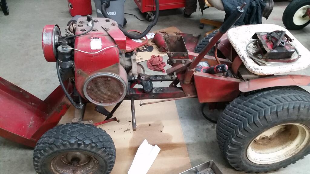

WHX?? 57,923 #7629 Posted November 15, 2020 (edited) What your source on the fuel cap Madge? Tied into the 1054 Mike @prondzy brought over at plow day. Sorry Mike I can handle a smoking engine on a new to me, this one doesn't, but sloppy steering is a deal breaker! This motor acts exactly like the short pan in my 1055. The SG struggles to turn it over on the compression stroke so guessing this doesn’t have ACR either. If you let it set for a second then hit it again it wil pop right off. Has that nice tight sound of the 1055 as well. Will also repair some other minor things while I'm at it and replace the ig switch with a proper 70 amp one and wire up the disconnected gen light and cigar lighter ... another deal breaker... how am I gonna run the pellet grill at shows with out a cigar lighter! Oh and what's up with the empty holes in the hood and muffler Mike? Dibs on that attachment you get the hair to sell! Edited November 15, 2020 by WHX24 3 1 Share this post Link to post Share on other sites

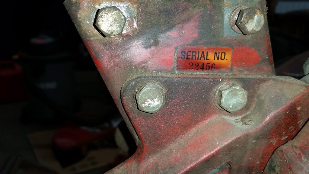

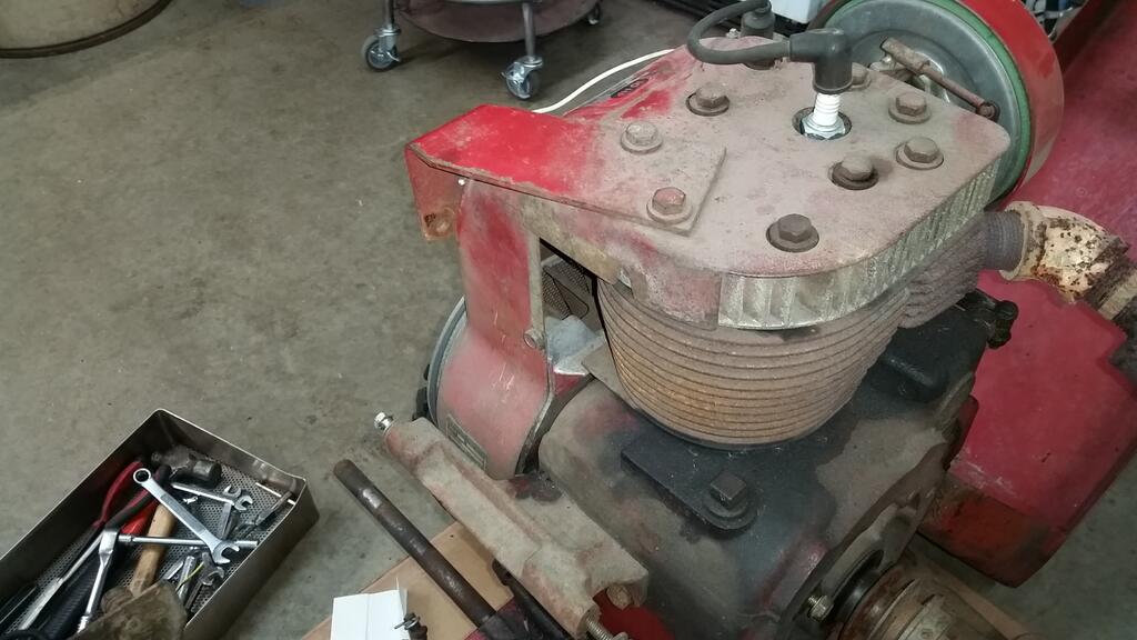

WHX?? 57,923 #7630 Posted November 15, 2020 (edited) Something else I found on this girl.... serial number tag just above the lift lever. No doubt original. Someone has been in the motor before tho. Base pan is on backwards, my other short frames with a big block it is facing the front. Missing tin on it too. Have those in the magic parts shed. Edited November 15, 2020 by WHX24 6 2 Share this post Link to post Share on other sites

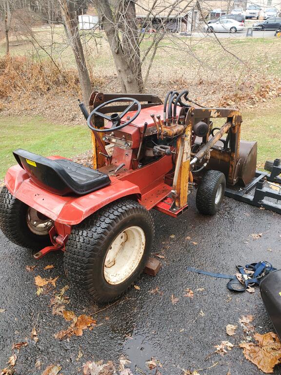

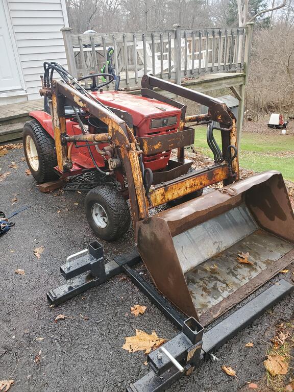

Jhook 849 #7633 Posted November 15, 2020 Got the charger 12 washed and degreased a little bit. The trans appears to be out of fluid or very low. It does drive. Is there common areas they leak from? Previous owner said it leaks slowly. 3 1 Share this post Link to post Share on other sites
pfrederi 21,097 #7634 Posted November 15, 2020 7 minutes ago, Jhook said: Got the charger 12 washed and degreased a little bit. The trans appears to be out of fluid or very low. It does drive. Is there common areas they leak from? Previous owner said it leaks slowly. Axle seals #1 Motion control #2 2 1 Share this post Link to post Share on other sites
Jhook 849 #7635 Posted November 15, 2020 11 minutes ago, pfrederi said: Axle seals #1 Motion control #2 Thank you, both relatively easy fixes? First im gonna put a new filter and fluid with dye if that wont hurt it, i have a black light for leak detection if i can find dye at the store. Also can you tell me what trans fluid (from an auto parts store) i can use? Share this post Link to post Share on other sites
Pullstart 71,161 #7636 Posted November 15, 2020 17 minutes ago, Jhook said: Thank you, both relatively easy fixes? First im gonna put a new filter and fluid with dye if that wont hurt it, i have a black light for leak detection if i can find dye at the store. Also can you tell me what trans fluid (from an auto parts store) i can use? Any auto trans fluid if it’s red on the stick, like Dex 3, Etc. Most all are comparable across the board anymore. If it’s brown though, use engine oil. the motion control isn’t terrible, but I feel like it’s easiest to pull the trans from the frame to do the job. 1 Share this post Link to post Share on other sites
Pullstart 71,161 #7637 Posted November 15, 2020 @Jhook here’s a thread where I did seals in the motion control. Share this post Link to post Share on other sites
pfrederi 21,097 #7638 Posted November 15, 2020 Dex/Merc if the fluid is red. 10w-30 or 10w-40 if it is tan...Filter Wix 51410 Axle seal effort depends on how hard the hubs fight. 1 Share this post Link to post Share on other sites
Jhook 849 #7639 Posted November 15, 2020 15 minutes ago, pullstart said: Any auto trans fluid if it’s red on the stick, like Dex 3, Etc. Most all are comparable across the board anymore. If it’s brown though, use engine oil. the motion control isn’t terrible, but I feel like it’s easiest to pull the trans from the frame to do the job. Its red, not on the stick though, on the bottom dripping off😂😂 thank you 3 Share this post Link to post Share on other sites
Tractorhead 9,217 #7640 Posted November 15, 2020 Sound like an continousely automatic fluid change 1 2 Share this post Link to post Share on other sites
Jhook 849 #7641 Posted November 15, 2020 Just got back from tractor supply co with some materials i gathered: -all new 1/2 inch pins for loader -more degreaser -2 gallons of atf for my diagnosis -dog toys for puppy -overpriced dog treats that my gf had to have So with all that i now have 110 dollars into this machine on top of the initial price of 1k(including dog treats for the puppy, they are necessary to keep my gf happy and from questioning me on how much i spend on tractors) 3 1 Share this post Link to post Share on other sites

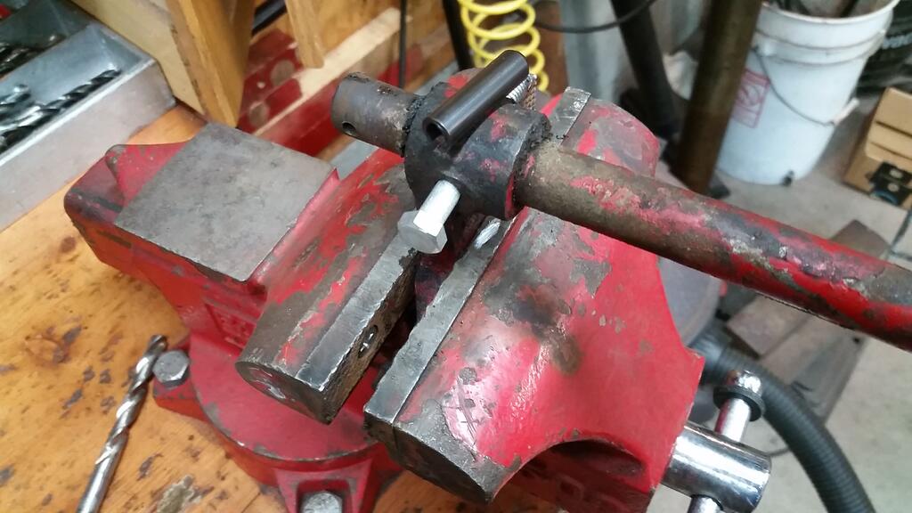

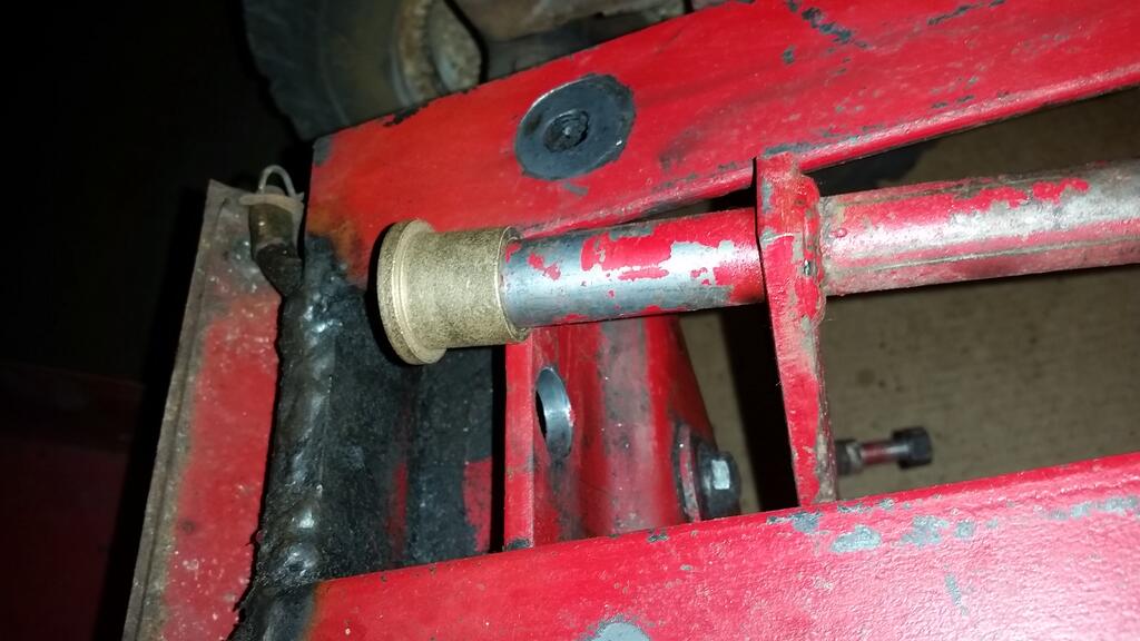

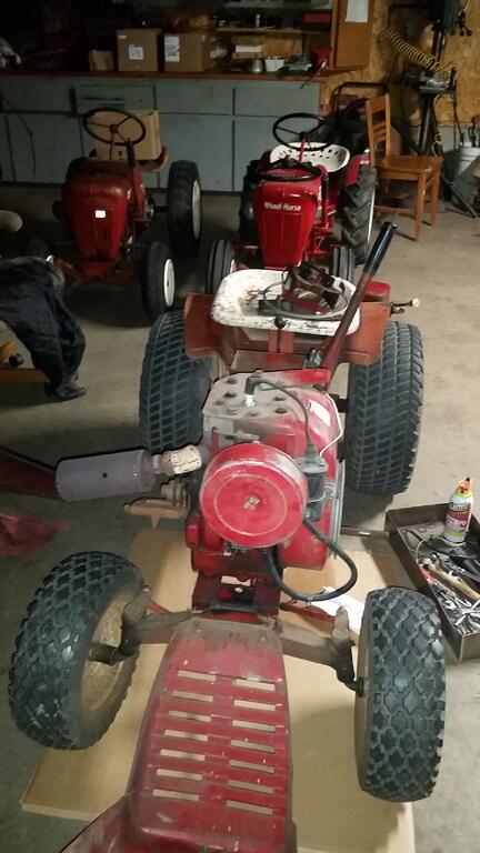

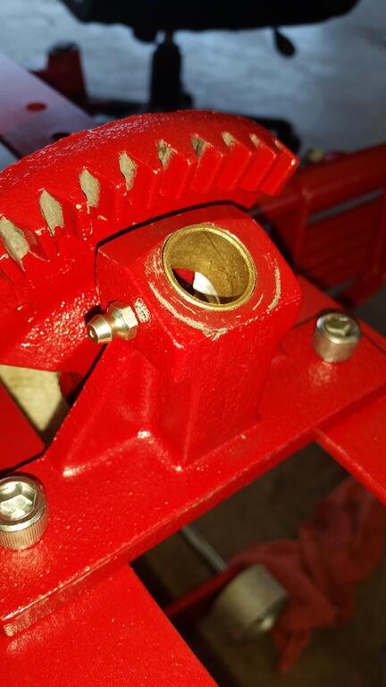

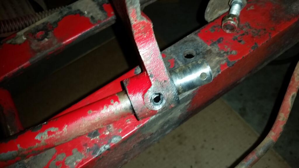

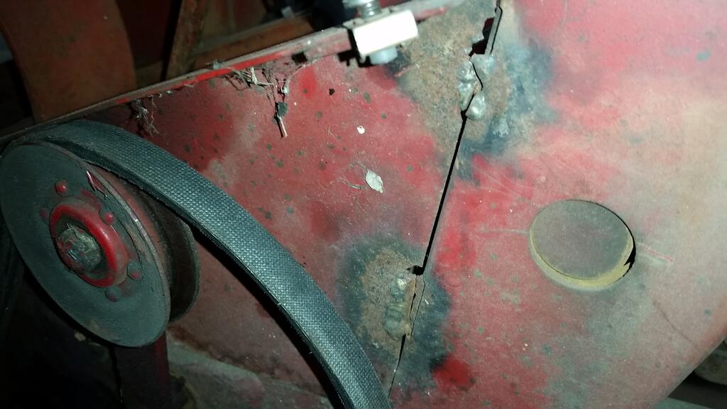

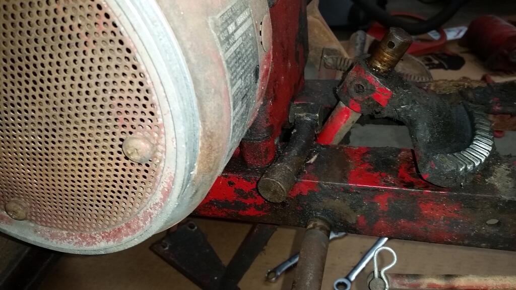

WHX?? 57,923 #7644 Posted November 16, 2020 Worked a bit more on the 1045 today .... cleanup mostly ..ugg...wife says I smell like parts cleaner. I guess that dab behind the ears doesn't help get her in the mood. I says wadda ya want from a guy runs tractor shop Mrs. candy apple! She quieted down. Any hoo redrilled & pinned the fan gear to the steering shaft with a 3/8 roll pin. PO had a 5/16 bolt through it and lots of slop Also rebushed the the pinion to base and the rebushed the the steering to front plate which was wobbled out terrible. Same things I did on a 1067 resto and steers great. Last two pics but same principle. Woulda got more done if the Packers hadn't pulled it out their rear and had to watch that. 9 3 1 Share this post Link to post Share on other sites

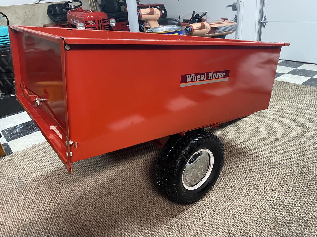

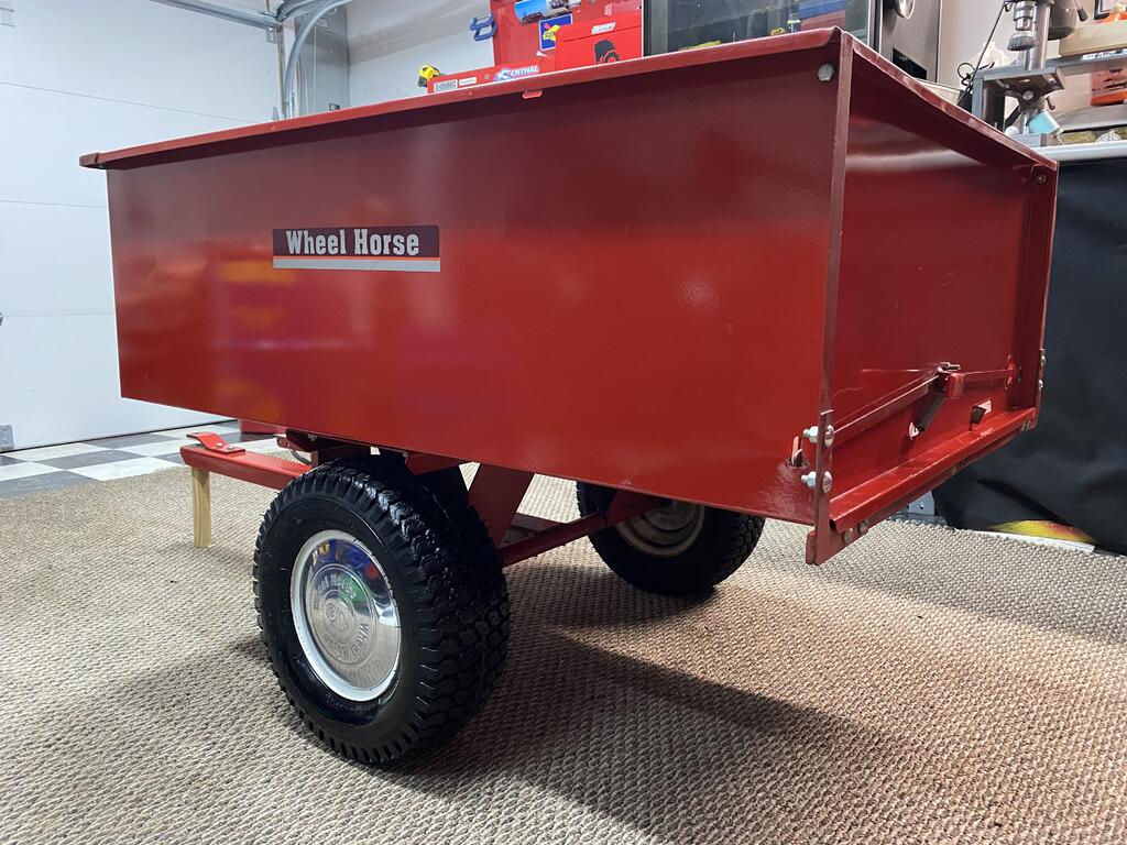

whtractors24 3,571 #7645 Posted November 16, 2020 Cleaned up This nice original cart today 3 7 Share this post Link to post Share on other sites
Horse Newbie 7,405 #7646 Posted November 16, 2020 22 minutes ago, whtractors24 said: Cleaned up This nice original cart today Is that a "show" cart ? 1 Share this post Link to post Share on other sites
