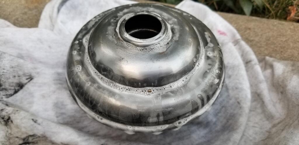

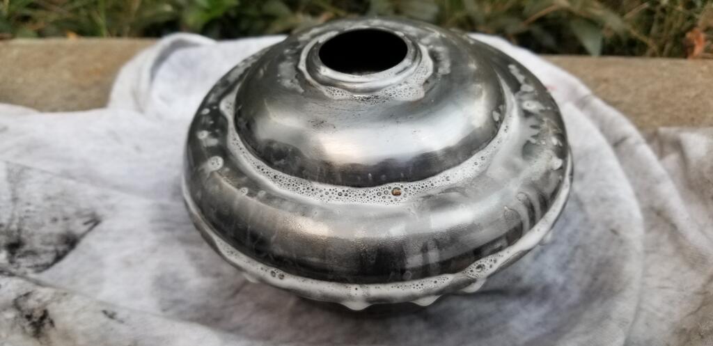

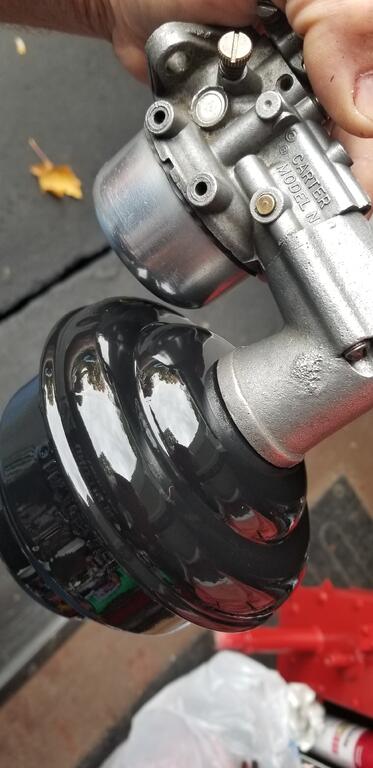

76c12091520h 4,282 #7251 Posted October 24, 2020 49 minutes ago, AMC RULES said: Hope you didn't wash off the gold plating these are coated with ....... 1 1 Share this post Link to post Share on other sites

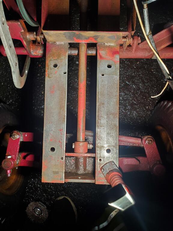

Jhook 849 #7252 Posted October 24, 2020 Cleaning up the mounting area so i can start to mock up the predator 212 swap on the 62', after thats squared away the tractor will be further disassembled and sanded down to prep for a last minute paintjob before it gets too cold. Picking up a factory hood for it on Sunday. Hoping to start the predator for the first time tomorrow. 2 Share this post Link to post Share on other sites

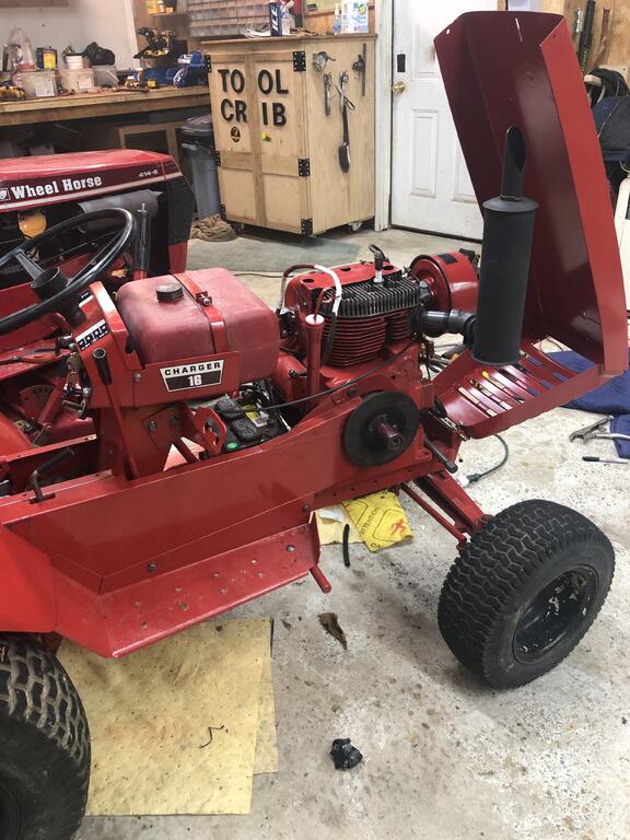

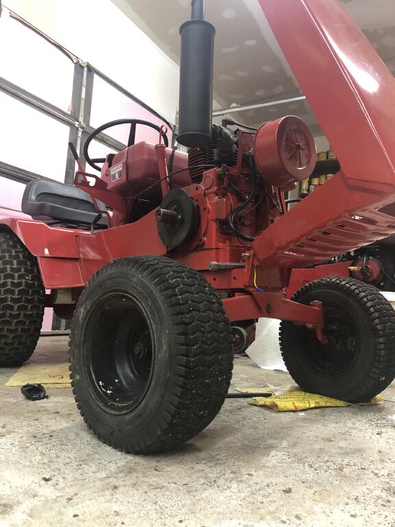

The Tuul Crib 7,354 #7253 Posted October 24, 2020 Did some fine tuning on the sweet 16 today. All the adjustments needed to make it all come back together.! 4 4 Share this post Link to post Share on other sites

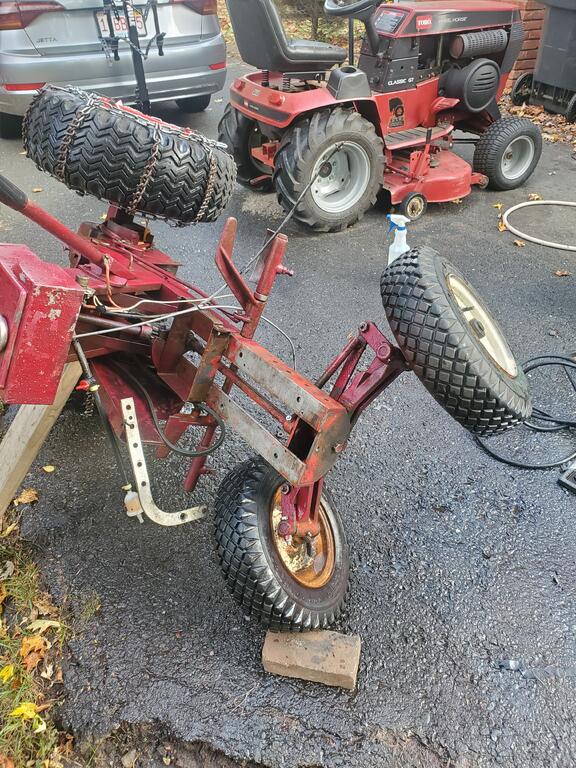

8ntruck 9,246 #7254 Posted October 24, 2020 Spent some time with my angle grinder removing the old tow behind hitch on my de-thatcher so I can start its conversion into a front mount de-thatcher. You can see the start of the caster frames for the gage wheels behind the drill on the bench as well. Will need to pick up some 3/4" round in order to proceed to the next step. Yes, I have a thread going on this in the Implement section. 5 Share this post Link to post Share on other sites

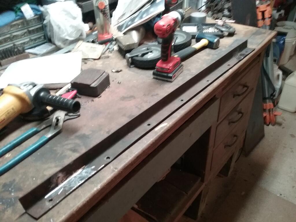

ohiofarmer 3,475 #7255 Posted October 24, 2020 I finally got my welder working so I could repair the front mounting plate for the seat pan. This part fastens to the transmission tunnel and on the three tractors I have that have the under seat fuel tank, the holes on the tunnel crack or break out. I used some bed frame angle in that the stuff is thicker than the tractor steel and is very tough. Still not satisfied, i took some furniture steel from a recliner and am in the process of mounting that to the rear seat pan/ fuel tank frame. i missed the alignment of the seat holes, got frustrated and quit for the day because now i have to grind off a weld. I will show the procedure on a separate repair thread because it is such a problem on the later machines with the thinner steel. That bed frame steel does not like cheap drill bits, and i finally got it drilled by sharpening some smaller bits and using a step drill to finish. I also had a 12 horsepower kohler cast iron that became very hard to start . i pulled the head and there was some coked deposits around the valves that had broken free. Methinks that some of that material caused the valves not to seal.I think that from now on, when I but a horse, it will be automatic proceedure to pull the head and check for valve adjustment and sealing and general condition.. Of my three last purchases that run, one of the c-145s has a .015 oversize piston that is not even broken in, and the other two need rebores at some point. I"ll be quiet now. That a lot of detail for just one day 2 Share this post Link to post Share on other sites

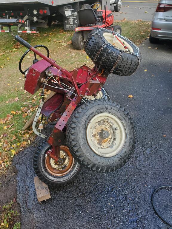

Jhook 849 #7256 Posted October 24, 2020 Pressure washing this today to get ready for sanding 3 3 Share this post Link to post Share on other sites

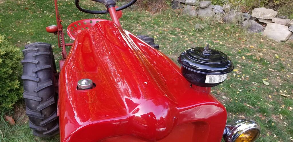

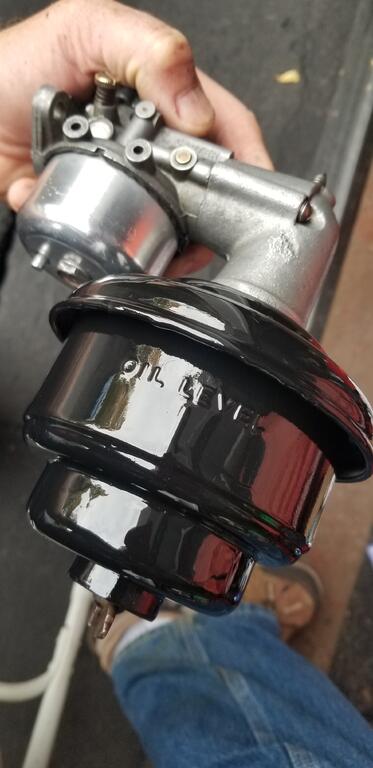

AMC RULES 37,259 #7257 Posted October 24, 2020 2 11 Share this post Link to post Share on other sites
oldredrider 2,553 #7258 Posted October 24, 2020 @AMC RULES I hate your guts! You're setting the standard too high for the rest of us! 1 5 Share this post Link to post Share on other sites

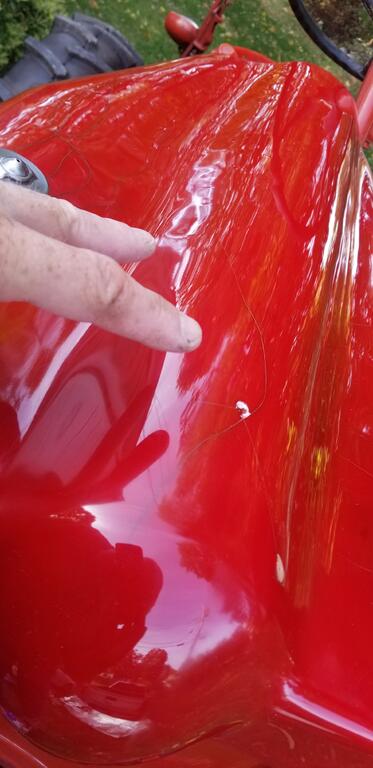

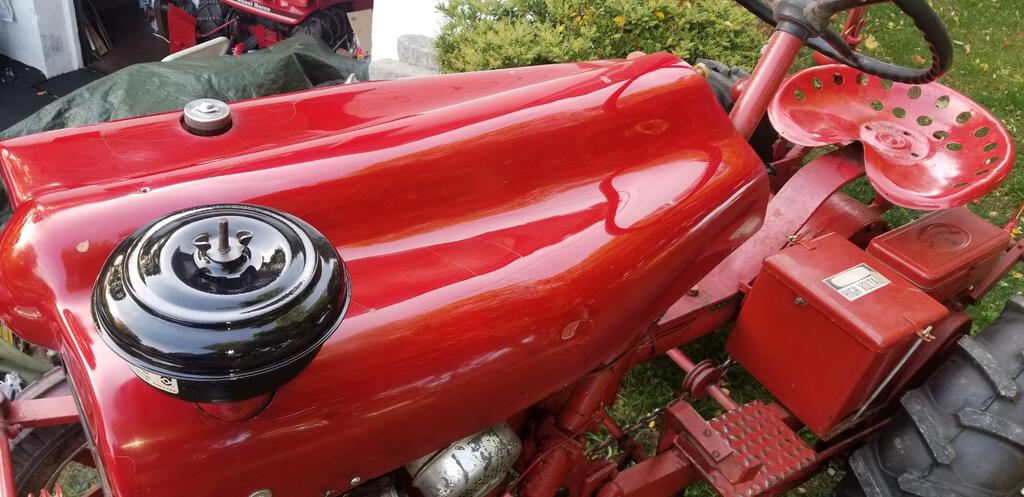

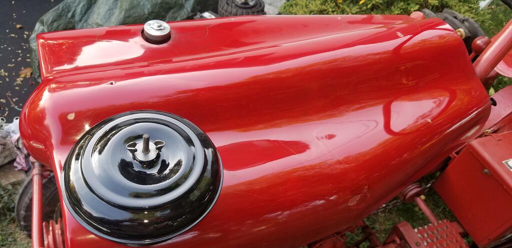

AMC RULES 37,259 #7261 Posted October 25, 2020 Getting better every day! 3 7 1 Share this post Link to post Share on other sites
WHNJ701 4,173 #7263 Posted October 25, 2020 2 hours ago, AMC RULES said: Getting better every day! Might be time to restore an old vette 1 Share this post Link to post Share on other sites

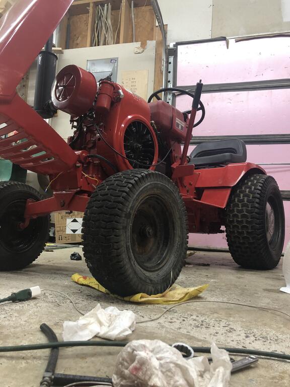

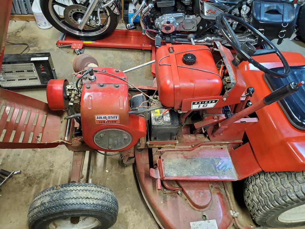

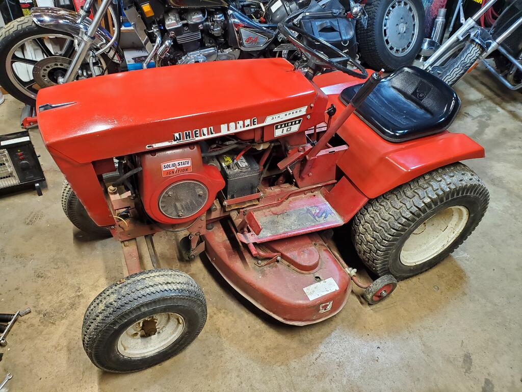

ArturHawk 195 #7269 Posted October 26, 2020 The Raider 10 needed a new positive battery cable today after the old one fell off. PO had a bad connection and burned most of the terminal away. I had it sandwiched with some oversized washers on the battery end. When it fell off after starting, I figured it was time to fix it right. Unfortunately, I needed to take the fuel tank off to get to the ignition. While waiting for the spilled gas to dry, I decided to do a little bit of cleaning and waxing. I think it was @AMC RULES that said they used Johnson's paste wax to make their old machines look good. I had a can around and got to work. Also grabbed my 303 aerospace protectant. Got the hood, fenders, seat, steering wheel, gas tank, engine tins, and air cleaner looking pretty decent. If I need to burn some more time I'll continue. Oh, and I unclogged the breather in my gas cap. I was thinking it might have been part of my problems getting this horse to run right, but it wasn't. Might try installing my other carb to see if it works better. 10 Share this post Link to post Share on other sites
AMC RULES 37,259 #7270 Posted October 26, 2020 Looking spectacular! 1 Share this post Link to post Share on other sites
ebinmaine 80,464 #7271 Posted October 26, 2020 5 hours ago, AMC RULES said: Looking spectacular! Agreed! Share this post Link to post Share on other sites
ebinmaine 80,464 #7272 Posted October 26, 2020 6 hours ago, ArturHawk said: . Might try installing my other carb to see if it works better Looks like that rubber fuel line has some age to it. IF you (or a PO) use ethanol and if it's more than ONE year old you'll need to replace that line. While switching to a different carb is of course a great time to do so. VERY nice work on the paint!! 1 Share this post Link to post Share on other sites

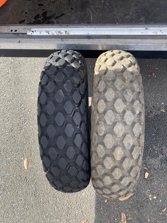

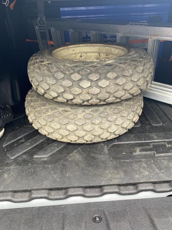

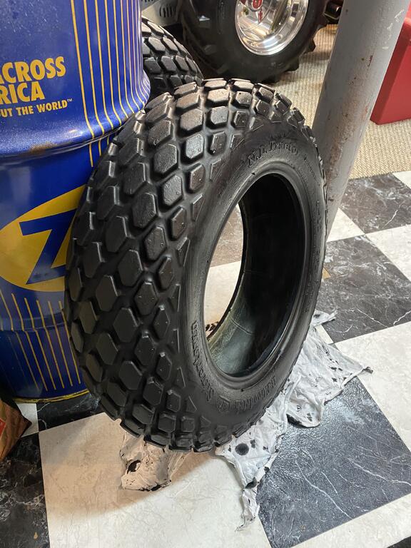

whtractors24 3,571 #7273 Posted October 26, 2020 Making silvertowns nice again . 3 4 2 Share this post Link to post Share on other sites
ArturHawk 195 #7274 Posted October 26, 2020 4 hours ago, ebinmaine said: Looks like that rubber fuel line has some age to it. IF you (or a PO) use ethanol and if it's more than ONE year old you'll need to replace that line. I actually use ethanol fuel in the tractor because the good stuff is so darn expensive. I guess i'll change the lines next year as part of maintenance, but these lines are barely 3 months old. It's been super dry around here so all my equipment looks old and not maintained from the dust. 2 Share this post Link to post Share on other sites
ebinmaine 80,464 #7275 Posted October 26, 2020 1 minute ago, ArturHawk said: I actually use ethanol fuel in the tractor because the good stuff is so darn expensive. I guess i'll change the lines next year as part of maintenance, but these lines are barely 3 months old. It's been super dry around here so all my equipment looks old and not maintained from the dust. Definitely understandable. Fine dust settles on everything really well. I haven't messed with the carburetor on a Tecumseh engine but I understand that some of the Kohler carbs can be adapted on and it's been known to make a good difference in running quality. Share this post Link to post Share on other sites
