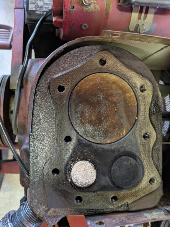

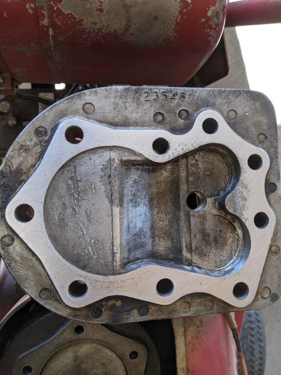

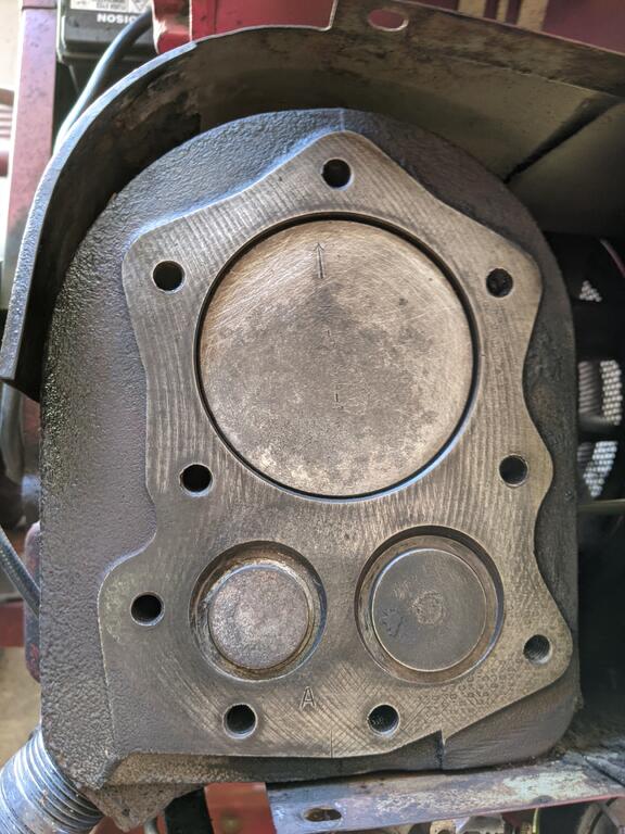

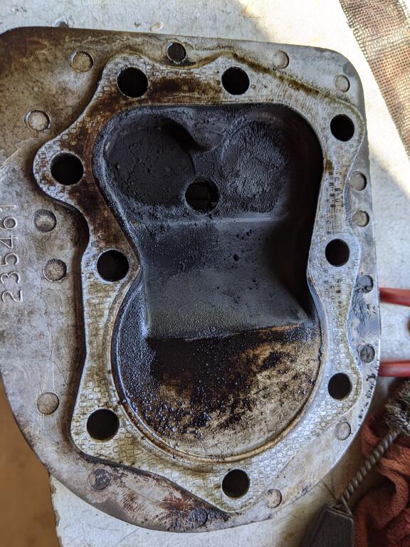

sqrlgtr 3,799 #7152 Posted October 17, 2020 1 hour ago, rjg854 said: Head gasket was leaking on the 1076, so I pulled the head and this is what I found. So obviously I cleaned it all up and sanded the head to be sure it was flat And put it back together. Torqued the head and ran it for awhile and got it nice and warm, let it cool and retorqued the bolts. I'll check it again after some more run time. Sure looks alot better,should run some better also.Can you tell any difference in performance? Share this post Link to post Share on other sites

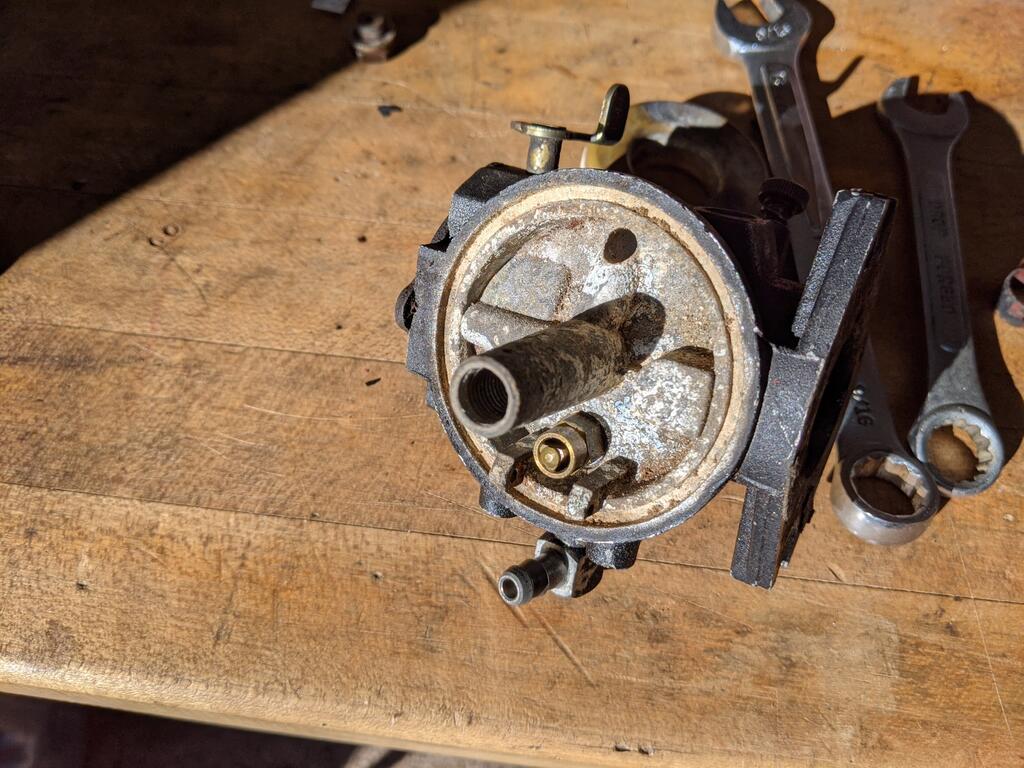

johnnymag3 2,646 #7154 Posted October 17, 2020 1 hour ago, rjg854 said: Next up was the carb on the Raider 12. And man was it nasty. The float needed adjustment, and I think it was sticking because at times I had gas leaking out from the front of the carb. Seems to run better now. So all in all it was a good day. been 20 years or more since that carb was used and ran....not bad................ 1 Share this post Link to post Share on other sites

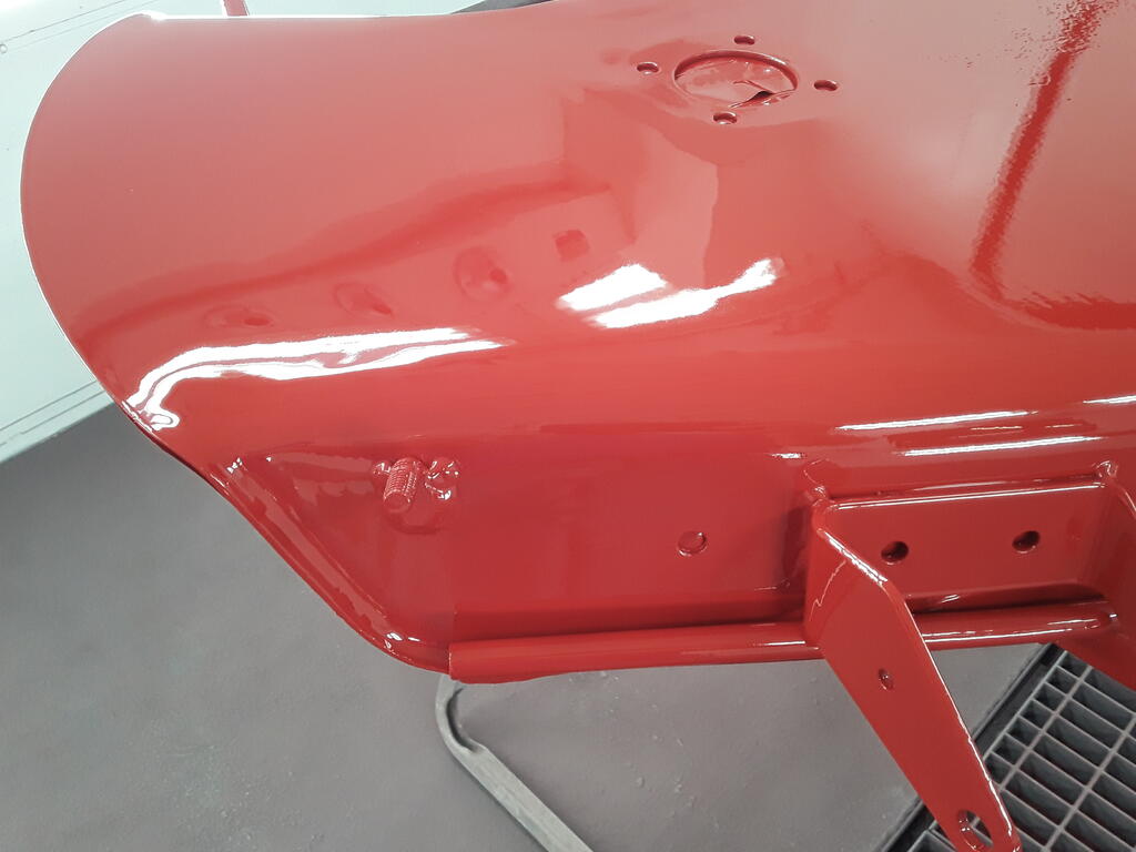

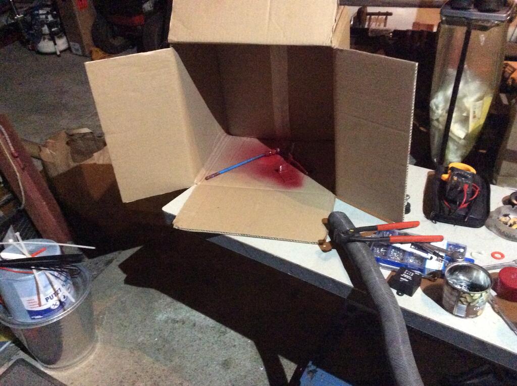

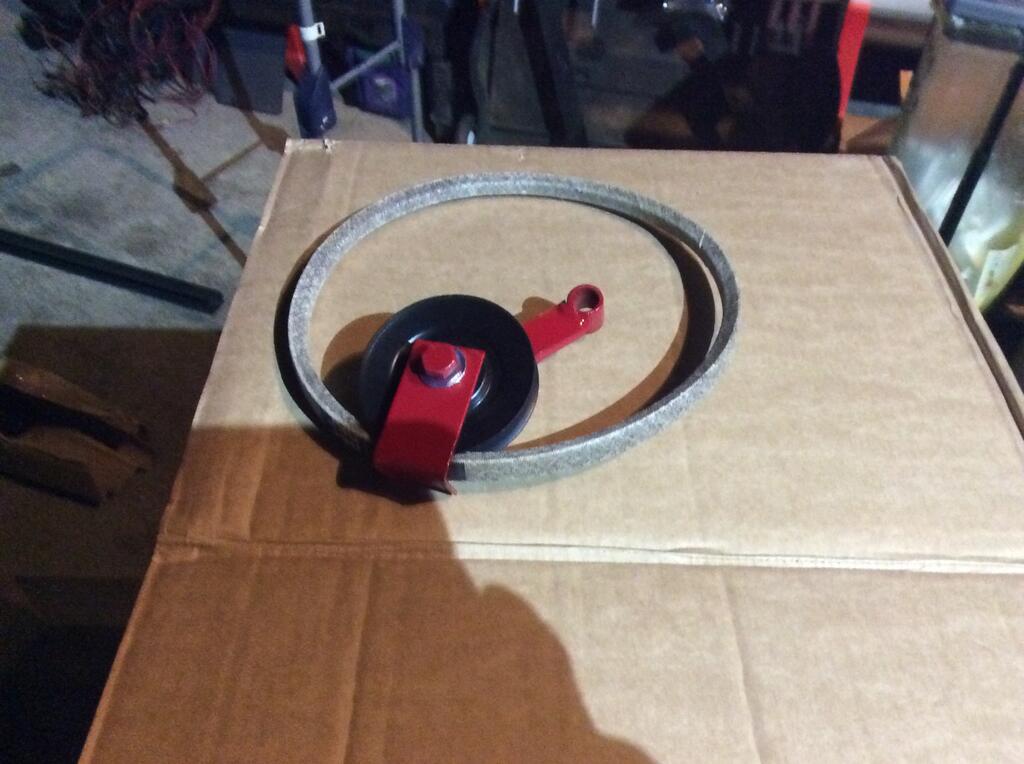

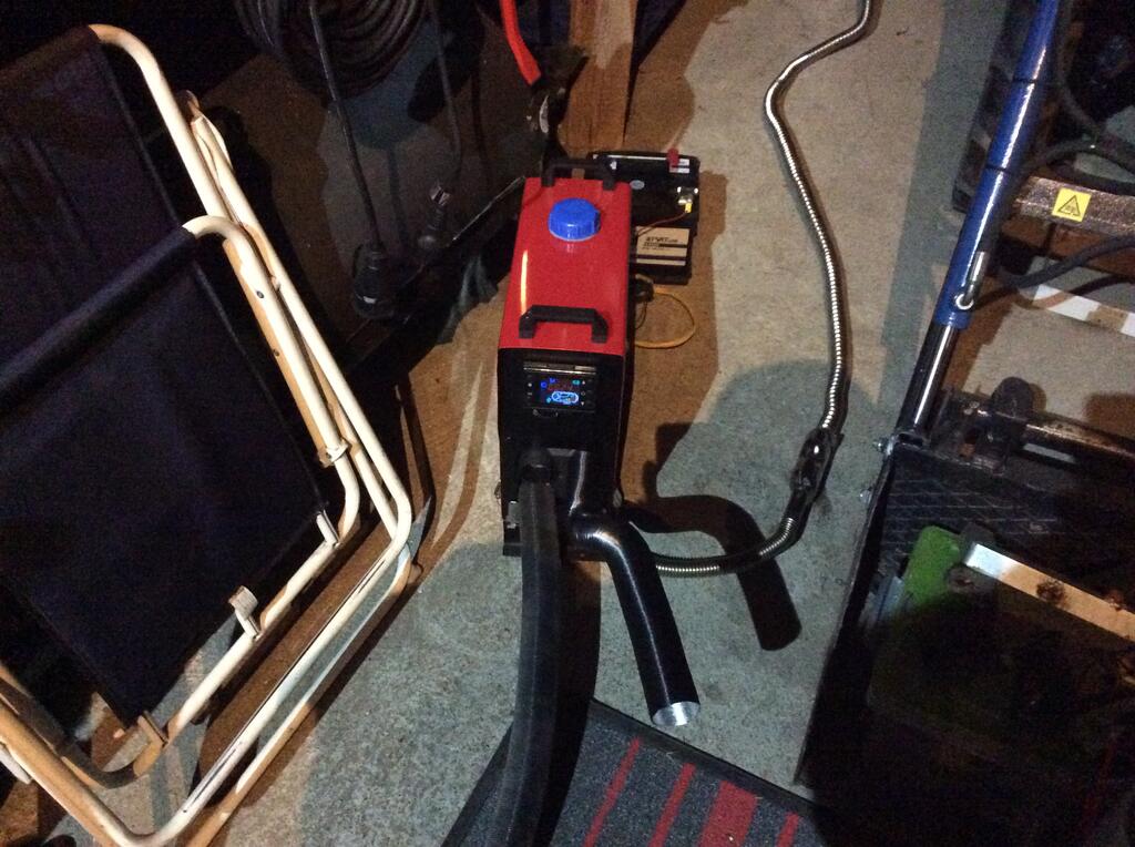

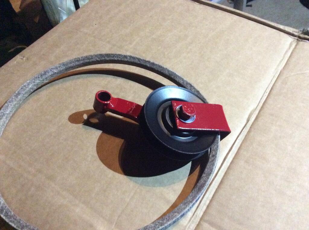

echris 1,426 #7155 Posted October 17, 2020 On 10/16/2020 at 5:26 PM, Tractorhead said: rethinkering about the idea from echris and built myself today a small heated Paint cabin.. with the Heater ( works very well) Directed one pipe into a Cardboard box missused as Paint cabin. aaand out comes a reworked mount hitch for a brandnew Idler pulley. Painted in Ruby Red RAL 3003 Brilliant! My crazy old neighbor next door takes one of those little 6" cubed space heaters, points it at the painted parts and then covers the entire area with cardboard. Just the top, so the air flows. Another idea of his (He has over 150 patents with IBM, so he's an old school idea guy)... Is your generator hard to start in the cold? When a big winter storm is on the way, put a 100w light bulb next to your generator and cover it with a cardboard box. She'll be nice and toasty by the time the power goes out. The guy has a million brilliant ideas like what you did @Tractorhead 1 Share this post Link to post Share on other sites
echris 1,426 #7156 Posted October 17, 2020 2 hours ago, rjg854 said: Next up was the carb on the Raider 12. And man was it nasty. The float needed adjustment, and I think it was sticking because at times I had gas leaking out from the front of the carb. Seems to run better now. So all in all it was a good day. Remember my unnecessary post the other day about always pulling the carb when you suspect fuel trouble? This one's a great example. Probably nothing wrong with the carb itself, but if you don't know the engine, or haven't serviced it much, carb cleaner might make it work for a while, until that crap works loose, and jams you carb up. Over and over again. Pull the carb. Smart people like @rjg854 do, so why don't you? I know I'm preaching to the choir, I just like to talk. 1 Share this post Link to post Share on other sites

rjg854 13,330 #7163 Posted October 18, 2020 1 hour ago, sqrlgtr said: Sure looks alot better,should run some better also.Can you tell any difference in performance? The thing I notice the most is that it was really loud, but it seems quieter. I'm not sure if the repair of the head has anything to do with it, it just might be my imagination. But it does run better. 3 Share this post Link to post Share on other sites

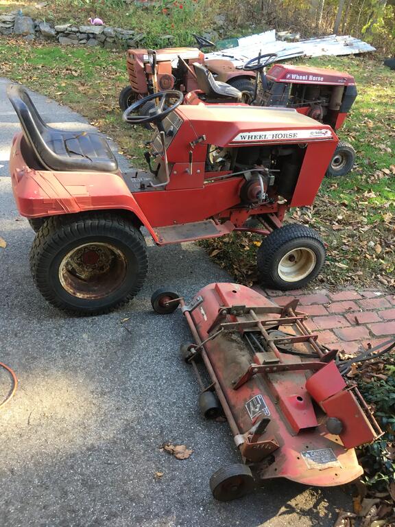

76c12091520h 4,282 #7164 Posted October 18, 2020 I got decked this morning.......... 6 12 1 Share this post Link to post Share on other sites
WHNJ701 4,173 #7165 Posted October 18, 2020 You sure did 1 Share this post Link to post Share on other sites

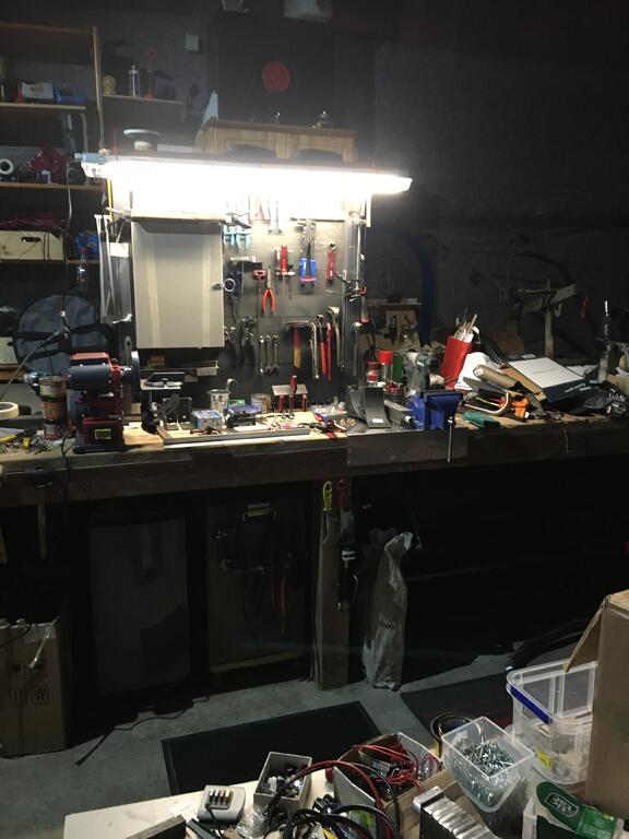

Tractorhead 9,217 #7166 Posted October 18, 2020 (edited) 9 hours ago, rjg854 said: The thing I notice the most is that it was really loud, but it seems quieter. I'm not sure if the repair of the head has anything to do with it, it just might be my imagination. But it does run better. Could be, that if the Head was before not sat clean, it now thights more after your rework and in fact it‘s more tight and in result it’s more silent. if you feel its more silent, that‘s true and this should be a good sign, except you are as deaf like me.. 😂 Di nothing on the Horse but a bit prevention to be able to work in Winter. so i insulating my Part of the Barn on the inside. At least i built a Toolboard for my self hiding tools i search most time..😂 And built at least a quick mount able high bright LED Bar to have enough light on the Work zones. Edited October 18, 2020 by Tractorhead 6 2 Share this post Link to post Share on other sites

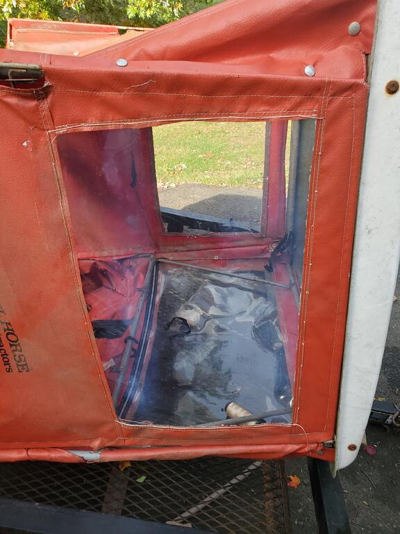

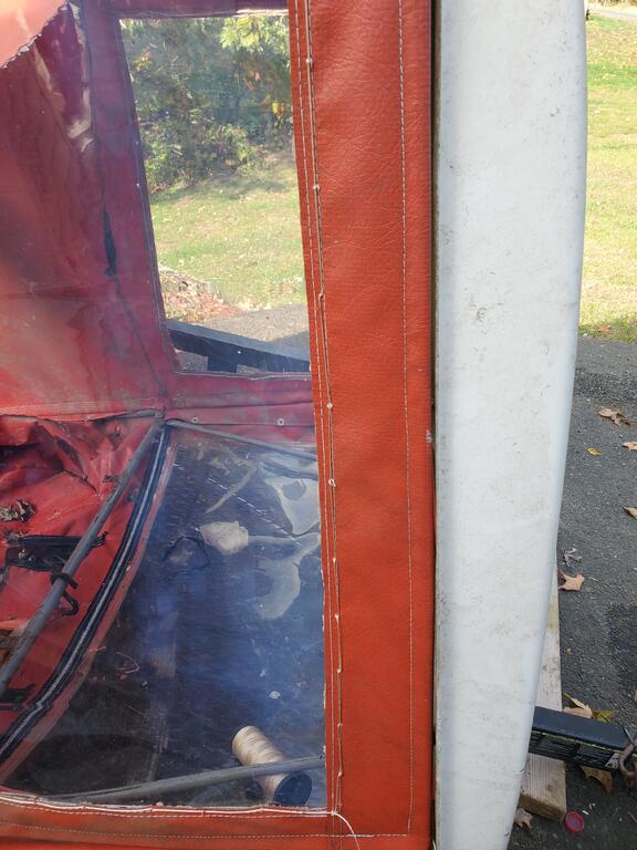

Jhook 849 #7169 Posted October 18, 2020 Another window sewn into the cab. Getting better at this. 1 more to go. 6 3 1 Share this post Link to post Share on other sites

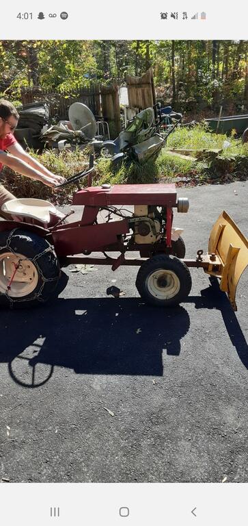

Jhook 849 #7170 Posted October 18, 2020 Can anyone tell me what this is and what its worth? Have an opportunity in go grab it now for short money. Runs and operates. No clue on model or serial number 1 1 Share this post Link to post Share on other sites
AMC RULES 37,259 #7171 Posted October 18, 2020 (edited) Franken-Horse on a good day...worth only as much as you are willing to hand over to it's seller. Edited October 18, 2020 by AMC RULES 2 Share this post Link to post Share on other sites
Jhook 849 #7172 Posted October 18, 2020 3 minutes ago, AMC RULES said: Franken-Horse on a good day...worth only as much as you are willing to hand over to it's seller. Any idea what model or anything? I have no idea what it is. Should i go buy it for 200 bucks? I have plenty of cash in the toy fund and wouldnt mind pushing snow with it. Just wNted to make sure its a genuine wheel horse lol 1 Share this post Link to post Share on other sites

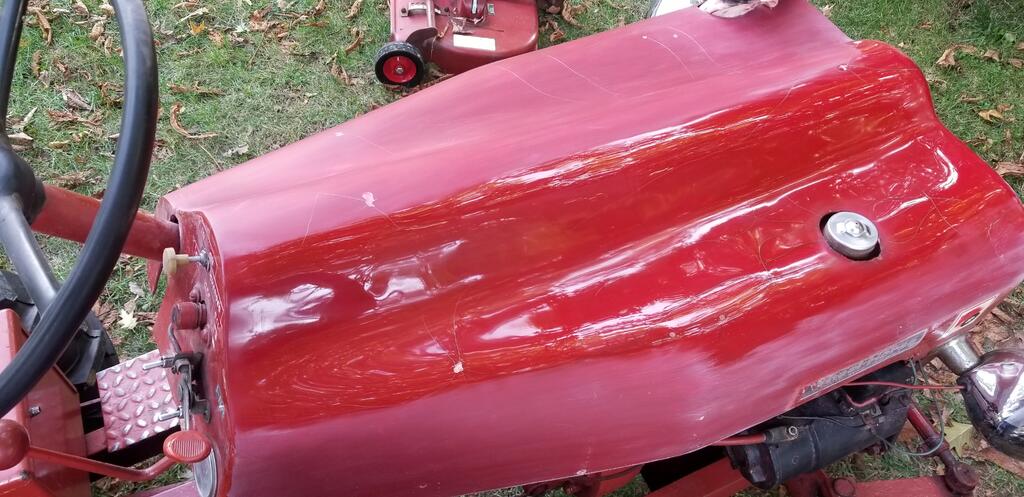

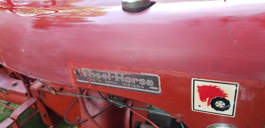

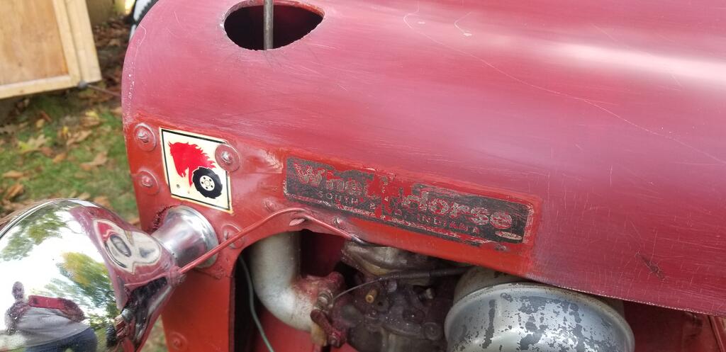

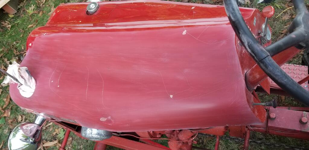

AMC RULES 37,259 #7173 Posted October 18, 2020 Got the Sr's other 1/2 of the hood sanded down to the original factory gel coat today. Thinking it really makes those original decals look like crap now. Gonna sleep on it tonight, but I'm thinking they're going to be gone by this time tomorrow. 3 3 Share this post Link to post Share on other sites
AMC RULES 37,259 #7174 Posted October 18, 2020 3 minutes ago, Jhook said: Any idea what model or anything? Appears it started life as a round hood of some type, what exact model # is anybodys guess at this point. '62-'64 era is my guess. You're at least gonna need a replacement hood to start putting it back to original. So, factor that into your final offer on it. Share this post Link to post Share on other sites
Jhook 849 #7175 Posted October 18, 2020 7 minutes ago, AMC RULES said: Appears it started life as a round hood of some type, what exact model # is anybodys guess at this point. '62-'64 era is my guess. You're at least gonna need a replacement hood to start putting it back to original. So, factor that into your final offer on it. Well i like it so im gonna pay him the 200 and go from there. Not bad in my opinion for a running plow machine. Will have closeups later when shes home! Excited for my 2nd ever wheel horse👍👍 3 Share this post Link to post Share on other sites
