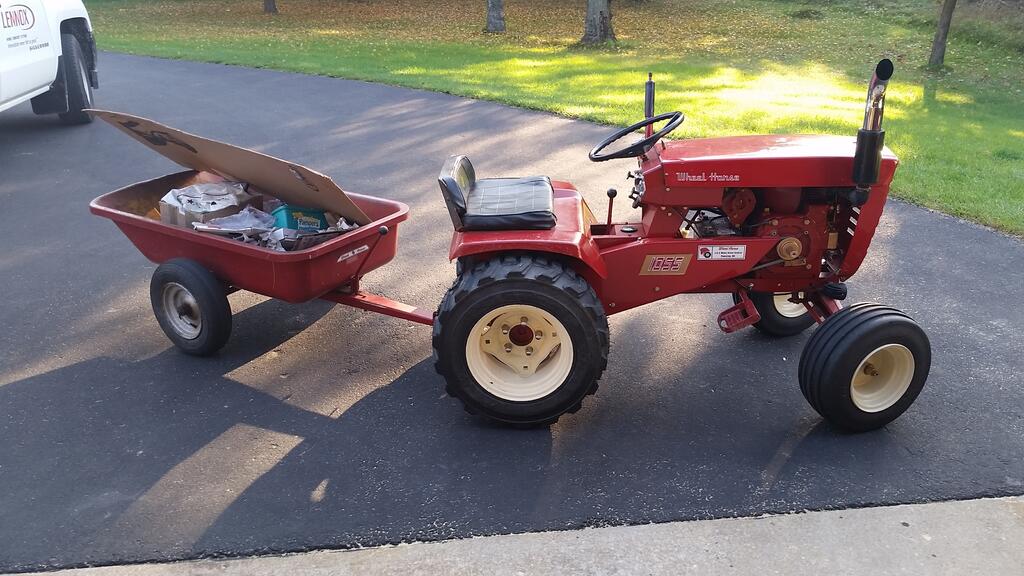

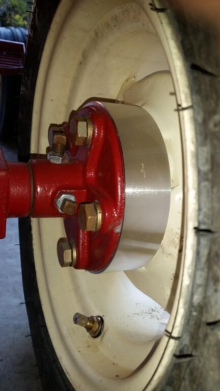

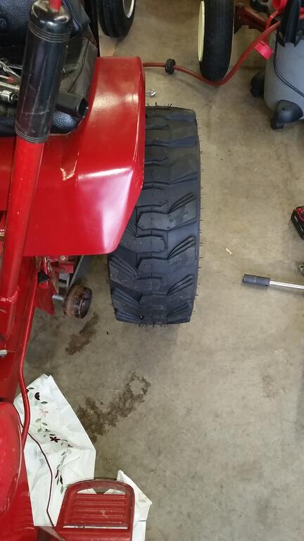

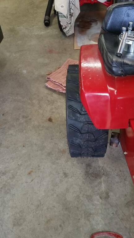

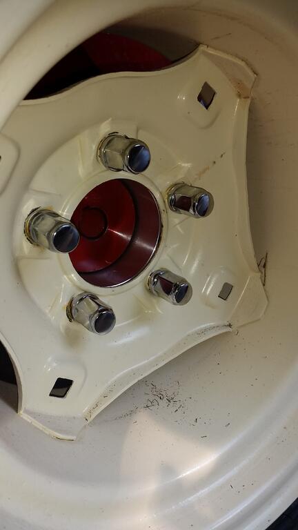

WHX?? 57,922 #6953 Posted October 10, 2020 (edited) FINALLY got the wheel spacers on the 1055 ..... what a bunch of screwing around! Hardware issues mostly. Spacers are all set up for 1/2-20. Studs are of course 7/16 but the studs I had were too short ... githerdone! Drilled the hub holes out to 1/2" and used 1/2-20 x 2" bolts. Dang near killed me to take the 7/16 threads out of the hubs but I just kept telling myself @Achto has no problem removing 60 yo metal! Lock washers are ther 'cause the bolts were just a 1/8" too long. Thanks Dan you corrupted me! Wonder if 60 years from now some FO (future owner) will go ... WTF was this guy thinking?!?!? Before After Amazing what just an 1 1/2 will do. Rears line up perfect with the new V-61's on wider rims on the front now. Edited October 10, 2020 by WHX24 6 2 Share this post Link to post Share on other sites

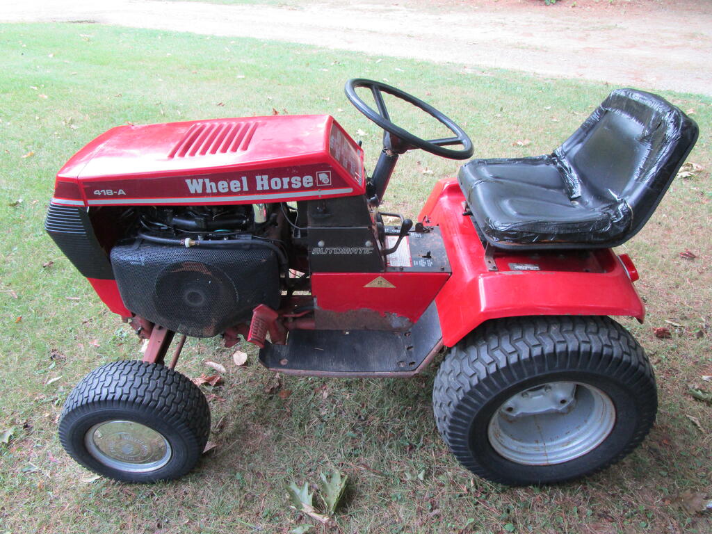

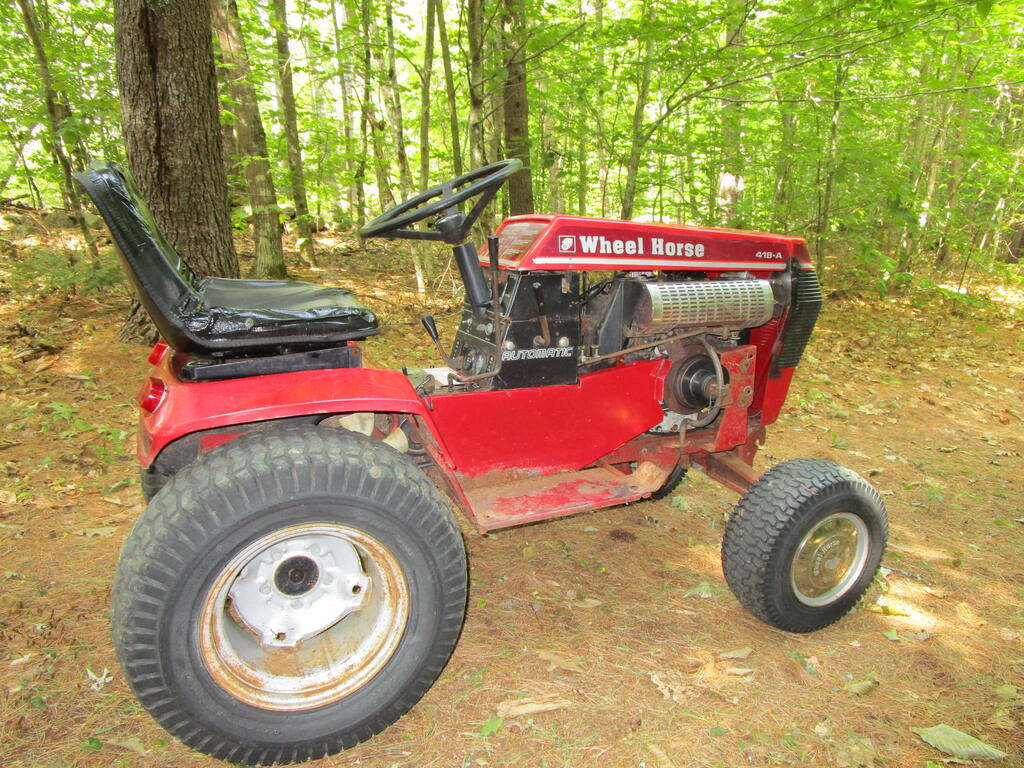

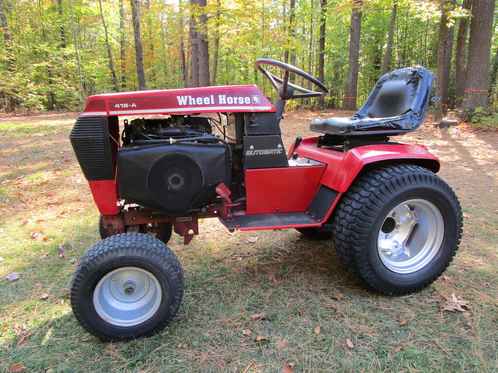

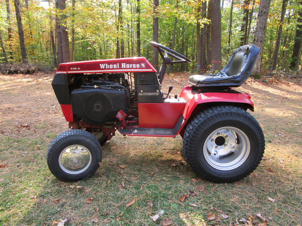

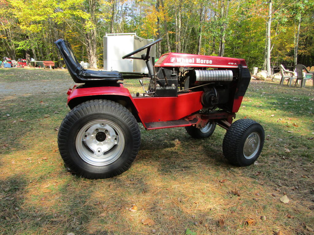

JCM 11,406 #6955 Posted October 10, 2020 Now that our painting days are getting shorter I figured with the weather today was a good time to paint the rear wheels on the 418-A. I removed the chrome hub caps on the front to see what the condition of the wheels were and there was about a half a tube of grease all over every inch of both wheels. decided not to paint them at this time. Both side covers and footrests were done in late August. I recently bought this and have been doing a few things as time allows. Painted the black center of the rear hubs and installed a rear hitch for the 48'' dozer blade that I have not used since the early 90's and thought I would try it with a Hydro tractor for cleaning up after light snow storms. Have included pics when it came home and a few from today. 5 6 Share this post Link to post Share on other sites

Achto 32,510 #6959 Posted October 10, 2020 1 hour ago, WHX24 said: Thanks Dan you corrupted me! Sure !!!! Blame me right away. I think it looks much better with the spacers. I would probably ditch the lock washers and use flat washers on the bolts though. I've seen too many lock washers split apart. Not a place where you would want this to happen. 4 1 1 Share this post Link to post Share on other sites
rjg854 13,330 #6961 Posted October 10, 2020 1 hour ago, WHX24 said: 1 hour ago, WHX24 said: Amazing what just an 1 1/2 will do. Rears line up perfect with the new V-61's on wider rims on the front now. And just how do we know that if there are no 1 2 Share this post Link to post Share on other sites

WHX?? 57,922 #6963 Posted October 11, 2020 15 minutes ago, Achto said: Sure !!!! Blame me right away. ditch the lock washers and use flat washers on the bolts though. I've seen too many lock washers split apart Agreed but hardware stores here are somewhat limited. ... unless you want to come and open up the 7/16 grade 8's I had .....yup thought so! Like I said Dan it was a githerdone! She was prompt put to work hauling garbage out to the burn pit! 3 1 Share this post Link to post Share on other sites

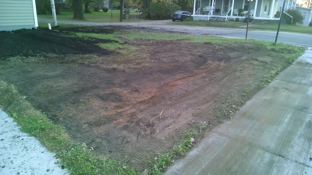

Achto 32,510 #6964 Posted October 11, 2020 (edited) I finally got around to mounting my new grader blade on to one of my tractors. My C-141 8 speed seemed to be a good candidate. My neighbor was doing some land scaping & I ask him if I could smooth out the dirt and ruts that he made with his compact tractor. I had a lot of fun playing with my new toy. The little bit I did with it turned out pretty good too. Edited October 11, 2020 by Achto 4 5 Share this post Link to post Share on other sites

WHX?? 57,922 #6974 Posted October 11, 2020 (edited) 35 minutes ago, rjg854 said: And just how do we know that if there are no Yah guess I had that one coming Randy .... before ... After Edited October 11, 2020 by WHX24 5 2 Share this post Link to post Share on other sites
