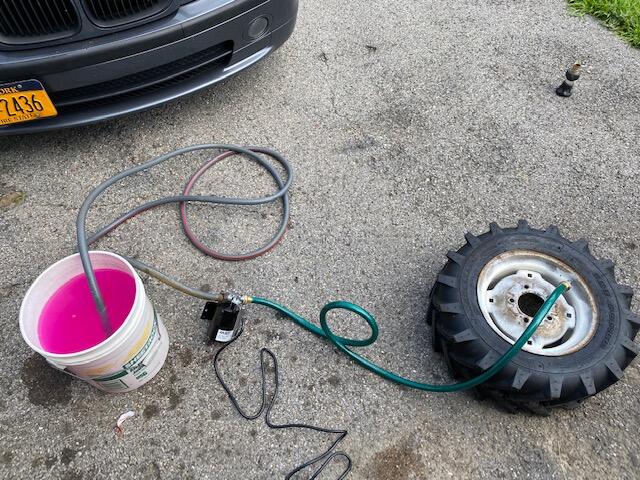

Pullstart 71,150 #5751 Posted July 15, 2020 11 hours ago, Ro-Go said: Added RV antifreeze as ballast to the new tires, front and rear. Got a transfer pump for $60 online, so tiny and cheap. Ugh. It worked, but the tires and tubes wanted to push the ballast back out; I did shut pump down 1/2 way to release air...but it still kept wanting to push out of the valve -- was there something I did wrong? 4 hours ago, ebinmaine said: @pullstart could explain how he set one up... I pushed the fluid right through the normal Schroeder valve, with the core in place. I have a portable air tank and removed the air outlet fitting and used a funnel to fill the tank with fluid. After reinstalling the outlet stuff, I charged it with 20-ish psi of air. Be careful to not over charge it, the water doesn’t compress very easy! Tip the tire up on a 45 degree or so angle, so the valve stem is high as you can get it. Tip the charged and full air tank upside down and proceed to fill the tire like normal. You may need to put some more air in occasionally but it forces the fluid right through. 3 Share this post Link to post Share on other sites

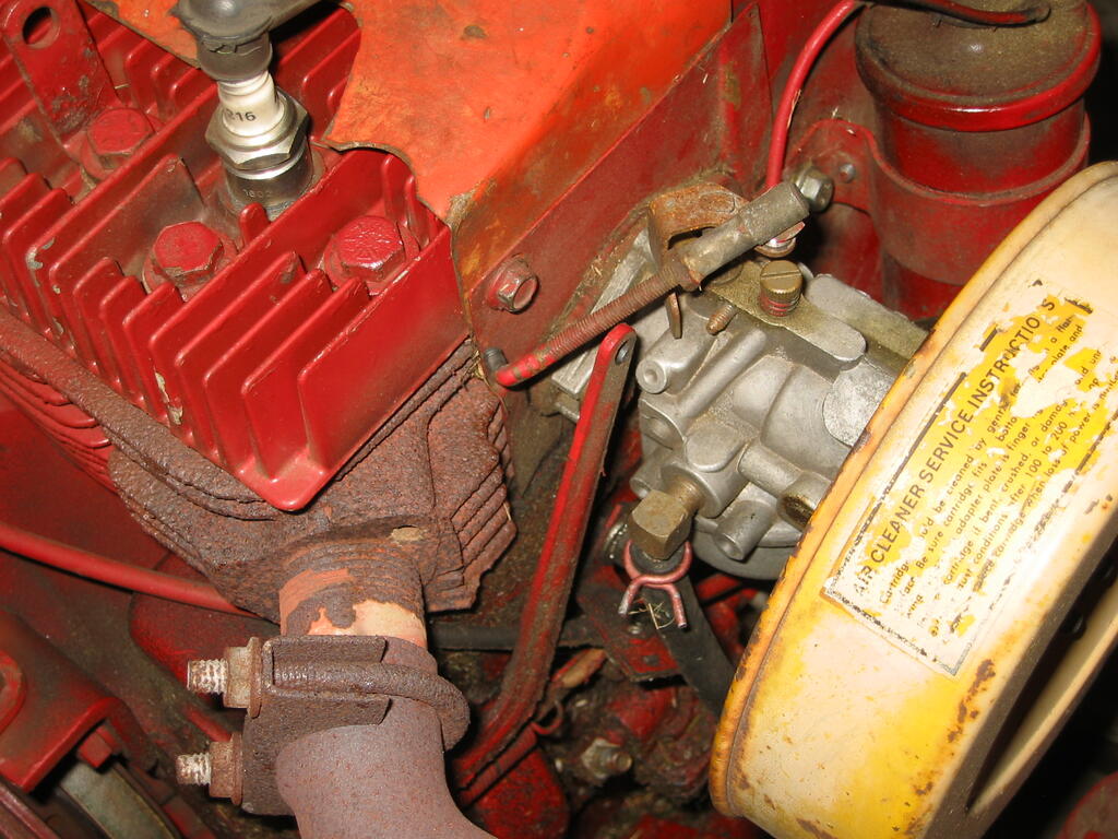

pfrederi 21,095 #5756 Posted July 15, 2020 Was finishing up mowing yesterday C141 started to die like she was out of gas. Headed back to shop the thene engne started to race Throttle had no effect. Pulled some choke that slowed it down limped in to the shop. Lost the E clip that holds the governor arm to Carb linkages.... Nice to have an easy fix once and awhile and a failure near the workshop... 14 Share this post Link to post Share on other sites

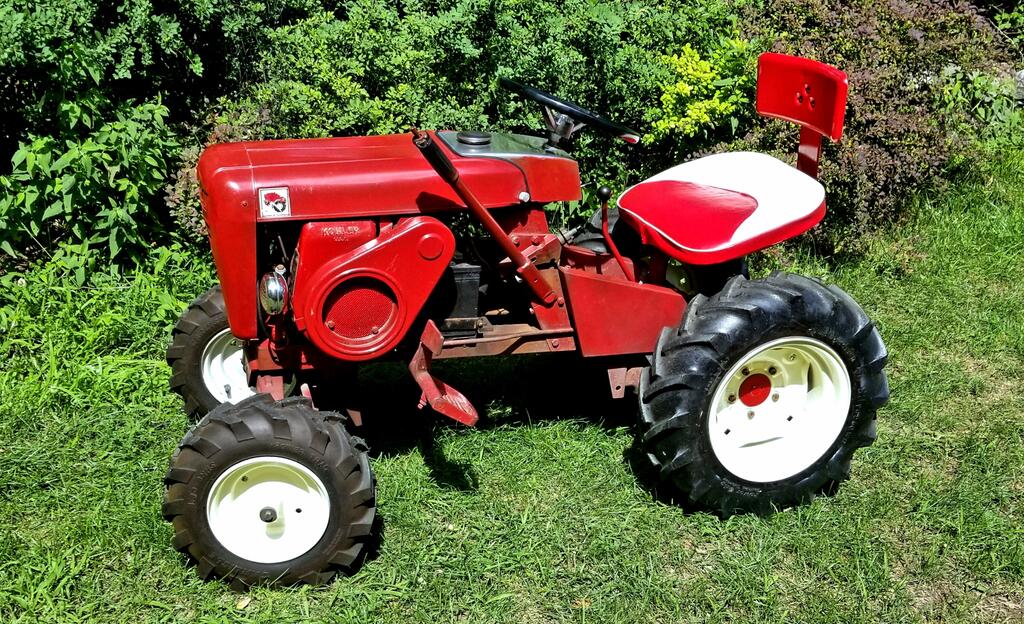

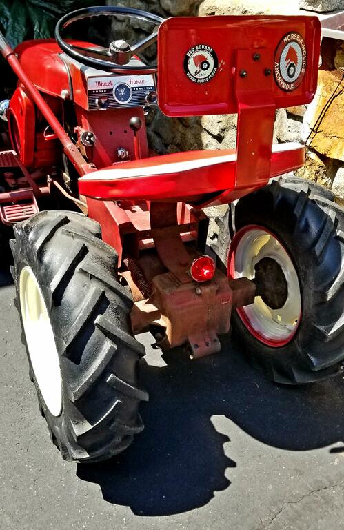

AMC RULES 37,259 #5758 Posted July 15, 2020 Got my big old plush W-H love seat cover installed today.Oh...and a matching PMCO bullet tail light to finish off my recently installed HL-5 light kit. 4 8 Share this post Link to post Share on other sites
echris 1,426 #5759 Posted July 17, 2020 (edited) On 7/15/2020 at 11:52 AM, pfrederi said: Was finishing up mowing yesterday C141 started to die like she was out of gas. Headed back to shop the thene engne started to race Throttle had no effect. Pulled some choke that slowed it down limped in to the shop. Lost the E clip that holds the governor arm to Carb linkages.... Nice to have an easy fix once and awhile and a failure near the workshop... Best kind of fix. Simple. And if you don't have the correct clip a piece of ~18g copper wire wrapped around the groove and twisted a few turns will do the trick! Edited July 17, 2020 by echris 3 Share this post Link to post Share on other sites

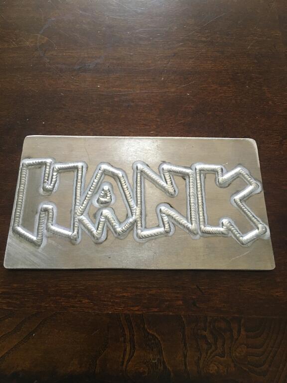

19richie66 17,932 #5761 Posted July 17, 2020 (edited) So I’m one of those guys that names his tractors. I decided to make “license plates” for them with thier names on them. Finished the first one for my 953. I named it after my ex-father as he was a very hard worker, simple and no frills kinda guy...... same as this tractor. A fitting tribute to the man. Edited July 17, 2020 by 19richie66 No, I didn’t weld it 😁 7 4 4 Share this post Link to post Share on other sites

19richie66 17,932 #5764 Posted July 17, 2020 1 minute ago, Ed Kennell said: First there was @wallfish tooth pick art, then @Dan.gerous swizzle stick art, now we have @19richie66 tig art. What a bunch of talented artists. Thanks Ed but that’s all my son’s handywork with the tig torch. I cut, scribed it out and he zapped it. 6 minutes ago, WHX24 said: Tell ya right now guys are gonna be pestering you with orders! My son said bring it on! 7 Share this post Link to post Share on other sites

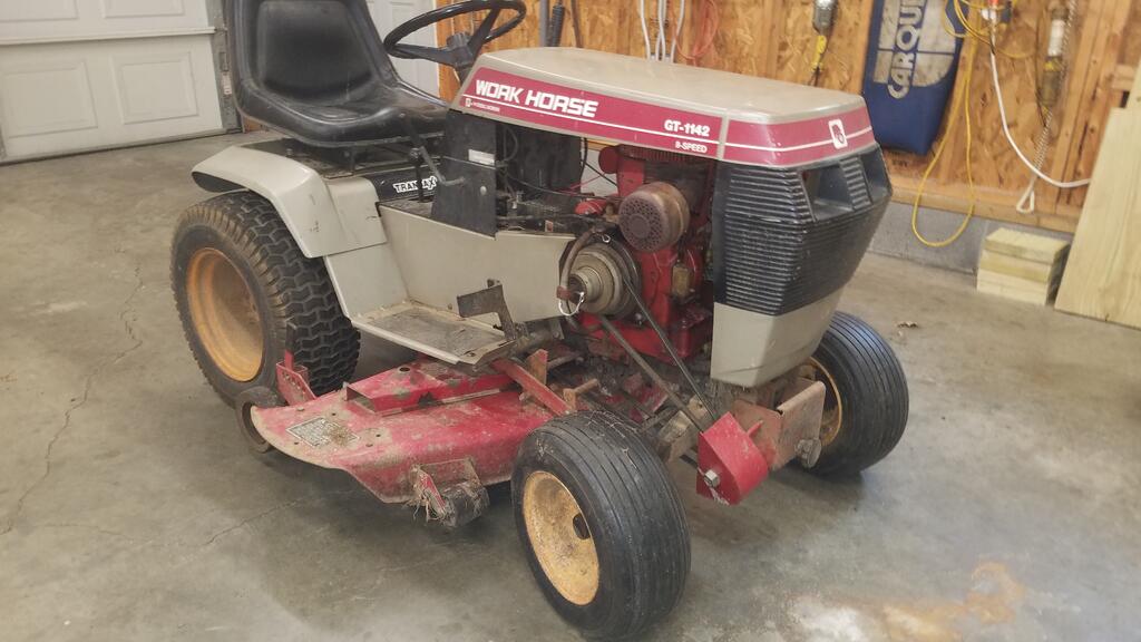

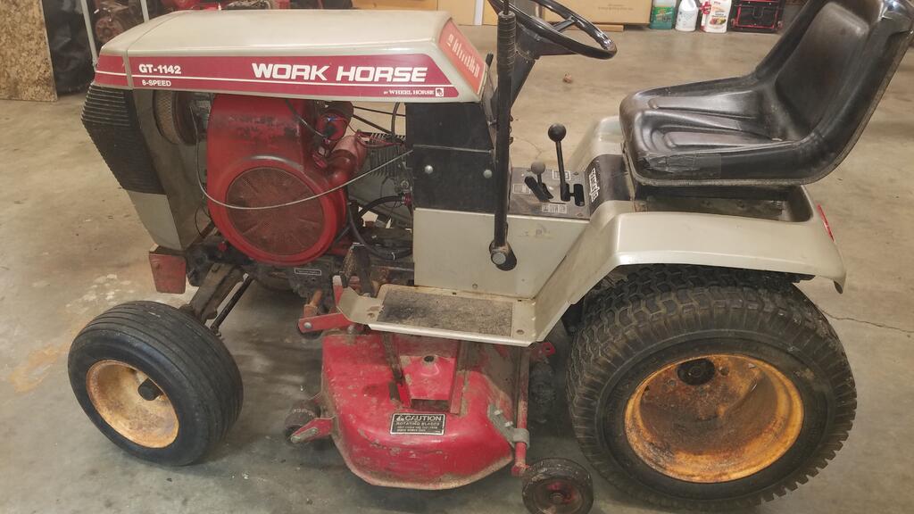

oldredrider 2,553 #5766 Posted July 17, 2020 Plucked an old 12hp Kohler off the shelf to replace a worn out and tired Briggs in a GT1142. Converted wiring for mag ignition to battery type. Basically, turned the old girl into a 312. Ready to go back to work. 7 5 2 Share this post Link to post Share on other sites

WHX?? 57,880 #5768 Posted July 17, 2020 1 hour ago, 19richie66 said: Thanks Ed but that’s all my son’s handywork with the tig torch. I cut, scribed it out and he zapped it. My son said bring it on! He is good Ritchie those beads look very uniform. 1 Share this post Link to post Share on other sites
19richie66 17,932 #5769 Posted July 17, 2020 2 minutes ago, WHX24 said: He is good Ritchie those beads look very uniform. Thanks Jim! He does this 10 hours a day making ski towers for high end ski boats. Definitely gets more practice than me. 5 Share this post Link to post Share on other sites
