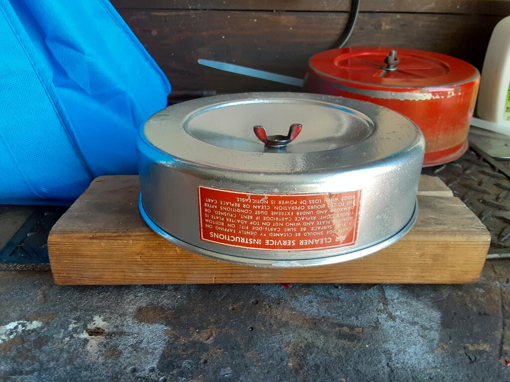

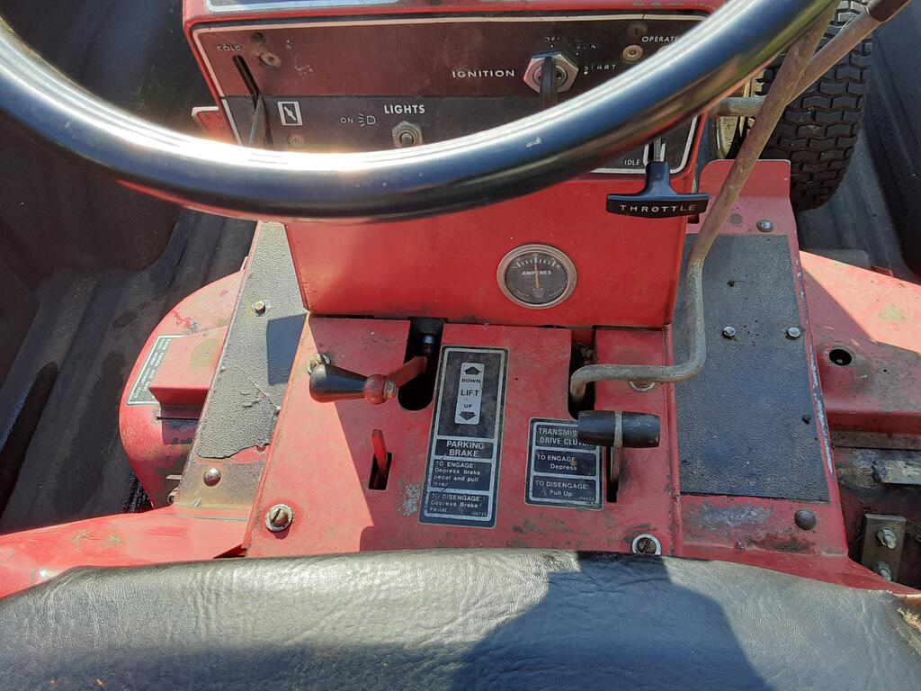

D_Mac 9,339 #5079 Posted June 7, 2020 I got the correct filter for the air cleaner. I painted the cover I picked up. Ran out of red paint so I made it silver. Looks ok I guess. Still trying to figure out why it keeps popping the fuse. I will put a new fuse in, start the engine, runs fine and both front and rear lights are on. I turn the light switch to off. I shut down the engine. Go and restart it, turn lights on and fuse is shot. Cant figure it out. Might have to cancel any " night mowing " 3 1 Share this post Link to post Share on other sites
ebinmaine 81,160 #5080 Posted June 7, 2020 2 minutes ago, D_Mac said: I got the correct filter for the air cleaner. I painted the cover I picked up. Ran out of red paint so I made it silver. Looks ok I guess. Still trying to figure out why it keeps popping the fuse. I will put a new fuse in, start the engine, runs fine and both front and rear lights are on. I turn the light switch to off. I shut down the engine. Go and restart it, turn lights on and fuse is shot. Cant figure it out. Might have to cancel any " night mowing " Those wires are run from front to rear with no protection. Very likely your tractor has a chafe in the coating of one of the wires. I've removed and replaced ALL the light wires from every horse we've ever worked on. I like my lights to be on when I want them on.... Like at 3 am in January... 4 1 Share this post Link to post Share on other sites

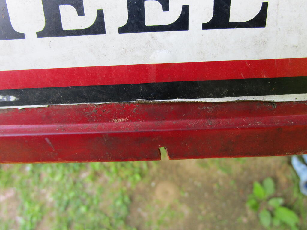

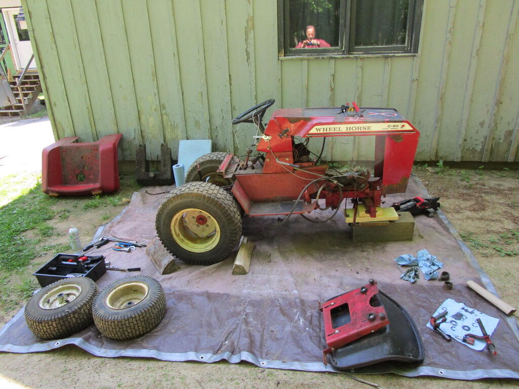

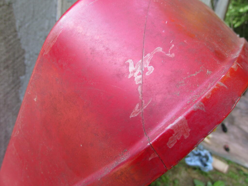

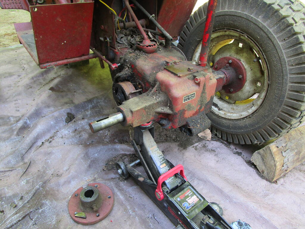

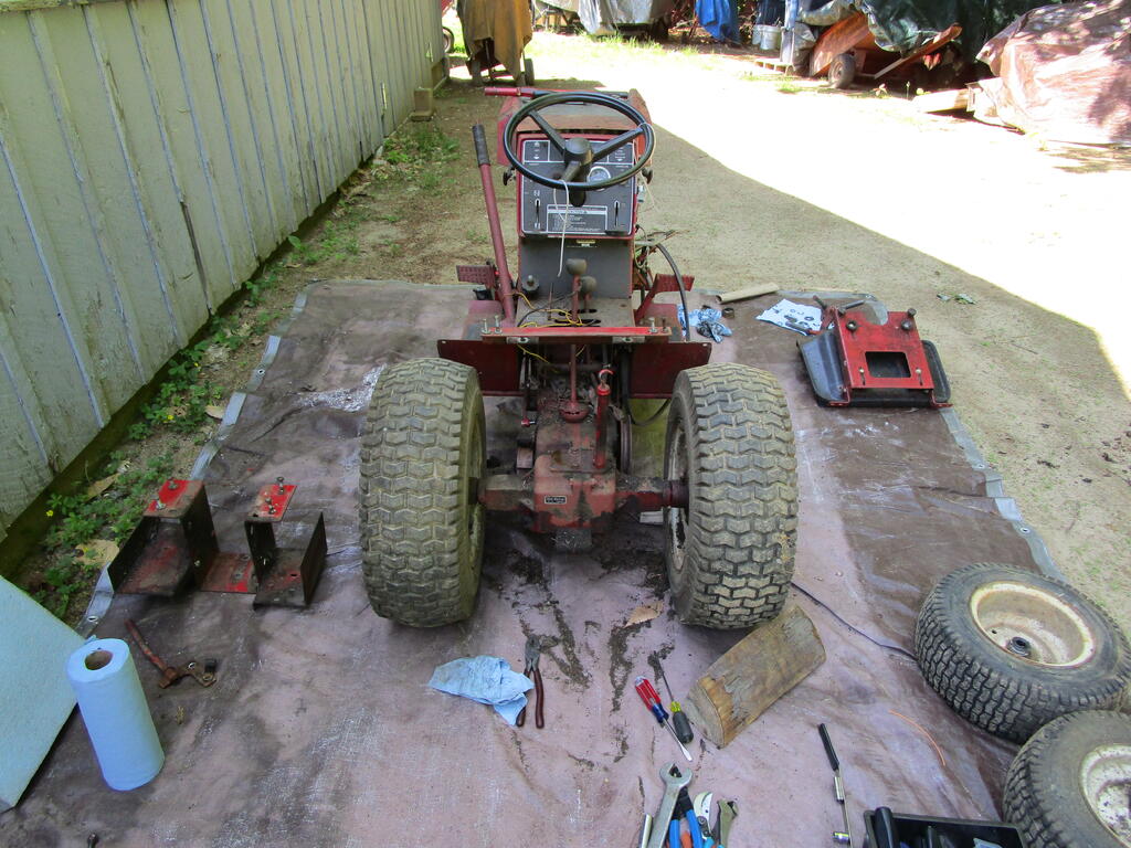

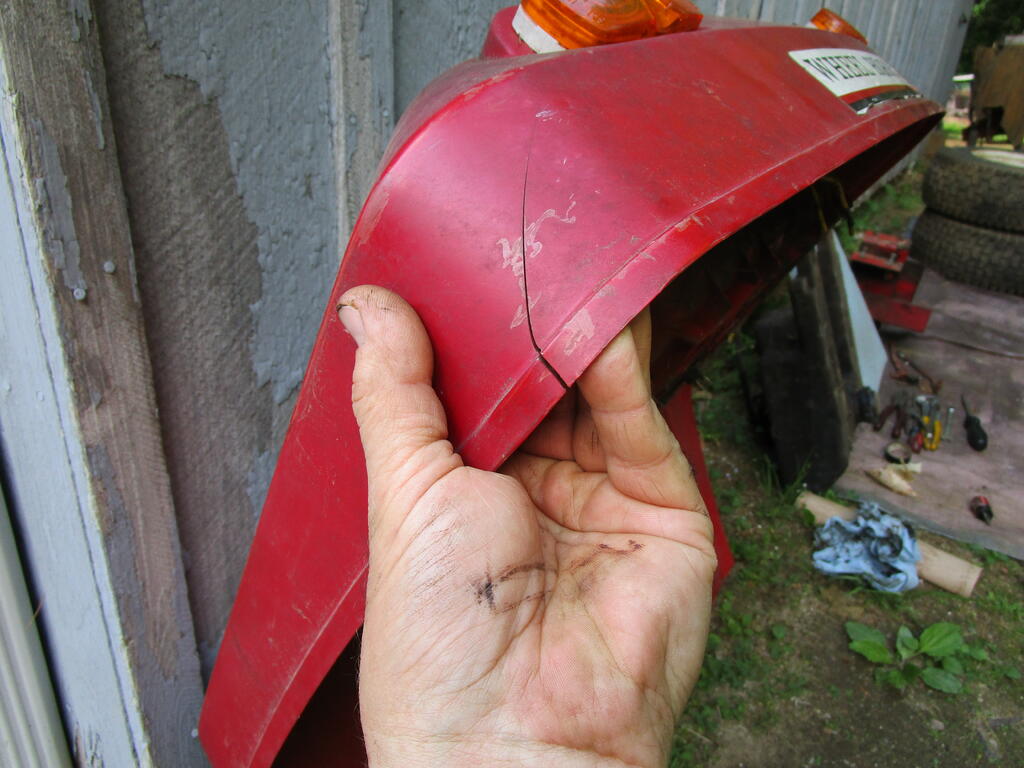

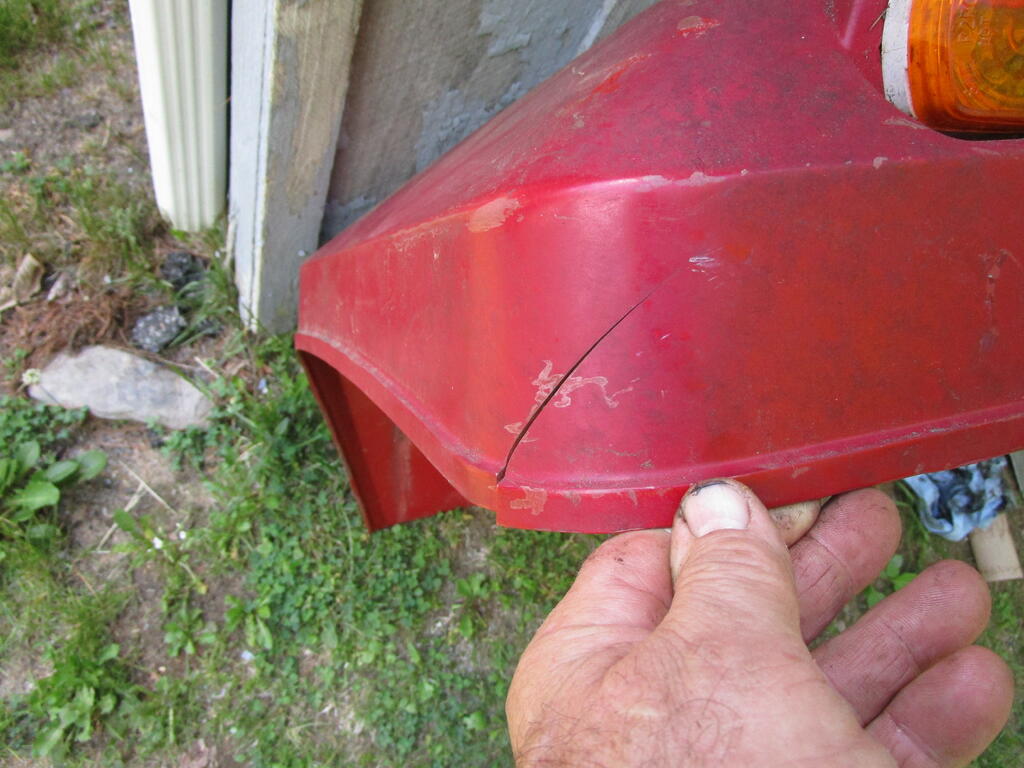

JCM 11,451 #5081 Posted June 7, 2020 Picked up this 1980 C-85 5 years ago 15 minutes from home with a free sign on it. Engine was in a rubbermaid tote and not looking to well. It has sat in the yard covered over thinking maybe a resto some day and that day never came, to many other projects. Turn the page a 1989 310-8 shows up and is leaking gear oil bad but I am told it runs. Come to find out the tranny must have filled with water and froze and split the case in 2 places. So yesterday I made the difficult decision to end the C-85's life, rather a difficult decision to make for the love of WH tractors. the other side of the coin is hopefully I will end up with 1 nice tractor and some spare parts. 1 more hub needs to come off and then transplant the uni-drive into the 310 and all will be well, I hope. That 10 H.P. Magnum sure does run sweet so hoping for the best. The other way to look at it is I still have the C-165 to keep me in the Blackhood club. Almost forgot, that plastic rear fender was in pretty good condition other than the small notch below the decal and the crack that I had to open up to see, not bad for it's age. 6 2 2 Share this post Link to post Share on other sites
D_Mac 9,339 #5082 Posted June 7, 2020 I would like to have them working but I just dont have the correct equipment when it comes to wiring. I am starting to think it might be one of the switches? I already replaced a piece of wire that at first I thought solved the problem. Now its doing what I said earlier. Those fuses are almost a buck a piece. Getting aggravating and expensive ! Its one of those things that if the tractor didnt have lights I wouldnt care about lights. But when the lights are there.... now I care and want them working. 1 Share this post Link to post Share on other sites

ebinmaine 81,160 #5085 Posted June 7, 2020 4 minutes ago, D_Mac said: I would like to have them working but I just dont have the correct equipment when it comes to wiring. I am starting to think it might be one of the switches? I already replaced a piece of wire that at first I thought solved the problem. Now its doing what I said earlier. Those fuses are almost a buck a piece. Getting aggravating and expensive ! Its one of those things that if the tractor didnt have lights I wouldnt care about lights. But when the lights are there.... now I care and want them working. No special equipment needed. Test light is a few bucks. You'll spend more than that buying fuses by the gross so pick up a test light instead. VERY carefully and slowly remove, clean and check all the wires in that circuit. Might be a switch. Might be a wire. Wiring a DC system is not a complicated pile of wizardry. It's easy if done systematically and correctly. 2 1 Share this post Link to post Share on other sites

johnnymag3 2,646 #5089 Posted June 7, 2020 14 minutes ago, D_Mac said: I would like to have them working but I just dont have the correct equipment when it comes to wiring. I am starting to think it might be one of the switches? I already replaced a piece of wire that at first I thought solved the problem. Now its doing what I said earlier. Those fuses are almost a buck a piece. Getting aggravating and expensive ! Its one of those things that if the tractor didnt have lights I wouldnt care about lights. But when the lights are there.... now I care and want them working. Eric is right....this is a simple 2 wire installation....Ground, 12v Hot....and a switch. Go through and look at what you have...there has to be a bare spot on the 12v wire...or a bare spot on the ground touching 12v somewhere....not likely. !!! Look at the 12v Hot wire running to the headlights, and the tail lights. YOU will find an issue some place. Unless the fuse holder is defective??? or a key switch issue ??? the ACC. for the lights are in the Key Switch also. Don't over look that chance....good luck, you will figure it out !! JOHN 2 Share this post Link to post Share on other sites
D_Mac 9,339 #5090 Posted June 7, 2020 There is a key switch but no ACC position on the switch. There is also a toggle switch for the lights. Just on / off. The toggle is wired to the key and the fuse holder is wired to the toggle 2 Share this post Link to post Share on other sites
johnnymag3 2,646 #5091 Posted June 7, 2020 Then you have a bare wire someplace....Im with the guy in MAINE LOL Unless you have a weird thing going on with the fuse holder ? Share this post Link to post Share on other sites
johnnymag3 2,646 #5092 Posted June 7, 2020 Is there no Acc lug on the back of the switch? I did not mean to say ACC position....sorry Share this post Link to post Share on other sites
D_Mac 9,339 #5093 Posted June 7, 2020 lol the only weired thing going on is me trying to solve an electrical problem. 1 Share this post Link to post Share on other sites

squonk 48,344 #5097 Posted June 7, 2020 They only way a fuse will blow would be because of excessive current caused by a short to ground. Follow every inch of the wire from the switch to the lights. It has to split somewhere front to back. dollars to donuts there is a chafe or a crack in the insulation touching ground. A short in a switch is extremely rare. If the short was in the keyswitch side a wire would have burn't and you would have found out the hard way. 3 1 Share this post Link to post Share on other sites

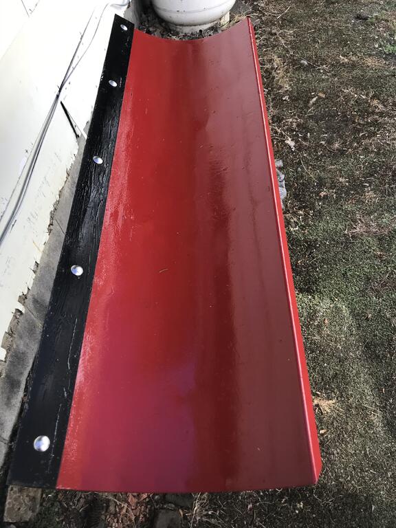

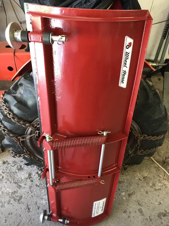

squonk 48,344 #5098 Posted June 7, 2020 Finished up the blade. Got new decals from Terry. Now if I could only get the hydraulics to work! 6 8 Share this post Link to post Share on other sites
D_Mac 9,339 #5099 Posted June 7, 2020 Blade looks nice. I was looking at the other picture of your tractor.... is that a bell on the lever ? Share this post Link to post Share on other sites

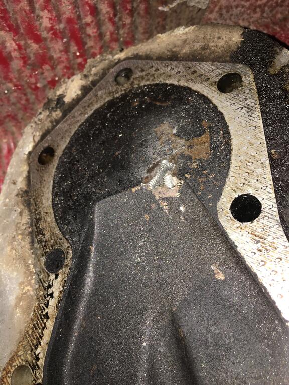

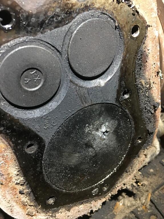

19richie66 17,950 #5100 Posted June 7, 2020 Investigation started. Findings not so good. Previous owner’s “mechanic’s” handiwork..... This will become a 417-12 A I guess for the time being. 8 Share this post Link to post Share on other sites
