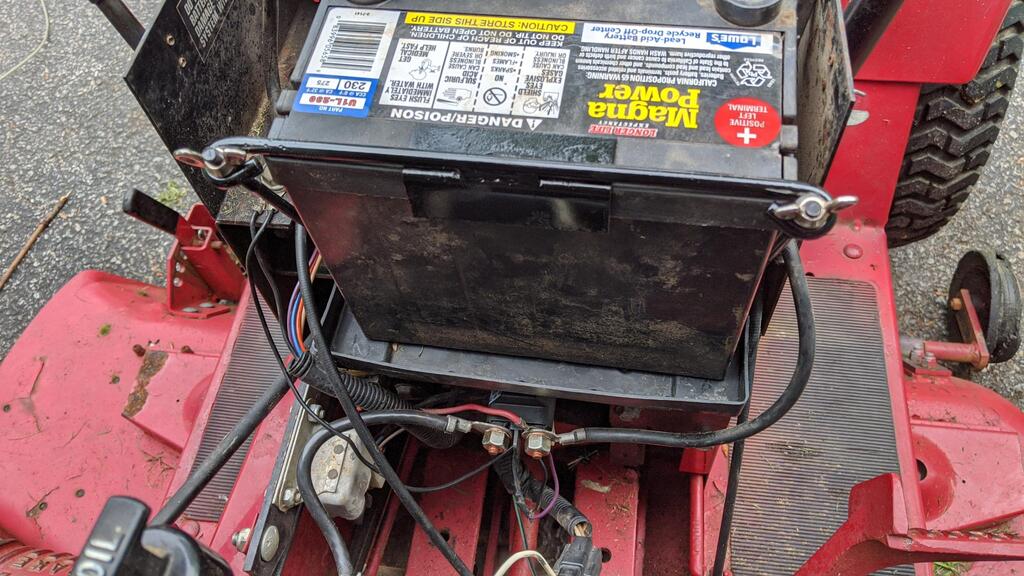

echris 1,426 #5053 Posted June 6, 2020 Because I now have the fever, I took the day off and spent it giving my new 310-8 a thorough servicing. I found out last night (Thanks WheelHorseForum!) she's a 1989. Removed mower deck, side panels, shifter panel and battery so I could see what's going on inside. Looks good overall! Greased all fittings - looks like it hadn't been done in a long while. Applied lithium grease to all linkages, steering column, everything. Lubed throttle and choke cables. Adjusted throttle cable - looks like it slipped on the engine clamp and was not reaching full throttle Reconnected clutch safety switch, solder/shrink tubing. Previous owner cut the wires twisted them together, kinda, and duct taped them. Removed very noisy starter and added light machine oil to the shaft. She's as quiet as a....well...a Kohler starter now. Had to remove dipstick to remove starter. Dumb, Kohler. Adjusted brake. Was very loose. Might need to get a new band soon. Brake drum has a lot of oil on the hub. Bad seal? Adjusted PTO (like 5 times lol) and PTO brake. .012... I ended up setting it at .015. Once I tightened the bolts at .012, it closed up more making the brake drag a bit. Replaced missing bolt from lower PTO bracket. The entire bracket was loose. Yikes! Replaced the battery. Was at 11.5 volts after overnight 2A charge. Stole it from my old tractor. Removed, tested and reinstalled keyswitch. Previous owner replaced it with generic and it wasn't aligned properly. Cleaned, stripped and repainted battery hold down. (It's the little things that make us happy) Cleaned, lubed and inspected mule drive. Looks good! Did a quick service on the deck. Added about 10 pumps of grease to each spindle and none came out. Was not happy about that! Need to replace deck belt, so once I get that, I will do a full service tear down on the deck. I also found a hole in the deck, pretty big, size of a quarter near the height adjuster. Half-assed repair was done previously. Can't believe I missed that earlier, but not too big of a deal to repair properly. The rest of it looks solid. All the baffles underneath are solid. Didn't have SAE 30 or 90, so I still need to change the oil. Hopefully tomorrow I can get out and buy some. I'm pretty sure there's more that I've forgotten. And then I mowed my side yard, while my elderly neighbor and best friend sat in my driveway drinking a beer and watching me. He's happy for me that my years-long quest has finally come to fruition. LMAO! And then my nephew showed up with 2 friends in a GIANT diesel flatbed to pick up my tiny Husqvarna YTH-180 tractor. You could easily put an F-350 dually on this thing. Like using a freight train to move a single grain of rice. I should've gotten a pic. Hilarious. A good day! Is it normal that my Wheel Horse is in the garage and my car in the driveway? I thought so. 3 7 Share this post Link to post Share on other sites

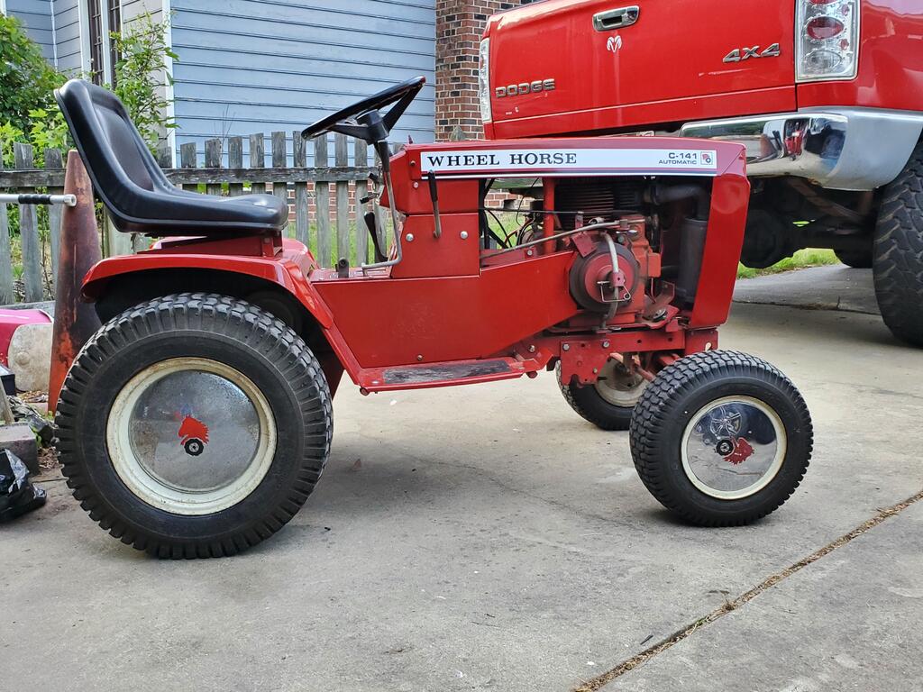

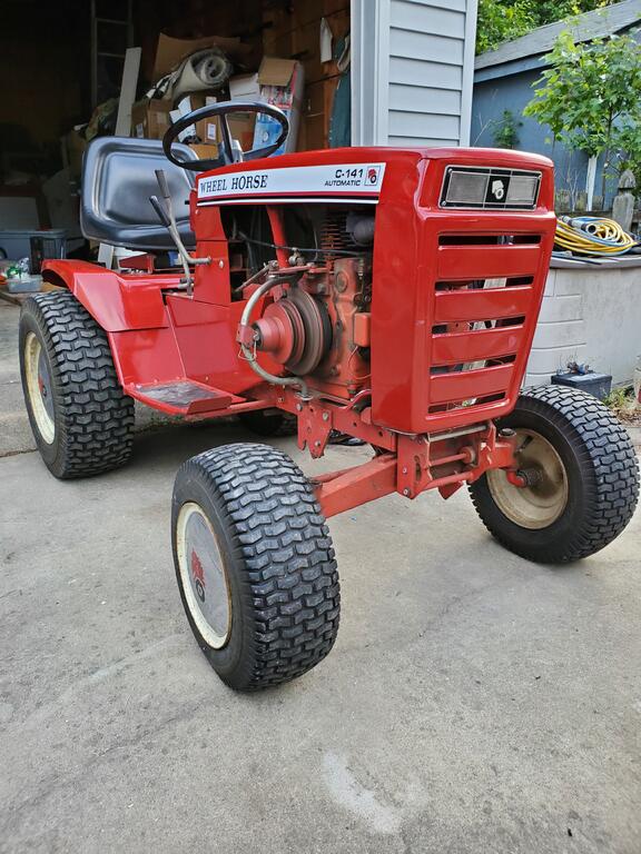

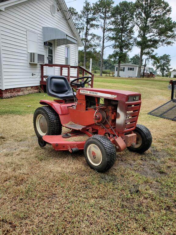

chip61 666 #5058 Posted June 6, 2020 (edited) Not a restoration by any means, I cleaned up and painted the hood, seat pan and foot rests on my C141. It's a worker-had lots of issues when I bought it. I just wanted it to look a little better. Terry's decals look great-probably the best part of the tractor. How it looked when I got it After a little touch-up Edited June 8, 2020 by chip61 pics Share this post Link to post Share on other sites

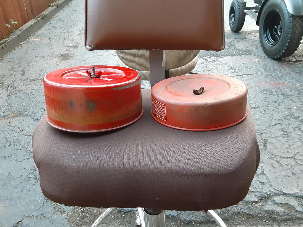

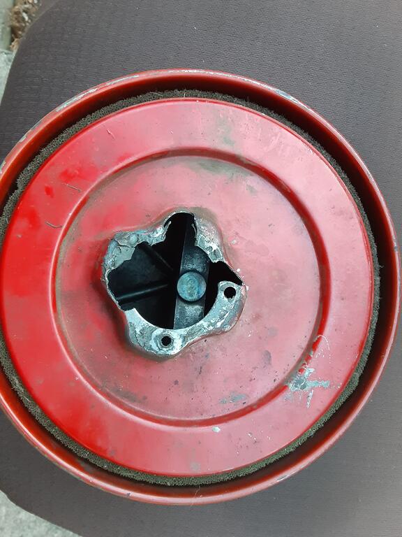

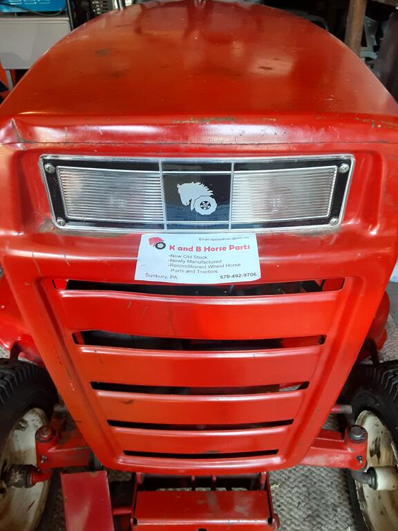

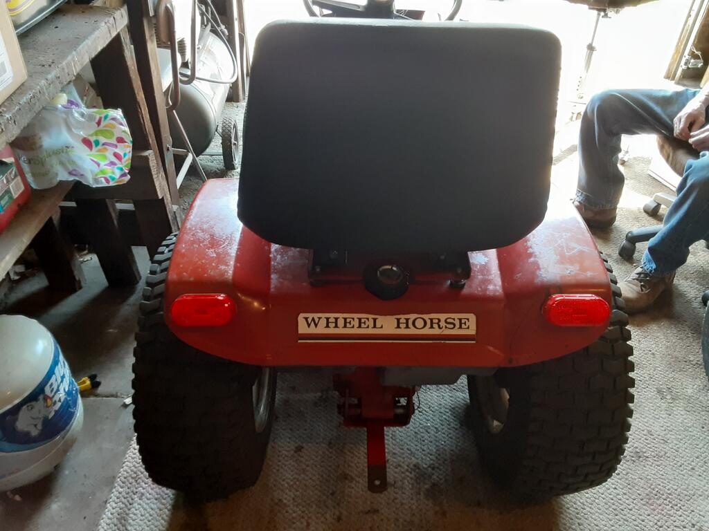

D_Mac 9,339 #5059 Posted June 6, 2020 Well continued receiving parts in the mail today. Im telling you its like Christmas. Today I got two packages. One from my buddies at K and B Horse Parts. This time they sent me brand new front lens for the C-161 and a new air filter assembly. The lens looks teriffic, old one was obviously broken. The air cleaner is a little different then the one I am removing. The plate is the same that screws to the carb but the dish is not as deep. Does anyone know what size filter I am going to need with the new dish on it? Part # perhaps ? Here is a photo of the plate I took off. Hanging on by a thread. Do you think thats cause by the " shaker " mounts? The second package was the rear lens. That was the good news. Bad news is that the lights are not working again. Thought I had it figured out but it keeps blowing fuses. Looks like I have something to do tomorrow. Maybe its the switch... I dunno but the little glass fuses are starting to add up !! I also picked up a Rubbermaid Riding Mower Shed. I got it for my mother some years ago served its purpose well. She wanted it gone so I brought it to my house....... you know what that means dont ya .......??? 5 2 Share this post Link to post Share on other sites

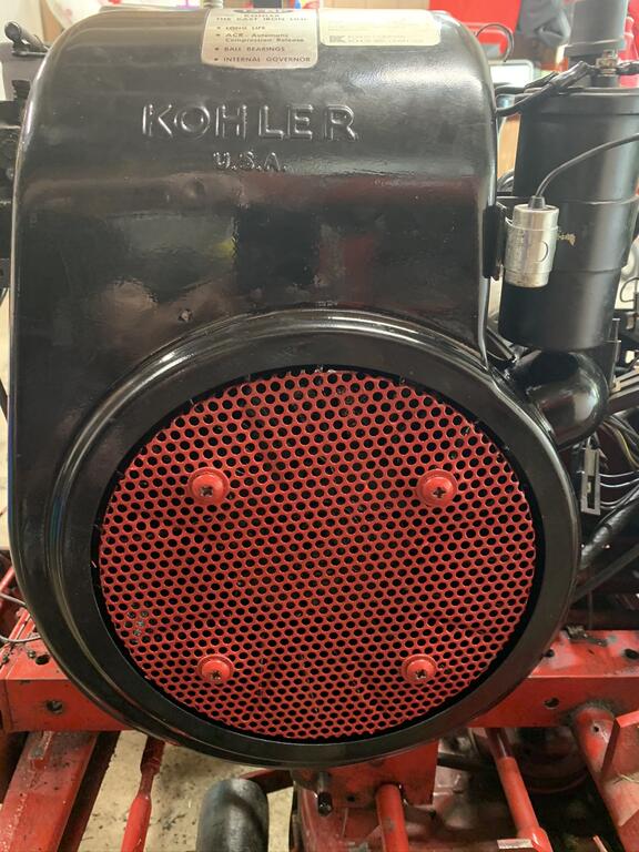

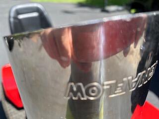

Andy N. 2,881 #5063 Posted June 6, 2020 (edited) Did some custom engine detailing on the wife's '86 312-8. Edited June 6, 2020 by Andy N. 6 1 Share this post Link to post Share on other sites

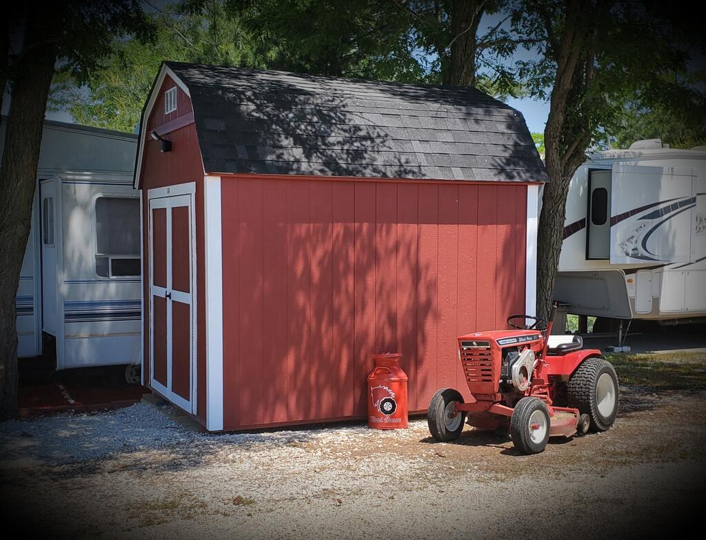

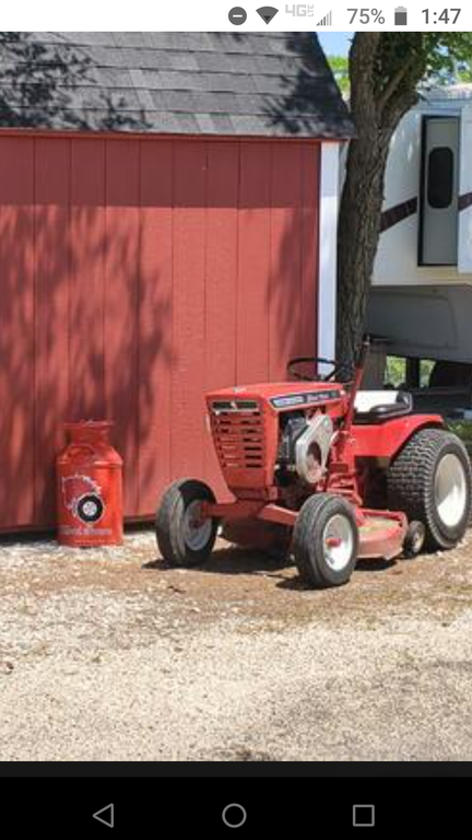

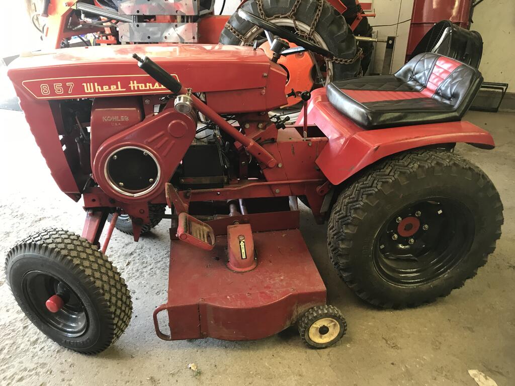

Vinylguy 4,797 #5070 Posted June 6, 2020 (edited) Mowing the ridge at the lake today with the little 857 And took time for a picture by my new mini barn. Been wanting one for 5 years. Of course it had to be red. Edited June 6, 2020 by Vinylguy 3 5 7 Share this post Link to post Share on other sites
ebinmaine 81,160 #5071 Posted June 6, 2020 Like that special edition Wheelhorse milk can too. 6 1 1 1 Share this post Link to post Share on other sites
SylvanLakeWH 32,826 #5072 Posted June 6, 2020 3 hours ago, ebinmaine said: Like that special edition Wheelhorse milk can too. Hey @Vinylguy - Pretty nice decal...Who did it for you? 1 5 Share this post Link to post Share on other sites
Vinylguy 4,797 #5073 Posted June 6, 2020 1 hour ago, SylvanLakeWH said: Hey @Vinylguy - Pretty nice decal...Who did it for you? I know a guy 1 1 4 Share this post Link to post Share on other sites
AMC RULES 37,260 #5074 Posted June 6, 2020 1 hour ago, Vinylguy said: I know a guy Thinking, we both know the same guy, and yeah, he really is a great guy. 2 3 Share this post Link to post Share on other sites
