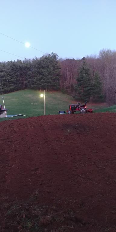

WVHillbilly520H 10,379 #4352 Posted April 7, 2020 (edited) A bit of tillin' by the full moon light... Edited April 7, 2020 by WVHillbilly520H 7 1 Share this post Link to post Share on other sites

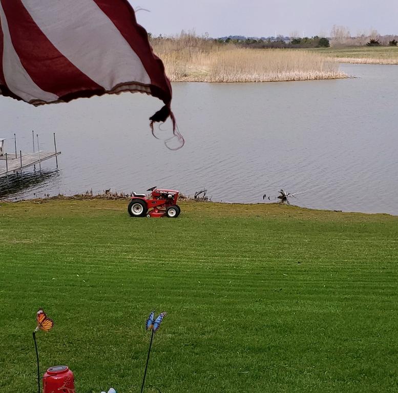

Vinylguy 4,796 #4353 Posted April 7, 2020 My 312-H has a carb issue so I got the little 857 out of storage and brought to lake to mow. Runs and cuts great for about 30 minutes then dies. Let it cool for about 30 minutes and it's back to work for about 20 more minutes. Thinking a new coil and or condenser? 3 1 Share this post Link to post Share on other sites
ebinmaine 80,449 #4354 Posted April 7, 2020 13 minutes ago, Vinylguy said: My 312-H has a carb issue so I got the little 857 out of storage and brought to lake to mow. Runs and cuts great for about 30 minutes then dies. Let it cool for about 30 minutes and it's back to work for about 20 more minutes. Thinking a new coil and or condenser? Terry do you have a spark checker? Share this post Link to post Share on other sites

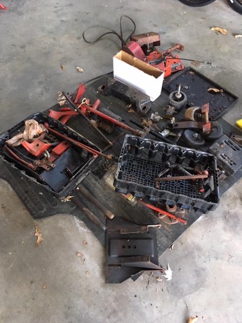

TonyToro 1,189 #4355 Posted April 7, 2020 Well like most of you guys I have some free time. I am sorting WheelHorse parts. Trying, trying really hard to clean up my garage. Lol anyone need parts?? 4 Share this post Link to post Share on other sites
Lane Ranger 12,094 #4356 Posted April 7, 2020 1 hour ago, Vinylguy said: My 312-H has a carb issue so I got the little 857 out of storage and brought to lake to mow. Runs and cuts great for about 30 minutes then dies. Let it cool for about 30 minutes and it's back to work for about 20 more minutes. Thinking a new coil and or condenser? Terry: It was usually the coil was shot when I had this issue but check that gas tank cap also! 3 2 Share this post Link to post Share on other sites
Tractorhead 9,217 #4357 Posted April 7, 2020 (edited) Thought the same, maybe just the fuel tank breather is clogged. Try it with released fuel tank cap, if it run‘s, you found you problem. Or maybe some dirt in the bottom of the fueltank, that swaps sometimes and clogged the Fuel line. edit - did you carefully touch your ignition coil? Was it hot ? - edit end Edited April 7, 2020 by Tractorhead 2 Share this post Link to post Share on other sites
Vinylguy 4,796 #4358 Posted April 7, 2020 Thanks guys. Ran it the first 30 with gas cap off and it still died. Wierd thing is the 3rd time after it cooled I only opened the shutoff 3 quarter and the dang thing ran till I was done didn't die at all? 1 Share this post Link to post Share on other sites
Tractorhead 9,217 #4359 Posted April 7, 2020 I wold think to my second option, release the fueltank and clean it completeley. could be something that was in a fuel canister go into fueltank while refilling that clogs your fuelline while driving. 5 Share this post Link to post Share on other sites
Vinylguy 4,796 #4360 Posted April 7, 2020 1 hour ago, Tractorhead said: I wold think to my second option, release the fueltank and clean it completeley. could be something that was in a fuel canister go into fueltank while refilling that clogs your fuelline while driving. Good idea will check it out as well. Thanks 1 Share this post Link to post Share on other sites
The Tuul Crib 7,354 #4361 Posted April 7, 2020 5 hours ago, Vinylguy said: My 312-H has a carb issue so I got the little 857 out of storage and brought to lake to mow. Runs and cuts great for about 30 minutes then dies. Let it cool for about 30 minutes and it's back to work for about 20 more minutes. Thinking a new coil and or condenser? In the meantime those downtime moments could be done with a fishing pole Terry! 1 3 Share this post Link to post Share on other sites
The Tuul Crib 7,354 #4362 Posted April 8, 2020 (edited) Took lRV out for a joyride behind the house nice cool evening lots of pollen in the air yuck! Edited April 8, 2020 by The Tool Crib 8 2 Share this post Link to post Share on other sites
953 nut 68,750 #4363 Posted April 8, 2020 2 hours ago, Vinylguy said: Thanks guys. Ran it the first 30 with gas cap off and it still died. Wierd thing is the 3rd time after it cooled I only opened the shutoff 3 quarter and the dang thing ran till I was done didn't die at all? Could there be a piece of trash in the tank that can't get past a partly open valve but would clog a full open valve? May want to pull the tank and dump it into a clean container for inspection. Good luck. 20 minutes ago, The Tool Crib said: In the meantime those downtime moments could be done with a fishing pole Terry! Watch the grass grow, contemplate the potential fixes, Pray, fish some more and the answer will come to you. 2 1 2 Share this post Link to post Share on other sites

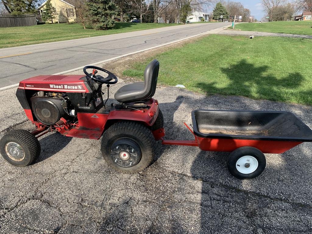

Andy N. 2,806 #4365 Posted April 8, 2020 The donor engine on my 520-H was having surging issues over the winter when I ran my snow blower (once) and hard to get the RPM in the correct range, so today I took the carb/intake manifold from the original Onan (because I knew it worked fine when I did the engine swap last fall) and swapped it with the donor. Runs great now. Idle at 1,200 RPM and full throttle at 3,600 RPM as advertised. Got it all put together and took the dump cart out for a tow before the storms rolled in. IMG_0254.mp4 4 4 Share this post Link to post Share on other sites
Tractorhead 9,217 #4366 Posted April 8, 2020 10 hours ago, Vinylguy said: Good idea will check it out as well. Thanks I rethinkering on your cause, maybe the gap on the sparkplug can also be the issue. i had this in the past, after changing the sparkplug, it run‘s fine. the reason was maybe a thermal cause on the sparkplug. Share this post Link to post Share on other sites

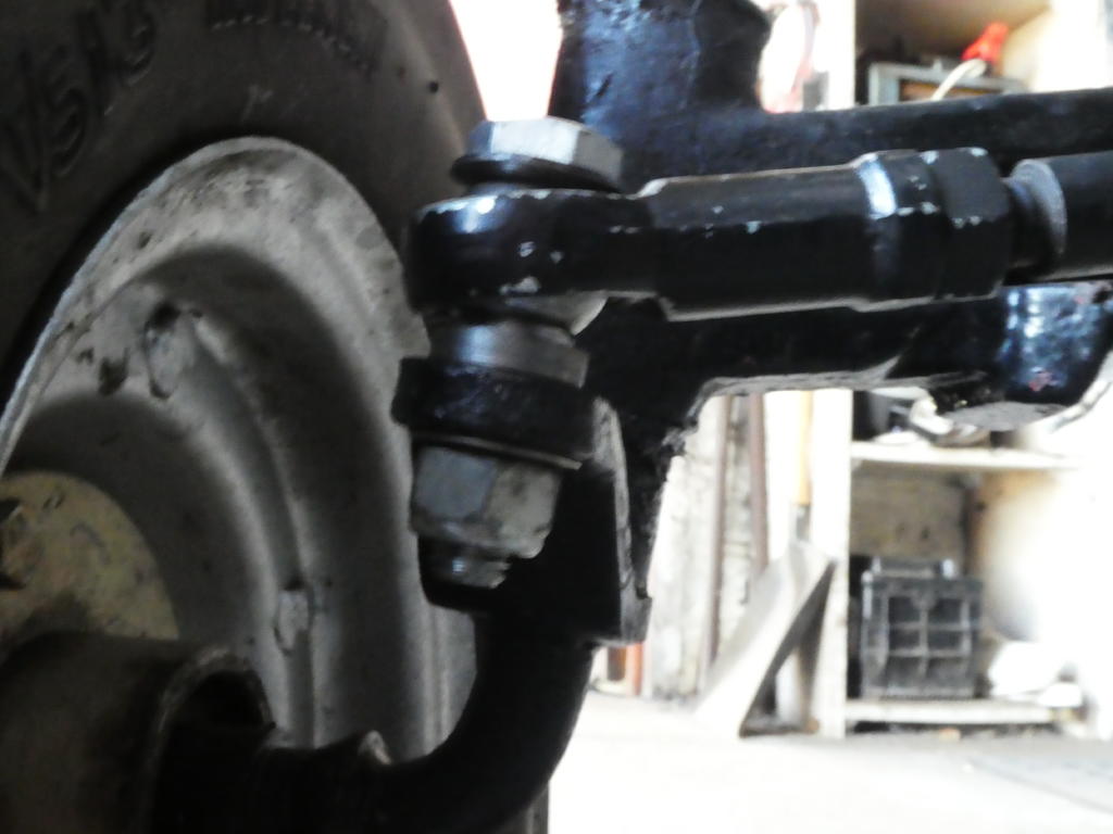

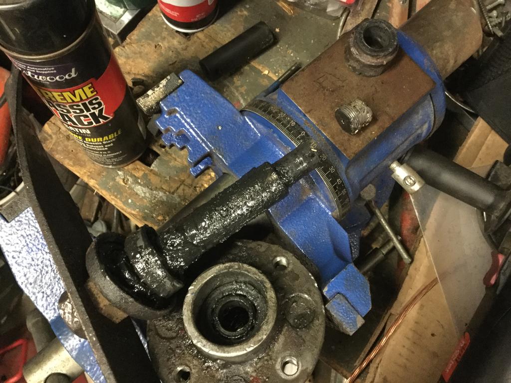

Stormin 9,988 #4367 Posted April 8, 2020 The steering on the C-121 Black Horse, was a little heavy. Yesterday I did a bit of investigating. I found that the track rod ends were just fouling the steering arms. The track rods slope downwards and the steering arms tilt inwards. So I knocked up a couple of spacers this morning. Just 1/4" thick and really need to be thicker, but I'd no bolts long enough to fit through thicker ones. Another future mod one day. If you look closely at the photo, you can see the top of the spacer is slightly chamfered. Also you'll see the arm is further down from the axle than standard. That's because I made spacers to lift the front end an inch, to compensate for the taller tyres on the rear. Not done a proper road test yet. I'll do that tomorrow. The rest of the day was spent getting the C-125 running better and made a towing attachment for the Sears/Roper. 2 1 Share this post Link to post Share on other sites

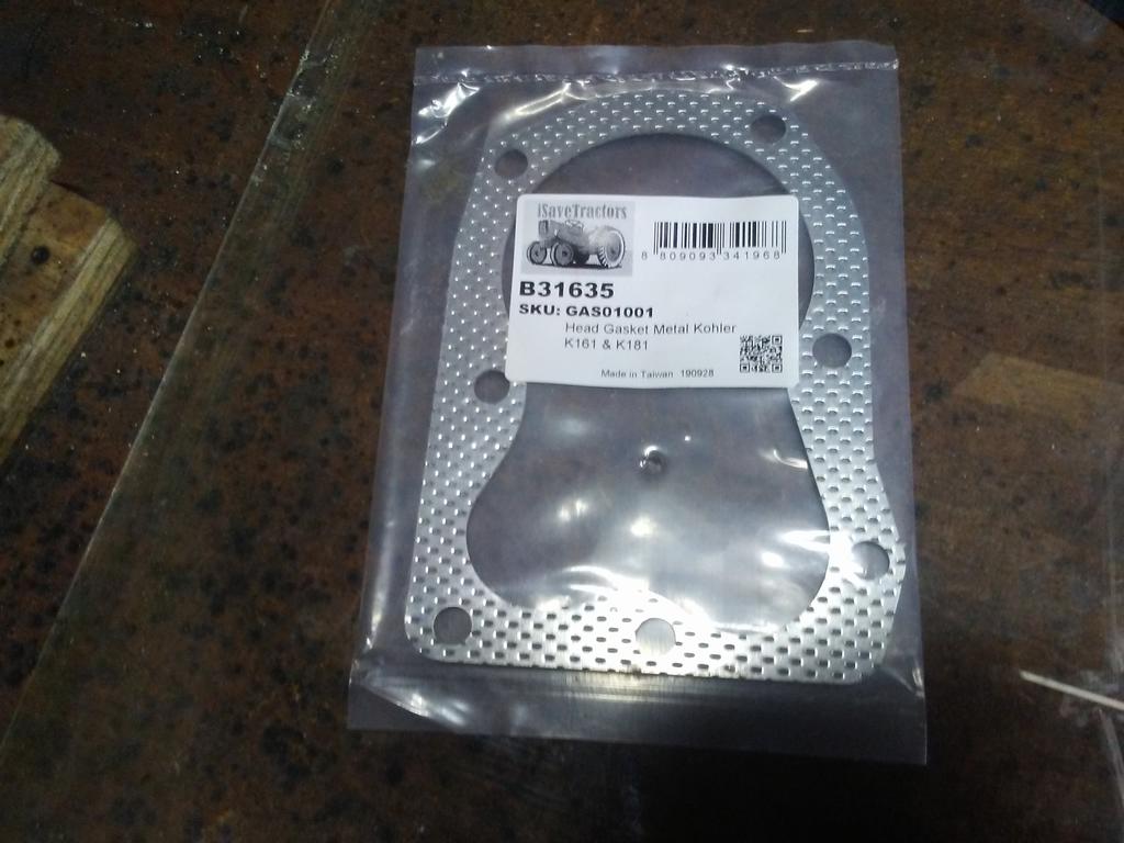

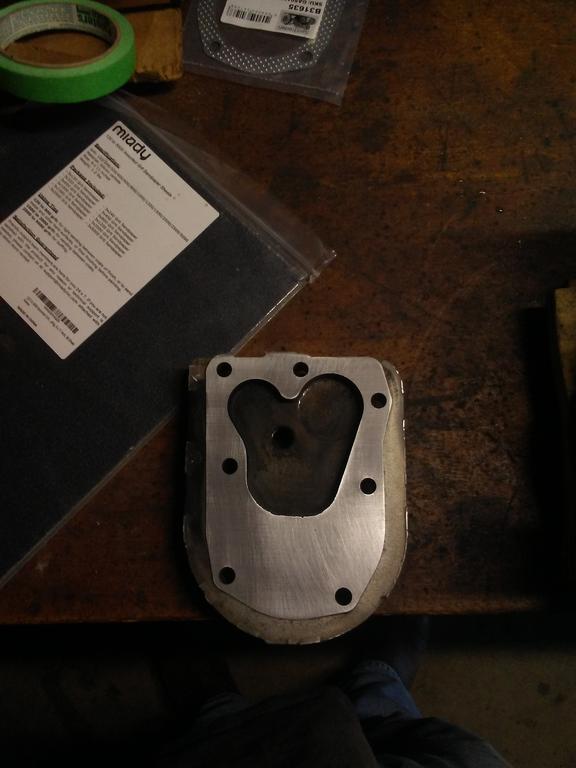

Sam Pasch 450 #4370 Posted April 9, 2020 Its like Christmas in my garage today. A new air filter, fuel filter and head gasket arived on my front porch today! I resurfaced the head and installed the parts and it runs great! 4 3 Share this post Link to post Share on other sites

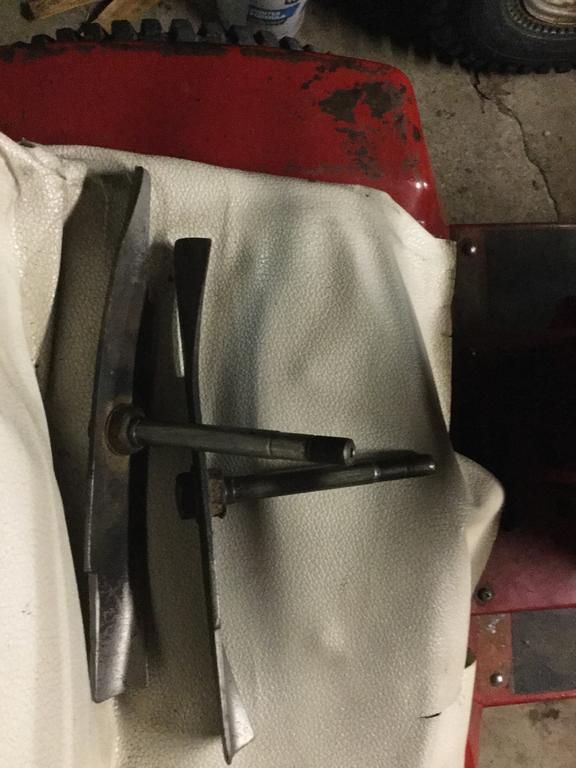

FAST 87 #4372 Posted April 9, 2020 Attempted to replace the bearingS on my side discharge mower deck and ended up ruining one rod that connects to the blade and two pulleys are junk. Any suggestions please. I’m now wishing I just lived with the squeaking noise lol.Things where just locked in and wouldn’t budge. 3 Share this post Link to post Share on other sites
Pullstart 71,145 #4373 Posted April 9, 2020 What rod is hurt @FAST? I have a few decks in a pile for spares if needed... can you share pictures of what you’ve got going on? Share this post Link to post Share on other sites
FAST 87 #4374 Posted April 9, 2020 (edited) 4 hours ago, pullstart said: What rod is hurt @FAST? I have a few decks in a pile for spares if needed... can you share pictures of what you’ve got going on? @pullstartI ruined one of the spindle rods. I assume that’s the name. It’s the rod that goes up through the spindle housing and attaches to the mower blade and the pulley. I also need at least the two outside pulleys. Didn’t realize they where so worn out and thin. The middle pulley is fine enough. The top photo it the one I destroyed. I didn’t take a photo of the pulley that goes on top. Sorry Edited April 9, 2020 by FAST Added photos Share this post Link to post Share on other sites
