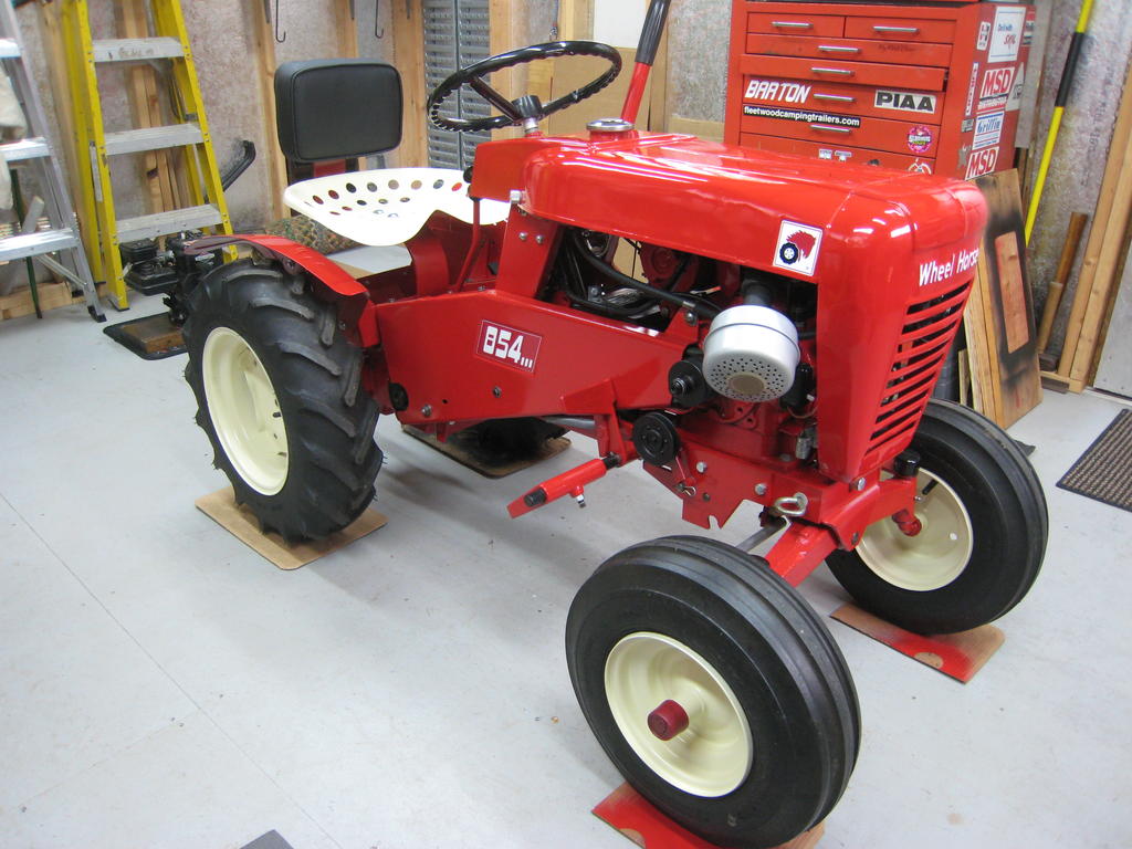

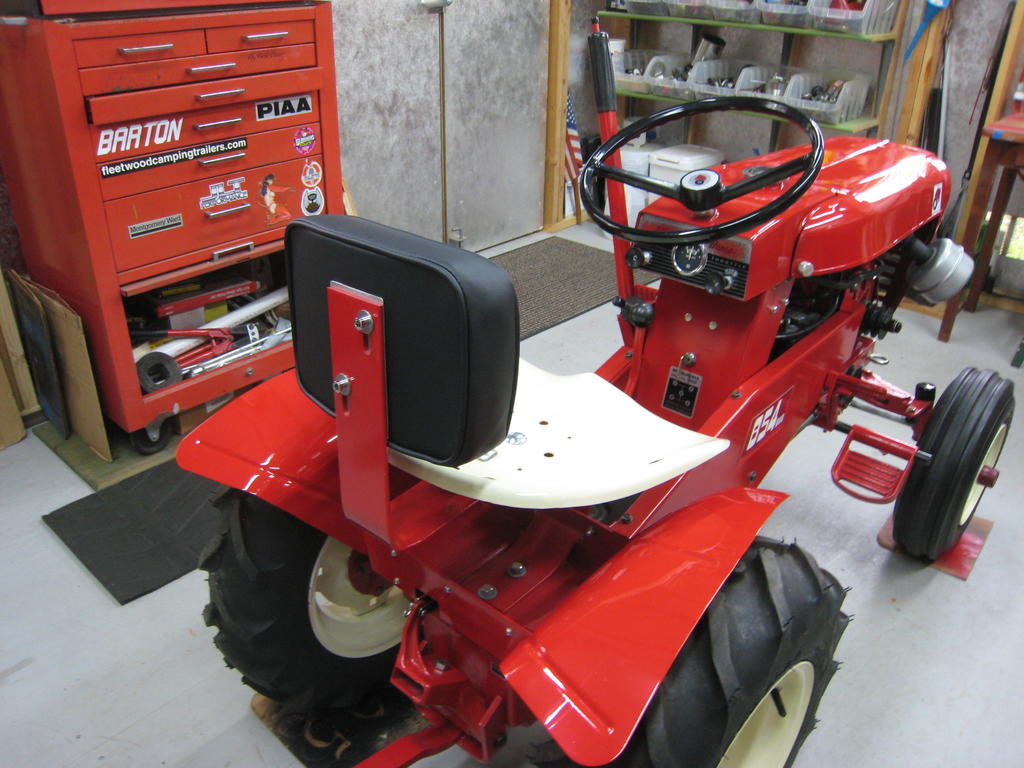

motor12 367 #404 Posted April 7, 2018 Made and installed a back rest on my 854. 10 4 Share this post Link to post Share on other sites
Vinylguy 4,796 #405 Posted April 7, 2018 Beautiful ! 1 Share this post Link to post Share on other sites

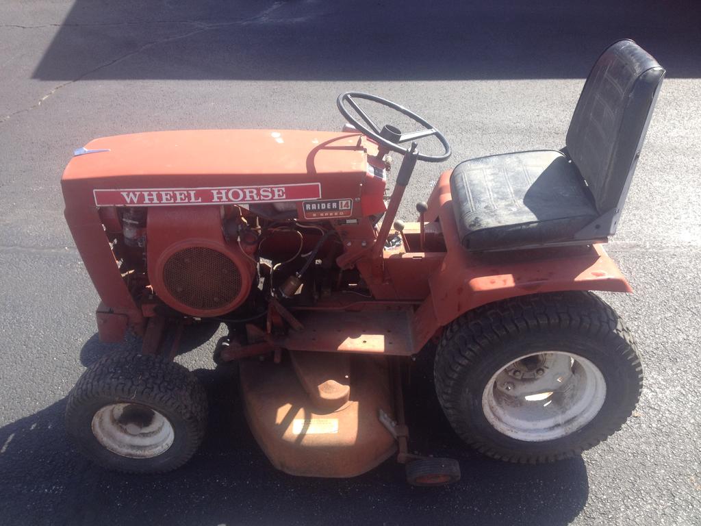

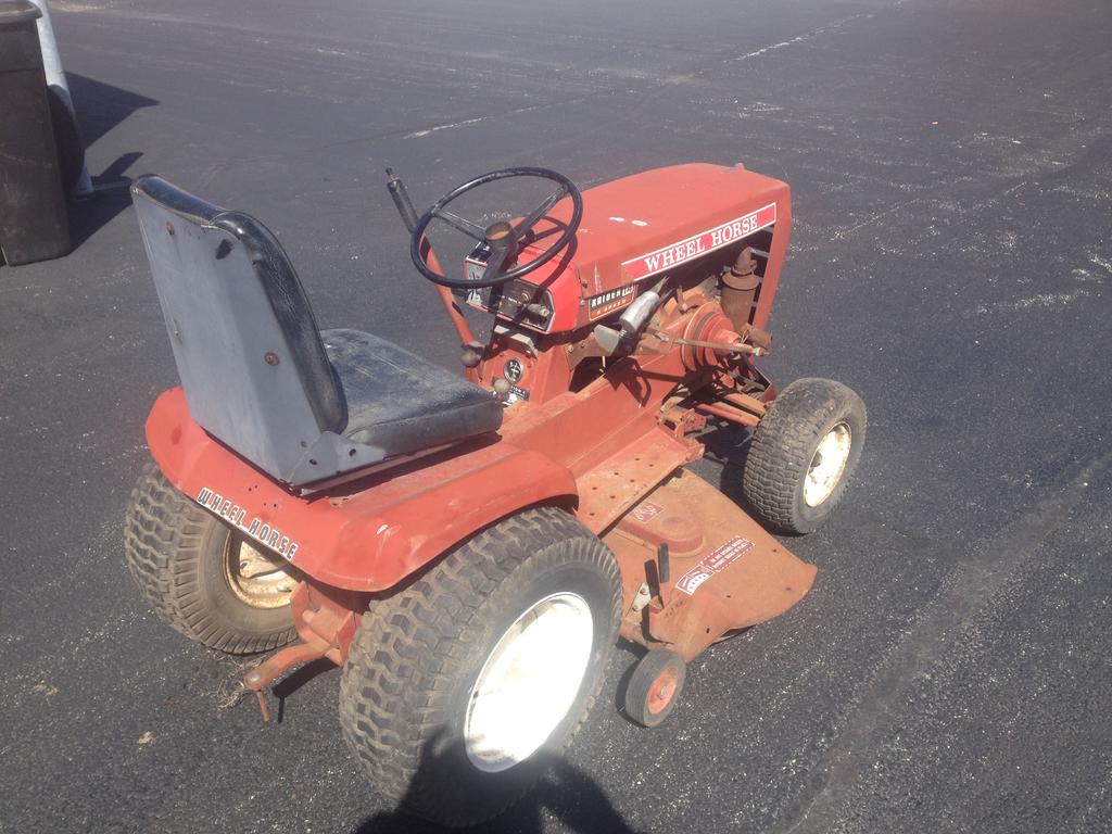

BPEisenhower 574 #407 Posted April 7, 2018 Hello Horse fans! I had another one pop up from a residential clean out. I own and operate a roll off truck every day and have seen some interesting things in the garbage,but this makes me glad to have but sick to see thrown away. I was dumping out my 20 yard box and a Raider 14 slid out. No starter and rear end is stuck and won't roll unless I pick up one side of the rear and push. Other than that, I will hopefully fix, repaint and park next to my other joy. 4 4 1 Share this post Link to post Share on other sites
dells68 7,499 #408 Posted April 7, 2018 Dang shame what some people throw away! Great save!! 2 Share this post Link to post Share on other sites
953 nut 68,160 #409 Posted April 7, 2018 25 minutes ago, BPEisenhower said: rear end is stuck and won't roll unless I pick up one side Nice save. If it is below freezing the transmission may have water in the oil which has frozen. 1 Share this post Link to post Share on other sites
oliver2-44 11,662 #410 Posted April 7, 2018 3 hours ago, motor12 said: Made and installed a back rest on my 854. @motor12 That 854 sure looks sharp top to bottom 2 Share this post Link to post Share on other sites
BPEisenhower 574 #411 Posted April 7, 2018 1 hour ago, 953 nut said: Nice save. If it is below freezing the transmission may have water in the oil which has frozen. Can't believe I didn't even think about ice in the transmission 😯 It was 19 this morning and it has sat out for a year. Shifter boot is badly cracked after inspecting. I'm hoping it's that simple! Thank you!!! 1 Share this post Link to post Share on other sites
BPEisenhower 574 #412 Posted April 7, 2018 1 hour ago, dells68 said: Dang shame what some people throw away! Great save!! That's how I got a C195. The people threw it away because it was old and wanted to go green. When I say green, I mean the rechargeable battery lawnmower kind. It's a shame that something well constructed needs maintenance because of 30 years of negligence gets the axe. It's got a roof over it too now . 3 Share this post Link to post Share on other sites
WHX?? 57,644 #413 Posted April 7, 2018 (edited) Just blows my mind thinking someone would have put that in a dumpster @BPEisenhower Nice save .. looks to be complete and undamaged from the ordeal....keep us posted on her recovery. Ollie knows...... that is one fine looking tractor @motor12 Edited April 7, 2018 by WHX16 1 Share this post Link to post Share on other sites
BPEisenhower 574 #414 Posted April 8, 2018 57 minutes ago, WHX16 said: Just blows my mind thinking someone would have put that in a dumpster @BPEisenhower Nice save .. looks to be complete and undamaged from the ordeal....keep us posted on her recovery. Ollie knows...... that is one fine looking tractor @motor12 It fortunately was covered by cardboard boxes and an old overturned sofa. Lol. I intend to go through this tractor and repaint just just to show them people they were sorely mistaken about it being "junk/garbage". 😛 1 2 Share this post Link to post Share on other sites

CountryRock 199 #416 Posted April 8, 2018 7 hours ago, BPEisenhower said: Hello Horse fans! I had another one pop up from a residential clean out. I own and operate a roll off truck every day and have seen some interesting things in the garbage,but this makes me glad to have but sick to see thrown away. I was dumping out my 20 yard box and a Raider 14 slid out. No starter and rear end is stuck and won't roll unless I pick up one side of the rear and push. Other than that, I will hopefully fix, repaint and park next to my other joy. That's a great find! Hope it doesn't take much to get it running again. I'd love to find something like that. 1 Share this post Link to post Share on other sites
BPEisenhower 574 #417 Posted April 8, 2018 **Update** 953 nut was right! I put the Raider in a heated shed and pulled rear end drain plug out for the night. Nothing dripped out. This morning there was a catch pan full of what looked like a melted milk shake. Filled with kerosene and diesel to flush out. I used an auger engine and v-belt to spin the rear end at an idle for an hour. Drained and repeated 4 times. Shifts like it's supposed to now! Kohler will be tackled this weekend 🎉😀. Thank you for the advice 4 5 1 Share this post Link to post Share on other sites
ebinmaine 80,087 #418 Posted April 8, 2018 1 minute ago, BPEisenhower said: .........melted milk shake. Filled with kerosene and diesel to flush out. I used an auger engine and v-belt to spin the rear end at an idle for an hour. Drained and repeated 4 times. As much as I do enjoy a milk shake that's not the proper time and place for one. Nice job with the multi-rinse. 1 3 Share this post Link to post Share on other sites

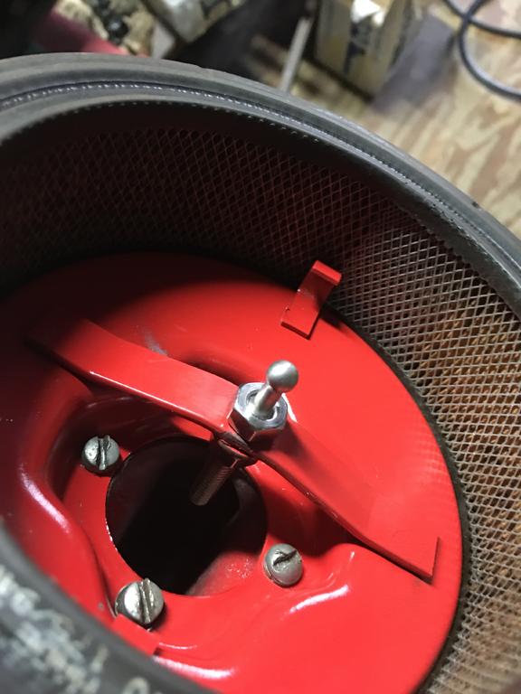

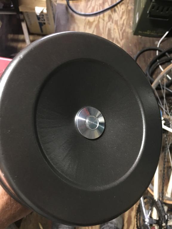

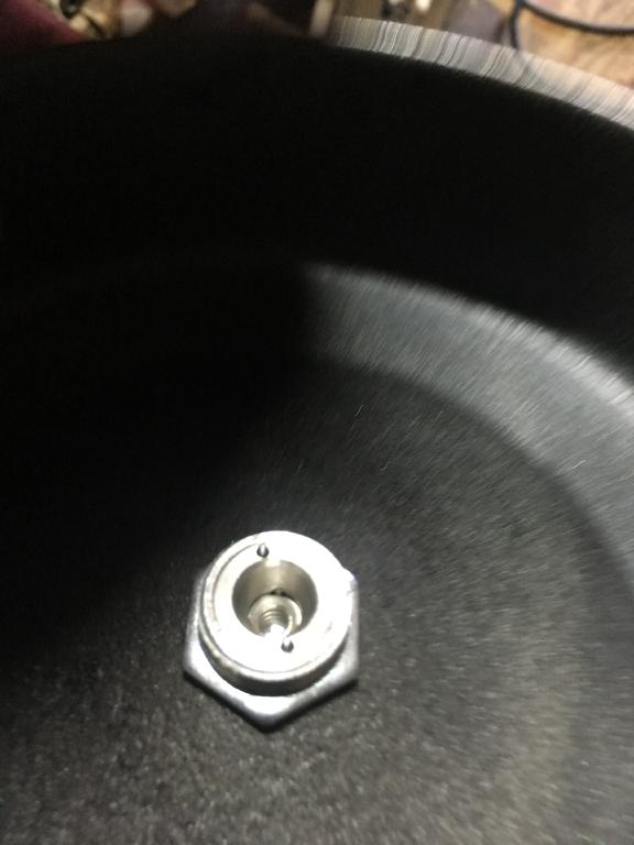

19richie66 17,932 #419 Posted April 9, 2018 (edited) No more air cleaner wingnut. One less thing to lose. I still have to cut the stud off down the air cleaner adapter and adjust it to a final “snap”. Then red loctite. 👍 Edited April 9, 2018 by 19richie66 7 2 Share this post Link to post Share on other sites
JPWH 6,544 #420 Posted April 9, 2018 Looks great I like it. 1 Share this post Link to post Share on other sites
Sarge 3,473 #421 Posted April 9, 2018 Great idea, bookmarked those button heads on my list. I get a lot of stuff from SailRite, great place... I think McMaster also sells these ? Sarge 1 Share this post Link to post Share on other sites
19richie66 17,932 #422 Posted April 9, 2018 (edited) http://www.quik-latch.com/. I ended up getting one for my hood because my hinge attempt nose dived. Did away with the lever. Edited April 9, 2018 by 19richie66 3 Share this post Link to post Share on other sites
