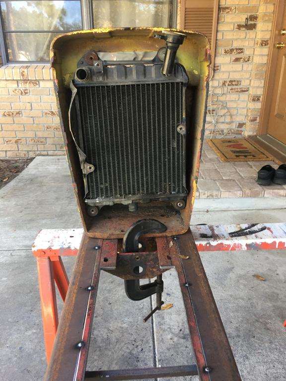

19richie66 17,930 #3676 Posted December 8, 2019 4 hours ago, 8ntruck said: 19richie66 - what chassis did you use in your mock up with your diesel engine? That grill looks like it might be for a 1054. It is a 518Xi parts machine I bought. I have a 522Xi I plan on using for my mowing duties and jumped at the chance for a parts machine. So I figured I could make something out of the transmission and rear frame section. I have a lot of Gt14 parts already. I am trying to build a gt14 with the diesel engine and Xi rear section. Gonna be a challenge but I am up for it. I’m trying to get it to a roller and then add it to the list of projects 👍 1 8 Share this post Link to post Share on other sites

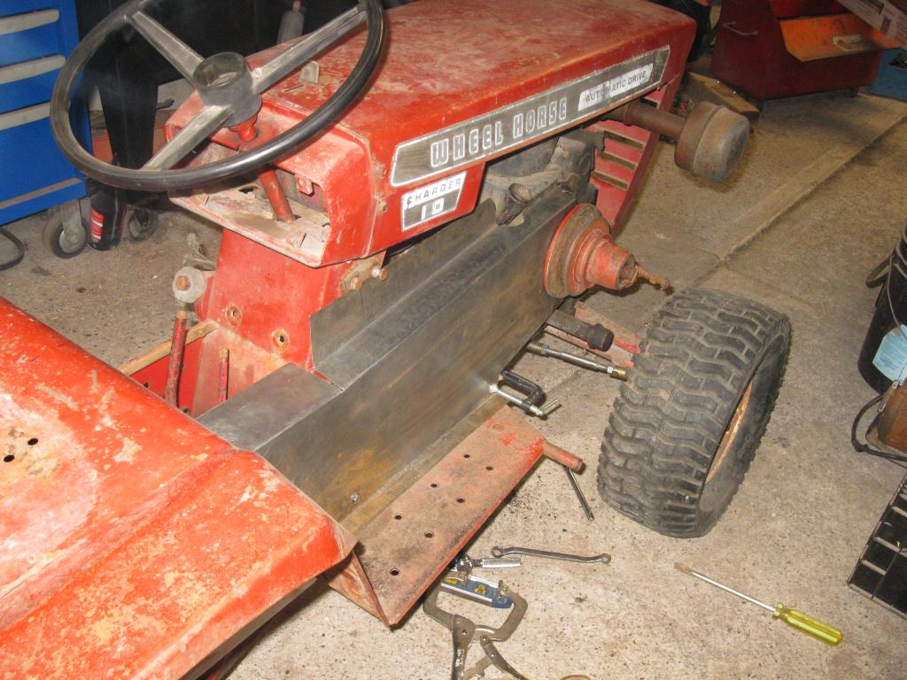

MikMacMike 494 #3681 Posted December 8, 2019 Well I hope i got the furnace in the shop good enough for the insurance company....Now back to Big Red......Need to finish up the sheetmetal guard on the right side. Theres going to be quite a bit more sheet metal fabing as things progress but I think after i get the belt guard fitting good Im into the electronics and rewireing. See you all tonight....Im getting a very late start into the shop today pfffff. Share this post Link to post Share on other sites

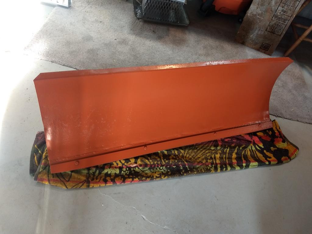

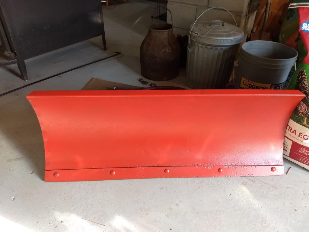

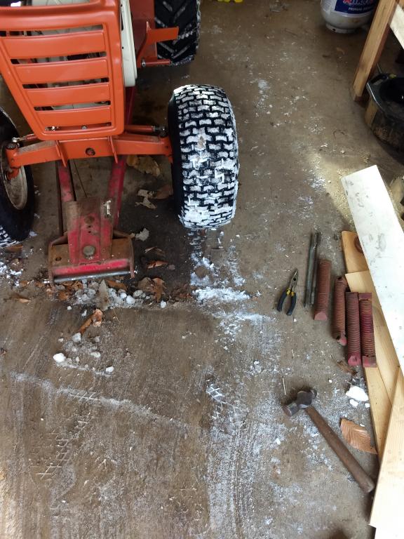

ebinmaine 79,786 #3683 Posted December 8, 2019 My Honey and I spent some time working on 2 plows today. Trina wants to try out plowing snow with her 867 "Pig Pen/ Otha Tracta" so I took apart a 42" plow & frame so she could de-rust-icate the plowing surface and toss a bit o paint at it. Her plow is Krylon Pimento Red. (It was here so she used it). On the Cinnamon Horse I've been noticing that the blade "trips" forward to easily. The springs are a little deformed and likely quite worn. Rather than buying new ones I decided to put an extra set of springs on to see what happens. Sooo We also dismantled the plow from my tractor and while I was working on the new rods Trina de-rust-icated the plowing surface and tossed a bit o paint at it... Looks pretty orange but that's the Cinnamon color. I took the rods from mine to use for the one on Trina's tractor and built 2 new longer rods from 1/2" steel round stock. Installation will be completed later this week after the paint dries. 4 5 Share this post Link to post Share on other sites

ebinmaine 79,786 #3688 Posted December 9, 2019 43 minutes ago, MikMacMike said: you tell her she did a dang fine job Thanks Mike. I'll pass the word along. We've done 2 complete frame off restorations and a partial repaint. She's the de-finish and re-finish department all in one. There's a couple threads covering those tractors. One was Cinnamon Horse, the other is her first tractor. A 657. Here she was yesterday working on getting one of the pieces cleaned off. We've had a light year for snow so far. Usually by about mid February and into March we have a 3 to 5 foot deep base. 4 1 2 Share this post Link to post Share on other sites
Pullstart 70,846 #3689 Posted December 9, 2019 Great work on that guard @MikMacMike! 1 1 Share this post Link to post Share on other sites

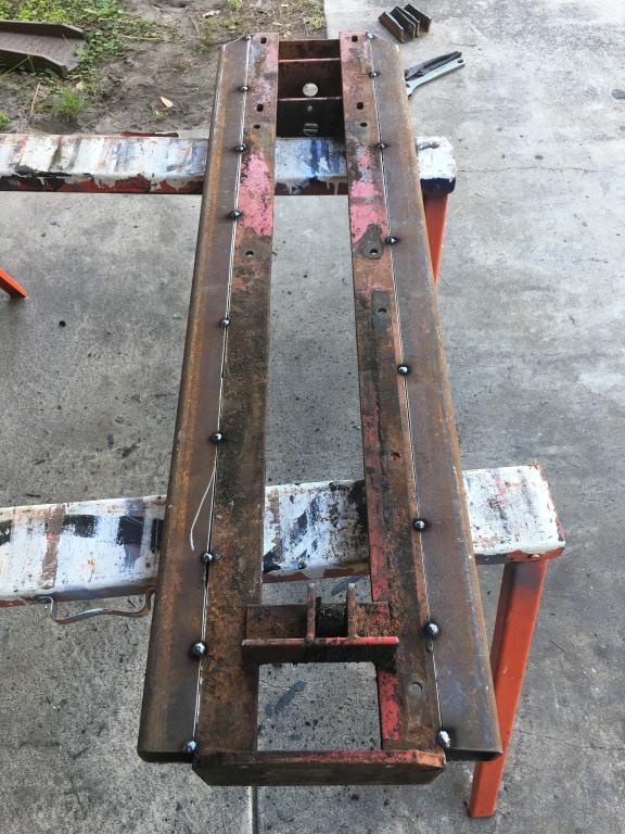

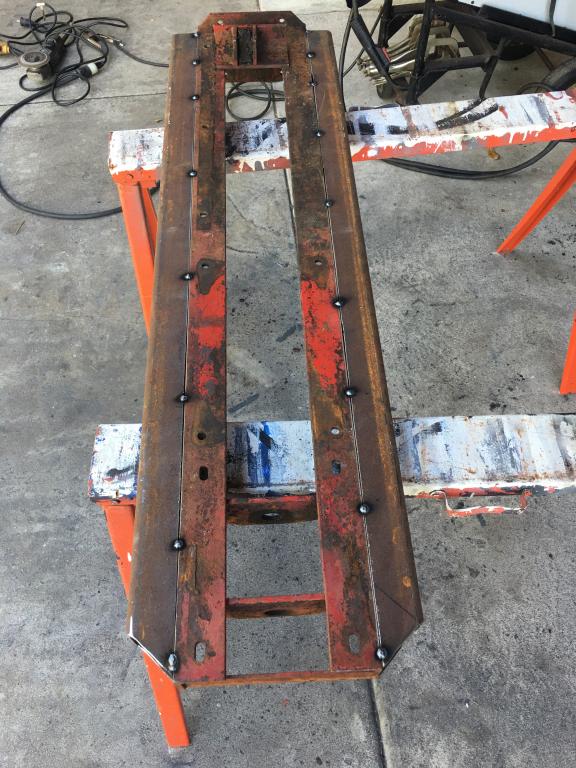

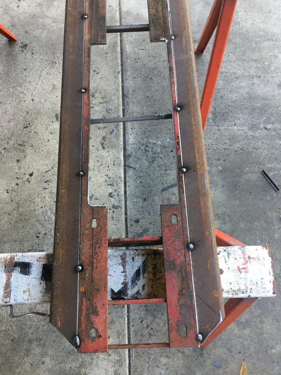

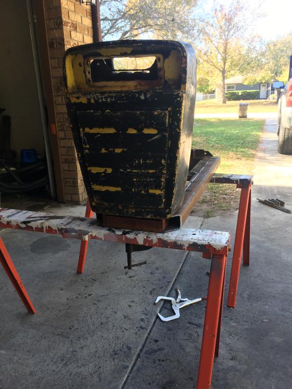

19richie66 17,930 #3690 Posted December 9, 2019 (edited) On 12/6/2019 at 10:43 AM, Lane Ranger said: You will be needing a frame upgrade with that thing Richie! However, the good news is you wont be needing and front or back wheel weights ! How’s this Lane? It will be fully welded but right now just held together till I figure out joining the two different frames. 👍 Edited December 9, 2019 by 19richie66 2 2 Share this post Link to post Share on other sites
ebinmaine 79,786 #3691 Posted December 9, 2019 5 minutes ago, 19richie66 said: How’s this Lane? It will be fully welded but right now just held together till I figure out joing the two different frames. 👍 Looks great to me from up here in Maine anyway. seriously though, what's to figure out? It looks like you've got stuff lined up pretty well there. Share this post Link to post Share on other sites
19richie66 17,930 #3692 Posted December 9, 2019 (edited) @ebinmaine I have to open the center up to at least 7” wide so the oil pan sump will drop down between the frame rails. The rest of the pan will be above the frame. The engine has to sit off to the left just a little bit to line up with the Xi drive shaft. Just a little bit. I also want to use the tilt column, front axle and steering from the Xi. Edited December 9, 2019 by 19richie66 2 1 1 Share this post Link to post Share on other sites

19richie66 17,930 #3695 Posted December 9, 2019 (edited) @ebinmaine frame notch👍 Edited December 9, 2019 by 19richie66 Enough teasing for today.👍 1 7 Share this post Link to post Share on other sites

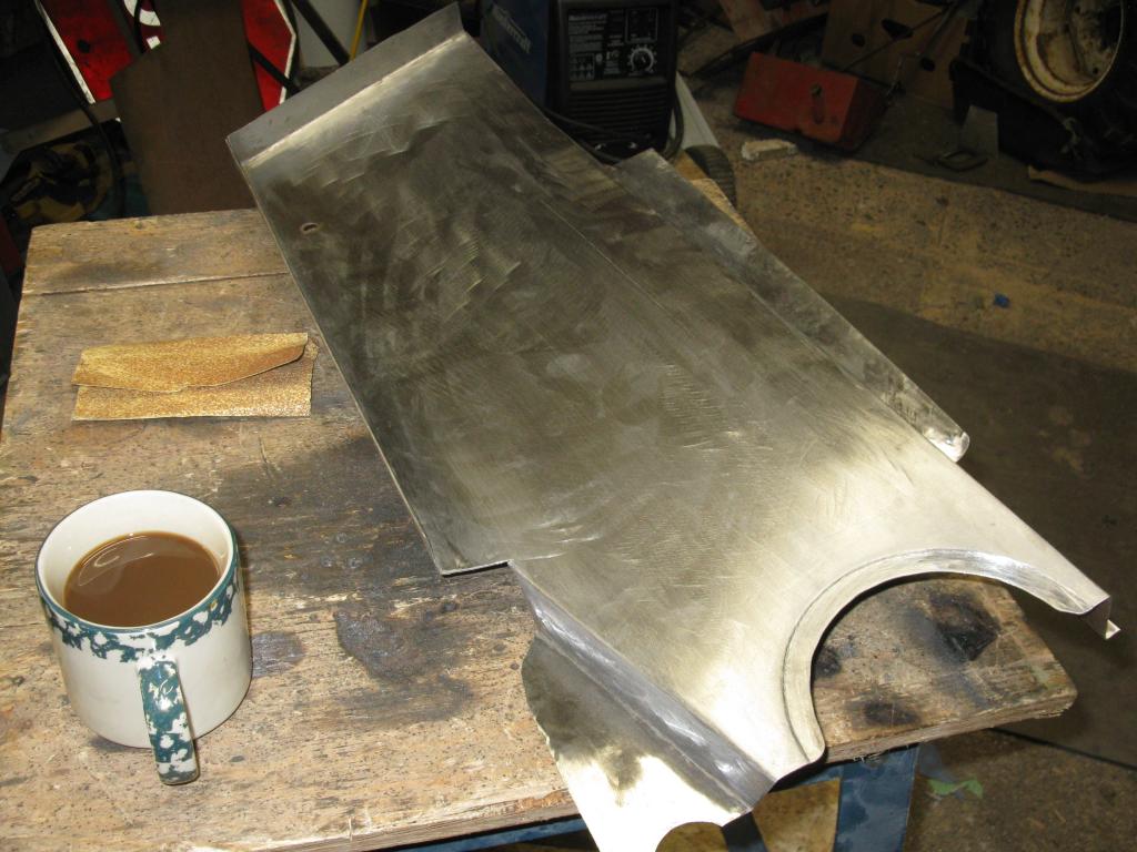

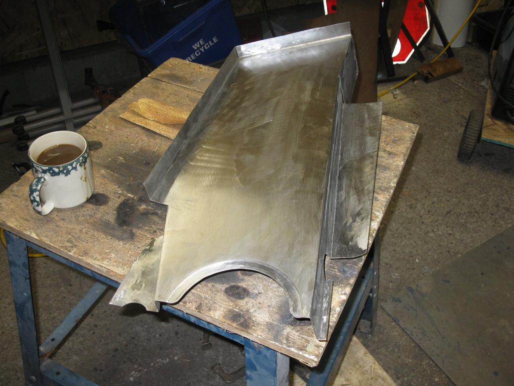

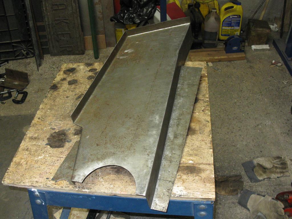

MikMacMike 494 #3699 Posted December 10, 2019 Well I tweeked it a bit more and then smoothed her out. and put a dimple around where it fits between the pto clutch n the drive pulley. I still need to weld in where I made a goof up and then drill a hole where it will bolt to the engine block. I think Ill for now leave it long, but once I start building the cab Ill have to split it to enable its removal when replacing belts, comes off relatively easy now though. Wew Ill say this, with 18 guage it sure is slow going with hammer n dollies......no wonder they called our old cars tanks hahahah, that metal is quite heavy. Ebonmaine you make sure the wife leaves some work for you ya hear......hehehehehe. She sure looks like she is right into it. That is a rare quality having a partner that gets right into it...is a blessing for sure. 4 1 Share this post Link to post Share on other sites
