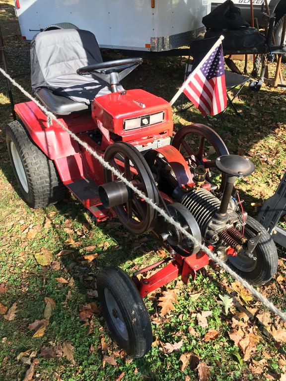

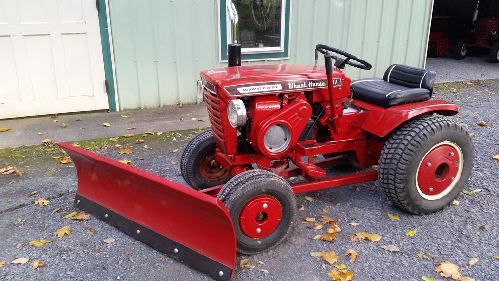

Burnerman 759 #3326 Posted October 20, 2019 Saw this repowered WH today. 2 6 2 Share this post Link to post Share on other sites

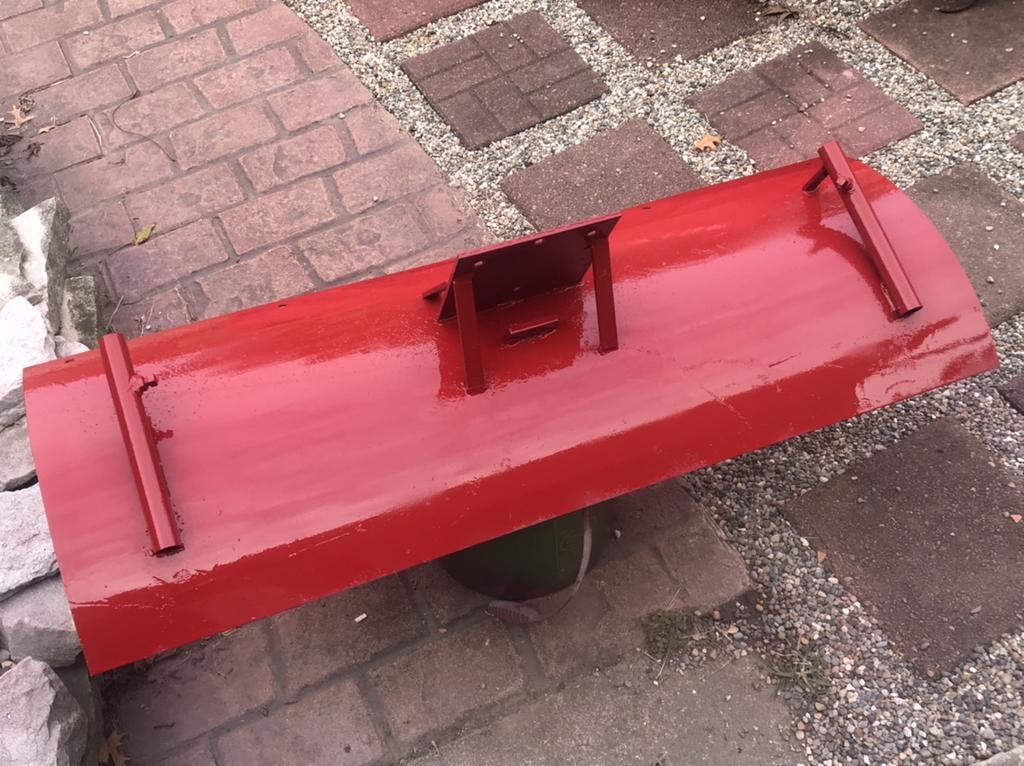

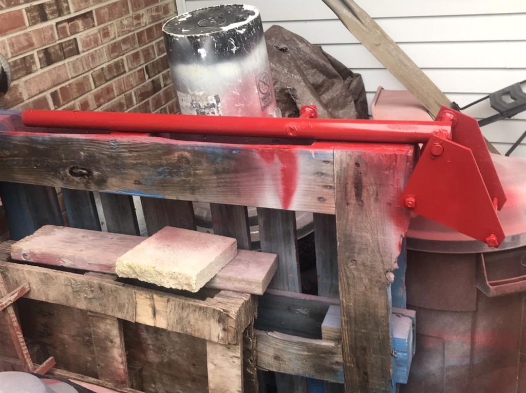

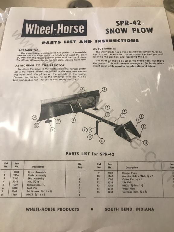

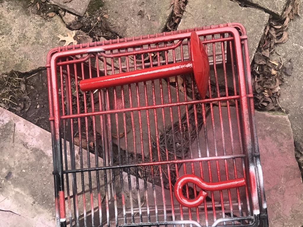

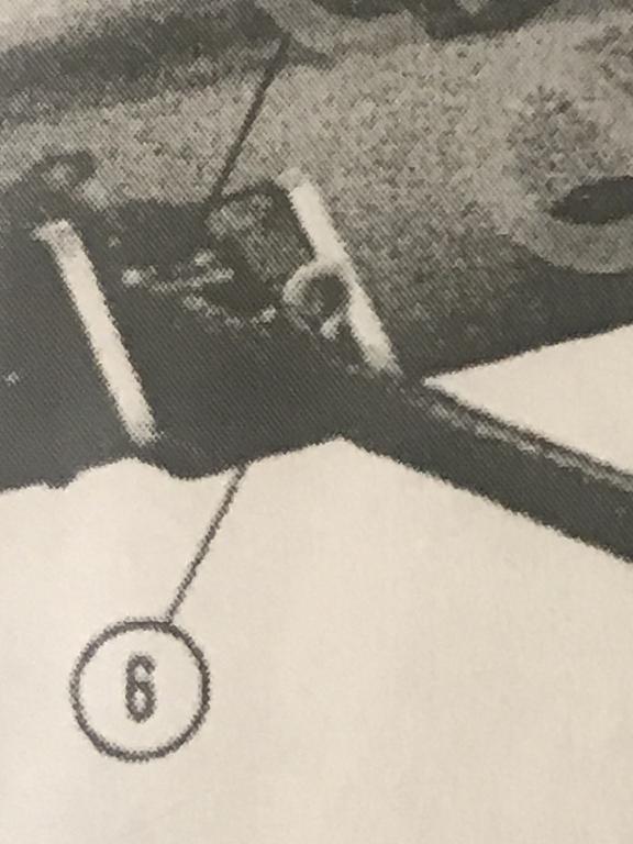

Lane Ranger 11,983 #3329 Posted October 20, 2019 (edited) Looked at the RJ SPR- 42 manual and parts list for the RJ snowplow/ dozer blade I am redoing this am. I was surprised to see that the original RJ plow used a tool pin to angle the plow! Edited October 20, 2019 by Lane Ranger 4 Share this post Link to post Share on other sites
ZXT 2,402 #3330 Posted October 20, 2019 14 hours ago, Burnerman said: Saw this repowered WH today. Do you know what engine that is? Looks like an Ideal but I've never seen one with the exhaust exiting the top of the head. 1 1 Share this post Link to post Share on other sites
Tractorhead 9,217 #3331 Posted October 20, 2019 Looklike an level engine. 👍 nice build Share this post Link to post Share on other sites
N875ED 98 #3332 Posted October 20, 2019 Lane Ranger: What paint system (brand, primer, typ, etc.) and color did you use to repaint your plow? Is there a manufacturer that makes “official” Wheel Horse red? Share this post Link to post Share on other sites
ZXT 2,402 #3333 Posted October 20, 2019 6 hours ago, Tractorhead said: Looklike an level engine. 👍 nice build What's a level engine? Share this post Link to post Share on other sites

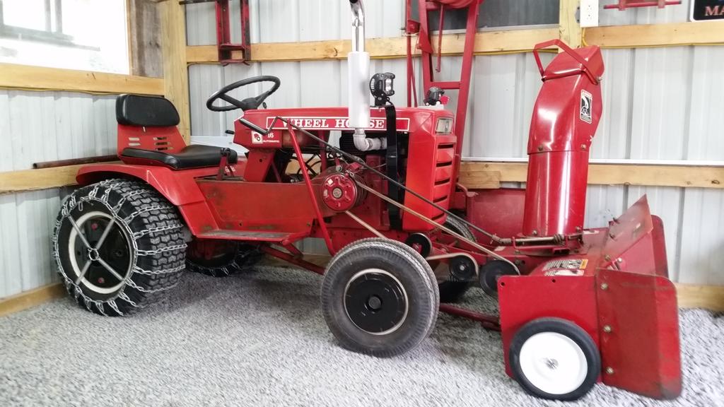

rjg854 13,096 #3334 Posted October 20, 2019 Took the weights off the loaded wheels that was on the 68 Commando 8 and swapped them over onto the 877 which will be the plow tractor this year. Put the axle bracket on and then the plow. Put the front wheels on that have the weights and roller chains. All that's left to do is put the chains on the rear wheels at some point. Now both tractors are ready for work 5 5 Share this post Link to post Share on other sites
Burnerman 759 #3335 Posted October 20, 2019 6 hours ago, ZXT said: Do you know what engine that is? Looks like an Ideal but I've never seen one with the exhaust exiting the top of the head. I do not. It is an air cooled hit or miss which I don’t think I’ve ever seen. I didn’t get to talk to the owner. I’d love to see it run. It has the drive belt pulley mounted to the crank behind the flywheel. Very well done. 2 Share this post Link to post Share on other sites

ZXT 2,402 #3337 Posted October 20, 2019 7 minutes ago, Burnerman said: I do not. It is an air cooled hit or miss which I don’t think I’ve ever seen. I didn’t get to talk to the owner. I’d love to see it run. It has the drive belt pulley mounted to the crank behind the flywheel. Very well done. I did a bit of looking around and it appears to be a 1.5 HP Associated "Busy Boy". Can't say I've ever seen that model before. 1 Share this post Link to post Share on other sites
Burnerman 759 #3338 Posted October 20, 2019 7 minutes ago, ZXT said: I did a bit of looking around and it appears to be a 1.5 HP Associated "Busy Boy". Can't say I've ever seen that model before. All I know is it’s about the most expensive WH repower I’ve seen! 😁 1 1 Share this post Link to post Share on other sites

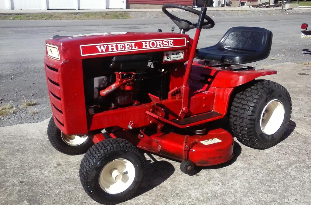

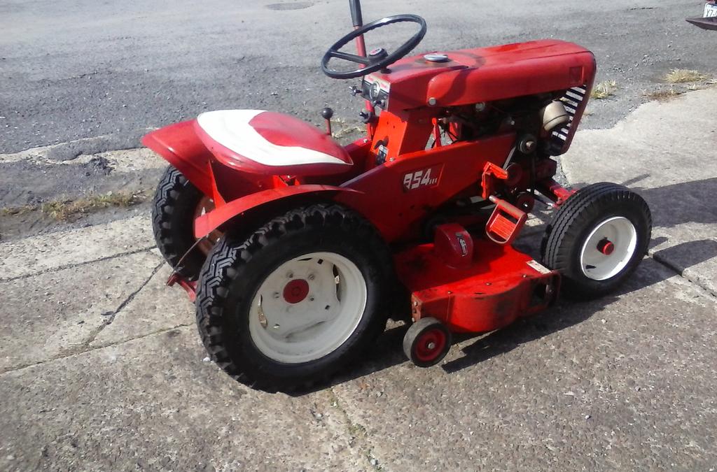

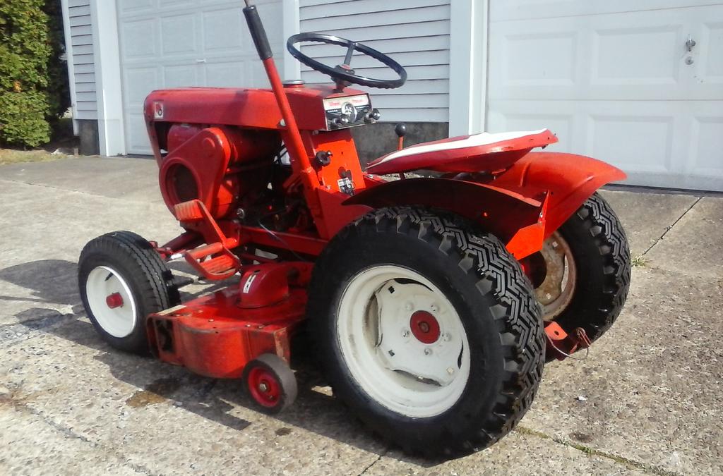

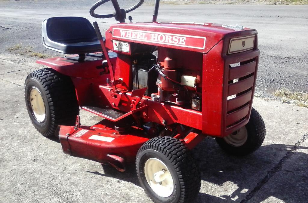

Tach-a-matic 357 #3339 Posted October 20, 2019 (edited) The original seat pan was rusted through so a "new" seat was installed today It came off of this model. IMO this series should not have had the "Wheel Horse" name on the hood. The Vanguard single still runs good but everything else around it is worn out and its not worth fixing Edited October 20, 2019 by Tach-a-matic 2 Share this post Link to post Share on other sites

Lane Ranger 11,983 #3342 Posted October 21, 2019 4 hours ago, N875ED said: Lane Ranger: What paint system (brand, primer, typ, etc.) and color did you use to repaint your plow? Is there a manufacturer that makes “official” Wheel Horse red? I just use Regal Red Rustoleum. Been using it for years. 2 Share this post Link to post Share on other sites
Tractorhead 9,217 #3343 Posted October 21, 2019 9 hours ago, ZXT said: What's a level engine? Call it standing engine, or stationary engine they‘re in the past used for Friction Belt driven Systems. Something like this 2 Share this post Link to post Share on other sites

FAST 87 #3345 Posted October 21, 2019 16 hours ago, rjg854 said: Took the weights off the loaded wheels that was on the 68 Commando 8 and swapped them over onto the 877 which will be the plow tractor this year. Put the axle bracket on and then the plow. Put the front wheels on that have the weights and roller chains. All that's left to do is put the chains on the rear wheels at some point. Now both tractors are ready for work What wheels are on that snow thrower ? My snow thrower just has little metal wheels. Would love to have mine like this. 1 Share this post Link to post Share on other sites

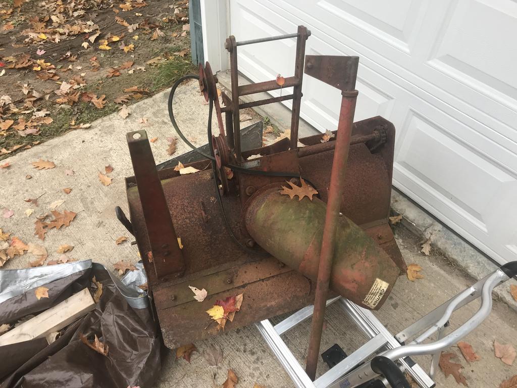

FAST 87 #3346 Posted October 21, 2019 Bought a very beat up snow thrower but it had the flag and rod to raise and lower the thrower and that’s the part I was missing. Paid $35 for the whole thing. 3 Share this post Link to post Share on other sites

Stepney 2,357 #3348 Posted October 21, 2019 23 hours ago, ZXT said: I did a bit of looking around and it appears to be a 1.5 HP Associated "Busy Boy". Can't say I've ever seen that model before. It's either a Chore Boy Aircooled, or a Busy Boy. About the only difference that can explain that is the igniter trip. They are otherwise the same engine. I have an A/C Chore Boy 1.5 myself. Not too common for sure. ..Today? Put the old tub cart vacuum to work! 6 Share this post Link to post Share on other sites
