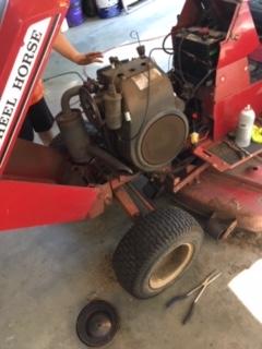

TonyToro 1,190 #3078 Posted September 22, 2019 Well..... that C-145 may end up staying. My son and I got it running today. It needed a few things and a good carburetor cleaning but within a few hours it was running. He got about 2hrs seat time🙄 driving around and mowing. It actually mowed nicely. The hydrostatic operation made it super easy for him to use. I guess no we are considered collectors! Lol 2 4 1 Share this post Link to post Share on other sites

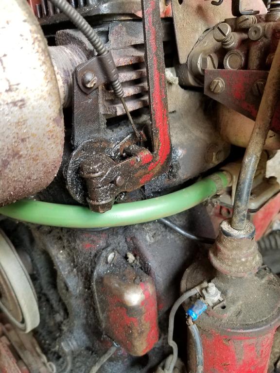

cafoose 3,878 #3079 Posted September 22, 2019 Gas was leaking somewhere between the tank and carburetor on my 876. I would put some gas in the tank and the next day it was empty. I could not find any evidence of leaking gas and it runs great so I doubt it's in the float. I got a new shutoff from and used the new tank I got from @Ed Kennell at the big show a couple years ago. The fuel line was shot so I replaced that while it was apart. I noticed what looked like fresh oil around the governor shaft. I guess the seal is leaking 3 1 Share this post Link to post Share on other sites
ebinmaine 80,916 #3080 Posted September 22, 2019 9 minutes ago, cafoose said: governor shaft. .... seal There's a seal there?? Isn't one on my '74 8hp.... Share this post Link to post Share on other sites
cafoose 3,878 #3081 Posted September 22, 2019 Don't know just guessing why else would oil leak there? Share this post Link to post Share on other sites

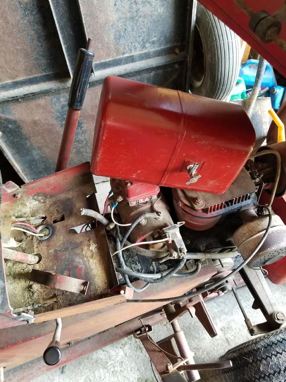

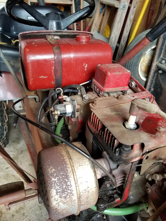

adsm08 5,195 #3082 Posted September 22, 2019 I think I blew up the voltage regulator. It tipped back and hit the gas tank as I was cranking, and now my headlights don't work anymore. So I added some insulation. That is Coroplast tape. It is fabric tape, insulates like electrical tape, and is resistant to heat, gas, and oil. It doesn't always like to stick to things that aren't other pieces of Coroplast, but it seemed to adhere to the tank well enough. This was what Ford had us wrapping the wiring harnesses of the 1.6L Escapes in to keep fluids out of the wiring during the 11S16 recall when they were catching on fire. 1 Share this post Link to post Share on other sites
ebinmaine 80,916 #3083 Posted September 22, 2019 21 minutes ago, adsm08 said: blew up the voltage regulator 49 minutes ago, cafoose said: Don't know just guessing why else would oil leak there? Others could answer more accurately but maybe oil breather clogged? Oil level ok? Gas isn't mixing in there? Share this post Link to post Share on other sites
adsm08 5,195 #3084 Posted September 22, 2019 2 minutes ago, ebinmaine said: You are telling me. I just pulled the cover off, the one section of copper coil is burnt black and has a big piece busted out. Now if only I could find a part number. I have only found one Delco-Remy that looks like this one and it says it's for a 6V positive ground, which does not seem to describe my system. Share this post Link to post Share on other sites
ebinmaine 80,916 #3085 Posted September 22, 2019 3 minutes ago, adsm08 said: You are telling me. I just pulled the cover off, the one section of copper coil is burnt black and has a big piece busted out. Now if only I could find a part number. I have only found one Delco-Remy that looks like this one and it says it's for a 6V positive ground, which does not seem to describe my system. Post the question in the electrical section or do a search there. Someone around here will lead you the right way. Share this post Link to post Share on other sites
adsm08 5,195 #3086 Posted September 22, 2019 10 minutes ago, ebinmaine said: Post the question in the electrical section or do a search there. Someone around here will lead you the right way. I think I found it, this appears to be the right one. https://www.ebay.com/itm/12-Volt-Generator-Voltage-Regulator-1118266-1118306-1118791-1118983-For-Delco-/281159796267 1 Share this post Link to post Share on other sites

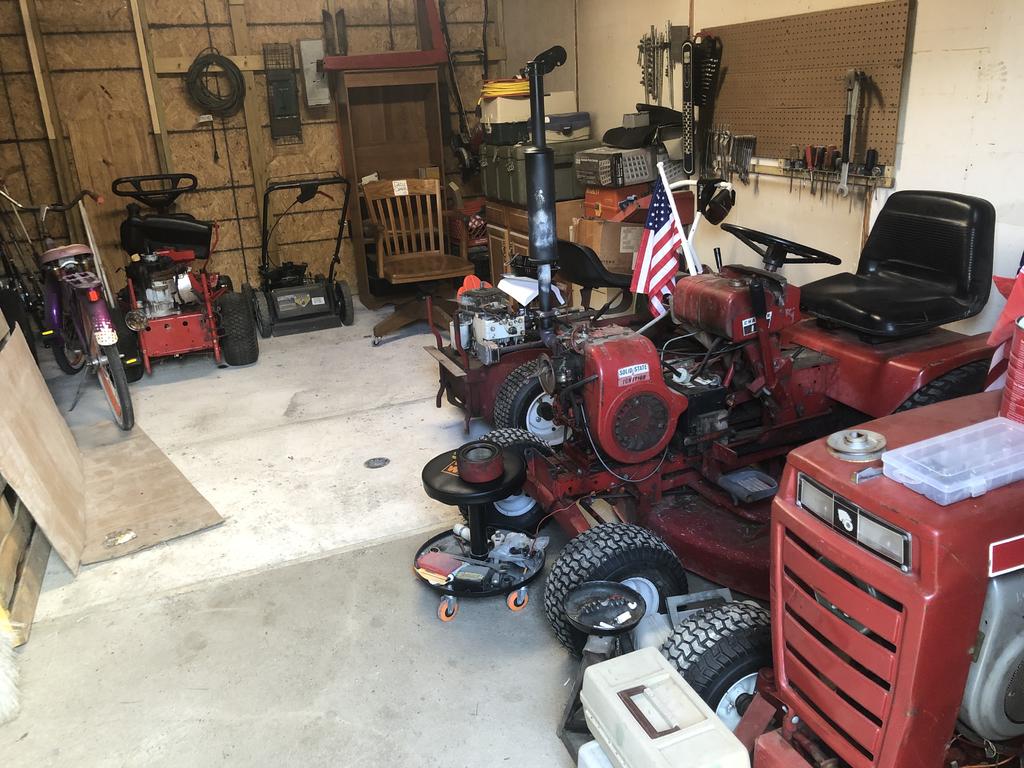

LengerichKA88 1,885 #3091 Posted September 23, 2019 Well, I’ve done a bit here and there recently, but it’s been hard to find the time now that I’m working again. FINALLY got the floor to the horse barn done, and was able to move everything in this weekend. Now I have my own space to work on my own things. I should be able to come out and work on things as I find the time. 1 1 2 Share this post Link to post Share on other sites
pfrederi 21,218 #3092 Posted September 23, 2019 16 hours ago, adsm08 said: I think I found it, this appears to be the right one. https://www.ebay.com/itm/12-Volt-Generator-Voltage-Regulator-1118266-1118306-1118791-1118983-For-Delco-/281159796267 That will work. On some i have the terminals to the front and some to the back to avoid contact with Engine shroud or fuel tank depends on the genny pulley size and the belt I have on the S/G 1 1 Share this post Link to post Share on other sites

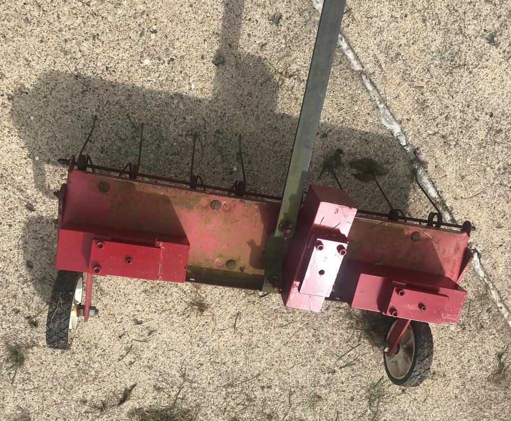

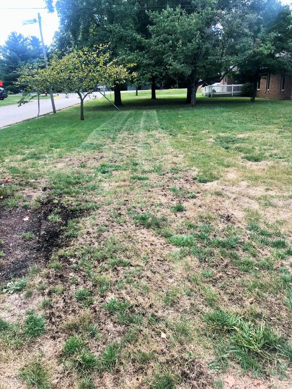

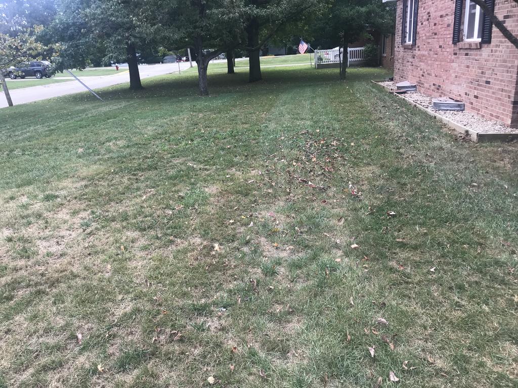

Lane Ranger 12,133 #3093 Posted September 23, 2019 Hooked up my old Snapper dethatcher to the 702 today to do some much needed lawn dethatching! Dry weather the last six weeks has done a number on my normally green lawn! Put my set of three 12 lb weights on the back of the dethatcher and cleaned it off after two passes. Does a great job. 5 Share this post Link to post Share on other sites

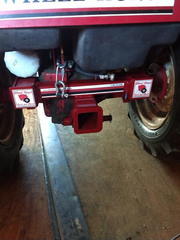

Blackhood Bill 728 #3096 Posted September 23, 2019 Well today I received my hitch from @wheelhorseman(Lowell) wheel horse parts and more), so I installed it on my C-145 auto and works great!!!!!!!! 2 2 3 Share this post Link to post Share on other sites
adsm08 5,195 #3097 Posted September 23, 2019 8 hours ago, pfrederi said: That will work. On some i have the terminals to the front and some to the back to avoid contact with Engine shroud or fuel tank depends on the genny pulley size and the belt I have on the S/G Yeah, I think my issue there was two-fold. 1) I have the longest belt that will work on there because it is the only one I could get without waiting a week. I am at the very end of the adjustment and it still slips a bit (cheap belt, stretched more than it should have once it was run in). 2) The rubber mount on my regulator is pooched. I think the vibrations of cranking and the engine puttering as it caught were enough to let it tip back and hit the L terminal on the gas tank. I know it hit because I could see the burn mark in the paint. I think the combination of those two things are what allowed it to happen though. Share this post Link to post Share on other sites

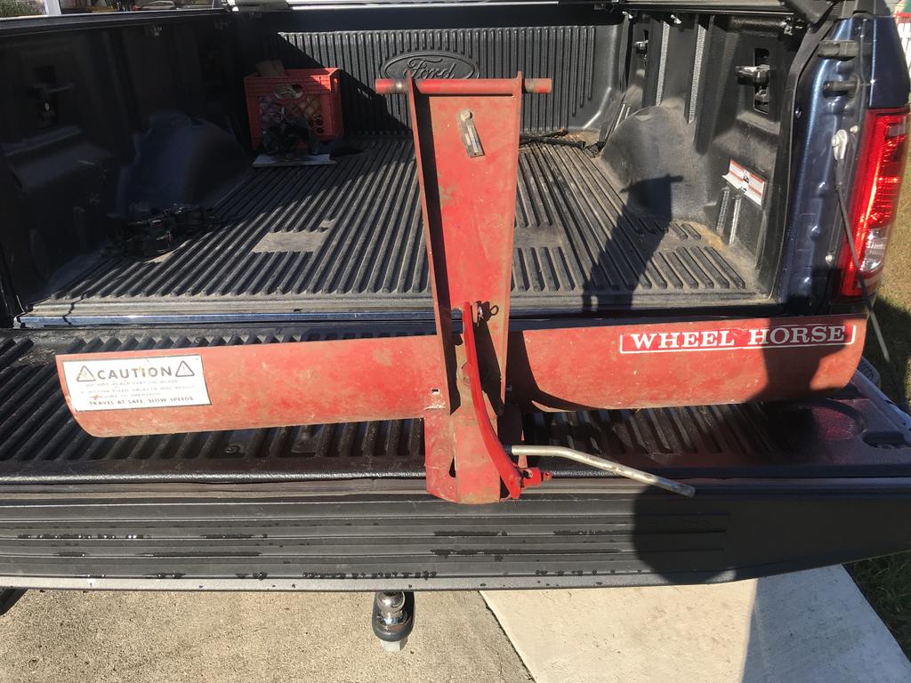

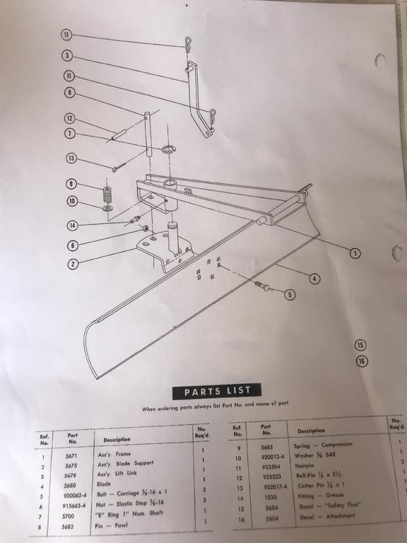

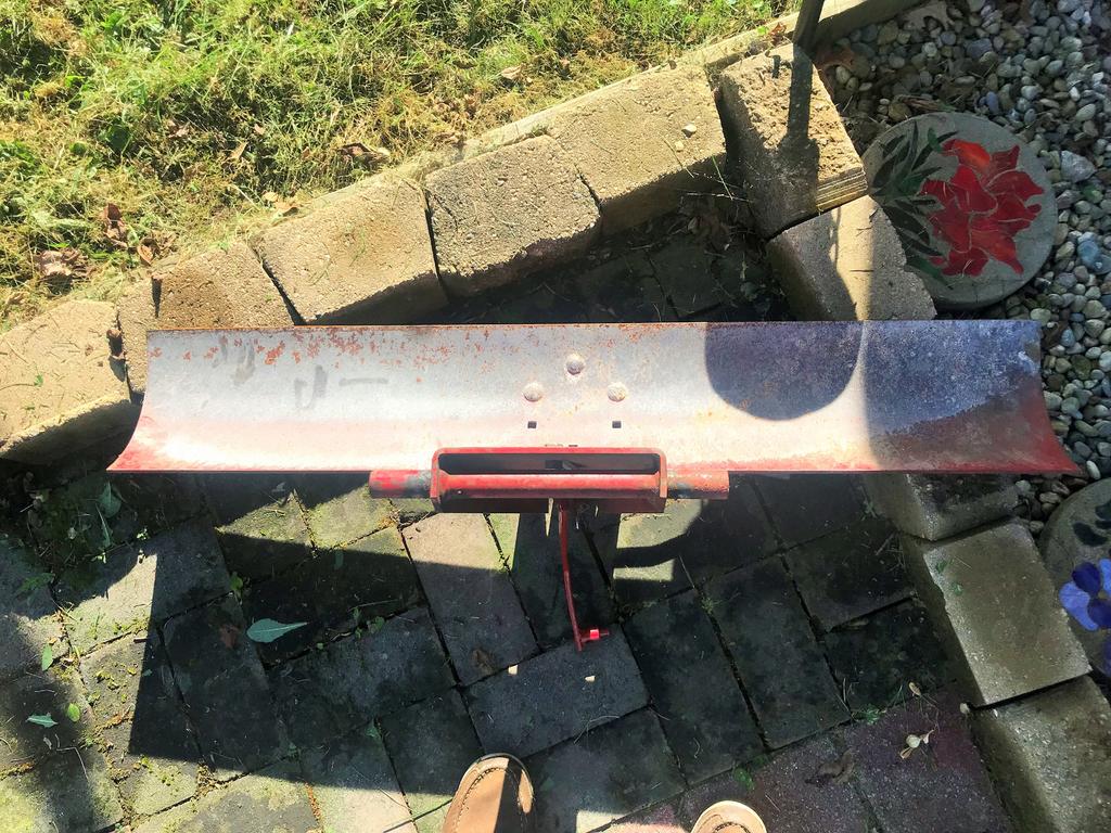

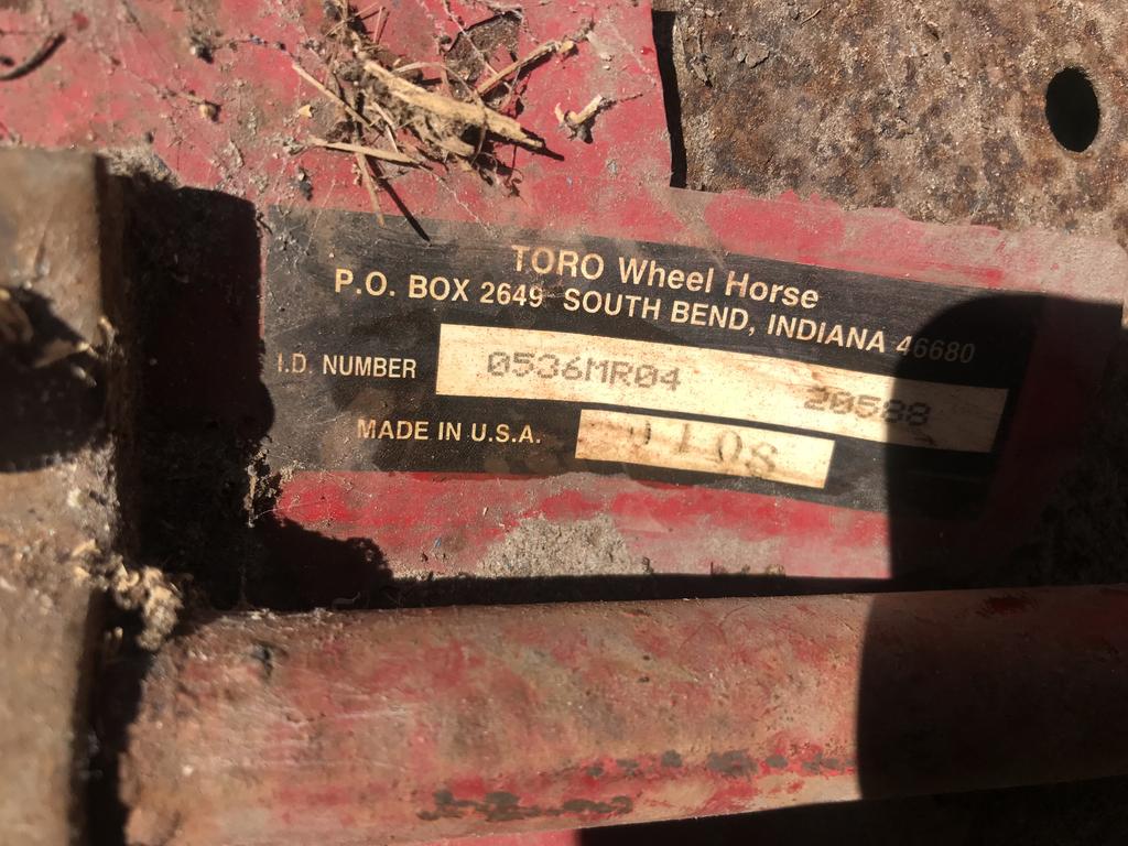

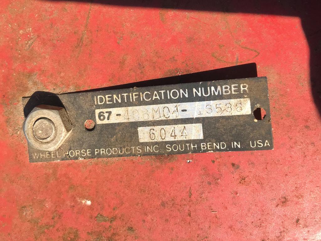

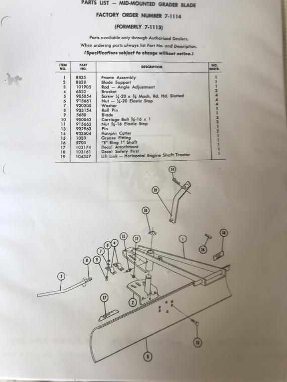

Lane Ranger 12,133 #3099 Posted September 24, 2019 Started working on a 36 inch rear discharge mower deck I got from Florida (by way of Rodney Burger) and an early mid-grader blade. Had another Mid-Grader blade needing paint so started on that too! Nice Kohler Motor Dealer Sign given to me by Rodney today! mostly has to do with the pivot handle. 3 Share this post Link to post Share on other sites
