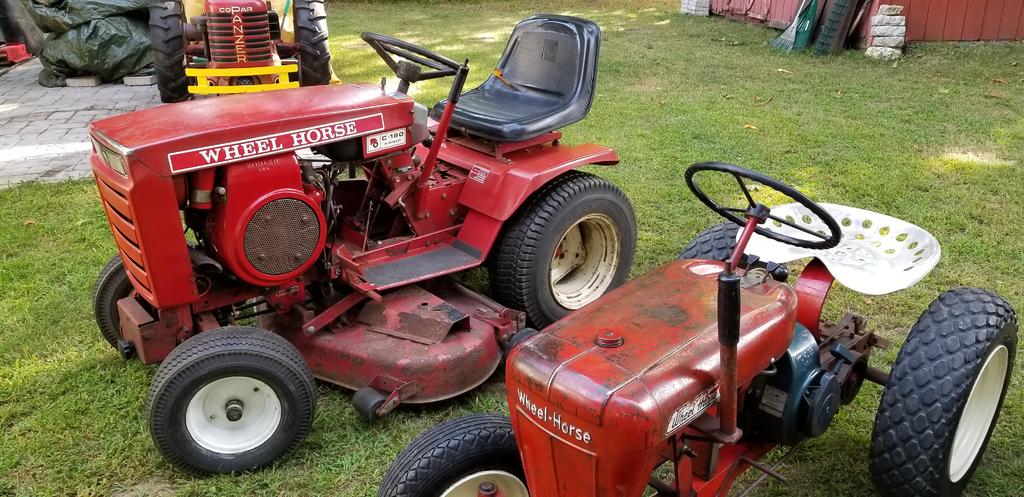

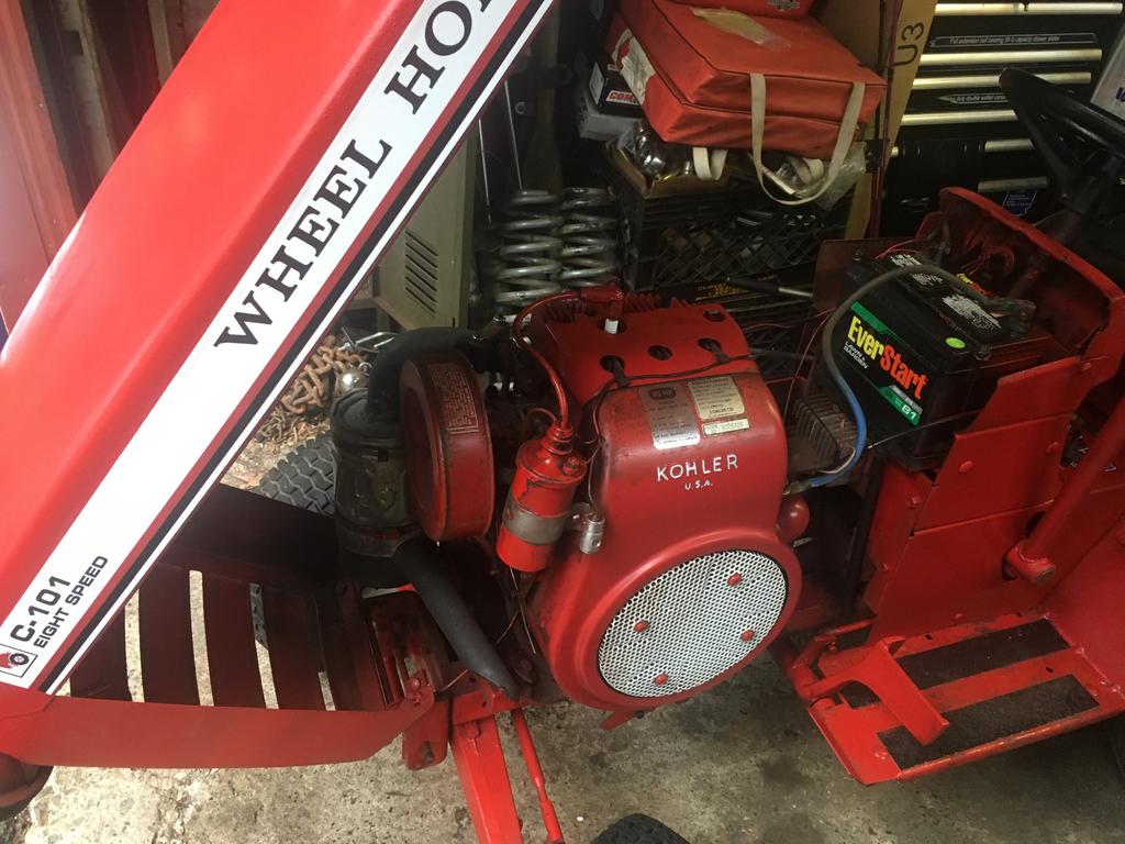

WHX?? 58,302 #2951 Posted August 28, 2019 Nice I like it Dan ...where did the pan come from? You piston me off tho..you was supposed to thin my fender pan herd! 2 Share this post Link to post Share on other sites
Achto 32,842 #2952 Posted August 28, 2019 1 minute ago, WHX24 said: where did the pan come from? You piston me off tho..you was supposed to thin my fender pan herd! The fenders came with the C-101 that I picked up Sunday. Don't worry about your fender supply, I'm thinkin' that a set of 520 fenders might look even better on it. 2 1 Share this post Link to post Share on other sites
ebinmaine 80,912 #2953 Posted August 28, 2019 20 minutes ago, Achto said: My C-145 said good by to it's busted up plastic fenders, and hello to a set of more respectable steel fenders Sooooooo much better!!!!! 1 1 Share this post Link to post Share on other sites

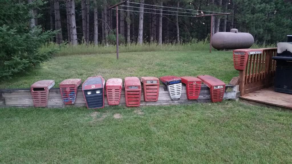

WHX?? 58,302 #2954 Posted August 28, 2019 Whilst your here pick out a hood! 1 3 2 Share this post Link to post Share on other sites
WHX?? 58,302 #2955 Posted August 28, 2019 (edited) 1 hour ago, Achto said: I'm thinkin' that a set of 520 fenders might look even better on it. Come get it then.... the ant infested ungly seat has to go with them tho! All yours for free if you have the stones to sit on the seat! ...Where's my camera! 0 Edited August 28, 2019 by WHX24 4 Share this post Link to post Share on other sites

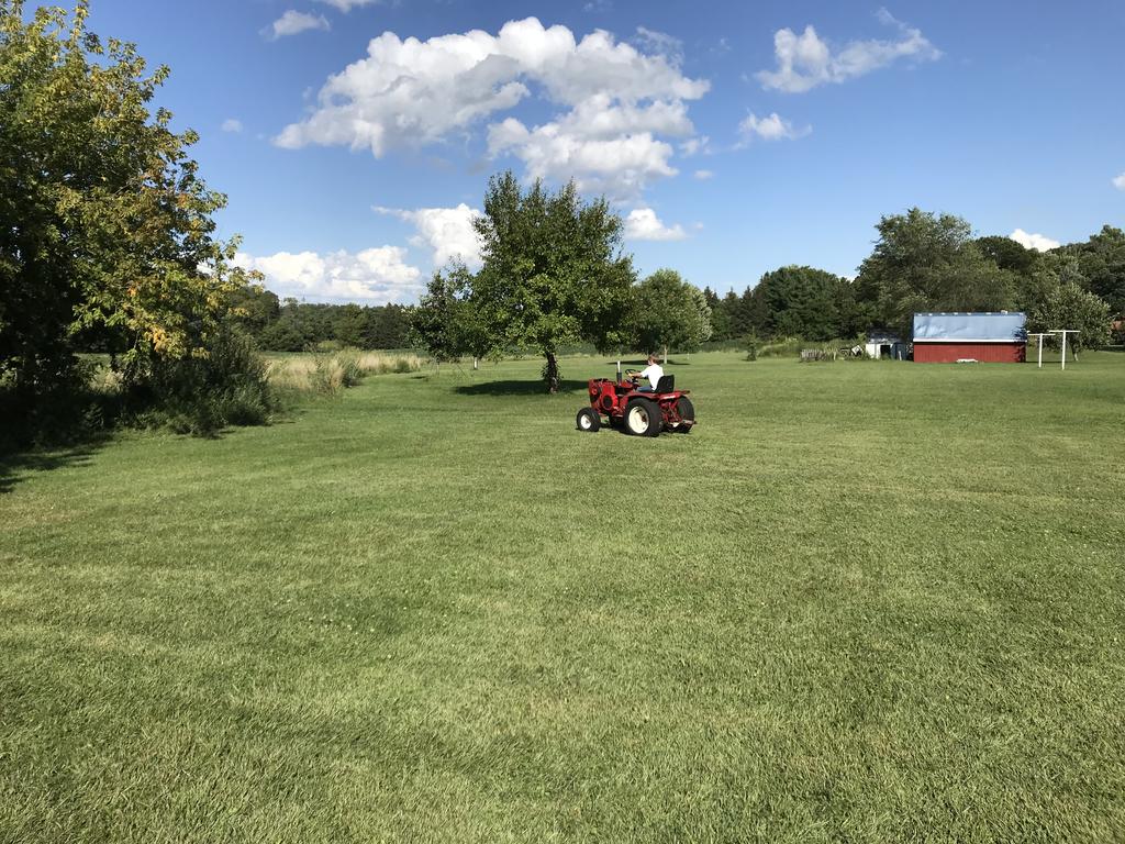

PeacemakerJack 11,068 #2956 Posted August 28, 2019 Because Zach isn’t old enough to have his own account yet...I’m posting this one for him...but it is a BIG ONE. He got to drive his GT-14 named “Blackbeard” for the very first time today—SOLO! He was so stoked! He has owned it for three full years but it has been too tired to do much for the last two years. We just finished repowering it with a monster Magnum 16 and he loves it. Just like that and he was gone to investigate the back acreage! What’s better than a boy and his horse? 2 1 1 8 Share this post Link to post Share on other sites
Tractorhead 9,217 #2957 Posted August 28, 2019 Maybe a Boy a two Horses.. 😂 1 4 Share this post Link to post Share on other sites
ebinmaine 80,912 #2958 Posted August 28, 2019 4 hours ago, Tractorhead said: Maybe a Boy a two Horses.. 😂 @PeacemakerJack AWESOME. But Stefan's got a valid point. You need to get more Horses now... 4 Share this post Link to post Share on other sites

Pullstart 71,362 #2961 Posted August 28, 2019 8 hours ago, PeacemakerJack said: Because Zach isn’t old enough to have his own account yet...I’m posting this one for him...but it is a BIG ONE. He got to drive his GT-14 named “Blackbeard” for the very first time today—SOLO! He was so stoked! He has owned it for three full years but it has been too tired to do much for the last two years. We just finished repowering it with a monster Magnum 16 and he loves it. Just like that and he was gone to investigate the back acreage! What’s better than a boy and his horse? Woo Hoo! Great work guys and nice job wheelin’ it Zach! 1 1 Share this post Link to post Share on other sites

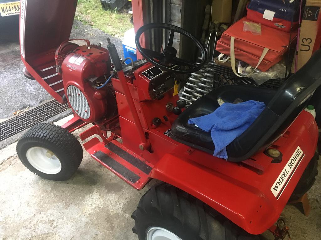

Burnerman 759 #2963 Posted August 28, 2019 (edited) The engine knocks and rattles on the old girl have been bugging me for years now. So I figured I’d see what closing the point gap would do. She got a brand new plug too. 👍 Dialed them back to 0.016 runs very smooth and a lot quieter. I know for sure now I have a loose camshaft and piston slap. Time to start hiding $$ for a rebuild. 😁😇 Edited August 28, 2019 by Burnerman 6 1 Share this post Link to post Share on other sites

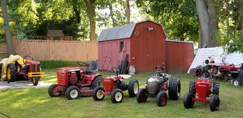

AMC RULES 37,260 #2965 Posted September 1, 2019 While mucking stalls today... got a few 's out into the sunlight again. 1 10 1 Share this post Link to post Share on other sites

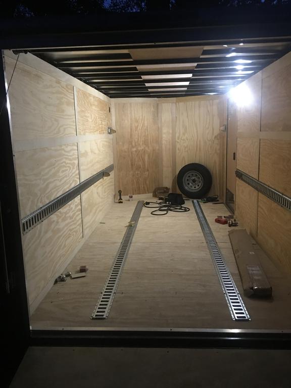

19richie66 17,937 #2966 Posted September 1, 2019 (edited) There is an underground bunker somewhere on @AMC RULES property. Didn’t do anything to any horse but did install my E-track in the horse hauler. Edited September 1, 2019 by 19richie66 5 1 2 Share this post Link to post Share on other sites

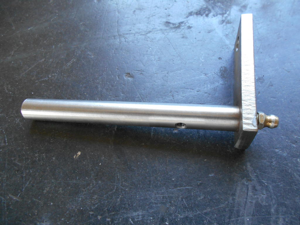

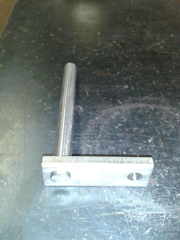

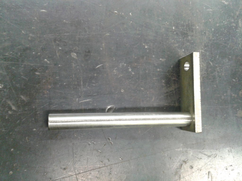

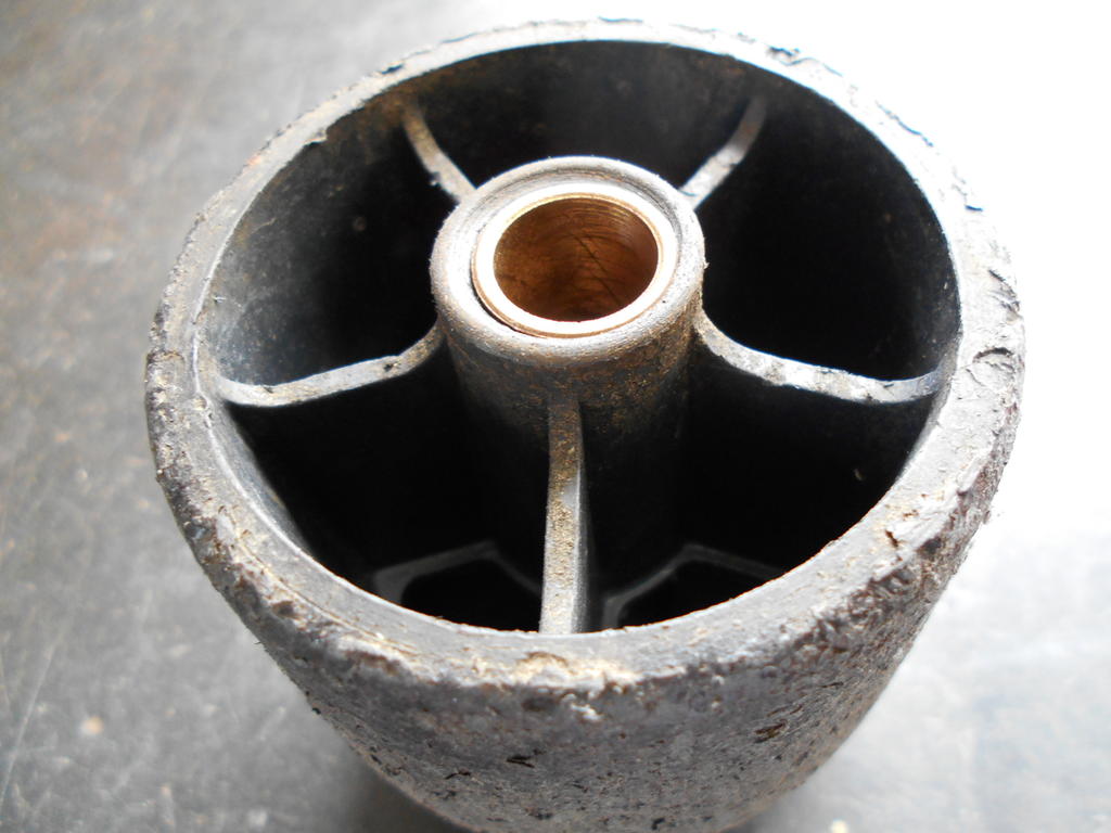

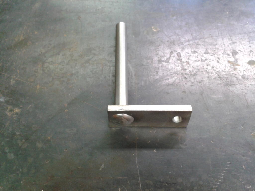

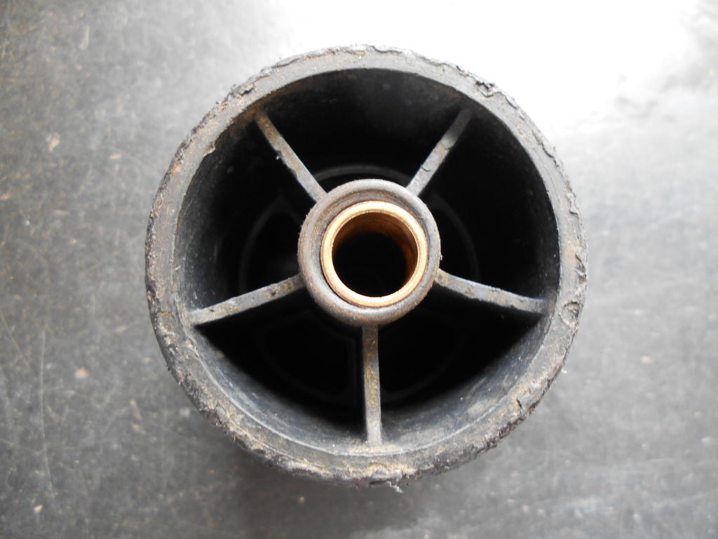

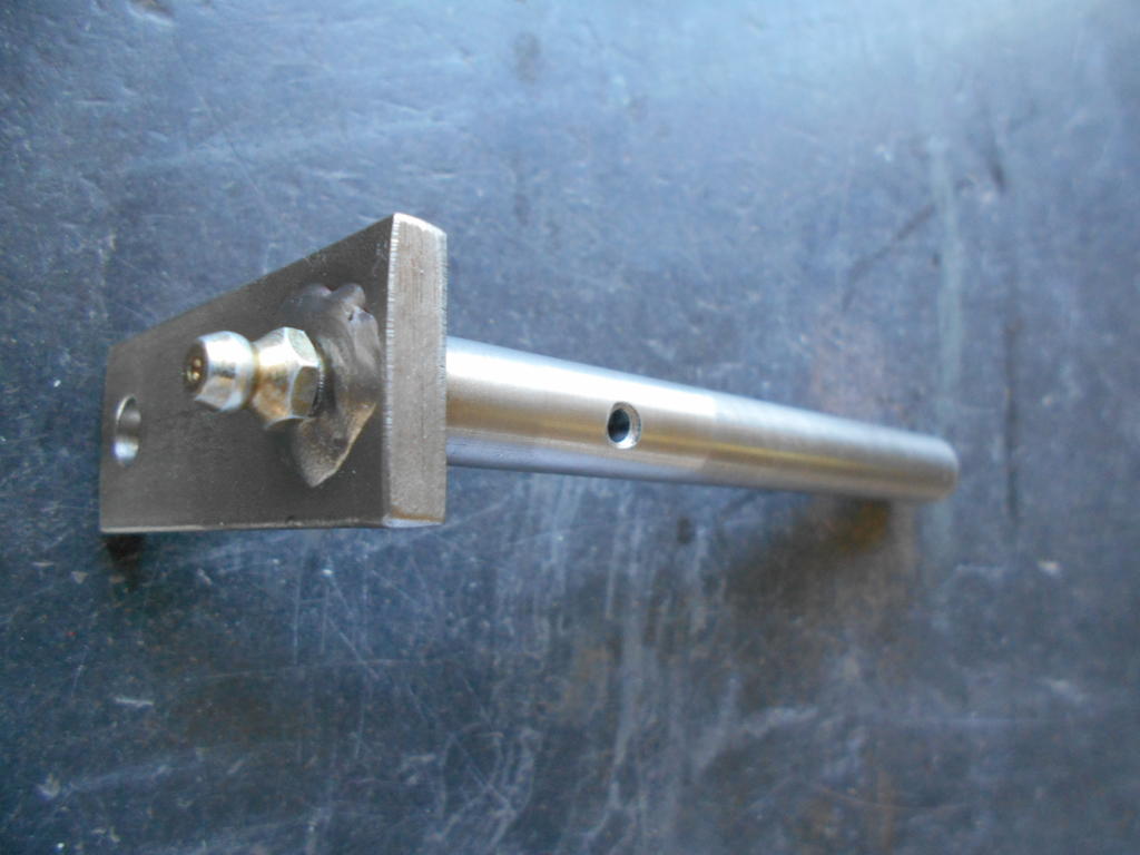

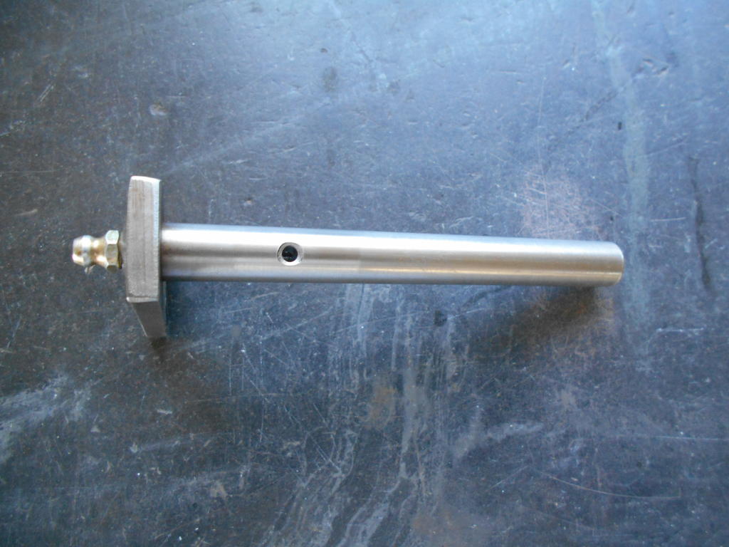

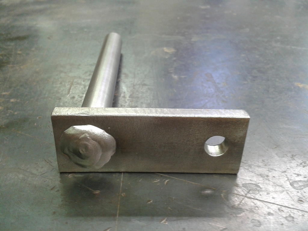

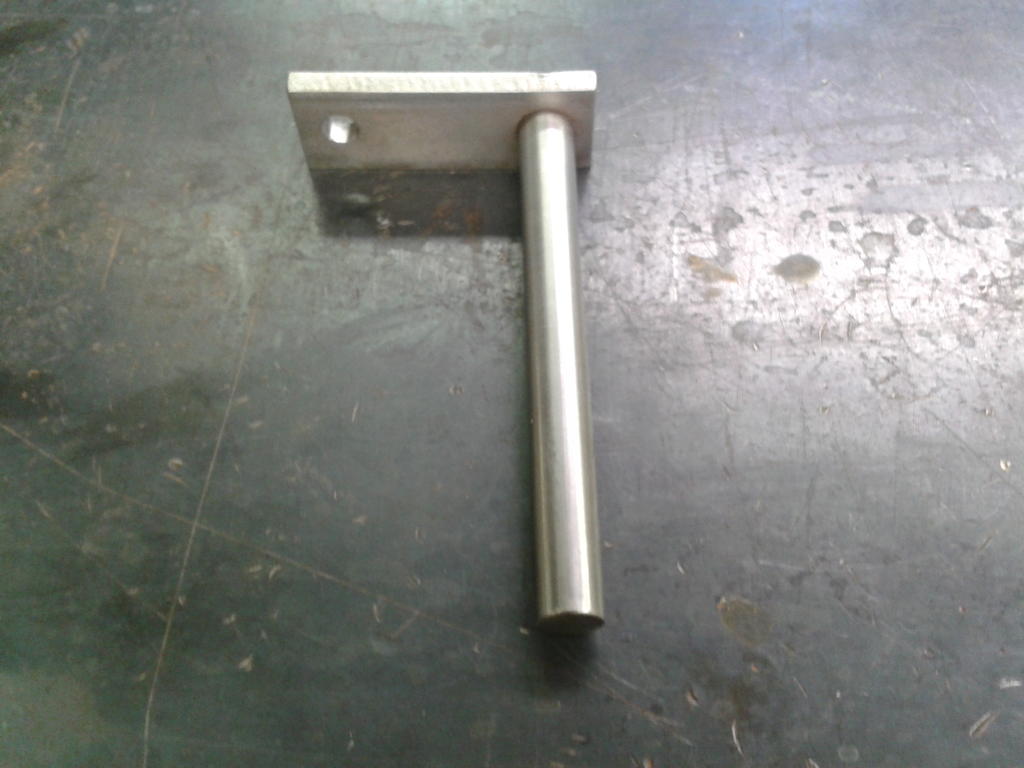

cleat 9,380 #2967 Posted September 1, 2019 (edited) On 4/22/2019 at 9:53 PM, cleat said: I make mine like that as well. Here are mine Here are the plans Deck roller shaft.pdf 27.16 kB · 2 downloads Yours looks nicer with the rounded off ends. Cleat I pressed brass bushings into the rollers as they were worn. After a few mowings they start to squeak a bit so I drilled and tapped a roller shaft for greasing. I will install this one and see how it works before doing the rest. Cleat Edited September 1, 2019 by cleat 4 1 Share this post Link to post Share on other sites
19richie66 17,937 #2968 Posted September 1, 2019 Nice work @cleat Share this post Link to post Share on other sites

The Tuul Crib 7,354 #2973 Posted September 2, 2019 9 hours ago, cleat said: I pressed brass bushings into the rollers as they were worn. After a few mowings they start to squeak a bit so I drilled and tapped a roller shaft for greasing. I will install this one and see how it works before doing the rest. Cleat Nice idea! Share this post Link to post Share on other sites

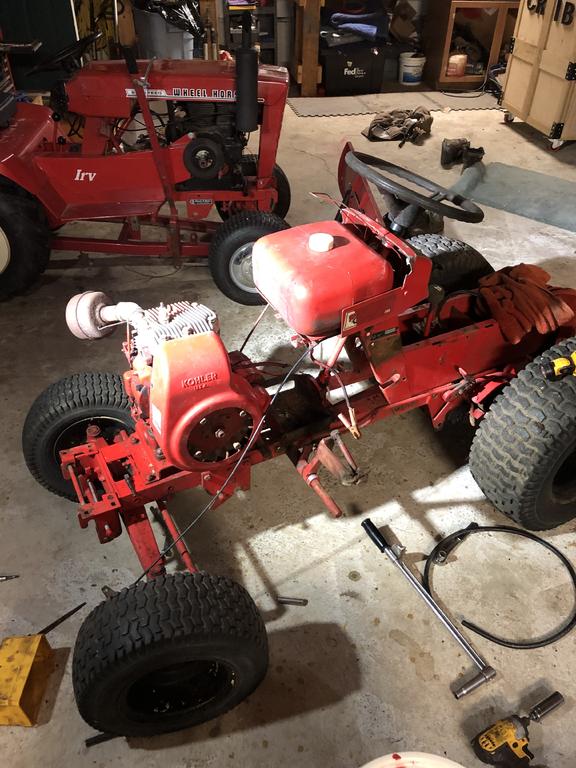

The Tuul Crib 7,354 #2974 Posted September 2, 2019 I'm working on this 8 horse no name that I picked up for next to nothing I robed some parts off of it to put on IRV . So now I am trying to get it running and use it around the yard to pull my wagon with dirt and firewood 3 2 Share this post Link to post Share on other sites
