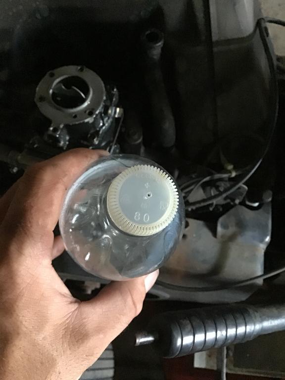

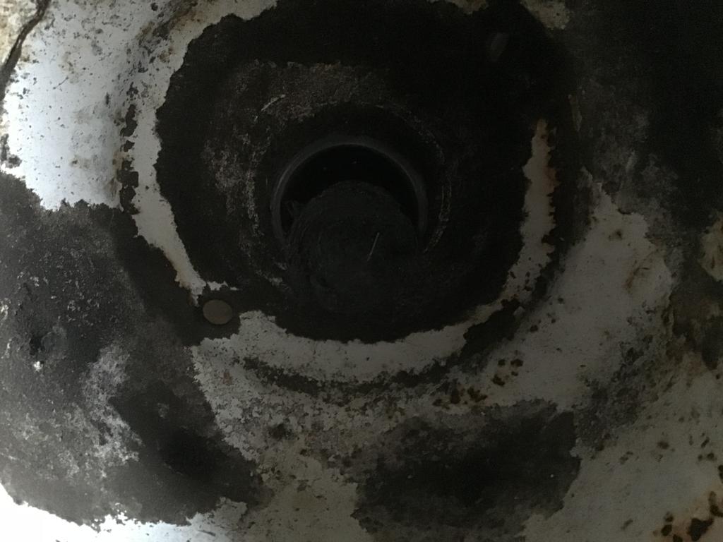

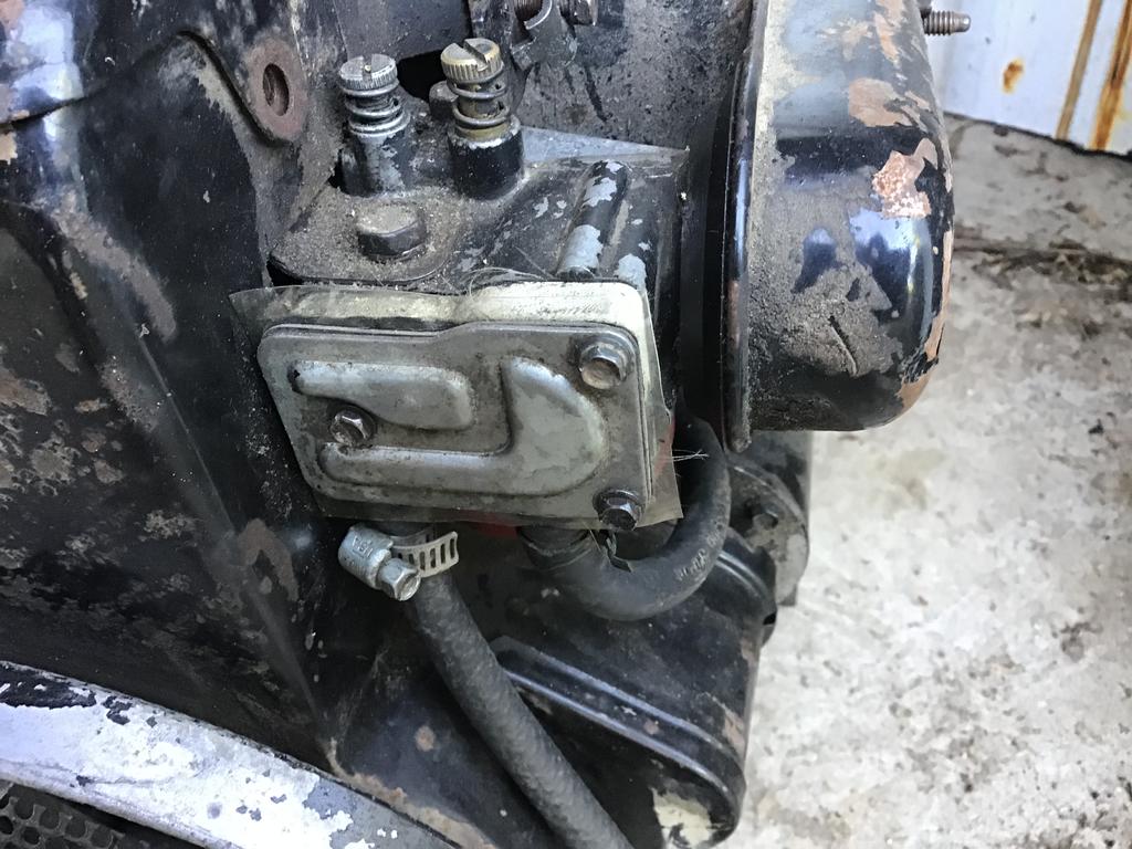

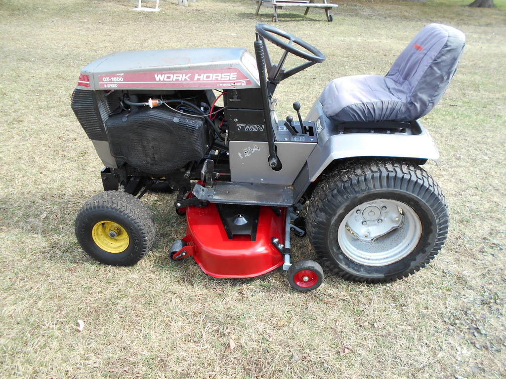

Pullstart 71,360 #2751 Posted July 23, 2019 12 minutes ago, Blackhood Bill said: @pullstart according to tractor data.com that came with a 655 cc twin cylinder Briggs. Made in 1984. I'm not sure of the part number your asking for. I'd bet that Lincoln at A-Z could help you with one. Does it run? Sure would be a great addition to the herd! I was told it runs, if you dump gas down the carb The fuel line is 100% blocked and the pump has no diaphragm on either side of the block. We’ll get it going 1 Share this post Link to post Share on other sites
Blackhood Bill 728 #2752 Posted July 23, 2019 I've also learned over the years, you might take some white gas ( Coleman lantern fuel) and run it backwards thru there that it might clean it out also. 2 Share this post Link to post Share on other sites

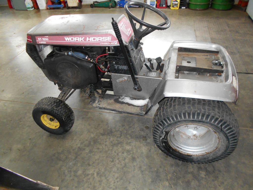

Pullstart 71,360 #2754 Posted July 24, 2019 The GT-1600 is alive! Well, sort of. Blowing air through the lines cleared the blockage in the fuel system, it drained into a water bottle just dandy. I poked a hole in the cap and bottle fed it for a ride around the yard! Once I get that fuel pump put together, next task will be figuring out why the PTO bell seems to wobble so bad! Maybe some day I’ll toss a spare front wheel on too. There’s no bearing left on the outer hub! 2 Share this post Link to post Share on other sites
Pullstart 71,360 #2755 Posted July 24, 2019 On 7/22/2019 at 10:53 PM, Achto said: Ok I'm not completely sure which engine your new tractor has. Is that an opposed BS twin? Fuel pumps on those were a common problem. If that is what you have hopefully it is the 3 screw pump as those are a little cheaper than the 4 screw pumps. Here is a site that offers the rebuild kits, even if you don't order from them you will be able to get the factory part #'s from their site. http://www.psep.biz/store/briggs_stratton_fuel_pump.htm Hey Dan check out the pump on that Sears Briggs! It looks like a tiny bit of home brew went into that fix. Maybe the acetone gas can would have been the giveaway? 1 1 Share this post Link to post Share on other sites

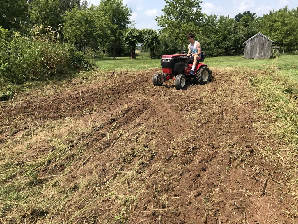

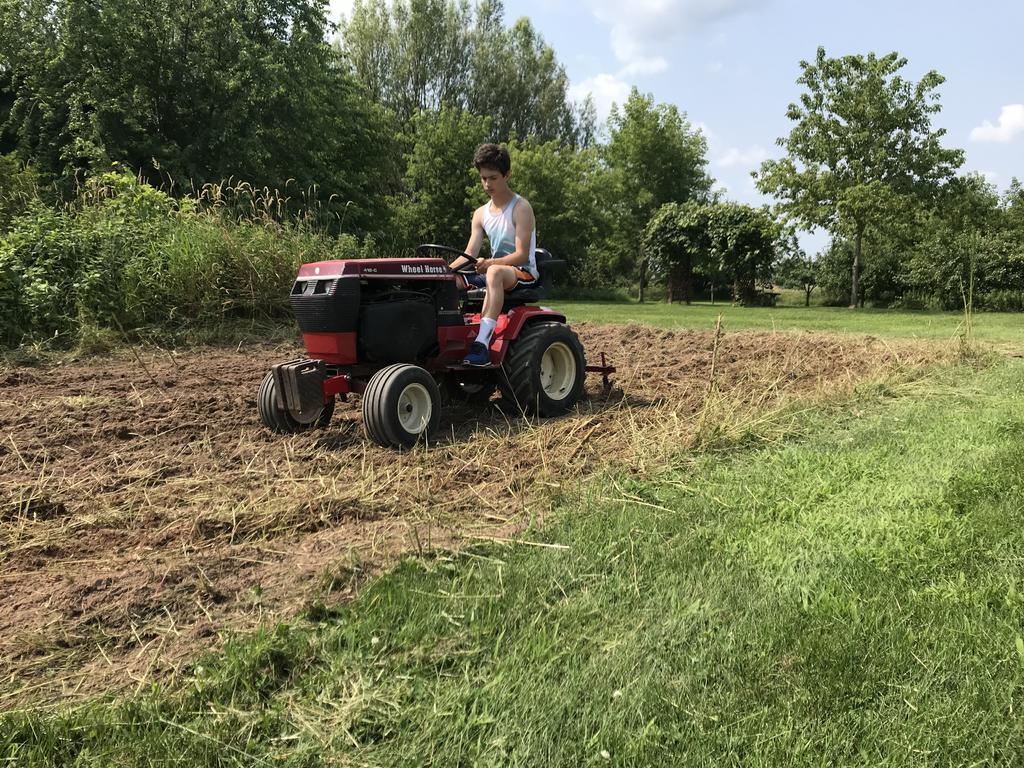

PeacemakerJack 11,068 #2757 Posted July 25, 2019 Today...it was more @Coulter Caleb on the horse than me but it was what we did... I had failed to plant a garden this spring and it is overcome with weeds and basically an eyesore. I made up my mind after spending the morning in the office pouring over bids, bills, and paperwork that I was ready to do some physical work. I got out the Big D and mowed the weed patch down and then began the tedious job of tearing up the soil. Normally I would plow it first but I had never leveled from last falls plowing and it was a bumpy mess. Caleb grabbed JackRabbit and his digger from Craig and got to work. Momma had the little boys working in the house and so Caleb slapped a couple of weights on the digger and broke up the ground. As you can see, it was a real mess to begin with but after about an hour and a half we had it broken up pretty well. I followed behind him with my Troy-Bilt Bronco Tiller and then he pulled the weights and drug out the rest of the trash before it began to level out nicely. That 418-C is a nice machine and the hydro was perfect for this task. Later this week, we will hook on the drag and continue to get it the way it should be. Another fine day of using the horses! Thanks Craig for the great attachment...looks and works good👍🏻 7 7 Share this post Link to post Share on other sites
Achto 32,842 #2758 Posted July 25, 2019 10 hours ago, pullstart said: Hey Dan check out the pump on that Sears Briggs! It looks like a tiny bit of home brew went into that fix. Maybe the acetone gas can would have been the giveaway? It's surprising that the engine ran as well as it did. 1 1 Share this post Link to post Share on other sites

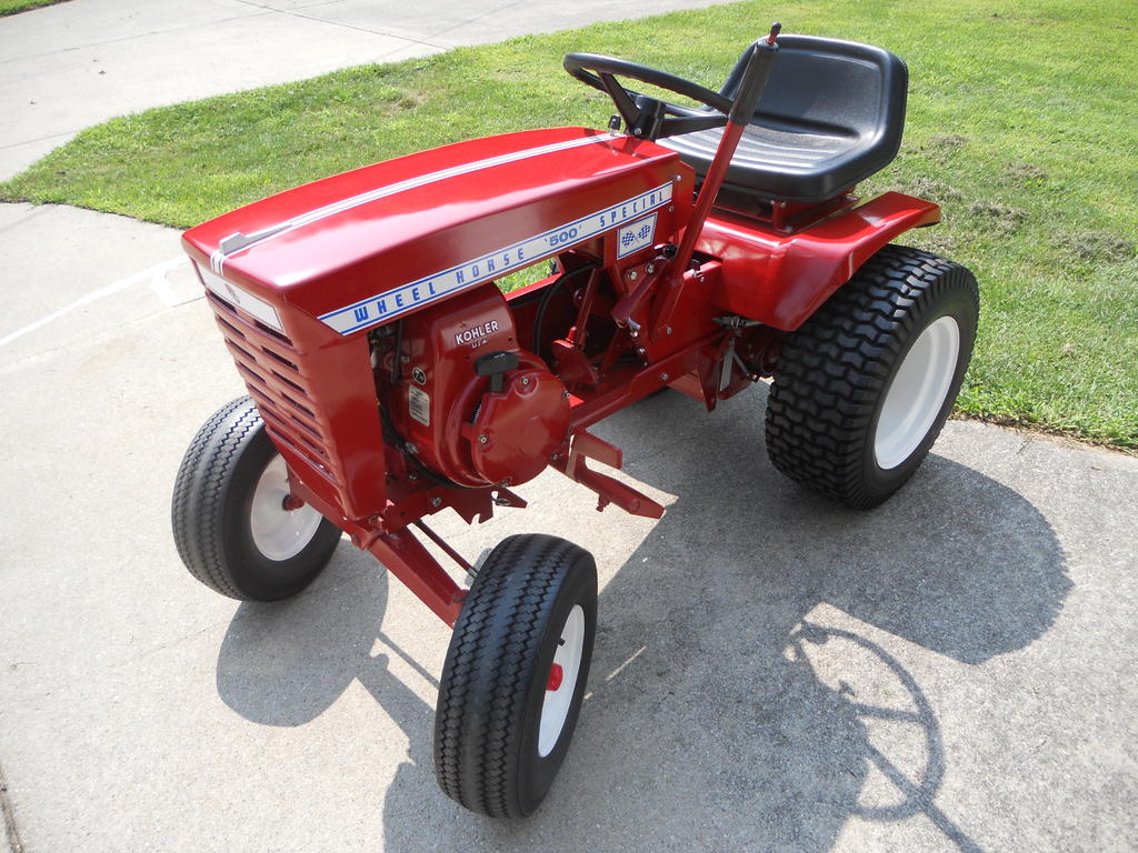

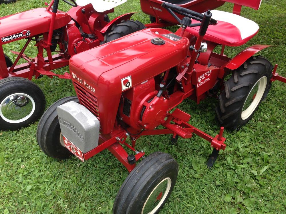

Racinbob 13,213 #2759 Posted July 25, 2019 Played with the 500 Special this morning. I mounted the fuel tank, fit the belt guard, connected the choke cable, installed a muffler, partially ran the wiring for the kill button and a couple other odds and ends. There's a few minor things I want to do but then I'm thinking this will go into storage for a while as I ponder my options on what to do. I lightly fogged the engine and I'm keeping the fuel system dry. My shoulder isn't going to get any better and yanking on a starter rope is pretty much second only to throwing a ball when it comes to irritating it. 3 6 3 Share this post Link to post Share on other sites

squonk 48,212 #2762 Posted July 25, 2019 3 hours ago, Racinbob said: Played with the 500 Special this morning. I mounted the fuel tank, fit the belt guard, connected the choke cable, installed a muffler, partially ran the wiring for the kill button and a couple other odds and ends. There's a few minor things I want to do but then I'm thinking this will go into storage for a while as I ponder my options on what to do. I lightly fogged the engine and I'm keeping the fuel system dry. My shoulder isn't going to get any better and yanking on a starter rope is pretty much second only to throwing a ball when it comes to irritating it. I wonder if rotating the starter 1 notch toward the rear would change the angle enough to help your shoulder. That's where I always had mine so I could start it from the seat. 2 Share this post Link to post Share on other sites
19richie66 17,937 #2763 Posted July 25, 2019 Yeah then you are pulling back and not up. Definitely worth a try. No on the mouse ears @Racinbob 1 1 Share this post Link to post Share on other sites

Racinbob 13,213 #2766 Posted July 25, 2019 1 hour ago, squonk said: I wonder if rotating the starter 1 notch toward the rear would change the angle enough to help your shoulder. That's where I always had mine so I could start it from the seat. I was pondering that today Mike. I'm thinking that would put it horizontal and I'd like it at about 45° but I'm going to try tomorrow. From the seat with my left arm might be the ticket. 52 minutes ago, 19richie66 said: Yeah then you are pulling back and not up. Definitely worth a try. No on the mouse ears @Racinbob I don't know Richie. I like telling the story about how this K-161 started out working for the mouse. It just seems kinda appropriate. 49 minutes ago, WHX24 said: My shoulders feeling fine these days Bob maybe I should just come get it?!?! I have guns. 9 minutes ago, squonk said: I'll tell Bob to put a Tecky back on it. That should keep you busy for a few hours! Back in 68 my Dad was looking to buy another new one. I saw a 500 Special on the showroom floor and, being a Indy 500 fan, I tried to get him to buy it. "Nope, no Tecumseh for me" was his reply. Smart man Soooooo…...I built this one touting that it is a 500 Special that my Dad would have bought. 3 2 Share this post Link to post Share on other sites

Racinbob 13,213 #2771 Posted July 26, 2019 20 hours ago, squonk said: I wonder if rotating the starter 1 notch toward the rear would change the angle enough to help your shoulder. That's where I always had mine so I could start it from the seat. Yup, what I figured. It puts it dead on horizontal and in a bad position for pulling. Share this post Link to post Share on other sites
Racinbob 13,213 #2772 Posted July 26, 2019 I have changed my mind about mothballing it for a spell. I just need to get the fuel line hooked up and the throttle cable connected. Ultimately I'll probably have to put a fuel pump on it. This engine originally had a tank on top so it didn't need a pump. I looks like I'd run out with about an inch left in the tank. 1 Share this post Link to post Share on other sites
squonk 48,212 #2773 Posted July 26, 2019 3 hours ago, Racinbob said: Yup, what I figured. It puts it dead on horizontal and in a bad position for pulling. I wonder if you have a different shroud. It lined up perfectly on my 704 1 Share this post Link to post Share on other sites
Ed Kennell 47,592 #2774 Posted July 26, 2019 1 hour ago, squonk said: I wonder if you have a different shroud. It lined up perfectly on my 704 They are different Mike. Your bolts straddle the vertical C/L. His are on the C/L. 1 Share this post Link to post Share on other sites
Racinbob 13,213 #2775 Posted July 27, 2019 There you go. I've got a bolt at the 12 o'clock position. Your 704 doesn't Mike. I never thought about the bolt placement being different. Splitting the difference of where my rope is in the picture and where it ends up by rotating the starter one bolt clockwise would be just right. I'm going to see if the K181 on the 854 even has the threaded holes. If so, and they are in the location I need, a possible swap? 1 Share this post Link to post Share on other sites
