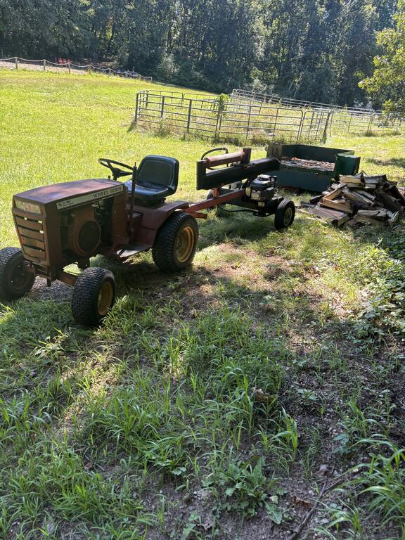

TonyToro Jr. 2,547 #26731 Posted September 15 Split some wood today and the C-121 was on log splitter hauling duty. 8 4 Share this post Link to post Share on other sites

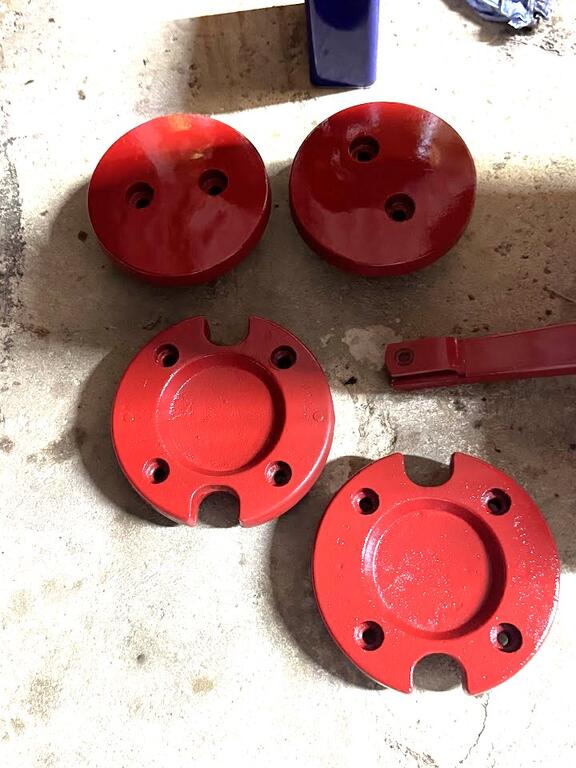

Bar Nuthin 3,342 #26732 Posted September 16 (edited) Picked up some HEAVY Bolens front cast iron weights. They had "BOLENS" cast into the face, so I filled them with some JB Weld. Decided while I was painting them, that my JD rear weights needed to be red too! Now all my iron weights are red. Just one set of plastic fronts are the odd-balls now. Started doing a little prep work for an upcoming parade in our local festival. Edited September 16 by Bar Nuthin 9 Share this post Link to post Share on other sites

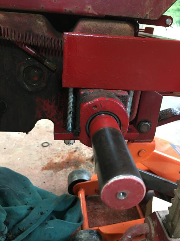

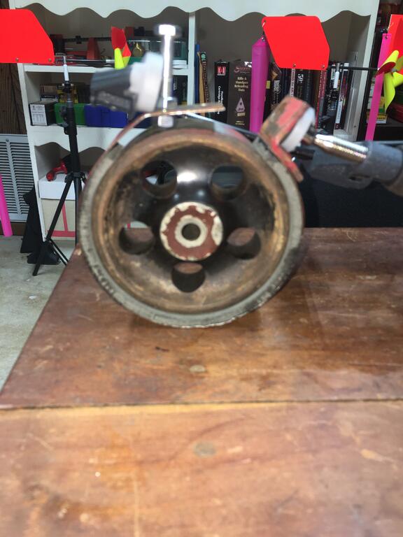

sqrlgtr 4,084 #26733 Posted September 18 Replaced both axle seals and brake shaft seal on C160, and thanks to @rmaynard glued up a new brake band for same tractor. Hopefully get put back together tomorrow or maybe this evening. 4 6 Share this post Link to post Share on other sites

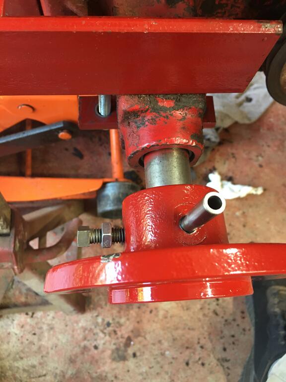

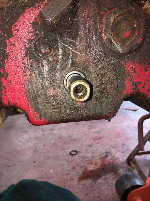

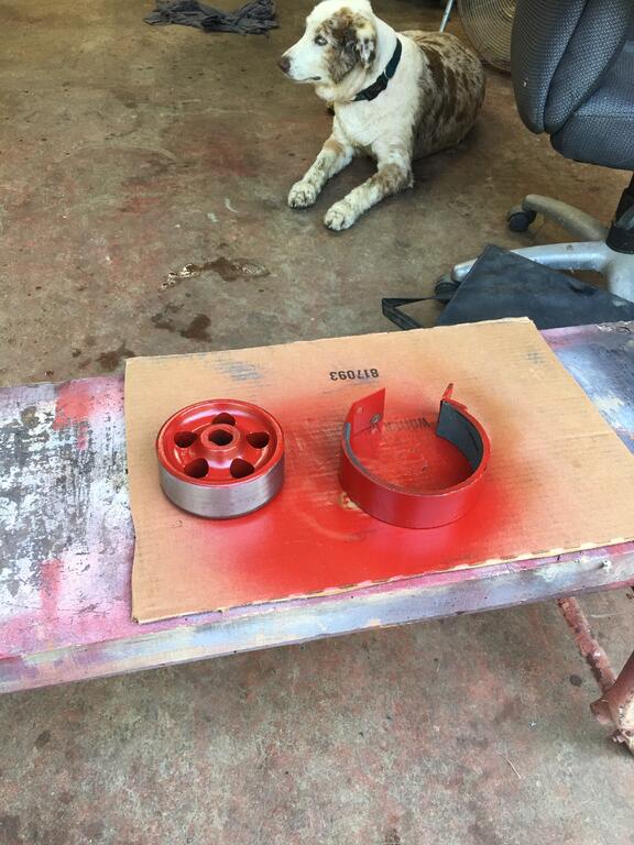

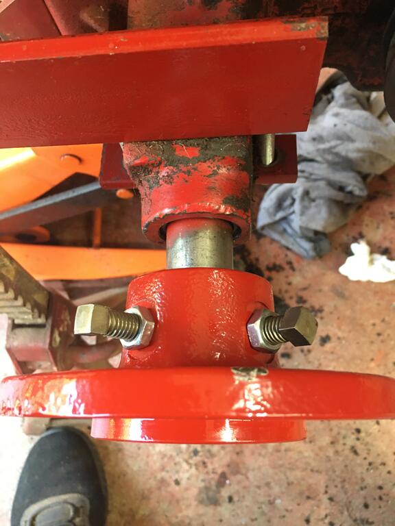

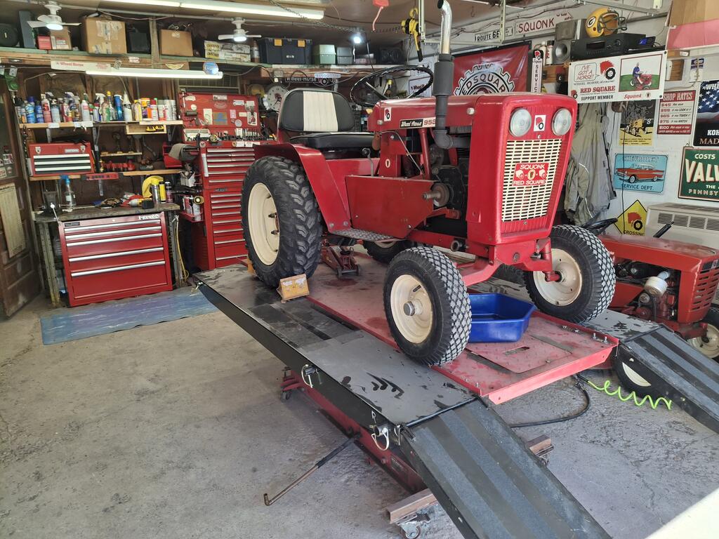

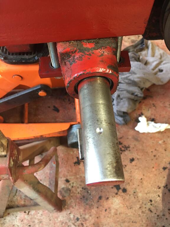

sqrlgtr 4,084 #26735 Posted September 21 Finally got a chance to put C160 back together today. New brake lining, and painted brake drum and band. Got my new to me late model 1 1/8” two set screw hubs installed thx to @76c12091520h and @richmondred01 for da hubs and @rmaynard for brake lining. Made a drill guide so I could spot drill a place for the 2nd set screw on axle and worked out great. I feel a little better with the xtra set screws since Im running loaded tires and wheel weights now . 1 5 Share this post Link to post Share on other sites
cleat 9,380 #26736 Posted September 21 5 minutes ago, sqrlgtr said: Finally got a chance to put C160 back together today. New brake lining, and painted brake drum and band. Got my new to me late model 1 1/8” two set screw hubs installed thx to @76c12091520h and @richmondred01 for da hubs and @rmaynard for brake lining. Made a drill guide so I could spot drill a place for the 2nd set screw on axle and worked out great. I feel a little better with the xtra set screws since Im running loaded tires and wheel weights now . A lot of industrial equipment has the shaft countersunk like that. Really helps hold things in a proper location. 3 Share this post Link to post Share on other sites
ebinmaine 80,893 #26737 Posted September 21 1 hour ago, sqrlgtr said: . I feel a little better with the xtra set screws since Im running loaded tires and wheel weights now . It definitely made a difference on my own 1974 C160-8 Cinnamon Horse. I run it VERY heavy ALL the time and on rough ground. Single set screws would loosen after a few weeks. 2 1 Share this post Link to post Share on other sites
sqrlgtr 4,084 #26738 Posted September 21 (edited) 1 hour ago, cleat said: A lot of industrial equipment has the shaft countersunk like that. Really helps hold things in a proper location. This is first set of hubs that I have ever had with 2 set screws besides the ones that came on the 2 520's I acquired a few months back. These hubs are a lot beefier than the older star type one set screw type, I figured the dimple would work better than trying to grind a flat on the axle. I got to thinking they needed a dimple or flat on axle for future disassembly. I will tell on myself though; I was so tickled with my hubs I forgot to put brake drum and band back on before driving around the barn . Funny as heck though when I went to stop and no brakes.. Edited September 21 by sqrlgtr 1 5 1 Share this post Link to post Share on other sites

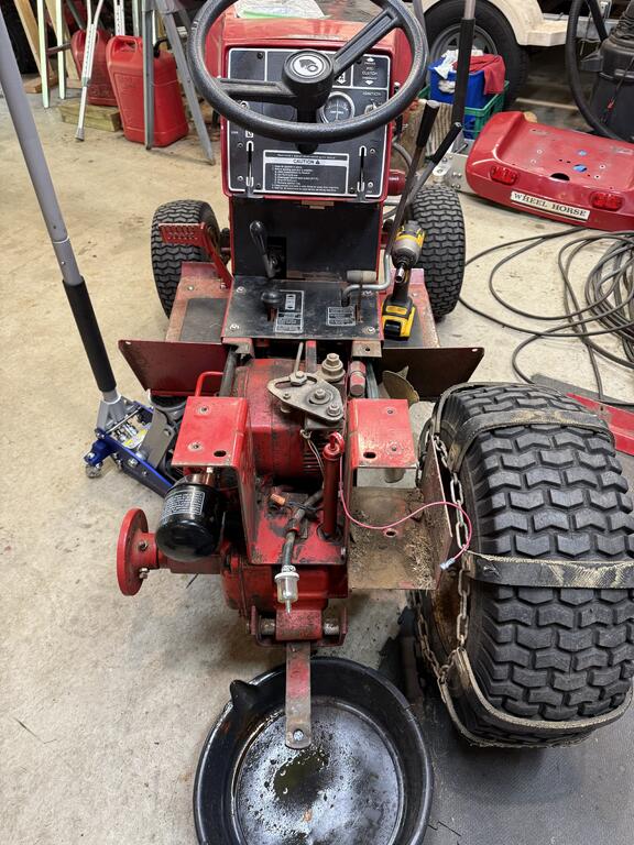

Wayne0 1,643 #26740 Posted September 22 (edited) Finally pulled the motor from Ole Rusty. Now in the process of swapping parts before re-installing the Craftsman transplant. Edited September 22 by Wayne0 1 Share this post Link to post Share on other sites

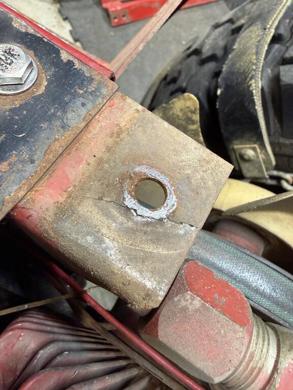

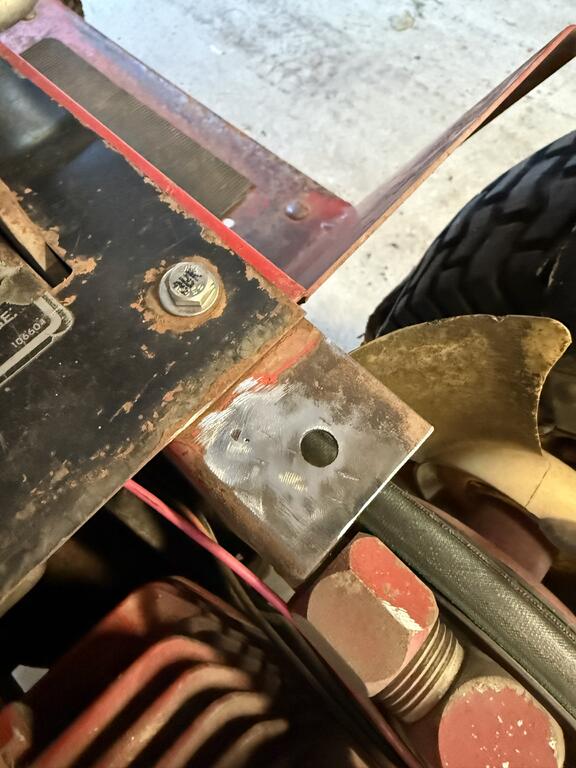

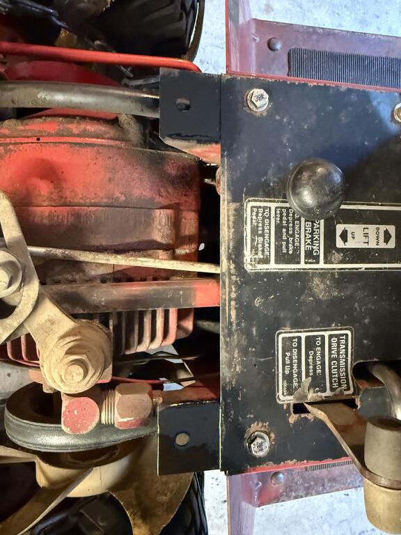

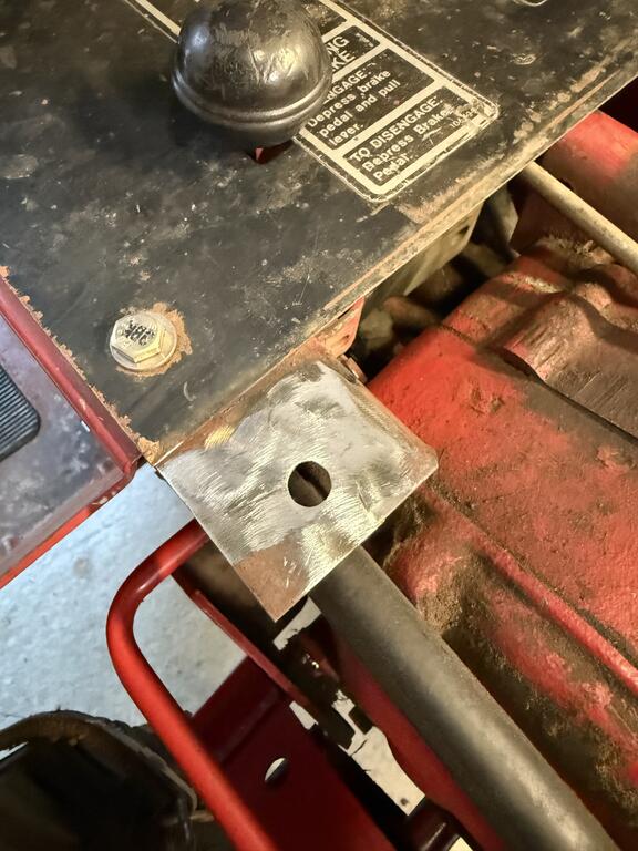

Sparky-(Admin) 26,489 #26742 Posted September 22 Had the frame/supports/rails welded on my C-145 Auto today. The plan is to use it this winter for snow plowing. While it’s apart I’ll power wash it and get the trans fluid and filter swapped out. Then install the frame to transmission supports that I bought from @ri702bill . Looking forward to having hydraulic lift this winter! 10 4 Share this post Link to post Share on other sites
cleat 9,380 #26743 Posted September 23 2 hours ago, Sparky said: Had the frame/supports/rails welded on my C-145 Auto today. The plan is to use it this winter for snow plowing. While it’s apart I’ll power wash it and get the trans fluid and filter swapped out. Then install the frame to transmission supports that I bought from @ri702bill . Looking forward to having hydraulic lift this winter! I don't know if I have ever got a machine that wasn't at least cracked here. If I was to say what the weak link is on these machines it is here. Fortunately it does not cause any great harm as the machines run along just fine like this but like Sparky, I just can't leave it and get them welded up. 6 1 Share this post Link to post Share on other sites
mrc 1,119 #26744 Posted September 23 not only welded but, reinforced is a good idea too. 1 Share this post Link to post Share on other sites
cleat 9,380 #26745 Posted September 23 5 hours ago, mrc said: not only welded but, reinforced is a good idea too. At the very least, installing a nice thick fender washer underneath when bolting the front fender bracket into place should help spread the load and possibly stop it from cracking again. 3 1 Share this post Link to post Share on other sites

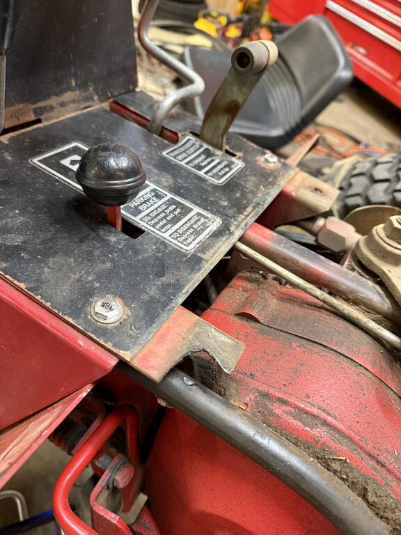

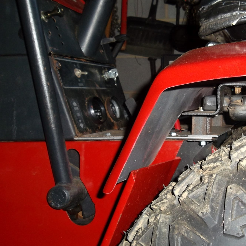

Lee1977 7,801 #26746 Posted September 23 It's a design problem, metal too thin. add a 1/8" x 1 1/2" flat on top all the way under the shifter plate. Then fender washers under the original cracked area. This one also got the fender raised 1 3/4". 2 4 Share this post Link to post Share on other sites

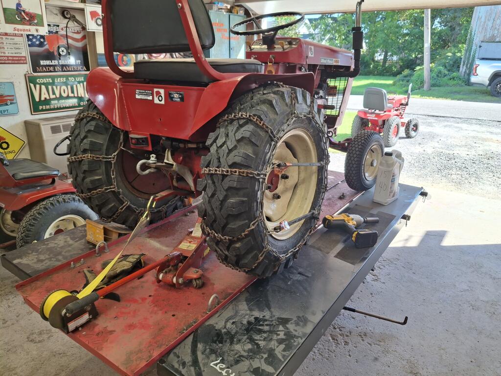

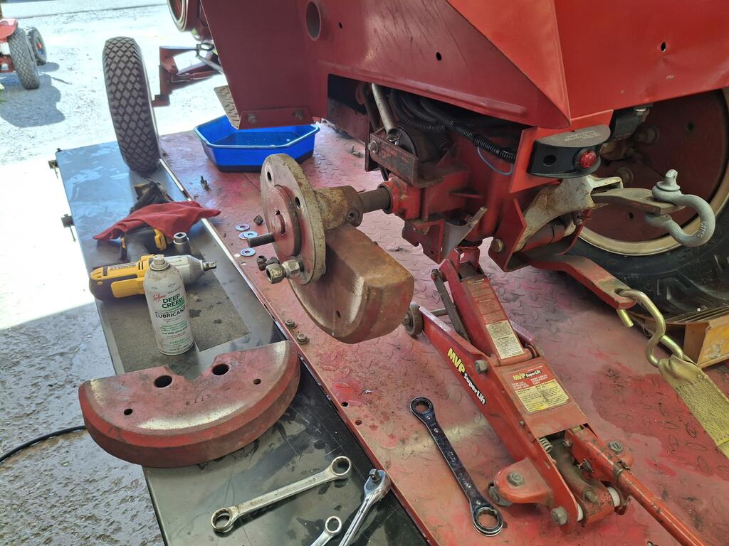

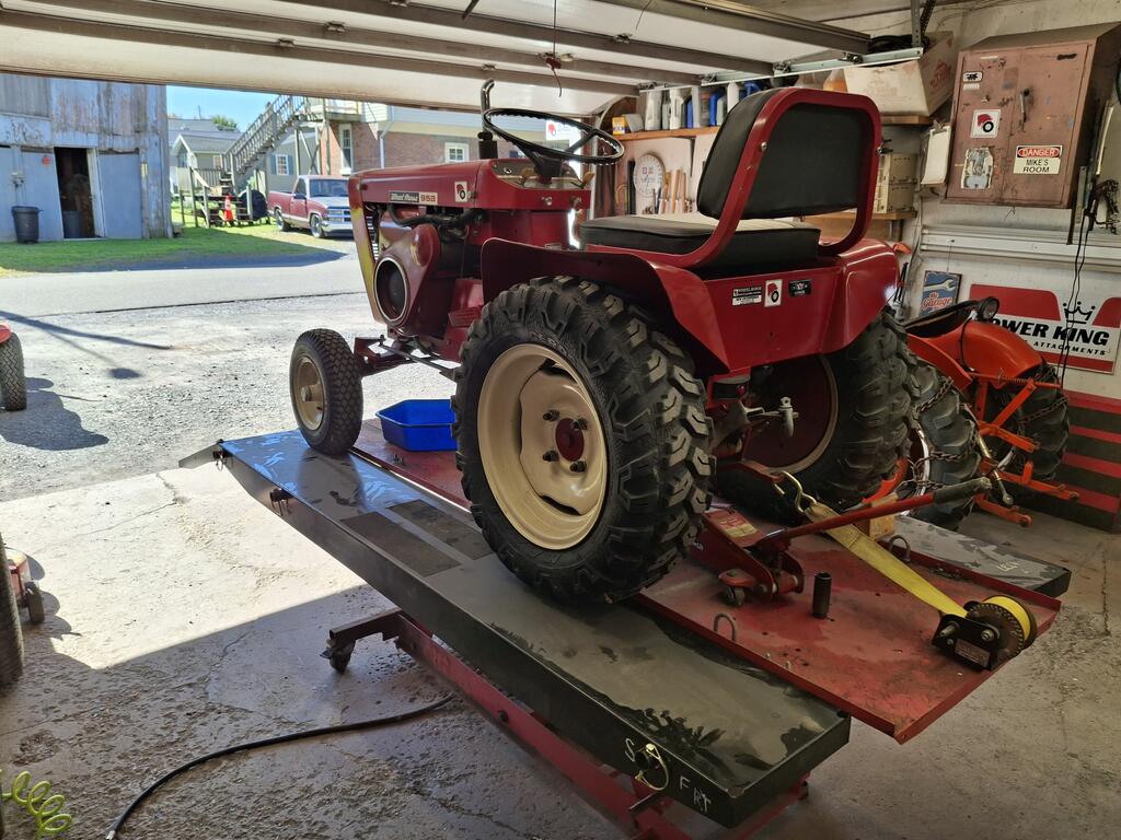

squonk 48,209 #26747 Posted September 24 Set screw theme. I have one hub on Big Oly that likes to walk so new screws. Have to take one pie weight off to do it. At the same time I changed the oil to Rotella 15/40 and installed the snows. Winter's coming! 2 6 Share this post Link to post Share on other sites

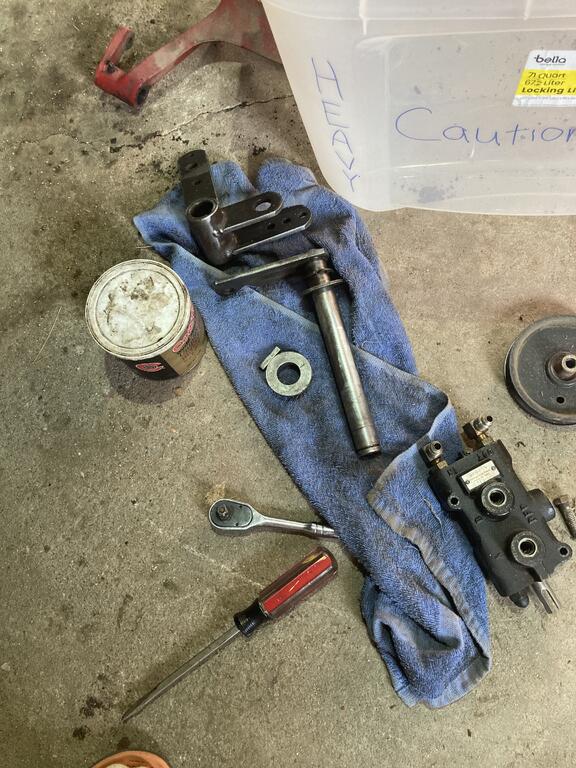

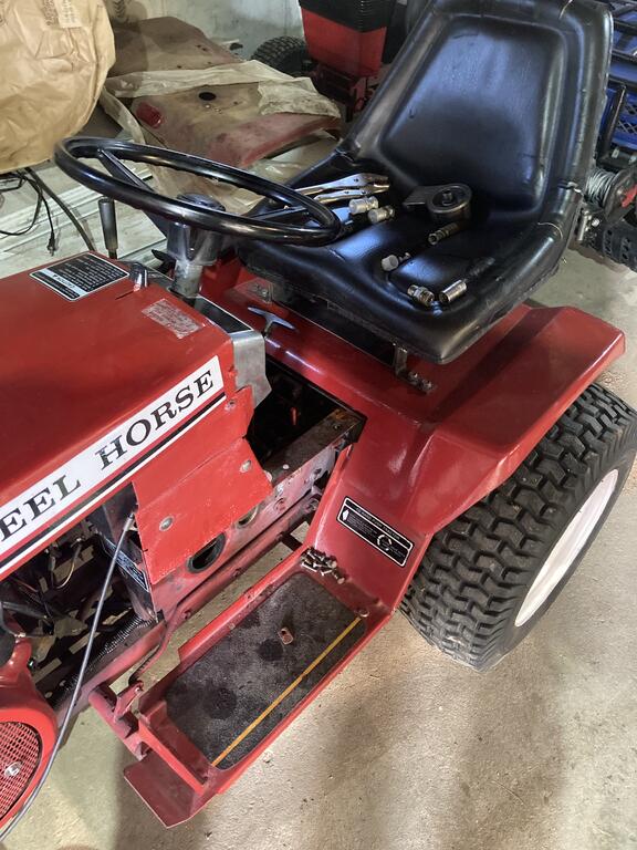

MainelyWheelhorse 3,145 #26748 Posted September 24 Today after work I started on figuring out how to retrofit and spruce up the 520H Hydraulic lift to my C-141 Auto. I've got the beginnings of a plan to build a bracket for the valve block. Once i take the seat off, and the rear sheet metal. I'll figure out if I need custom hard lines to the pump or can adapt the existing lines as they look in good condition. It looks close but I'll know for sure once I can see the pump better and run the lines. I'm off the next two days so I'll pick away at it. 1 5 Share this post Link to post Share on other sites
