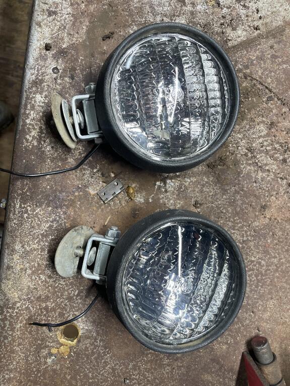

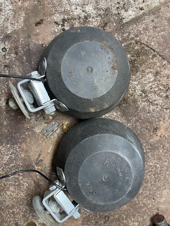

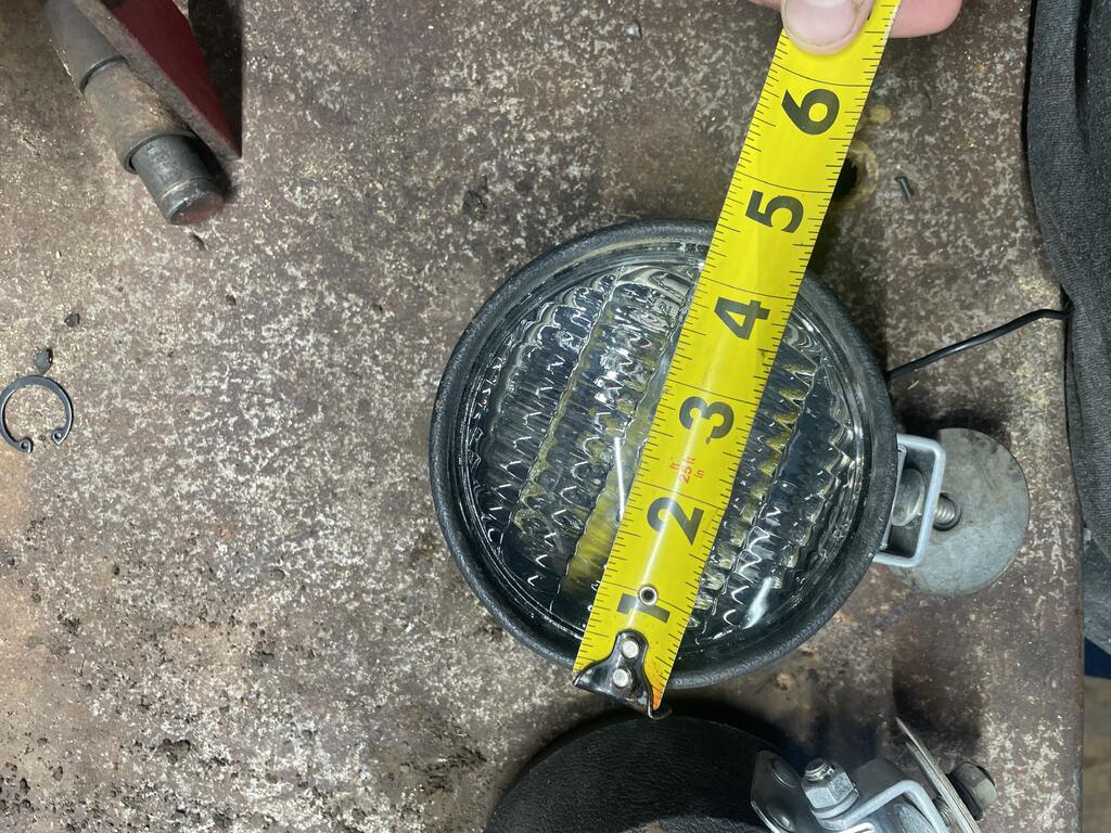

EthanL 69 #26453 Posted July 13 7 hours ago, ebinmaine said: Yes please. Pics and measurements. Check it out 1 1 Share this post Link to post Share on other sites
ebinmaine 80,600 #26454 Posted July 13 7 minutes ago, EthanL said: Check it out Thanks for posting this. What are the housings made of? Share this post Link to post Share on other sites

EthanL 69 #26456 Posted July 14 25 minutes ago, ebinmaine said: Thanks for posting this. What are the housings made of? Hard plastic housing, lens are glass Share this post Link to post Share on other sites

squonk 48,067 #26460 Posted July 17 (edited) On 7/13/2026 at 7:57 PM, ebinmaine said: Thanks for posting this. What are the housings made of? Those look like regular garden variety rubber work lamp size Edited July 17 by squonk 1 Share this post Link to post Share on other sites

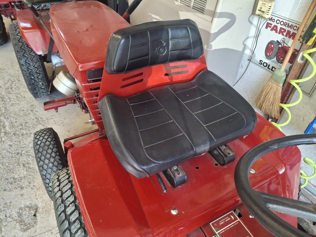

squonk 48,067 #26461 Posted July 17 Final stage of the Big Show seat resto. 3 13 Share this post Link to post Share on other sites
Fj40z 239 #26462 Posted July 17 1 hour ago, squonk said: Final stage of the Big Show seat resto. I keep resisting the urge to replace the Toro zero turn seat on my C160 because it’s so comfortable it every time a see an original one like this I absolutely love it! Looks fantastic! 1 Share this post Link to post Share on other sites

squonk 48,067 #26464 Posted July 17 8 minutes ago, Fj40z said: I keep resisting the urge to replace the Toro zero turn seat on my C160 because it’s so comfortable it every time a see an original one like this I absolutely love it! Looks fantastic! In all reality, the seat I took off is more comfortable. But it's getting torn up. I've had it over 20 years. 1 Share this post Link to post Share on other sites

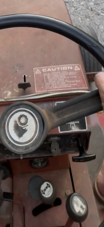

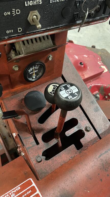

Fj40z 239 #26467 Posted July 17 Found a NOS shifter decal on eBay to replace my old one. Most of it was worn off. Didn’t bother me much since I had learned the gear pattern but if the wife or kids use it they’ll be able to quickly see it. 1 Share this post Link to post Share on other sites
ebinmaine 80,600 #26468 Posted July 17 12 minutes ago, Fj40z said: shifter decal If ya ever want new ones @Vinylguy sells em. 3 Share this post Link to post Share on other sites

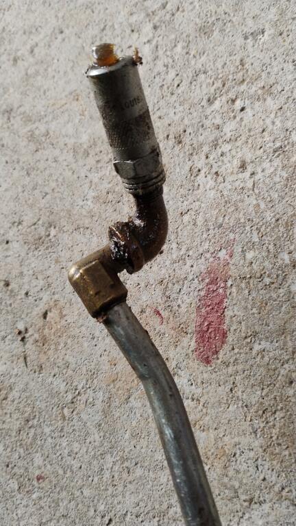

Ed Kennell 47,255 #26469 Posted July 17 1 hour ago, 8ntruck said: I replaced the solid pipe on my grease gun nozzle today with a hos I use two 1/8" street ells as a universal joint on mine. I can get on some pretty tight zerks and still have a rigid pipe that helps to push it on the zerk. 6 Share this post Link to post Share on other sites

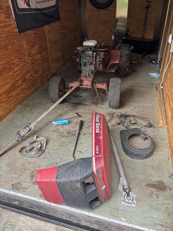

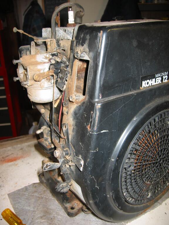

Chris689 323 #26471 Posted July 18 (edited) Picked up the remnants of this 310-8 today. At some point in its life it was repowered with a 12HP kohler that is currently stuck. Transmission is free though which is great. Not sure what direction I’m going to go in with it since the engine is stuck and it’s missing a bunch of stuff like wheels and tires, carb, fuel tank… the important stuff. A part of me kinda wants to piece it back together. We’ll see what’s happens. Edited July 18 by Chris689 3 1 Share this post Link to post Share on other sites

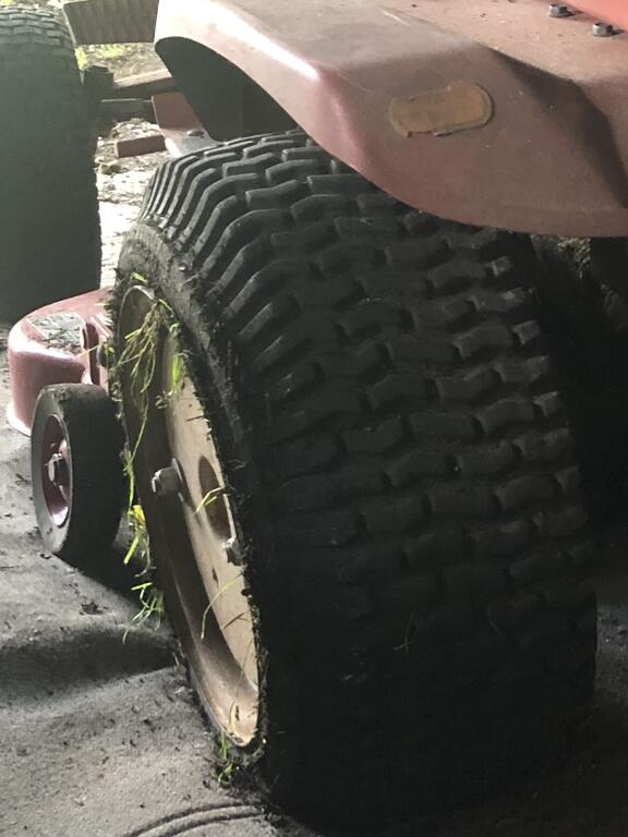

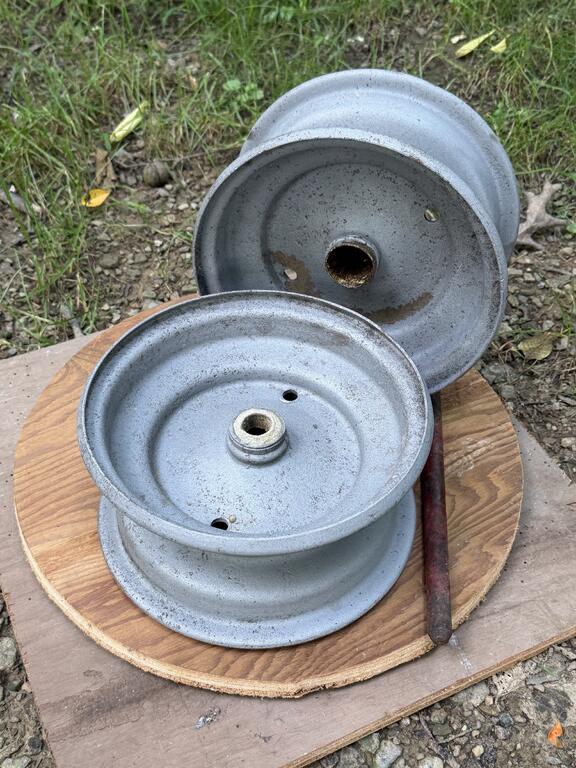

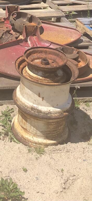

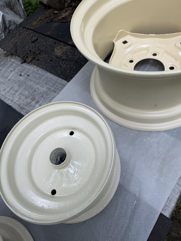

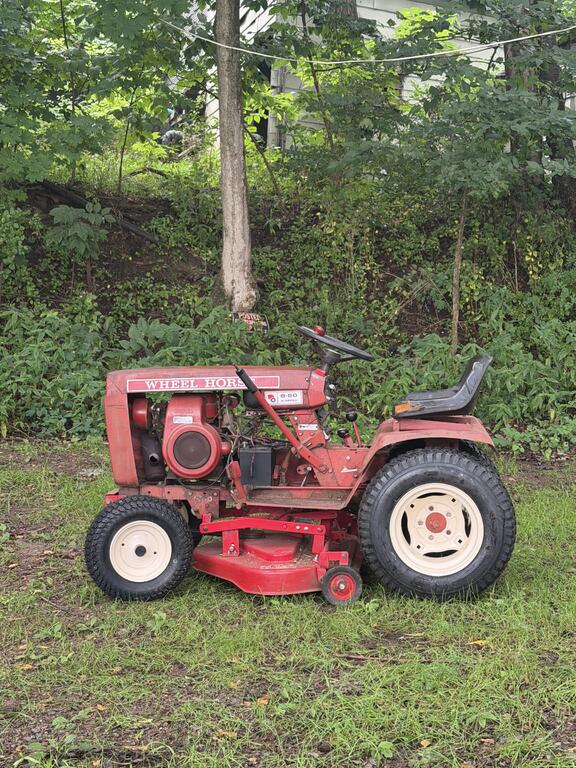

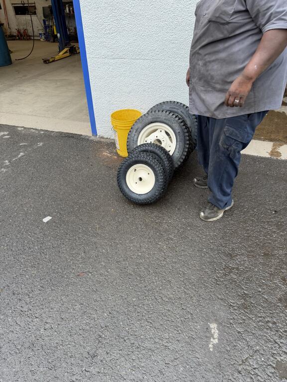

EB-80/8inPA 2,116 #26472 Posted July 18 (edited) I got the B-80 reshorn after taking the wheels, tubes & tires to my friendly local tire shop. I just wasn’t in the mood for doing that. He got them to seal up without the tubes. The blowout: Spare set waiting for the Sandman Scrubbed & ready to paint, more or less. Third coat left, fourth on right (Krylon Ivory) Just like new! (Sort of) Another triumph! I’m almost inspired to give her a lick of Penetrol and do something about that seat. Oh, and paint and remount the weights. Edited July 18 by EB-80/8inPA 4 9 Share this post Link to post Share on other sites

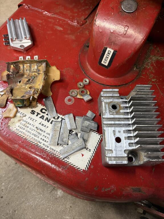

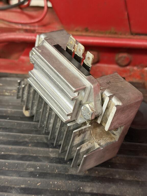

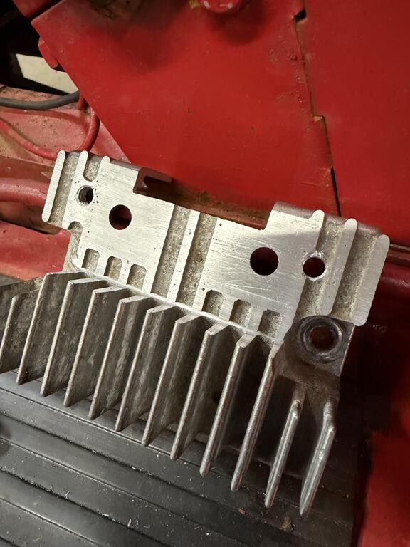

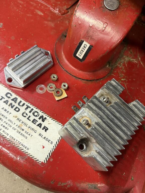

Blaine 275 #26473 Posted July 18 I ordered a $10 regulator from EBay for the Raider. The mounting holes are too narrow to use the existing holes in the tower and i wanted to use the original holes and carriage bolts. The terminals on the new one stick out the back also, so it can’t be mounted flush. The band saw made quick work of making an adapter mount out of the old regulator. 4 11 Share this post Link to post Share on other sites

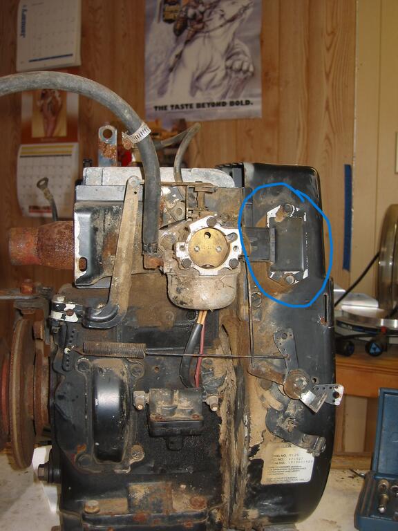

pfrederi 21,145 #26474 Posted July 19 (edited) 14 hours ago, Blaine said: I ordered a $10 regulator from EBay for the Raider. The mounting holes are too narrow to use the existing holes in the tower and i wanted to use the original holes and carriage bolts. The terminals on the new one stick out the back also, so it can’t be mounted flush. The band saw made quick work of making an adapter mount out of the old regulator. The new regulator you bought was designed to be mounted in the air shroud of KT and magnums fins facing in. It is cooled by all the engine cooling air blowing by it. Yo may not have enough air flow in the raider location and it may over heat. Edited July 19 by pfrederi 5 1 Share this post Link to post Share on other sites
Blaine 275 #26475 Posted July 19 (edited) 4 hours ago, pfrederi said: The new regulator you bought was designed to be mounted in the air shroud of KT and magnums fins facing in. It is cooled by all the engine cooling air blowing by it. Yo may not have enough air flow in the raider location and it may over heat. Thank you. I did not know that’s what they were made for. If it doesn’t survive that’s where the next one will go. Edited July 19 by Blaine 4 Share this post Link to post Share on other sites
