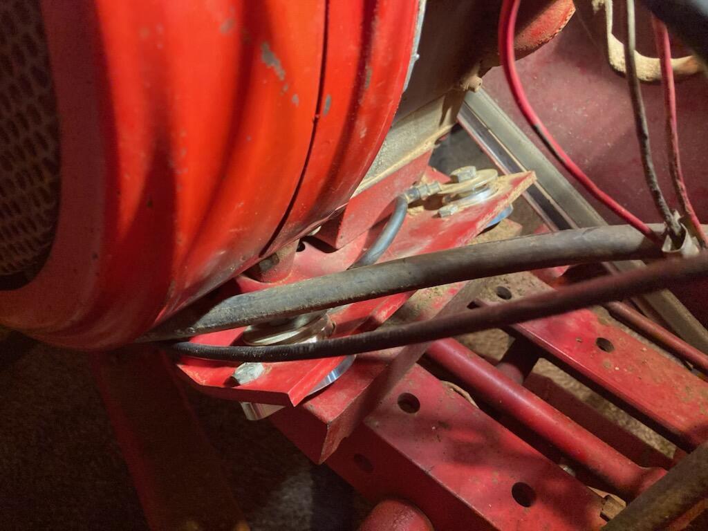

MainelyWheelhorse 3,208 #26426 Posted July 11 A hour working on a Cricuit and one more step done. 7 1 Share this post Link to post Share on other sites

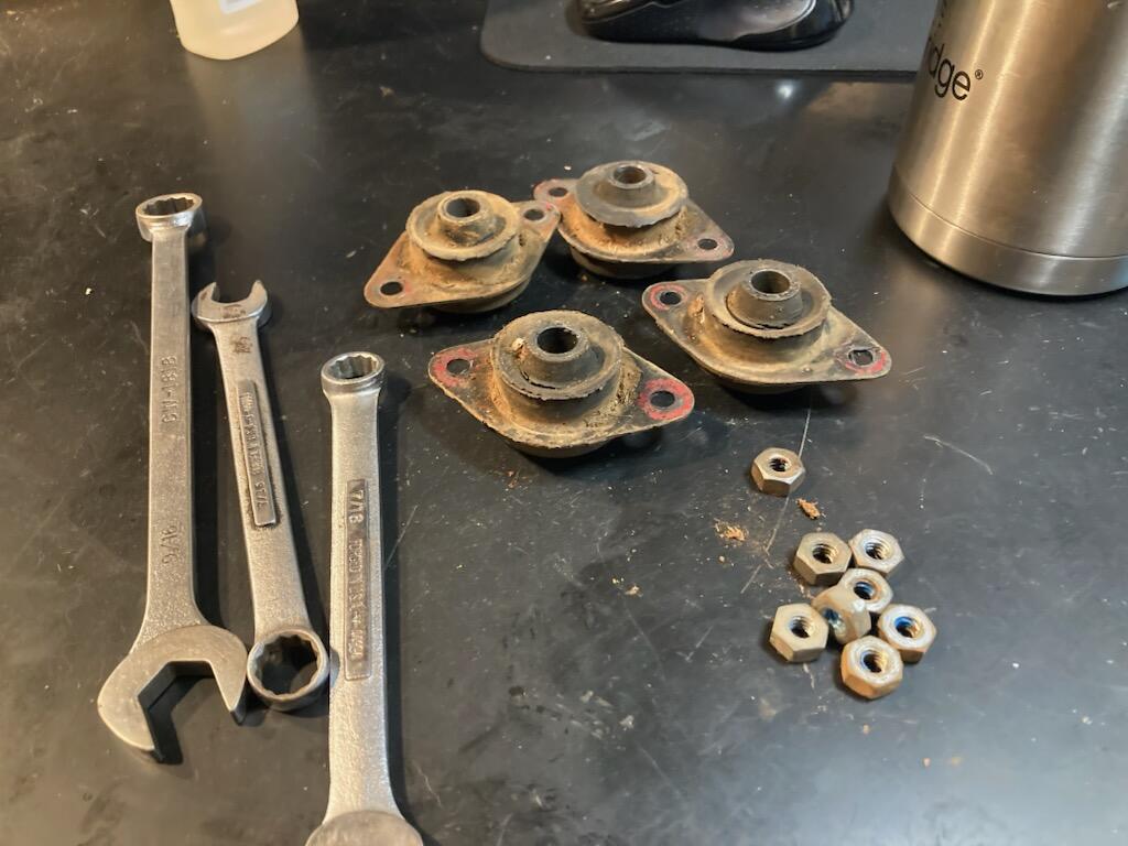

ineedanother 2,885 #26427 Posted July 11 Not wanting to do too much to this c-161 that is mostly original, I'm making an exception for solid shaker mounts. That last one seems to always be a challenge but I loosened one of the mounting blocks and was able to start that last bolt. This shored up the primary ground wire while I was at it so that's a plus. 8 4 Share this post Link to post Share on other sites
ebinmaine 81,281 #26428 Posted July 11 8 hours ago, ineedanother said: shored up the primary ground wire Good add. Ground is paramount to proper DC circuits. I do realize you want to keep originality. Adding wires to create a full ground loop from engine block to frame to steering tower will save many future headaches. 4 Share this post Link to post Share on other sites

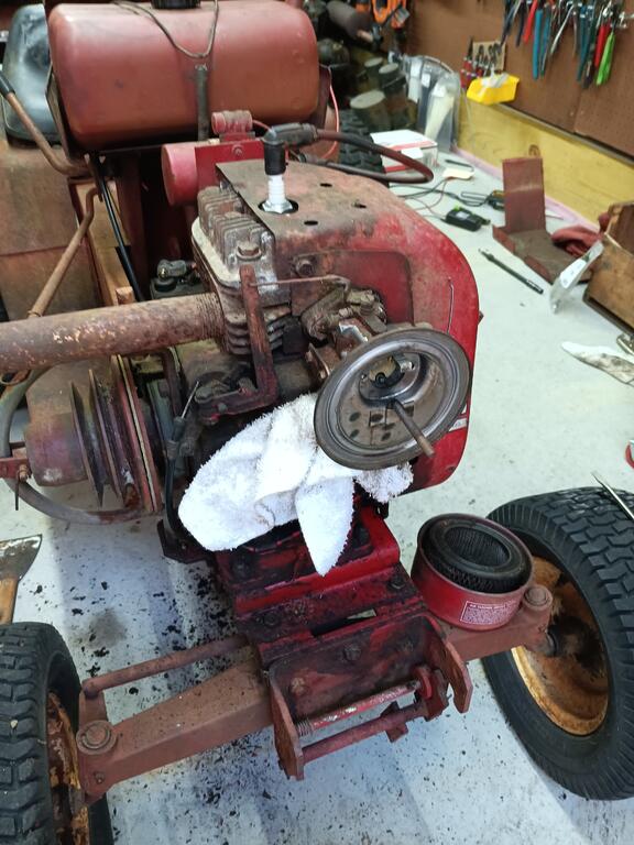

ineedanother 2,885 #26429 Posted July 11 This is a lot of work without a machine shop but I really needed to get these made before I install the ARK on the 161 (the old one on the bench is from the junk pile!). 4 7 Share this post Link to post Share on other sites
Lee1977 7,813 #26430 Posted July 12 (edited) 1 hour ago, ineedanother said: This is a lot of work without a machine shop but I really needed to get these made before I install the ARK on the 161 (the old one on the bench is from the junk pile!). Those will stay with you, I have one set that I built in 1989 and they are still tight, don't see any ware. Edited July 12 by Lee1977 2 5 Share this post Link to post Share on other sites

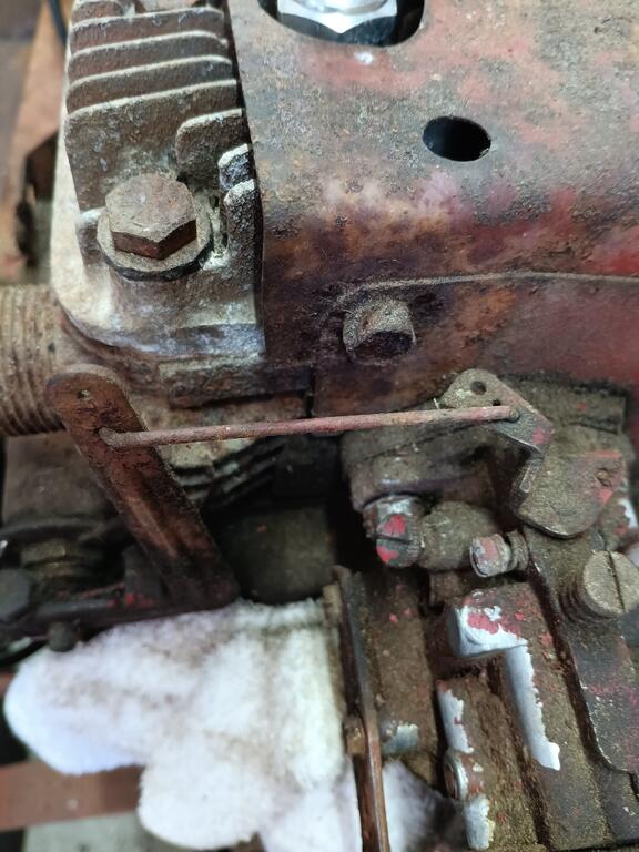

Thegearhead0324 1,902 #26435 Posted July 12 (edited) This morning I did disassembly and cleaned up everything for the new brake lining from @rmaynard and I took my old seal out to realize it’s wrong so I ordered the correct one (hopefully). I should’ve looked at the manual I have for part number from the beginning 🤦🏻♂️. So it’ll be a while. I just want a good brake and not roll to a stop. I did what the instructions said to do tho for the brake band lining, I waited 48 hrs to take the clamps off then I cleaned the excess adhesive off that was squeezed around the sides. Edited July 15 by Thegearhead0324 3 6 Share this post Link to post Share on other sites

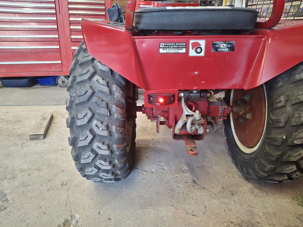

squonk 48,427 #26439 Posted July 12 For some reason the LED tail light on my 953 didn't survive the trip to the Big Show. Stopped at Horror Fright and picked up this groovy tail light for cheap. Even had a piece of steel the right color! 10 2 Share this post Link to post Share on other sites

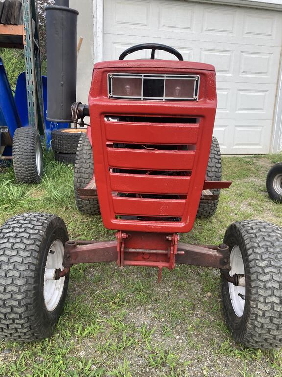

Desko 687 #26440 Posted July 12 Got some pictures of the 314 from the other day. It didn’t clean up bad and should make a good mower for my brother. Already gathered some parts like a new choke, throttle cable, clutch return spring and I did manage to score an entire wiring harness for cheap so it’ll save me from having to rewire everything that was cut out of this harness that I’ve found out to be taken and put on the 520. Still need to get a new seat and some tires for it but that’ll probably wait until it’s up and running on its own. 5 1 Share this post Link to post Share on other sites

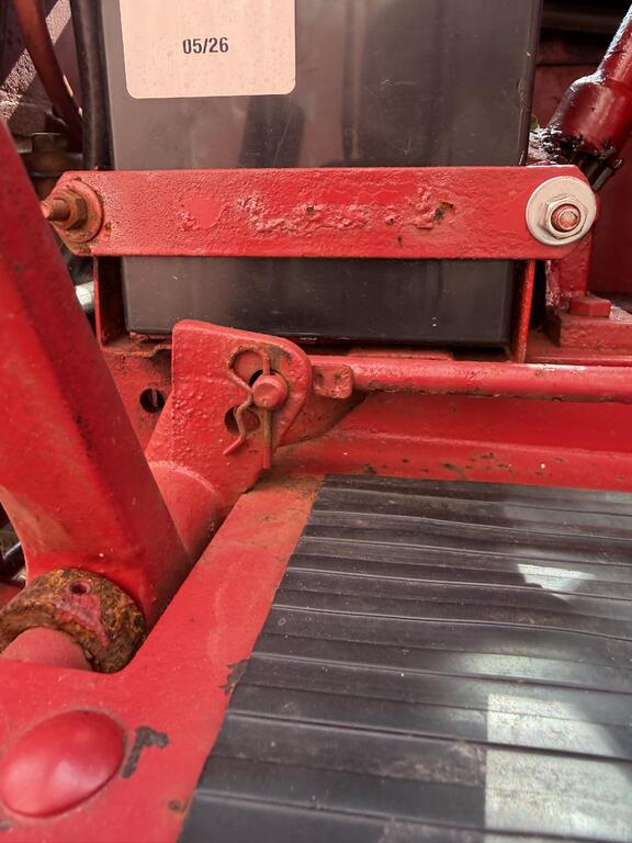

Blaine 276 #26441 Posted July 12 I moved the clutch/brake rod to other hole at the pedal on Whitey today. Removed a bit of the pedal to make some clearance at the foot board to allow the pedal to stand straight up in the rest position for added travel. i found that the rod was already rubbing on the running board at the other end because either it has too long of a drive belt, or it’s just stretched and worn. The rod is almost touching the boss of the lever, allowing the rod to come down and make contact with the rear of the foot board. Had to use the fire wrench to get the rod adjustment to turn freely again. A little adjustment of the clutch rod and brake rod and swapped to the lower hole, i have clean clutching and brakes that will hold backwards on the hill, so i’m happy with that. Unable to engage the parking brake, but i’ve never had one anyway, so no big thing. I’ll worry about that after a new drive belt. Kept getting a whiff of fuel while i was working on it today. Found a drip hanging at the fuel tank line. After 20 minutes screwing around with the clamp, brake clean and a blow gun, and still seeing fuel leaking, i pulled the tank. A pin hole crack at the seam of the plastic tank about 1/4” away from the nipple. I scavenged through my stash and the largest tank i could find was a stupid little predator tank, so it’ll do until i locate another. Just need to remember to fill it every time before mowing. The fuel pump doesn’t seem to work very well as an “air” pump. 5 1 Share this post Link to post Share on other sites

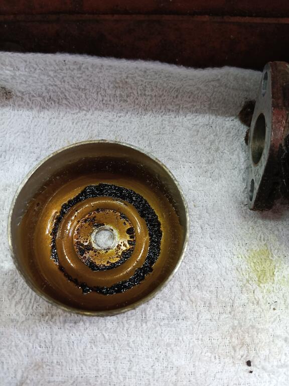

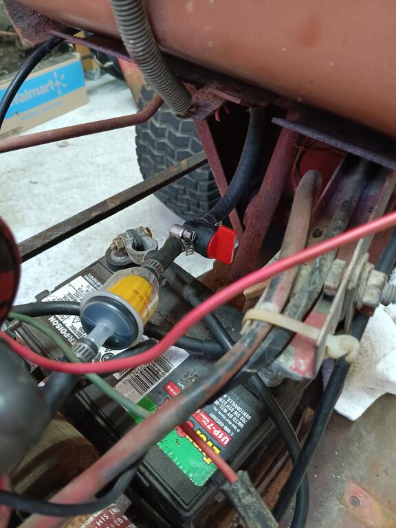

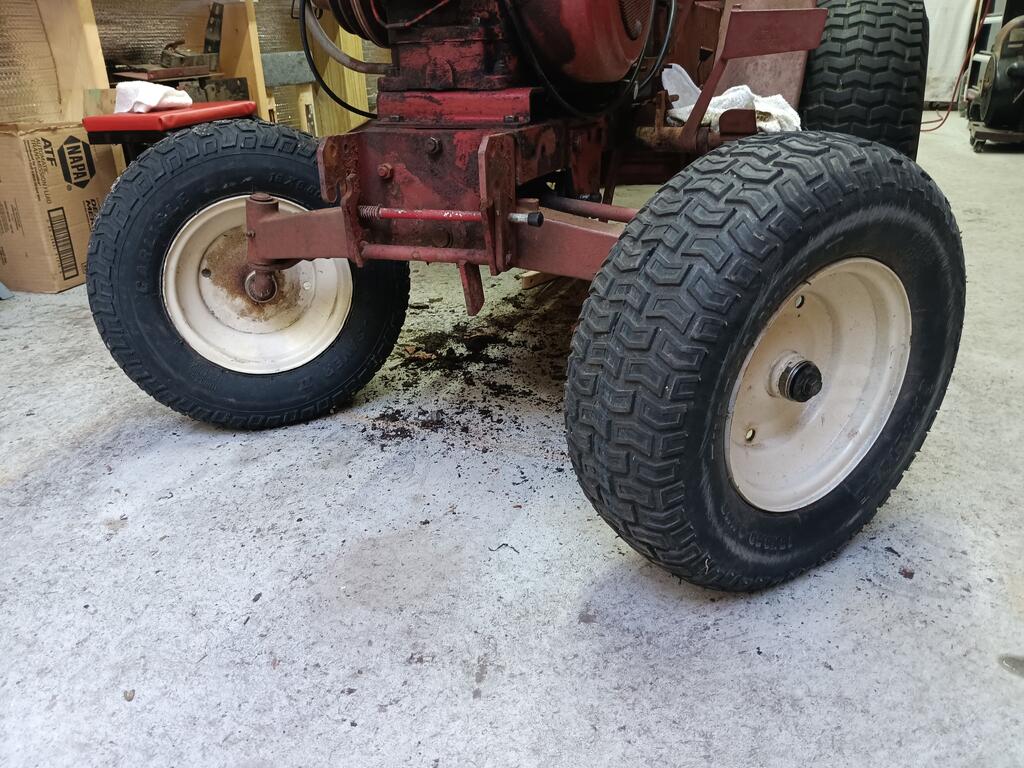

ebinmaine 81,281 #26447 Posted July 13 The BBT aka Trina and I have been helping @Natejc_98 with his 1973 8 HP 4 speed. Nate's been diving right in with great effort. Really good guy. Here's a few before n after pics of the carb & air cleaner. All cleaned up with a new Briggs fuel bowl installed. We also did a partial disassembly and general cleanup. Changed the drive belt and idler pulley out for better used ones. Swapped the 10" rear wheels for more standard larger wheels & tires. Swapped the destroyed front tires for nicer turfs. Did some investigating on a no electricity to the solenoid issue. Turns out both safety switches were bad. Fixed that and found an intermittent ignition switch connection. Installed new switch from @76c12091520h Brian Badman. Replaced all fuel line and added a turn off and fuel filter. Engine oil change done. Transmission oil change on the list. Trina and I have amassed a fair amount of extra parts over the years. It's great to see them being used. I need to finish the wiring and see about getting the transmission drain plug out. 16 Share this post Link to post Share on other sites

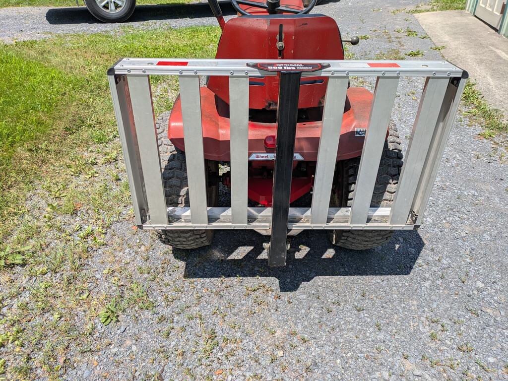

rjg854 13,454 #26450 Posted July 13 Put the hitch on that I got at the Big Show from K&B. 4 8 Share this post Link to post Share on other sites
