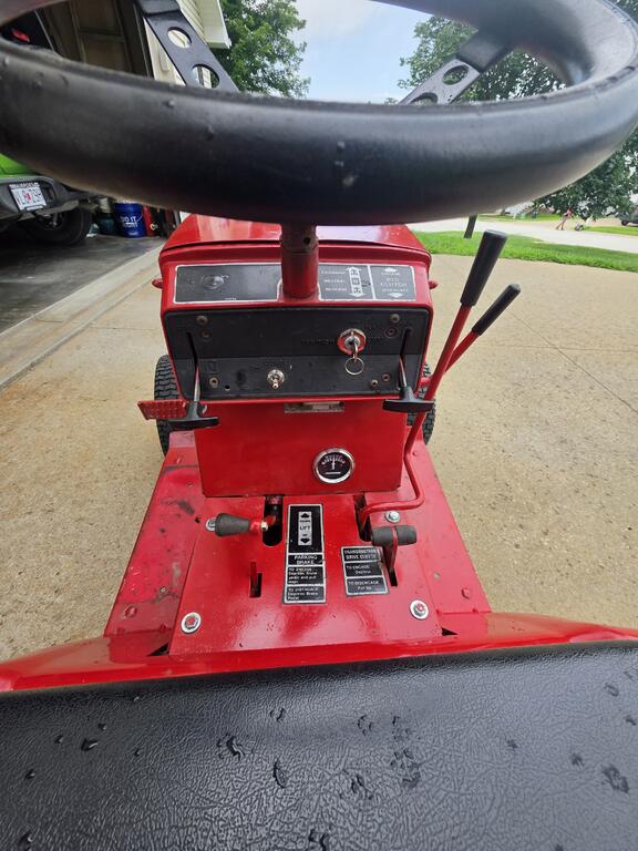

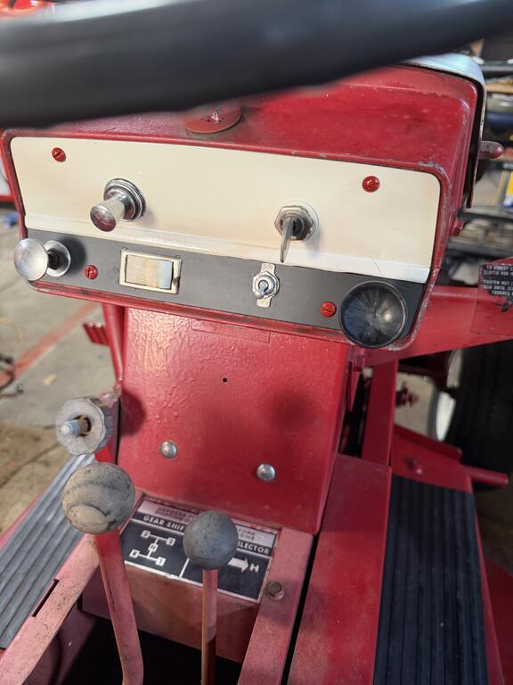

Goldnboy 1,156 #26351 Posted July 2 Took out the annoying Push button start button and push/pull kill switch..and added all new wires, switches and black plug to fill the huge hole in dash. 8 1 Share this post Link to post Share on other sites

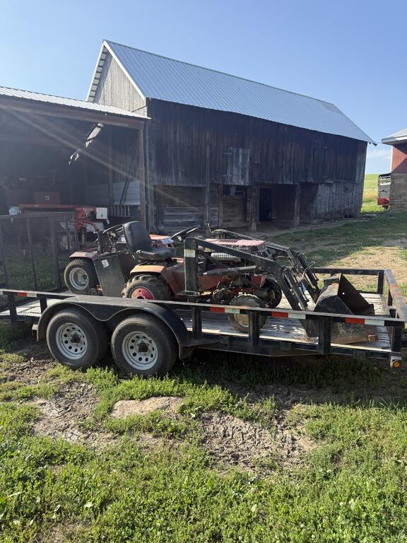

Desko 687 #26357 Posted July 2 Dug these old girls out of the weeds today for a couple hundred bucks. To my surprise the 520 actually started with some make shift gas line but the 314-8 which reads to be an 02 model is in tough shape with everything seized and locked up sadly it only has 200 hours on it with a like new 42” deck. 7 9 Share this post Link to post Share on other sites

mrc 1,122 #26359 Posted July 3 desko, a couple hundred bucks for 2 tractors and a loader? SUPER SCORE!!! 3 Share this post Link to post Share on other sites
Bill D 3,194 #26360 Posted July 3 5 hours ago, Desko said: Dug these old girls out of the weeds today for a couple hundred bucks. To my surprise the 520 actually started with some make shift gas line but the 314-8 which reads to be an 02 model is in tough shape with everything seized and locked up sadly it only has 200 hours on it with a like new 42” deck. Wow, just wow!! 2 Share this post Link to post Share on other sites

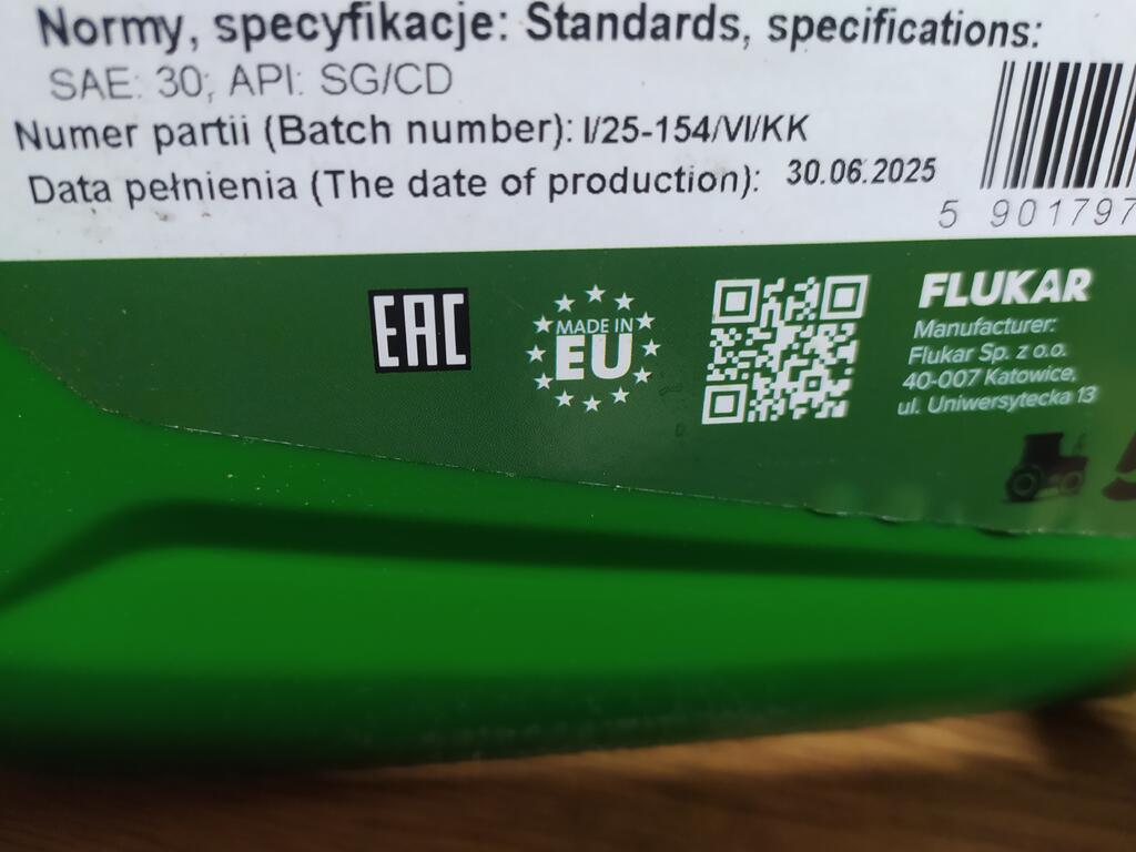

Stan50 245 #26364 Posted July 3 I changed engine oil after ~ 20 hours, I put mineral oil,Sae 30 which I found on local website, according to specs am good to go.. 1 Share this post Link to post Share on other sites

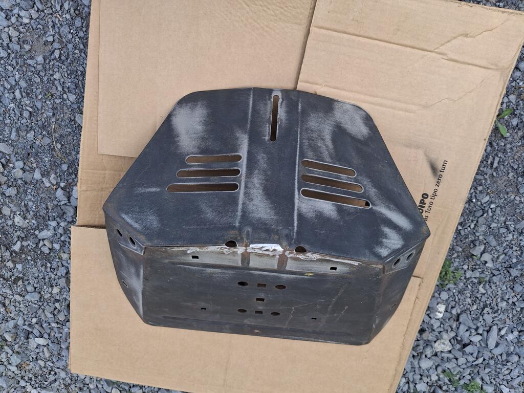

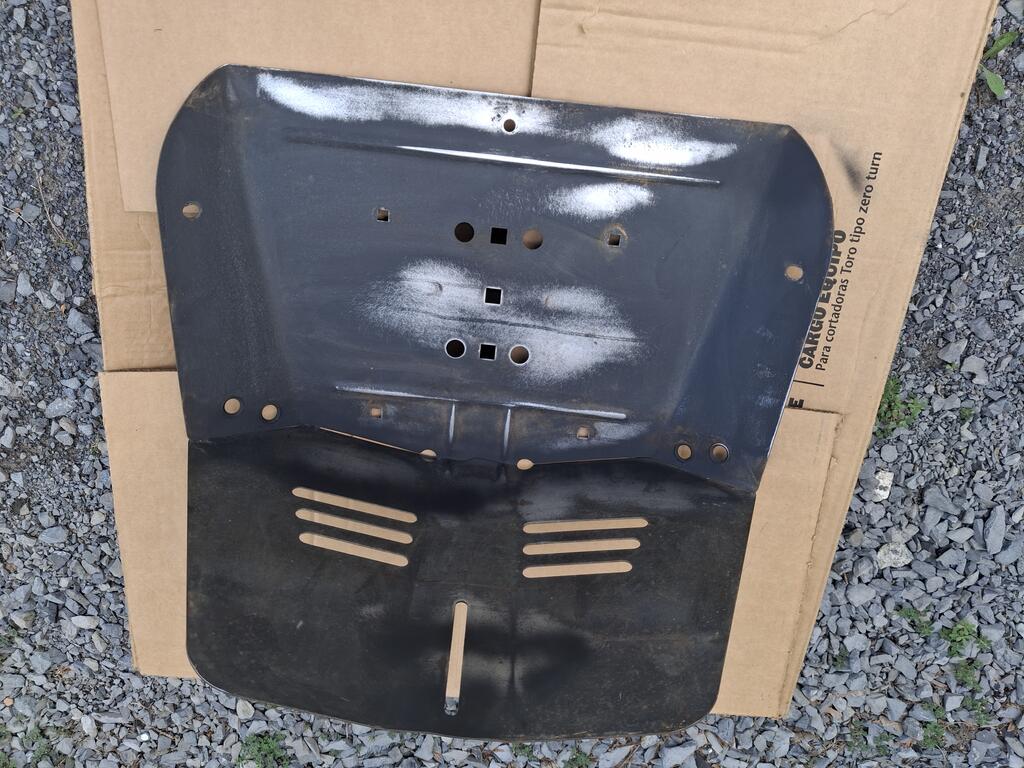

squonk 48,354 #26365 Posted July 3 Started phase 1 of a 2 piece seat revival in the shade! 7 5 Share this post Link to post Share on other sites

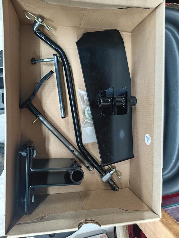

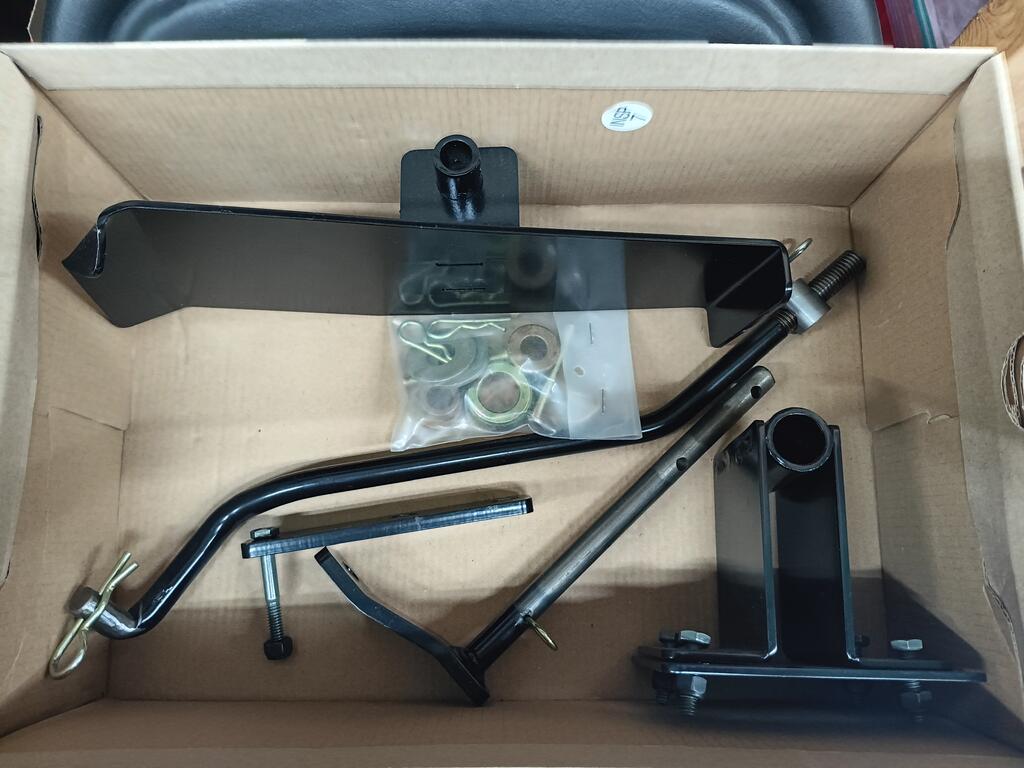

ebinmaine 81,183 #26366 Posted July 3 On 7/2/2026 at 9:12 AM, Bill D said: Any pictures of that pedal kit? 1 Share this post Link to post Share on other sites
Handy Don 17,689 #26367 Posted July 3 3 hours ago, ebinmaine said: I have two of the same kit awaiting installation! They are careful copies (in black powder-coat) of the original WH option using a rocker-style, heel-toe pedal. 2 Share this post Link to post Share on other sites
ebinmaine 81,183 #26368 Posted July 3 1 hour ago, Handy Don said: I have two of the same kit awaiting installation! They are careful copies (in black powder-coat) of the original WH option using a rocker-style, heel-toe pedal. I have two possibilities for this kit. Both are predominantly snow movers. In fact they're almost never used for anything else. The foot control would be nice. Share this post Link to post Share on other sites
Bill D 3,194 #26369 Posted July 4 On 7/2/2026 at 7:10 PM, Desko said: Dug these old girls out of the weeds today for a couple hundred bucks. To my surprise the 520 actually started with some make shift gas line but the 314-8 which reads to be an 02 model is in tough shape with everything seized and locked up sadly it only has 200 hours on it with a like new 42” deck. I'd love to see more pictures of those when you've got them cleaned up. 1 Share this post Link to post Share on other sites
Desko 687 #26370 Posted July 4 50 minutes ago, Bill D said: I'd love to see more pictures of those when you've got them cleaned up. I did get them pressure washed today and the 520 didn’t come out bad, it’s more pink than red but I think with some was it might get some color back but otherwise it’s in nice shape for the most part. It runs good but might need a carb cleaning in the near future as it has a surge down low but cleans up at wide open. It’s missing some pieces I’ll have to track down but right now I have the rear end draining of all the water/oil and the fuel tank out and trying to clean all the sludge out while I wait for the new Dorman universal fuel sender and grommet/shut off valve. The 314-8 came out okay everything is pretty much seized though from the steering to the clutch and brake pedals. The fuse box had been cut off the harness for some reason and some other bits but nothing that can’t be fixed in due time as it’s gonna need a lot already. The engine shows promise though it does turn over fine and has compression which is the biggest thing that’ll determine fixing it up as I intend to gift it to my brother when it’s finished. So it’s getting soaked down with whatever penetrating oil I have handy haha. Will try to get some pictures of them tomorrow though! 4 Share this post Link to post Share on other sites

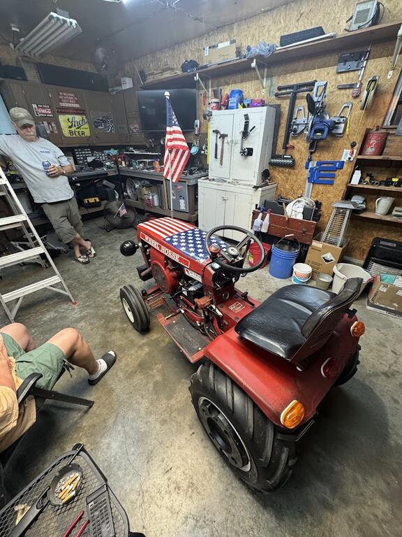

Bar Nuthin 3,545 #26371 Posted July 4 Me and the neighbor did some last-minute decorating for tomorrow's Freedom 250 parade. 2 7 Share this post Link to post Share on other sites
WHX?? 58,347 #26372 Posted July 4 28 minutes ago, Desko said: surge down low but cleans up at wide open. Lemme know what your cure is. I got one the same thing and cleaned it the proverbial @Ed Kennell three times with massive doses of sea foam and still not right. 2 Share this post Link to post Share on other sites

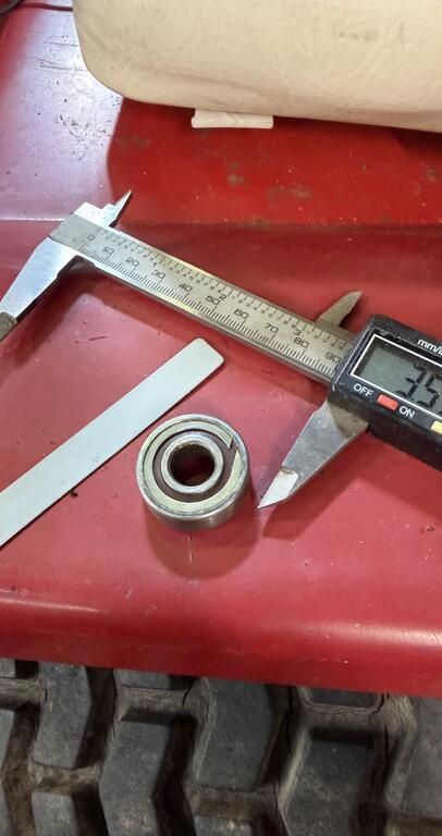

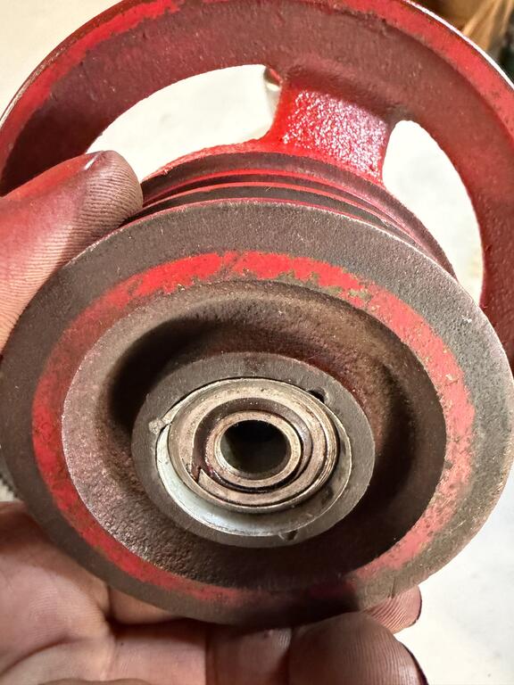

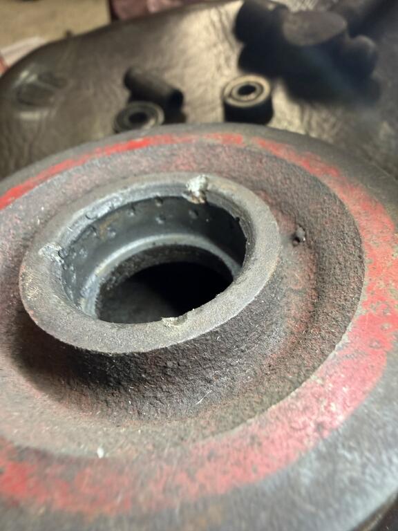

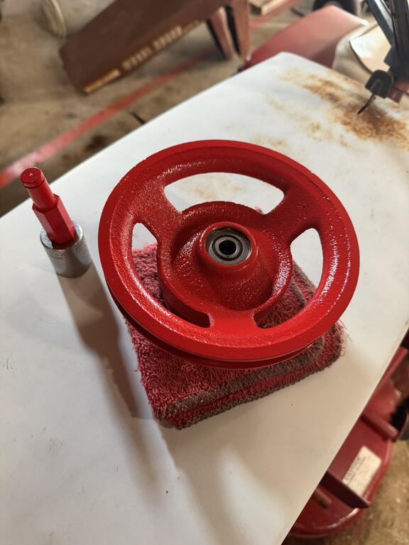

Blaine 276 #26373 Posted July 4 (edited) Did some final wiring and got the choke and throttle cables hooked up on the Raider, leftover items from the engine install and points conversion. Picked up an old regulator at the BS, but no charge, pretty sure it’s toast as the stator windings ohm’d ok. Any recommendations on an Ebay unit? I’ve seem them for like $25 from a quick search, but would like something with exact mounting hole spacing. USPS pleasantly surprised me by delivering my 6908 pulley today instead of Monday like it said on the tracking. I was a little saddened to discover the inner bearing bore was wallered out around .035” oversized. I guess i should have asked the seller questions. I didn’t notice the 3 stake marks around the bearing in the pictures. Oh well, not my first rodeo. After driving the bearing out past the stakes, i could see more stake marks around the circumference of the bore, as well as a ridge because the bore as a little deeper than the width of the bearing. After carefully removing just the ridge with a die grinder i was able to get an accurate measurement of .036” over the 1.125” bearing O.D. I found a piece of sheet metal .019” thick (probably .5mm) and cut a strip as wide as the bore depth and 3.550” long and beveled an edge. Rolled the strip over the bearing to give it its shape, beveled edge in. Placed the the shim in the bore and drove the bearing in with socket that only touched the outer race. I think i have a 2-3 thou press fit. Bearing had removable snap rings holding the seals in, so it got cleaned and fresh grease before i drove it home. I think it’ll make for a nice permanent repair. The outer bore was worn slightly also, but not enough to shim. I have a roll of .002” shim stock, but i couldn’t even measure.001” difference, but the bearing would easily push in and out of the bore with my fingers. So i cleaned everything well and installed the bearing with some Loctite 660. Some kind of logic tells me that i’d have thought the larger engine pulley side would have failed like this before the inner bore, being that the larger engine pulley hangs out way past the bearing. But whatever, it’s fixed. The cables on kRusty the donor Raider are completely rusted, and the cables on Whitey were backwards. The choke cable was a locking cable, even though the knob has a “C” on it, and the aftermarket throttle cable had no lock, so I swapped them. I cleaned up the dash while swapping the cables and tidying up the wiring. The surface of the dash plate was a solid rust except for most of the black lower portion. Removed the rust and did 2 coats of Dover White and flat black for the lower part. I should have color matched the screws instead of painting them all red, but it came out ok. I might have to match them because it bugs me now. 😕 After the dash was together and cables run, i fired it up, verified the charging system not charging, took it for a hot lap. No governor either, so i’ll need to figure out how to do the adjustment. Hoping nothing is broken or missing. Edited July 4 by Blaine 3 4 Share this post Link to post Share on other sites
sqrlgtr 4,192 #26374 Posted July 4 (edited) 6 hours ago, Desko said: it has a surge down low but cleans up at wide open. Check for vacuum leak on 2 piece manifold where it goes together. Had the same problem with my 520H thought it was a dirty carb but manifold fell apart when I took carb off so I'm sure it was leaking and I just went ahead and done a decarb, adjusted valves and rebuilt carb why I had it took apart the far. it runs like a new one now. Almost forgot added an electric fuel pump also, very much recomend and your starter will thank you for it also. Fires up almost instantly now and the fuel pump I removed seemed very healthy but would take forever to crank if mochine set for any length of time. Edited July 4 by sqrlgtr 2 1 Share this post Link to post Share on other sites
squonk 48,354 #26375 Posted July 4 4 hours ago, Blaine said: . I should have color matched the screws instead of painting them all red, but it came out ok. I might have to match them because it bugs me now. 😕 Throw some stainless steel screws in there! 1 Share this post Link to post Share on other sites
