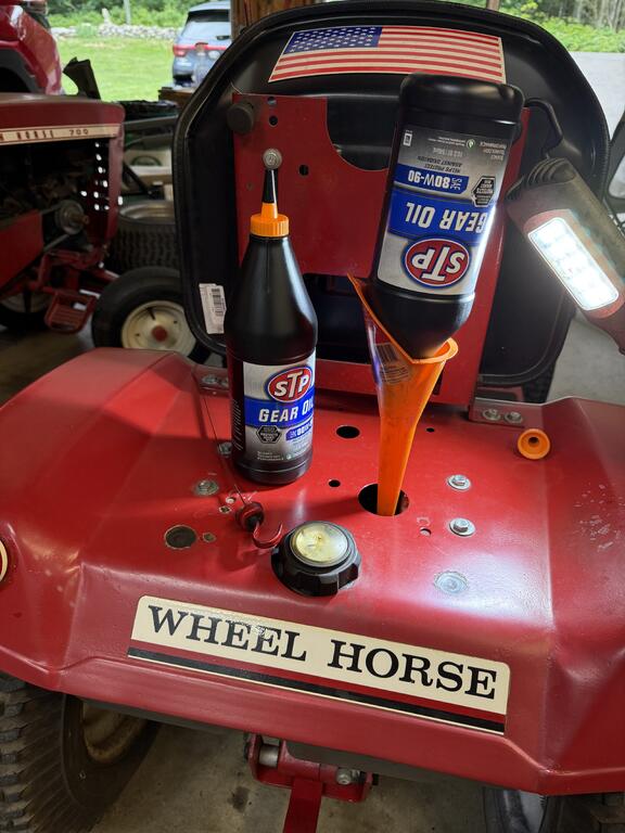

squonk 48,354 #26326 Posted June 30 23 minutes ago, Sparky said: Old gear oil out, then a kerosene flush and drain…now the fresh stuff goes in. 1978 C-81 Something tells me you didn't spend the afternoon on a black roof in this heat! 2 2 Share this post Link to post Share on other sites

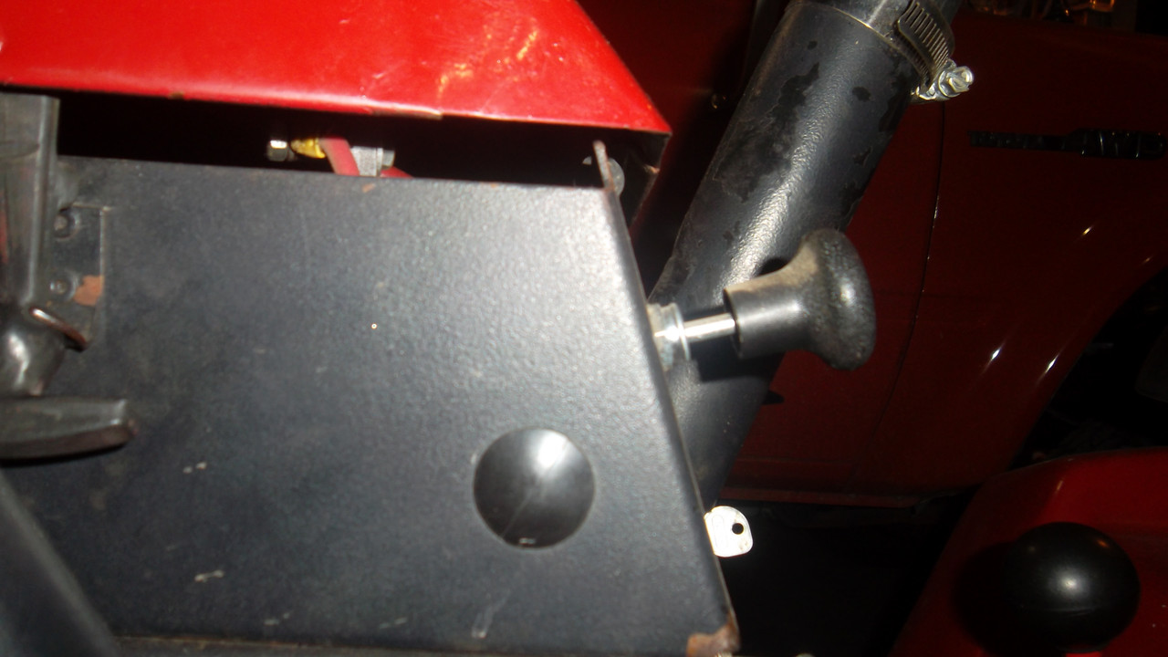

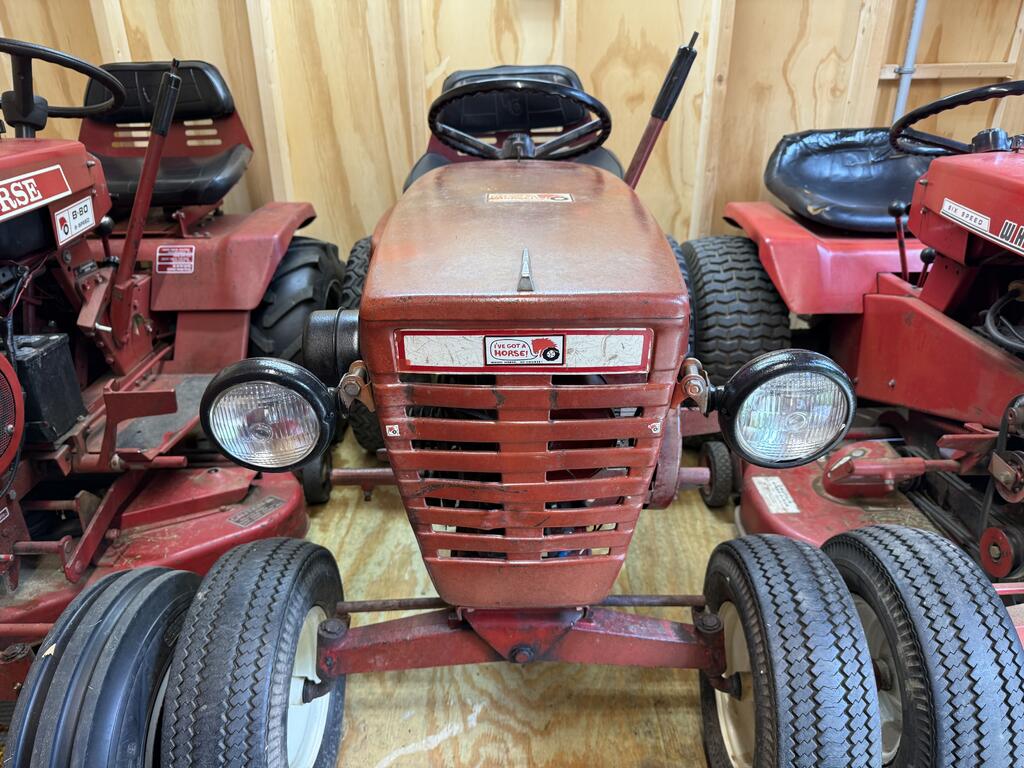

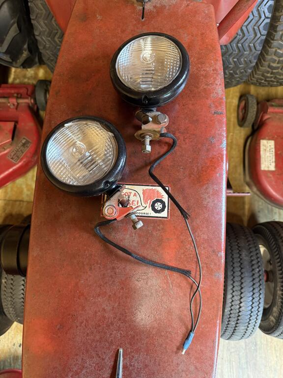

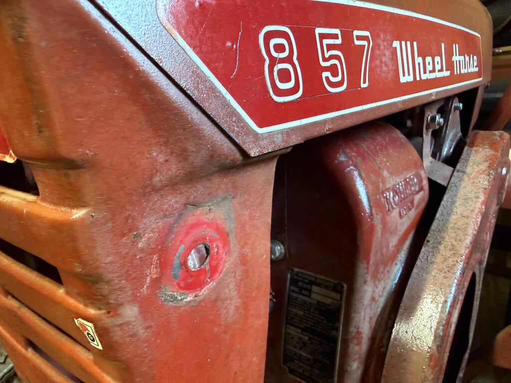

Sparky-(Admin) 26,716 #26328 Posted June 30 Was not a fan of these big goofy headlights on my 857, after two years of owning it I finally removed them. Much better looking! Too bad there’s a big ‘ol hole on both sides of the hood 5 1 Share this post Link to post Share on other sites

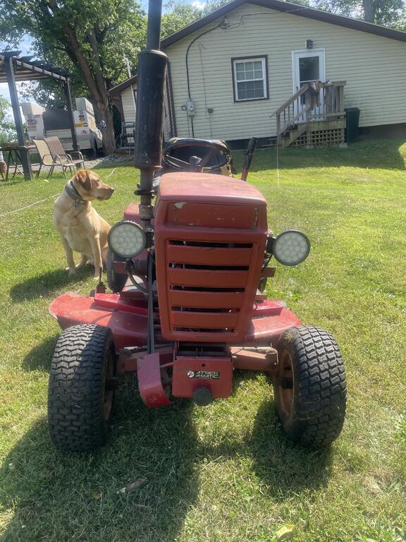

EthanL 69 #26329 Posted June 30 6 minutes ago, Sparky said: Was not a fan of these big goofy headlights on my 857, My tractor had the same round lights, they got old and burned out. Rather than replacing them I found new LEDs that looked very similar. Since this tractor is my work horse, the LEDs were a very functional upgrade. 4 4 Share this post Link to post Share on other sites
ebinmaine 81,183 #26330 Posted June 30 13 minutes ago, Sparky said: big goofy headlights If ya need a home for those.. I'd be interested. 1 Share this post Link to post Share on other sites
Sparky-(Admin) 26,716 #26331 Posted June 30 9 minutes ago, EthanL said: My tractor had the same round lights, they got old and burned out. Rather than replacing them I found new LEDs that looked very similar. Since this tractor is my work horse, the LEDs were a very functional upgrade. And yes, if this was a worker I would have kept the headlights. But it’s pretty much just a show cruiser. Occasionally I’ll hook up a trailer and move firewood but never at night. 5 Share this post Link to post Share on other sites
Handy Don 17,689 #26332 Posted June 30 18 minutes ago, Sparky said: I'm sure you can find something to attach there that is more pleasing to look at, for example a side marker light or a simple reflector. You might consider, too, a reinforced filler covered by a decal from redoyourhorse--something custom, even, like your horse’s name. I do agree those lights look better in the parts bin than on the tractor! 1 1 Share this post Link to post Share on other sites

squonk 48,354 #26334 Posted June 30 48 minutes ago, Sparky said: Was not a fan of these big goofy headlights on my 857, after two years of owning it I finally removed them. Much better looking! Too bad there’s a big ‘ol hole on both sides of the hood Red Square stickers would cover them up! 3 Share this post Link to post Share on other sites

sqrlgtr 4,192 #26336 Posted June 30 1 hour ago, Sparky said: Too bad there’s a big ‘ol hole on both sides of the hood had a set of extra holes in my 1257 hood but added lights instead of removing 3 3 Share this post Link to post Share on other sites

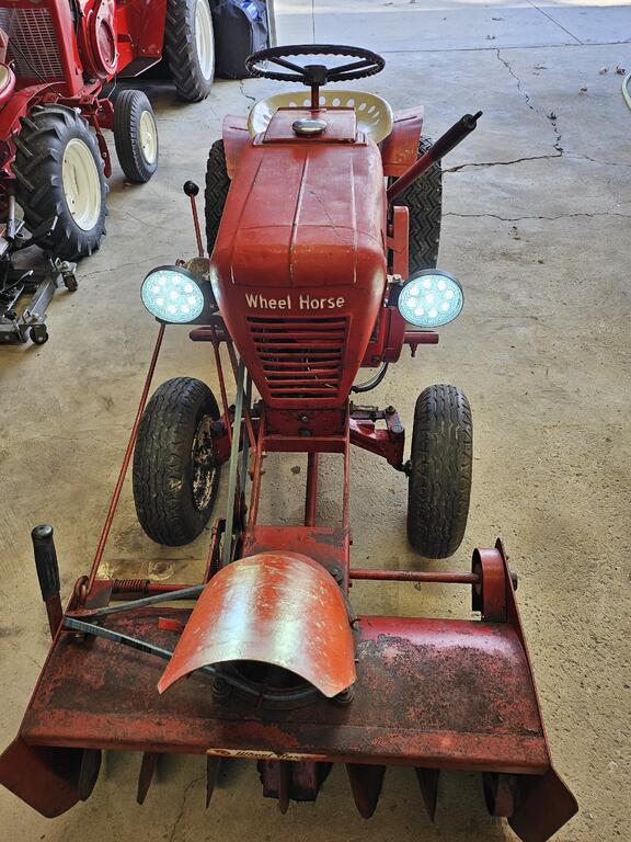

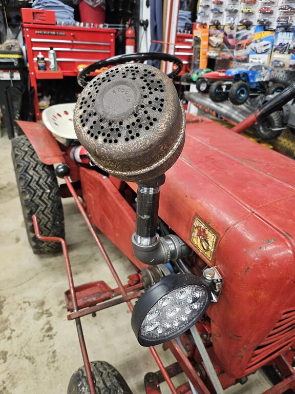

ML3 2,557 #26337 Posted June 30 10 minutes ago, sqrlgtr said: had a set of extra holes in my 1257 hood but added lights instead of removing My free 702 already had holes w/no lights installed. Since its a functional tractor I installed led lamps. They definitely work great & at least I dont think they look too bad......It kinda ugly old tractor anyways! 🤣 3 2 Share this post Link to post Share on other sites

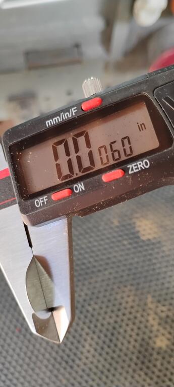

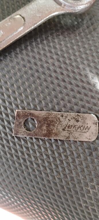

wfopete 69 #26338 Posted July 1 (edited) My "New to Me" D160 Kept pushing the dip stick out of the tube. I knew that wasn't right and did some digging about the Onan B43 in it. Took apart the breather reed valve assembly and was surprised that Lufkin made the reed; boy that reed was stiff too! You know what? Lufkin also made feeler gauges and this reed measured in at .0275". Me thinks bubba was at work here. My OEM replacement reed was a little more flexible at .0060". I think the reed problem is solved. Edited July 1 by wfopete 4 4 Share this post Link to post Share on other sites

Lee1977 7,810 #26340 Posted July 1 16 hours ago, Sparky said: Was not a fan of these big goofy headlights on my 857, after two years of owning it I finally removed them. Much better looking! Too bad there’s a big ‘ol hole on both sides of the hood I had a couple hole drilled in my 312-8 when I got it. I pushed in a couple body panel plugs, mine were in the black so I didn't have to paint them. 5 Share this post Link to post Share on other sites
peter lena 10,114 #26341 Posted July 1 @Lee1977 those body panel plugs make it easy , pete Share this post Link to post Share on other sites

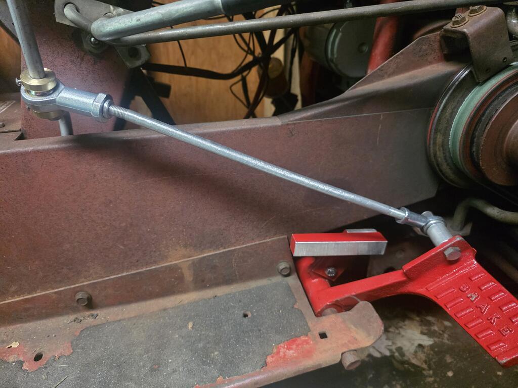

RJR49 179 #26342 Posted July 1 Installed a "go" pedal on my C-160 Auto. This is the 3rd, and I believe, the simplest, and most elegant of the three versions. Very easy to do. I'll create some drawings if anyone is interested. 2 5 Share this post Link to post Share on other sites

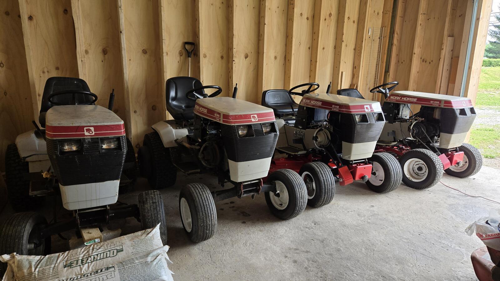

kdeatrick 170 #26343 Posted July 1 Saturday after leaving the show, I pulled all the Work Horses out of the Horse Garage and clean the garage and them. I rebuilt the garage last fall 1 board at a time, only thing left original is the roof. I have another restored 1848 to bring over that will live here now also. Still 1 more GT1100 at home and 1 at the cabin. Plus a C175 disassembled and on pause of restoration. a bunch of decks for spares. I think the GT1600 shown here maybe next, I have the engine ready to reassemble after being bored. 10 Share this post Link to post Share on other sites

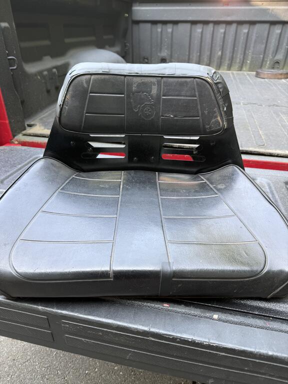

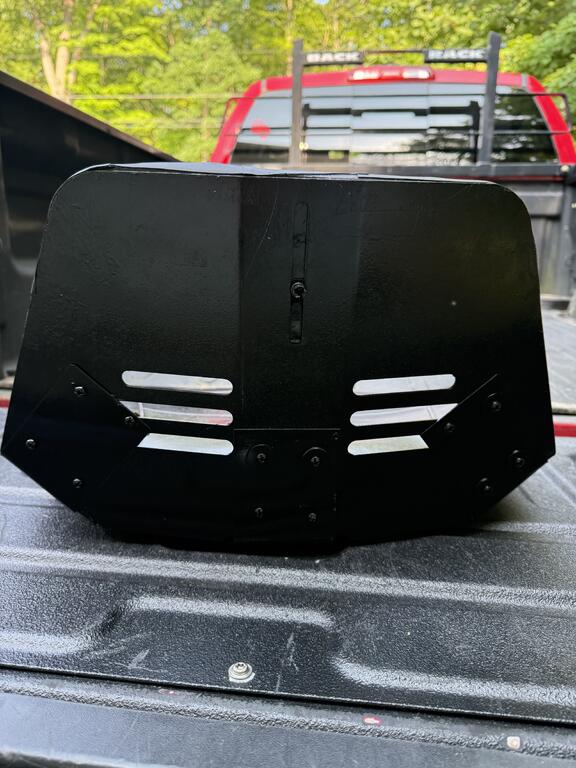

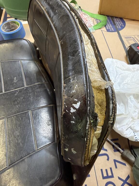

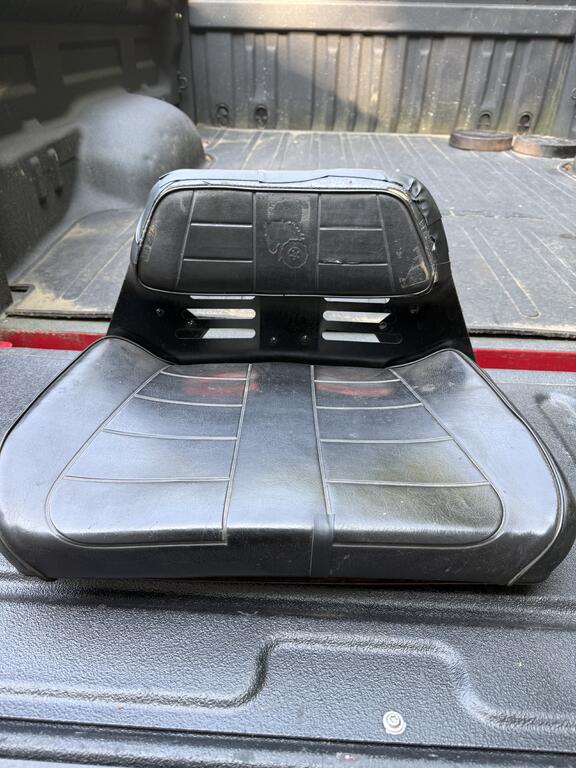

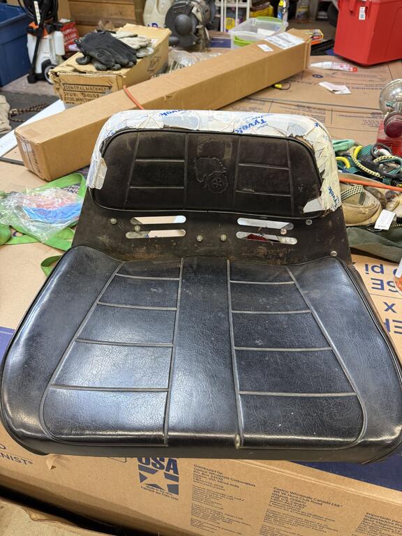

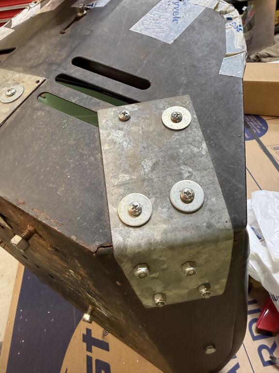

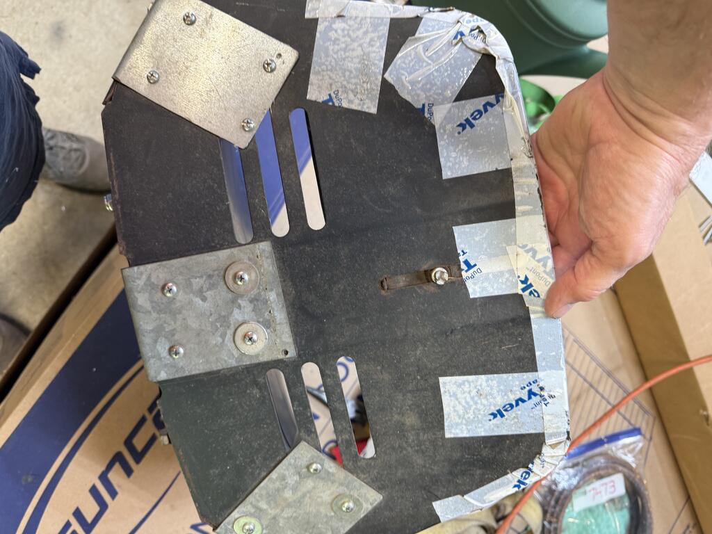

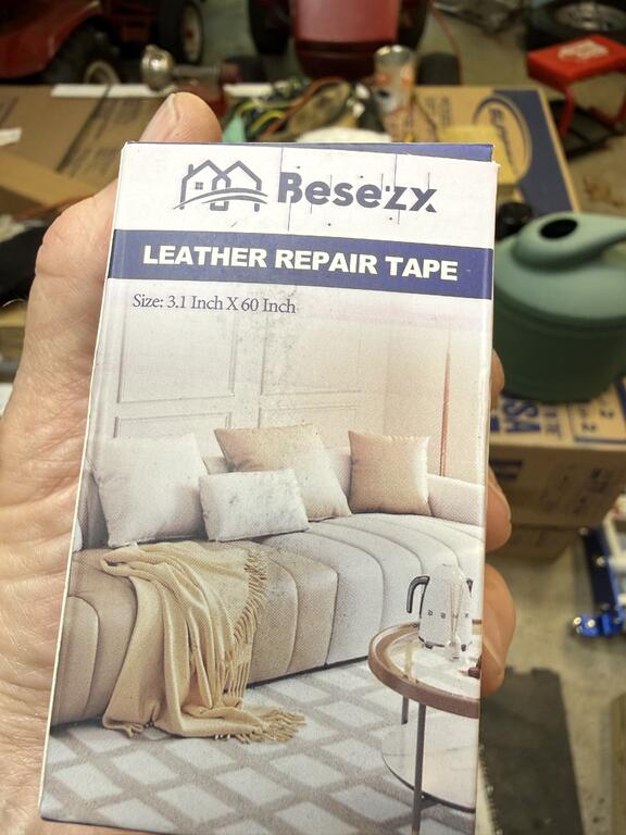

Sparky-(Admin) 26,716 #26345 Posted July 1 Picked up this two piece seat for cheap money at the WH Show. She’s ugly! Some gloss black rattle can and leather repair tape (lots of tape!) and she’s ready for service. Not show quality or anywhere close to it. But nothing so permanent that I couldn’t replace the seat back and seat cushion if I wanted in the future. 8 4 Share this post Link to post Share on other sites
wallfish 20,738 #26346 Posted July 2 Much gooder! 4 Share this post Link to post Share on other sites

TonyToro 1,199 #26348 Posted July 2 On 6/30/2026 at 6:13 PM, Sparky said: Was not a fan of these big goofy headlights on my 857, after two years of owning it I finally removed them. Much better looking! Too bad there’s a big ‘ol hole on both sides of the hood I would clean up the area and get a rubber grommet to fit that. I bet it would look almost factory. I just welded up a hood that had holes every where from hood ornament to lights. 1 1 Share this post Link to post Share on other sites
oliver2-44 11,833 #26349 Posted July 2 20 hours ago, RJR49 said: Installed a "go" pedal on my C-160 Auto. This is the 3rd, and I believe, the simplest, and most elegant of the three versions. Very easy to do. I'll create some drawings if anyone is interested. I would appreciate some drawings, especially since its a Sundstrand Hydro. 1 Share this post Link to post Share on other sites
peter lena 10,114 #26350 Posted July 2 @RJR49 hey , you can't do that ! using a heim joint for movement , functional ease ? have these in use for years , pto lever set up is a GOLD MINE FOR IMPROVEMENT . steering rod ends , clutch pedal , good for you ! pete Share this post Link to post Share on other sites
