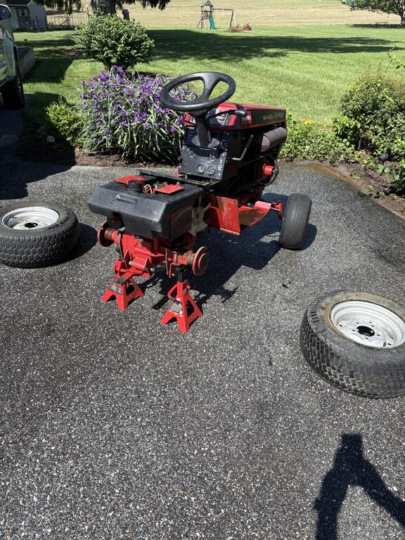

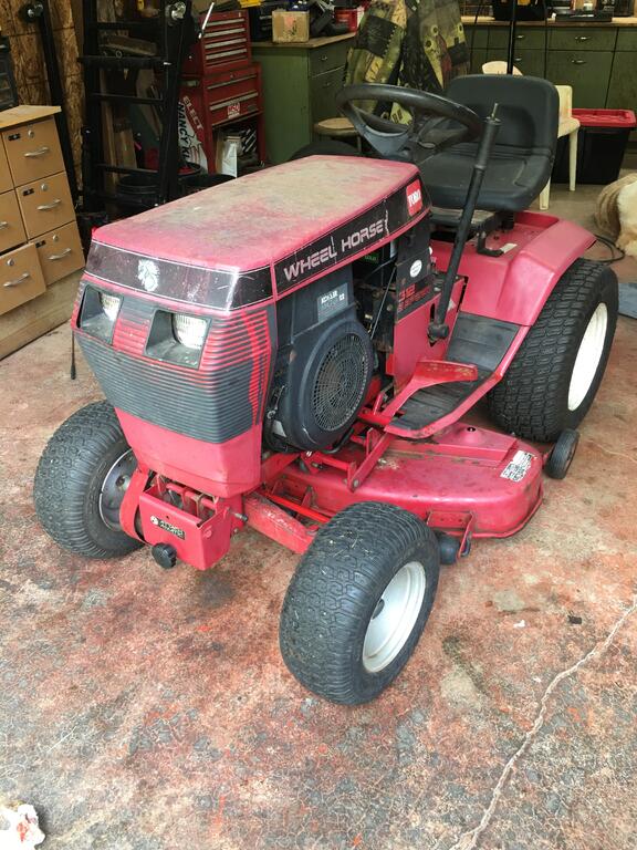

Sodaking27 1,348 #26152 Posted May 30 Major cleaning of the recently acquired 314H. 11 4 Share this post Link to post Share on other sites

lynnmor 9,037 #26154 Posted May 30 13 hours ago, Sodaking27 said: Major cleaning of the recently acquired 314H. You went that far I hope you pulled the gas tank and cleaned the crud under there. You can clean the cooling fins easier and the dirt between the seat mount and gas tank causes rust. 3 Share this post Link to post Share on other sites

Sodaking27 1,348 #26156 Posted May 30 6 hours ago, lynnmor said: You went that far I hope you pulled the gas tank and cleaned the crud under there. You can clean the cooling fins easier and the dirt between the seat mount and gas tank causes rust. Yep gas tank was pulled and cleaned out. Fan was removed to make sure all the crud was removed. This was one of the crudest tractors I’ve ever seen. After I was finished with the pressure washer I ended up throwing my shirt and shorts away. They were beyond cleaning. 5 2 Share this post Link to post Share on other sites

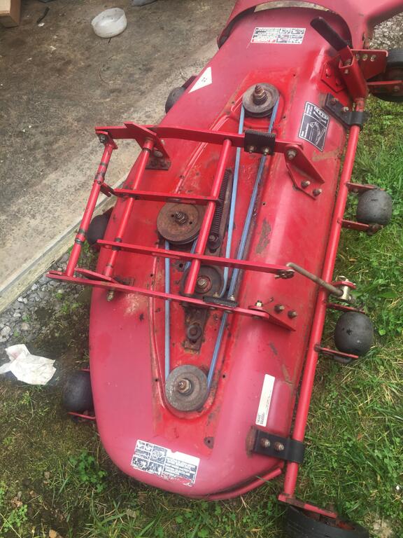

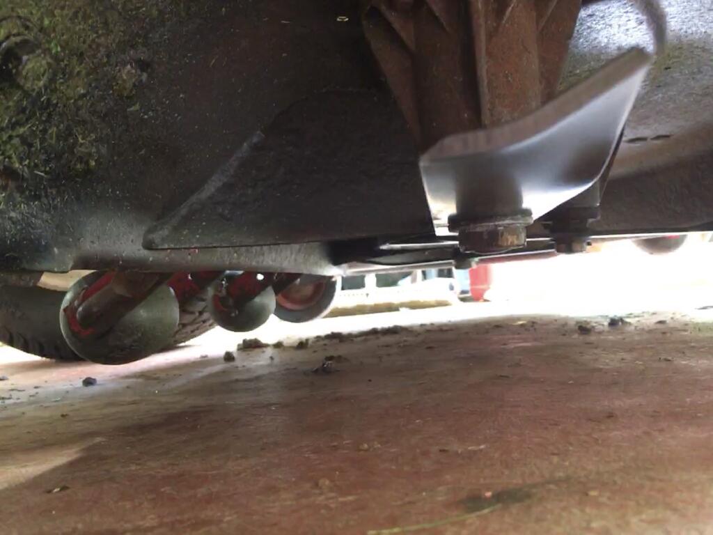

sqrlgtr 3,860 #26157 Posted May 31 New tie rods new, spindle belt, new blades and deck adjusted today. Mowed a little spot behind shop that I missed with zero turn mower and it mowed like a champ.. 9 Share this post Link to post Share on other sites

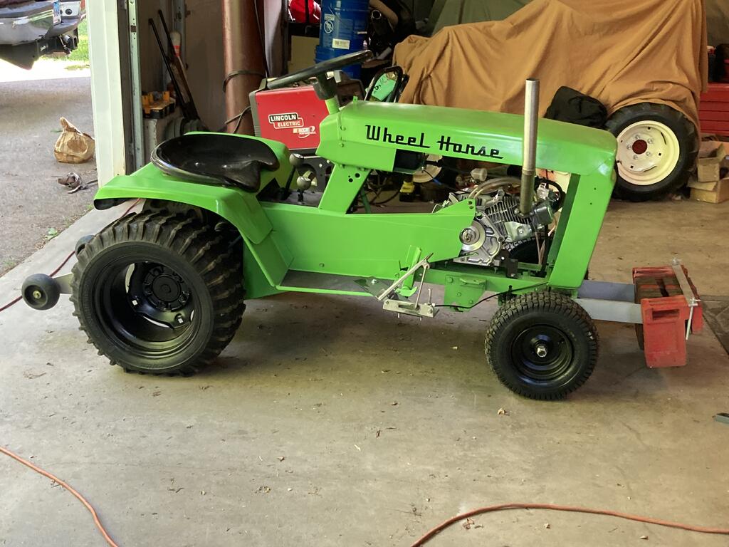

TonyToro 1,190 #26158 Posted May 31 Well it’s not really what I did today or yesterday but for the past 3 weeks….. is @TonyToro Jr. and I built this little puller! Originally a B60 now has a Predator 212 completely built engine running 7400RPM. I can’t say the horsepower because racing secrets ..lol Thank you @grnlark for the front axle worked perfectly! I might paint the front weight bar and need to make a mid weight bar. If anyone is looking for the absolute best pulling hitch for a WheelHorse check out D&D welding fabrication. 4 7 Share this post Link to post Share on other sites
Easton Rich 1,260 #26159 Posted May 31 @TonyToro You're giving me ideas! 1 Share this post Link to post Share on other sites

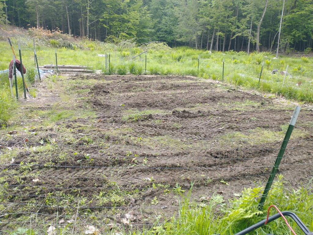

ebinmaine 80,600 #26160 Posted May 31 Got some good seat time in today. Started with the garden area prep. Double ripper spikes to use. Before, right at start. After: Couldn't get as deep as I want because of wet slippery ground. No worries. After that I hauled four full 17 cu ft loads of Mackissic chipper shredder mulch from the front yard down beside the barn and to the garden. All hand shoveled. Quite a workout. Feels good to move. Here's the BBT and her momma moving cow 🐄 poop 💩 in and getting it all stirred in. The mulch is about half layed out and some plants are in. This is a teeny tiny red potato Trina found while prepping the dirt. 8 4 Share this post Link to post Share on other sites

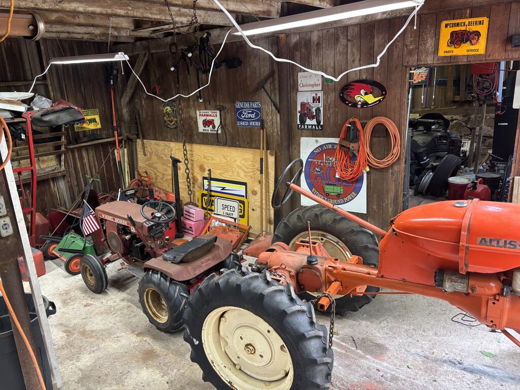

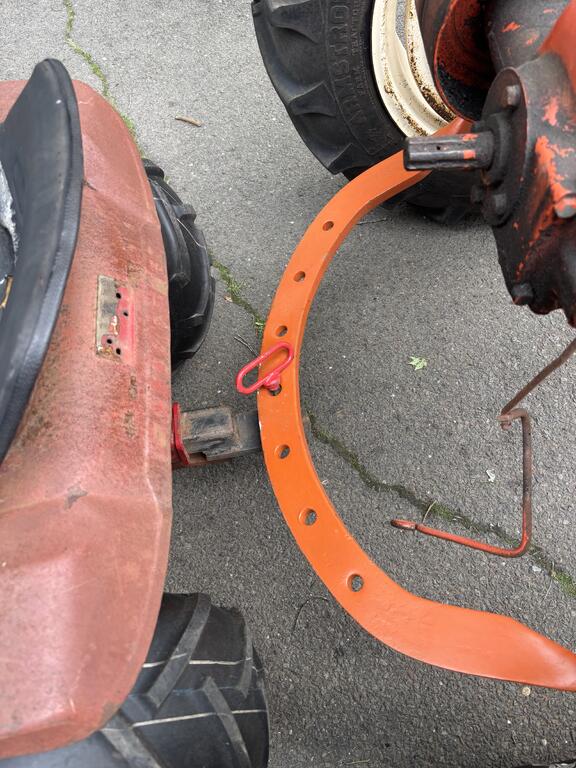

Chris689 323 #26161 Posted May 31 While not 100% wheel horse related my 10-8 was definitely utilized though. Bought my first antique tractor yesterday. Flying solo unloading it today I had to get creative. Started pulling it out with a chain and a wheel chock to move it in increments, that got sketchy quick. I then had the bright idea to hitch the tractors together with a hitch pin. That made life much easier. Had to resort back to the chain to pull it into the barn. 10-8 put in some good work today. 5 8 Share this post Link to post Share on other sites

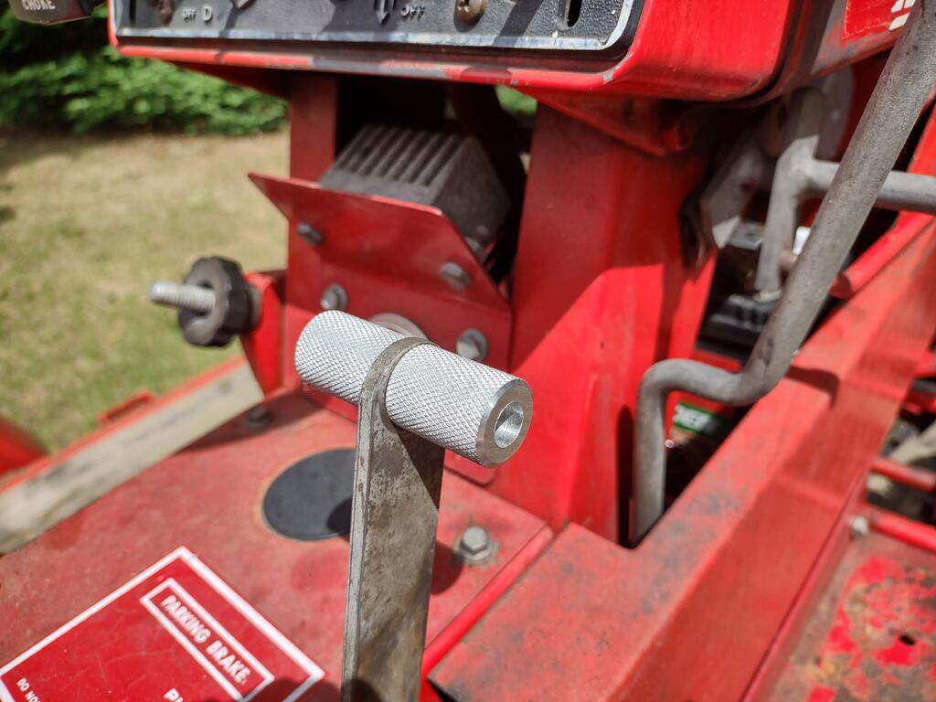

Achto 32,630 #26165 Posted June 1 (edited) Spent some time on the B-100 this weekend. Parts came in for the tranny so I was able to reassemble that. I discovered that the idle pulley for the drive belt was locked up so that got replaced. The plastic handle for the parking brake was missing so I spun some new ones out of aluminum on the lathe. Back together and ready for duty. Edited June 1 by Achto 3 11 Share this post Link to post Share on other sites
Bill D 3,139 #26166 Posted June 1 3 minutes ago, Achto said: The plastic handle for the parking brake were missing so I spun some new ones out on the lathe. I like those. Way better than original. 1 1 Share this post Link to post Share on other sites
mrc 1,116 #26167 Posted June 1 hi achto, love that knurling! 2 Share this post Link to post Share on other sites

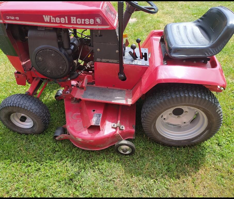

T.R Hawthorne 20 #26168 Posted June 1 I finally after all these years got a 520h. Wheelhorses have been a family thing way back when. From generation to generation. In the 4th Gen and my sons are the 5th gen wheelhorse loyal fanatics. We farm them like a farm tractor. A shout out to sight admins for a fantastic forum! Thank you! 2 10 Share this post Link to post Share on other sites

Ed Kennell 47,255 #26171 Posted June 1 16 hours ago, Chris689 said: that got sketchy quick. I have used the chain thru a pipe tow bar trick many times for pulling and pushing non running vehicles. Share this post Link to post Share on other sites

peter lena 10,047 #26175 Posted June 1 @sqrlgtr your second picture down of the deck ,VERY SMALL staring hole opportunity to mount a a flat idler pulley , added this to 3 decks , long unsupported belt , bounces / buzzes 3/8 hole holds an unshouldered , bolt , flat idler pulley with an elastic Lok nut , really ENHANCES FUNCTION ? done so much of this enhancement , its just a regular thing for me , pete 1 Share this post Link to post Share on other sites
