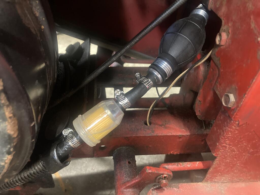

kpinnc 19,065 #26126 Posted May 27 50 minutes ago, Fj40z said: little hard to start if it’s sat for a few days but man do I love it Get an inline 1/4 marine primer bulb. This is a common issue with any of these tractors with the fuel tank under the seat. 2-3 squishes before before starting and it'll likely start on the first couple rotations. Saves your starter, saves your battery, does wonders for your sanity... 5 2 Share this post Link to post Share on other sites
ebinmaine 81,183 #26127 Posted May 27 4 hours ago, kpinnc said: Get an inline 1/4 marine primer bulb. This is a common issue with any of these tractors with the fuel tank under the seat. 2-3 squishes before before starting and it'll likely start on the first couple rotations. Saves your starter, saves your battery, does wonders for your sanity... @Fj40z I'd add to @kpinnc 's post. Be sure to get a GOOD QUALITY primer bulb. We've had the cheap ones fall apart in months. Great way to start a fire. Attwood brand is the choice here. 1 1 Share this post Link to post Share on other sites
Fj40z 241 #26128 Posted May 27 @kpinnc @ebinmaine Many thanks for the input! I wouldn’t have thought about a marine primer even though I had a feeling it was just having a hard time pulling fuel after it had sat for a while. Any one have a pic of how and where they’ve routed them? Share this post Link to post Share on other sites
ebinmaine 81,183 #26129 Posted May 27 59 minutes ago, Fj40z said: @kpinnc @ebinmaine Many thanks for the input! I wouldn’t have thought about a marine primer even though I had a feeling it was just having a hard time pulling fuel after it had sat for a while. Any one have a pic of how and where they’ve routed them? I don't have any pics handy but basically I try to tuck the primer bulb in just before the engine, on the starter side. That's only for the reason of practicality of space combined with ease of access to the bulb. 1 1 Share this post Link to post Share on other sites
SylvanLakeWH 32,837 #26130 Posted May 27 Here's mine: 3 1 Share this post Link to post Share on other sites
Fj40z 241 #26131 Posted May 27 PERFECT!! Big thank you @SylvanLakeWH and @ebinmaine 1 Share this post Link to post Share on other sites

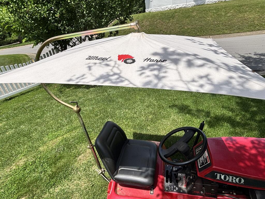

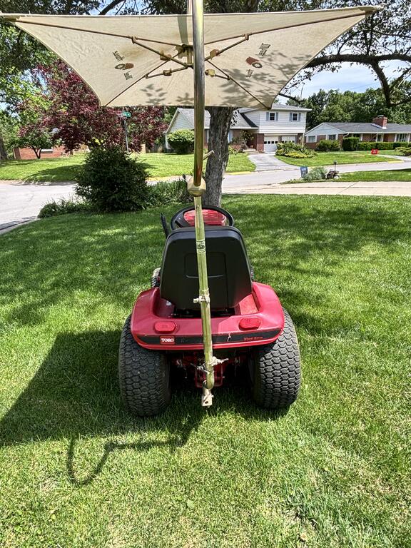

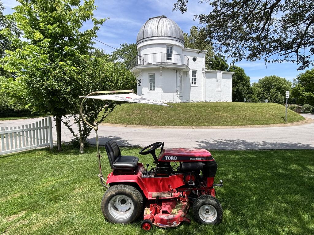

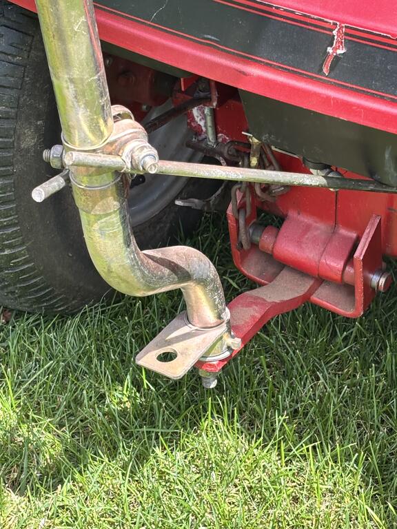

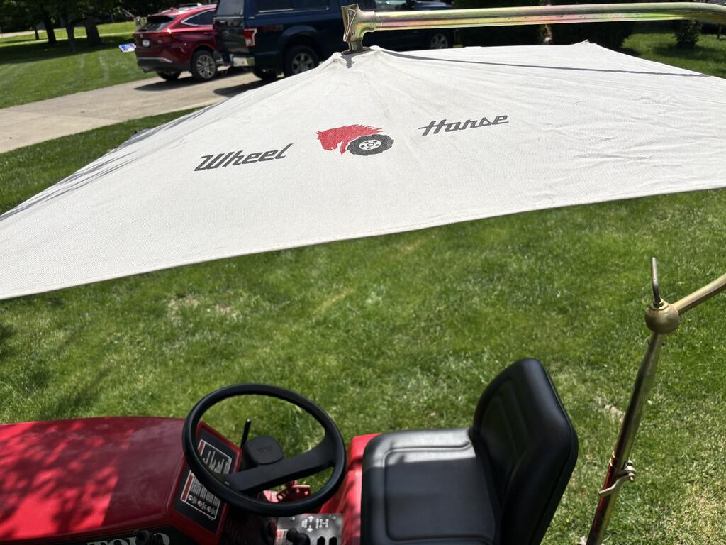

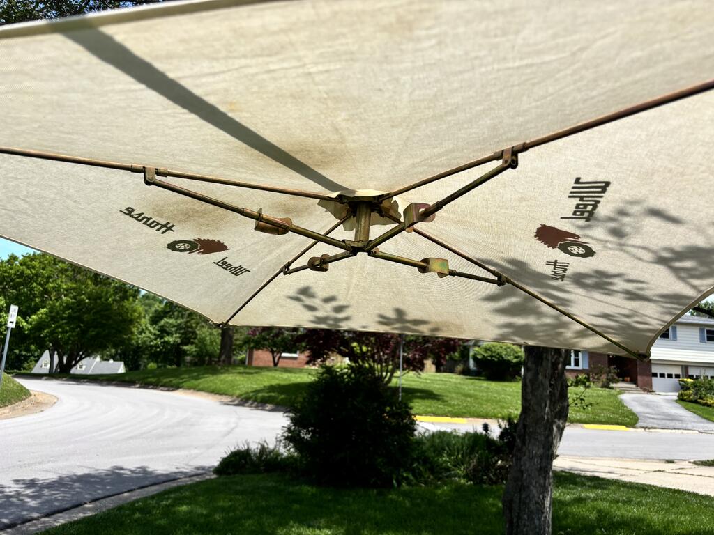

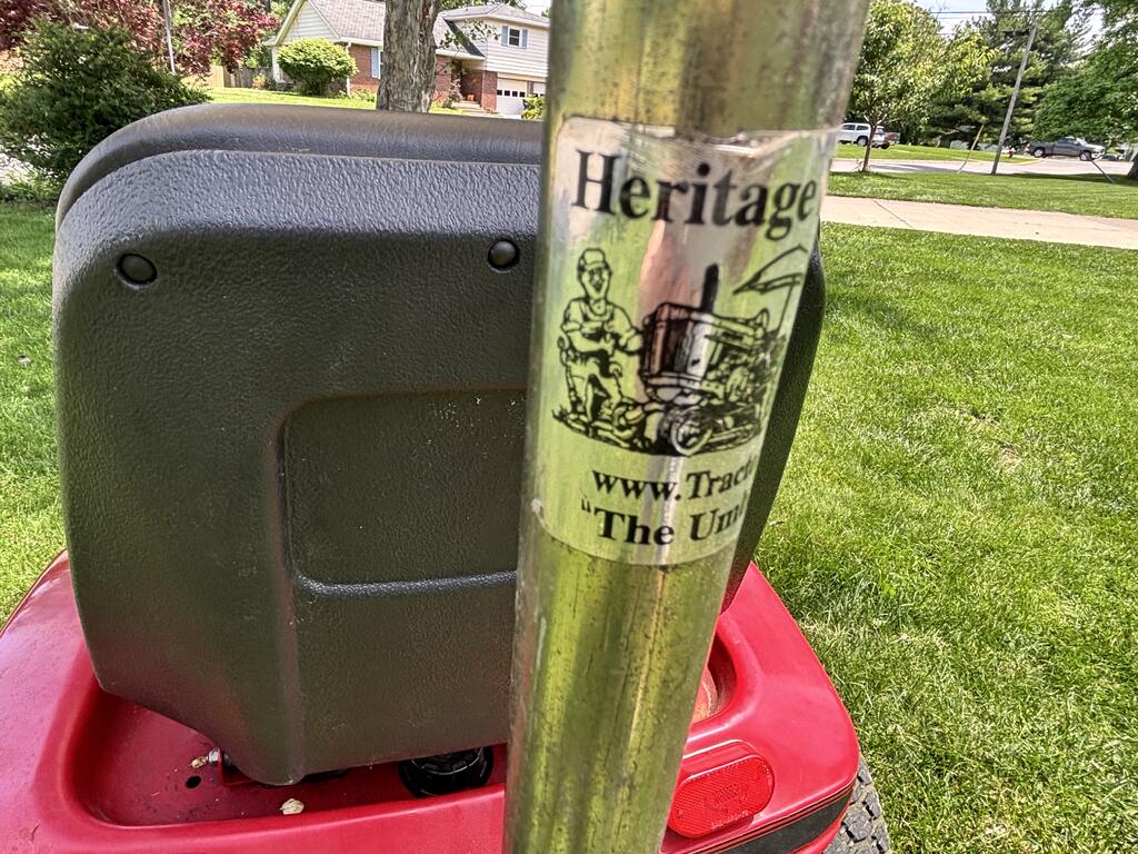

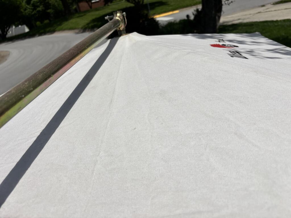

Lane Ranger 12,161 #26146 Posted May 29 (edited) Put my Wheel Horse canopy on my 314-8 mowing tractor today. I bought this canopy several years ago from Heritage Farm Power. They are the full size and garden tractor size umbrella or canopy people. I was surprised to see they are going out of business soon so i bought a new replacement canvas canopy with the Wheel Horse logo to have a nice spare. I recommend these as they do keep you cooler in the hot summer sun when mowing a big yard or field. They are well made not cheap and do a great job. https://tractorumbrellas.com Edited May 29 by Lane Ranger 5 3 1 Share this post Link to post Share on other sites

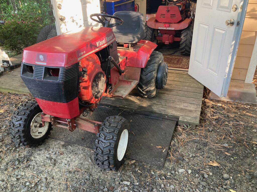

ineedanother 2,885 #26148 Posted May 29 Put the rear weights back on the 312-8. Neighbor wants to aerate everyone's yards tomorrow so I told him I'd provide the tractor and fuel 5 2 Share this post Link to post Share on other sites

953 nut 70,425 #26150 Posted May 29 4 hours ago, Lane Ranger said: Wheel Horse canopy on my 314-8 mowing tractor today. I have too many low hanging branches in my yard to mow with the umbrella, but is nice to have portable shade at the shows. 6 3 Share this post Link to post Share on other sites
