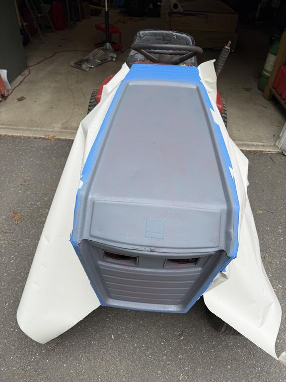

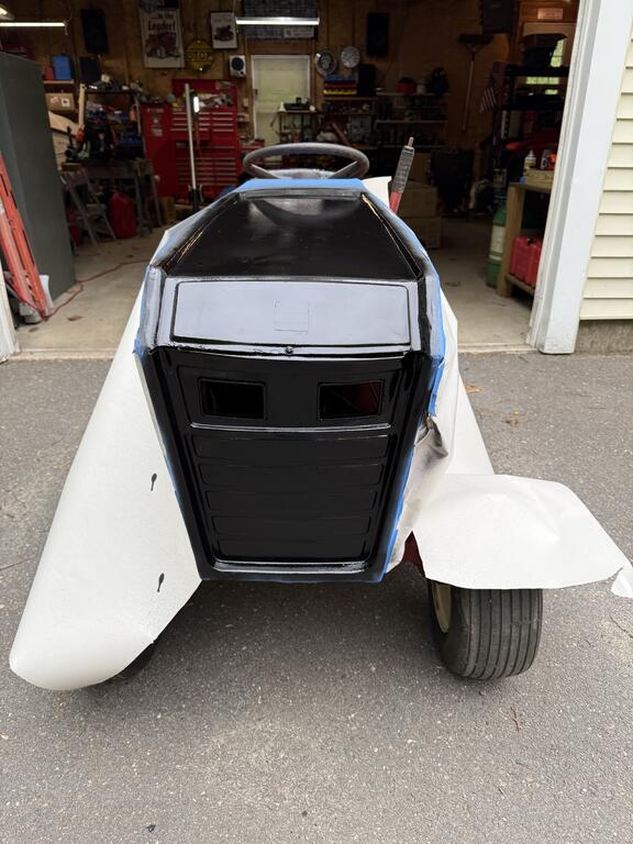

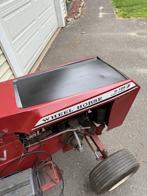

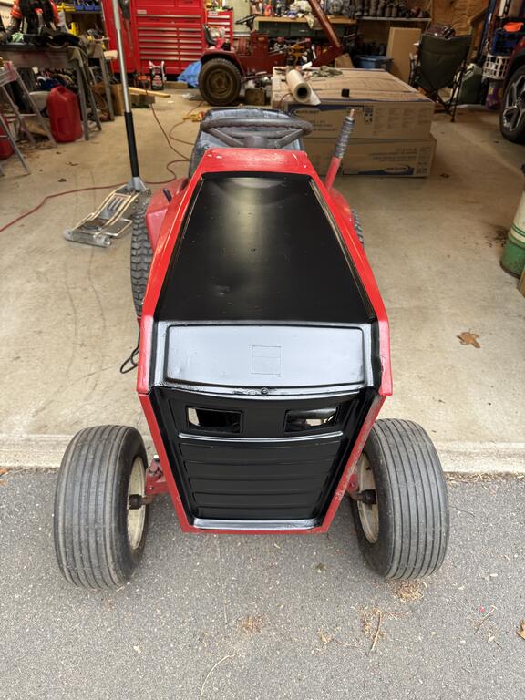

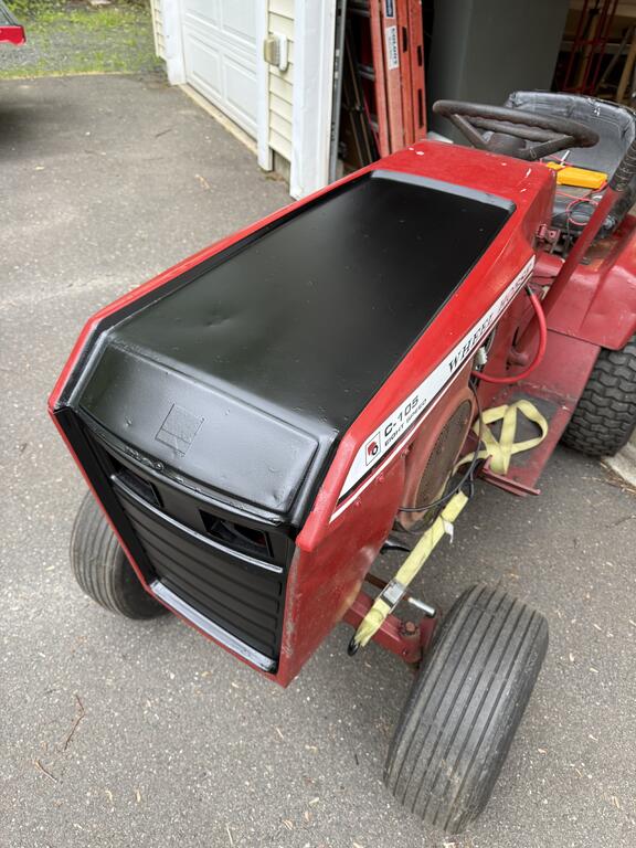

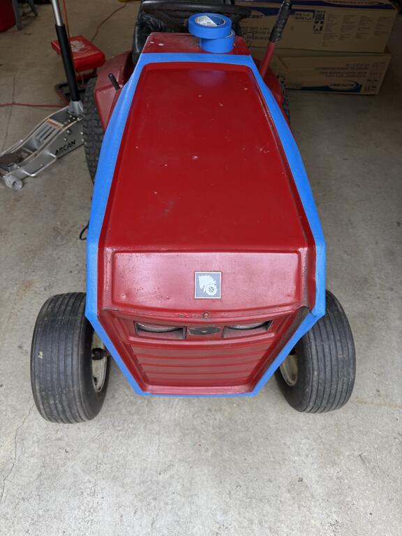

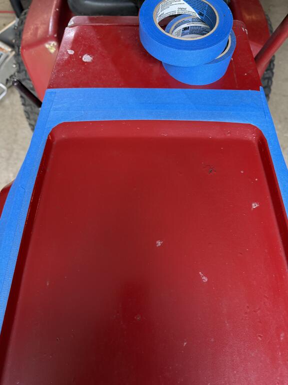

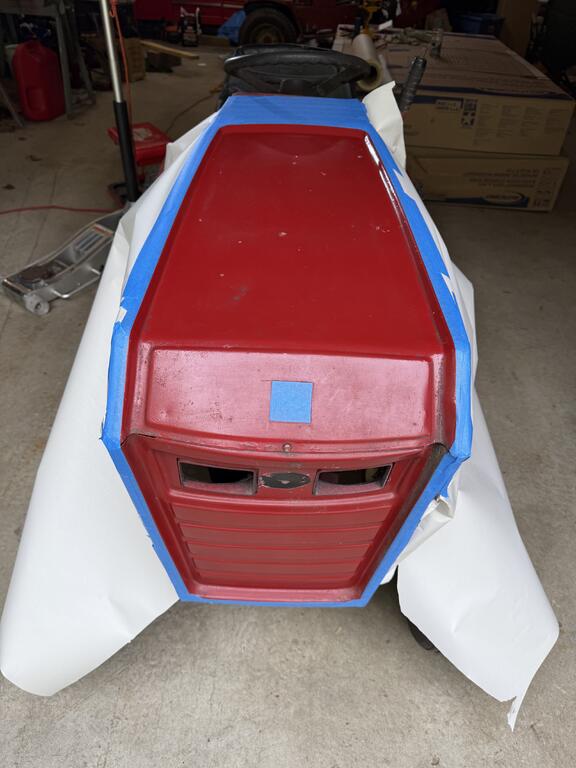

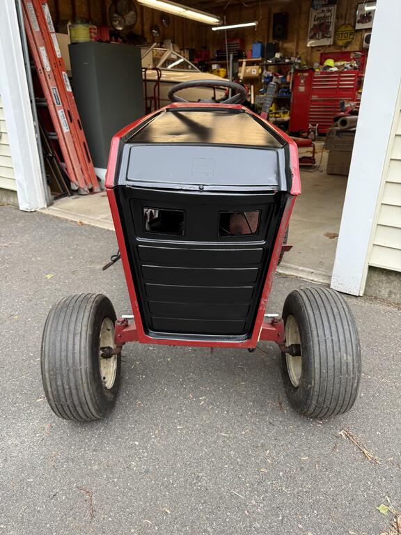

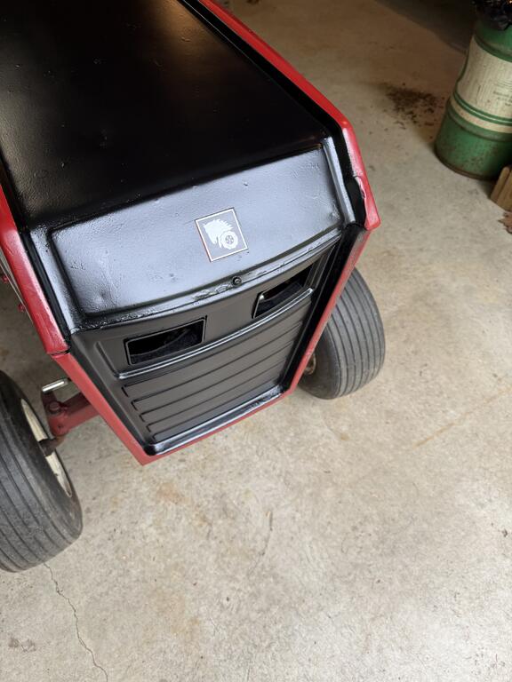

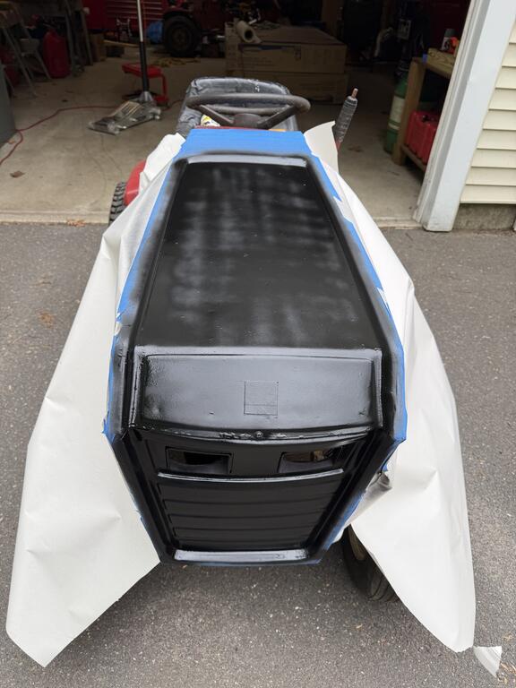

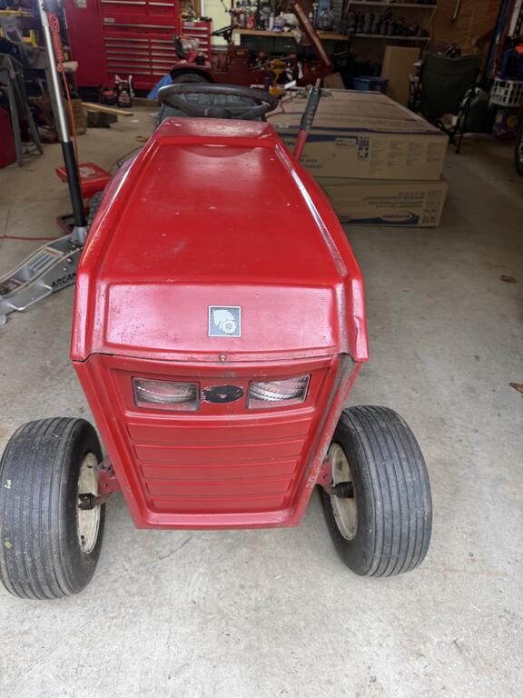

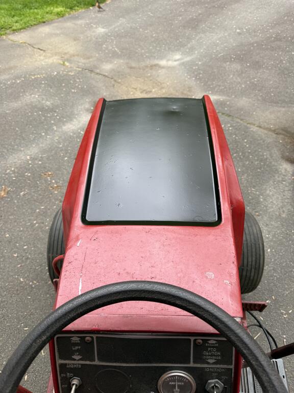

Sparky-(Admin) 26,118 #26007 Posted May 15 C-105 Black Hood I purchased couple weeks ago..but the hood was all red . Little amateur painting today to fix that. 6 12 1 Share this post Link to post Share on other sites

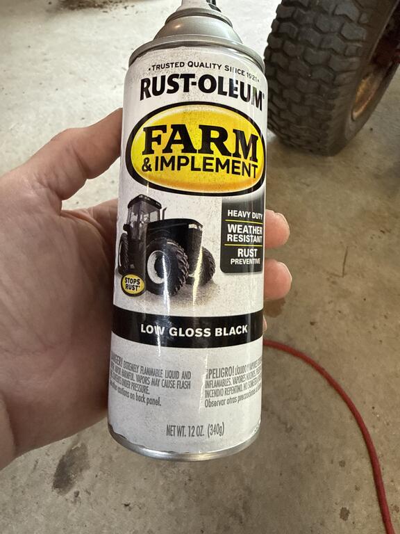

Sparky-(Admin) 26,118 #26008 Posted May 15 Filnal paint used was this if anyone was curious. 5 1 Share this post Link to post Share on other sites

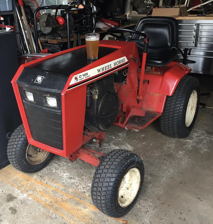

SylvanLakeWH 31,913 #26009 Posted May 15 Looks great @Sparky!!! Tell your C-105 that her Michigan cousin says "Nice new coat! And Cheers"!!! Love the Black Hoods!!! 8 1 Share this post Link to post Share on other sites

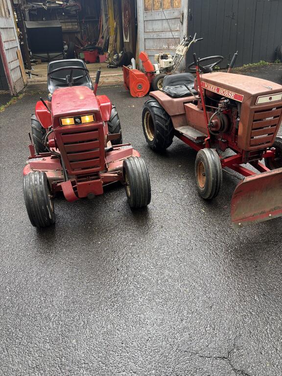

Chris689 308 #26012 Posted May 15 Finally had the V61s mounted for the C120 and the AGs mounted for the 10-8 6 4 Share this post Link to post Share on other sites

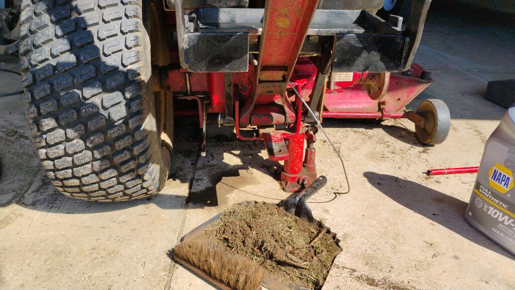

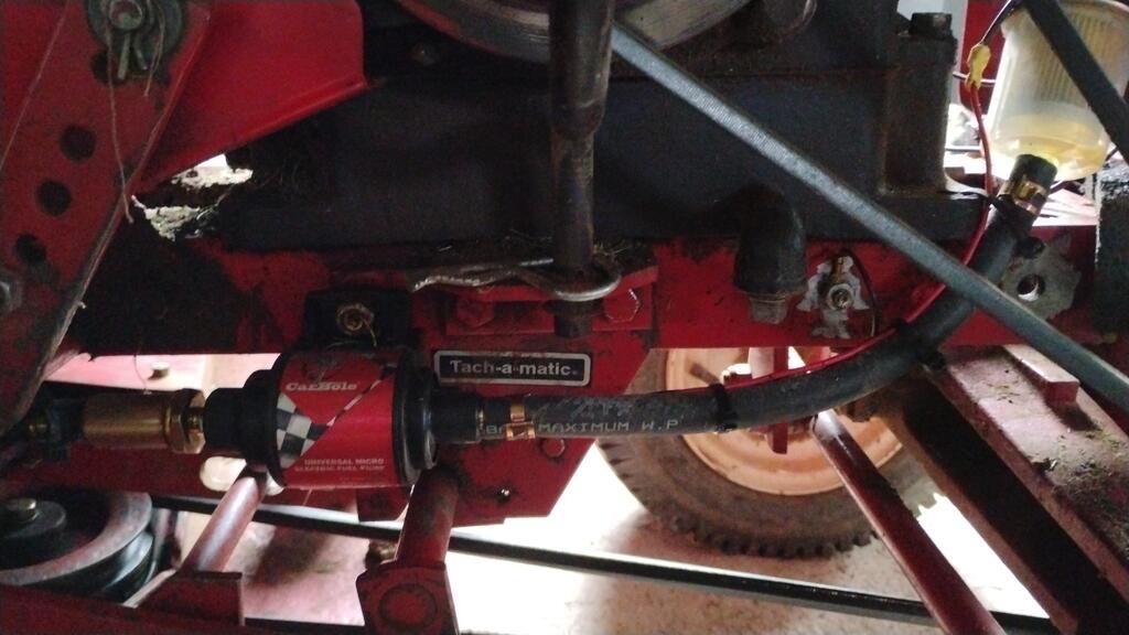

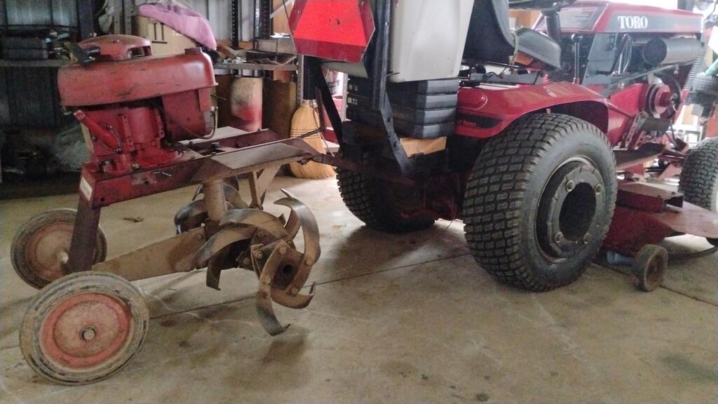

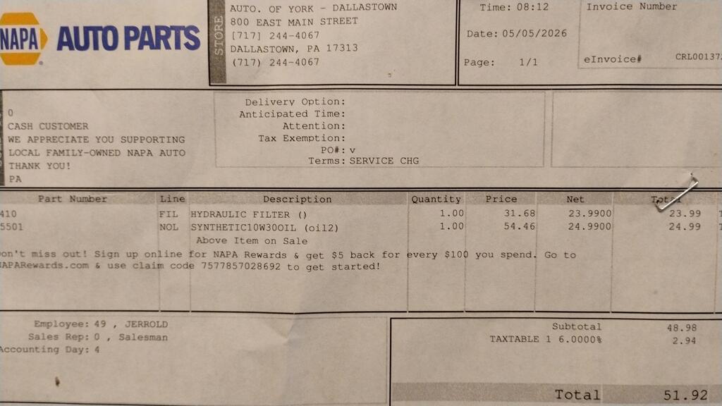

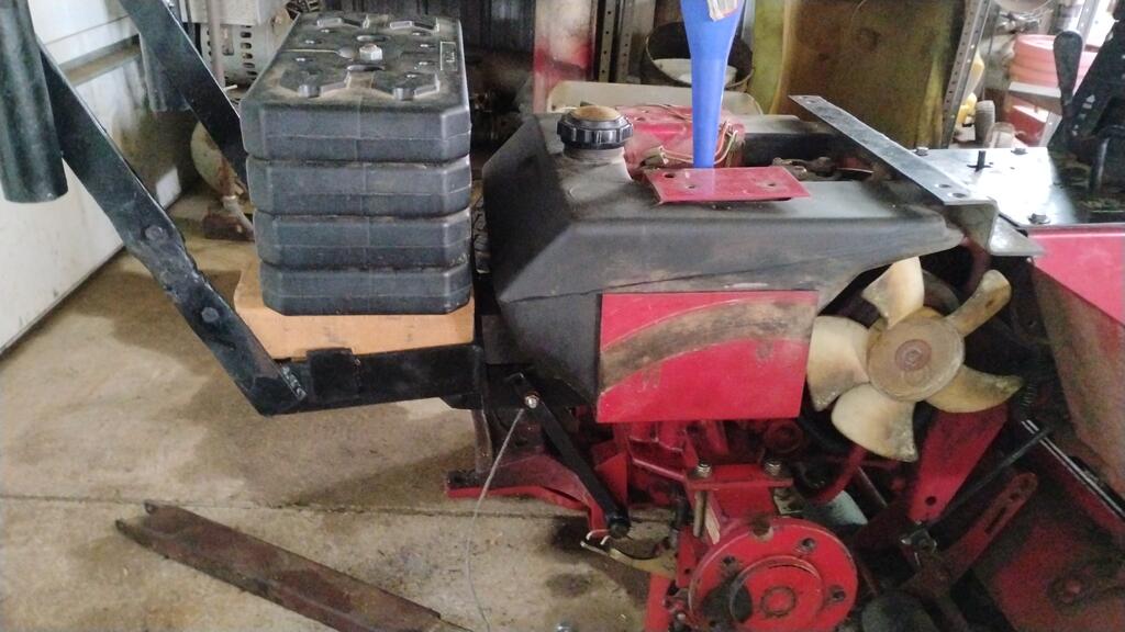

Ed Kennell 46,763 #26014 Posted May 15 What did I do to my Wheel horse today this week. I added a slot hitch so I could pull and lift the new tiller. This required removing the weight rack and moving the support legs to the outside of the drawbar hitch to make room for the slot hitch. The seat and fender pan had to come off so this was a good time to clean the hydro and change oil and filter. Nice surprise when I picked up the filter...NAPAs oil was on sale. Also installed new fuel lines, e-pump, and filter rerouting everything outside the tunnel and ran it along the outside of the right frame rail. 8 5 Share this post Link to post Share on other sites

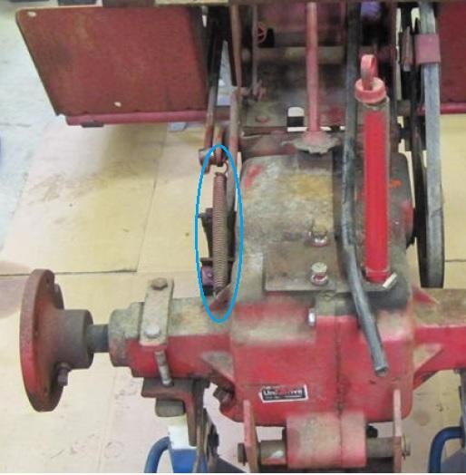

ebinmaine 79,952 #26021 Posted May 16 6 hours ago, Fj40z said: Really wanted to get a good feel for it and try it out. Kind of a shake down run. Noticed all the belts are cracked up pretty bad so all need replaced. Also noticed the clutch pedal doesn’t want to spring back up from time to time and I’d have to pull it back up with my foot a little, so I’m hoping that’s not a bad sign. Here in our Herd every machine is older than you have so my familiarity is limited compared to other guys. That clutch issue may be a worn out gas cylinder. I believe you can simply replace it with the older style spring. Toro number is 108035. Shop carefully for those. The price varies a LOT. Another maintenance item you'll need to consider is the fuel system. Ethanol fuel is not friendly to older rubber. Your tank valve, its grommet, and all your fuel line is almost definitely dried out. Again all parts are available from good sources. 2 1 Share this post Link to post Share on other sites
953 nut 67,929 #26022 Posted May 16 1 hour ago, ebinmaine said: That clutch issue may be a worn out gas cylinder. I believe you can simply replace it with the older style spring. Toro number is 108035. @Fj40z, You can leave the gas dampener in place and just add the clutch return spring as pictured below. Jut need to remove the left rear wheel, no need for a full disassembly. 6 2 Share this post Link to post Share on other sites
