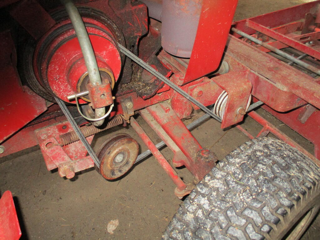

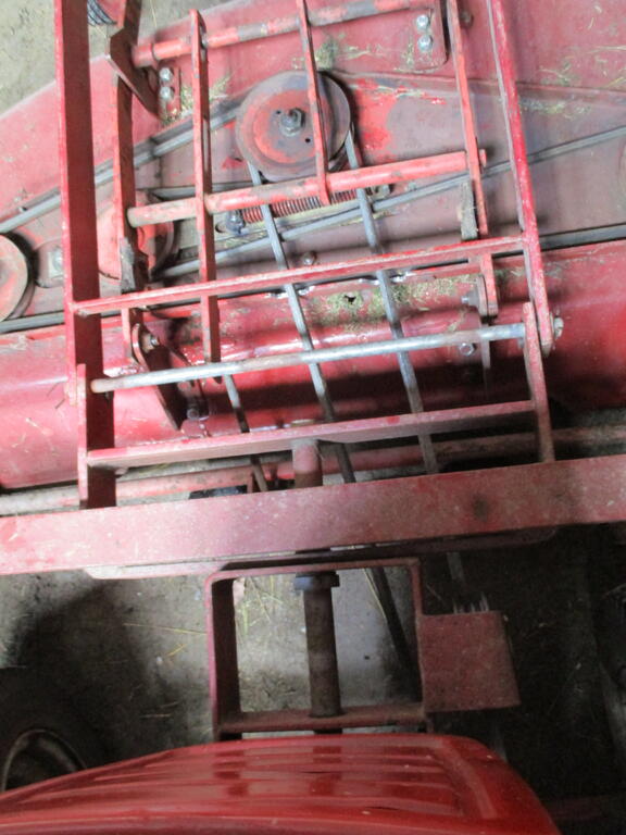

pfrederi 21,314 #25752 Posted April 19 (edited) 23 hours ago, Thor27 said: Nice set up. Can you please show a pic of the other side? Like to see belt routing. Thank you. Belt routing note how it goes around the PTO Hoop. also note you have to cut away some of the deck reinforcement plate to clear the belt. Edited April 19 by pfrederi 2 3 1 Share this post Link to post Share on other sites

Thor27 892 #25760 Posted April 20 @pfrederi Paul, Thank you! I found the center mule for mine today because of your picture. The pulley was robbed off it so it didn't stand out. I've never seen it assembled, but should soon... 1 Share this post Link to post Share on other sites
pfrederi 21,314 #25761 Posted April 20 8 hours ago, Thor27 said: @pfrederi Paul, Thank you! I found the center mule for mine today because of your picture. The pulley was robbed off it so it didn't stand out. I've never seen it assembled, but should soon... The V pulley on the spring loaded arm is supposed to be taken from your front tachmatic mule drive 1 Share this post Link to post Share on other sites
Thor27 892 #25762 Posted April 21 That makes sense, thank you. 2 Share this post Link to post Share on other sites

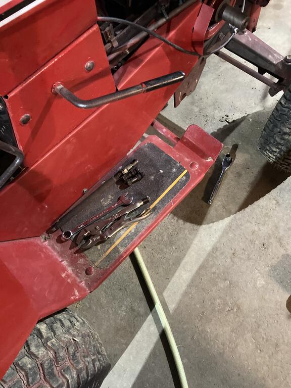

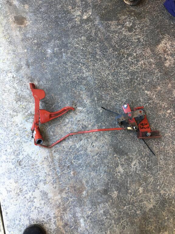

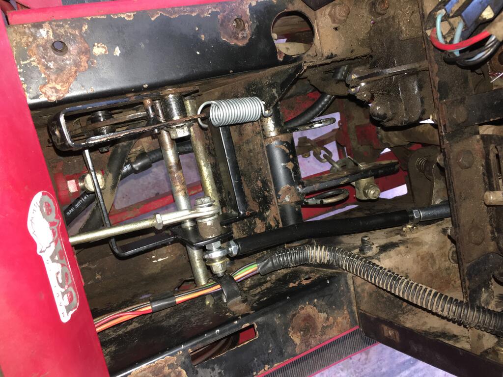

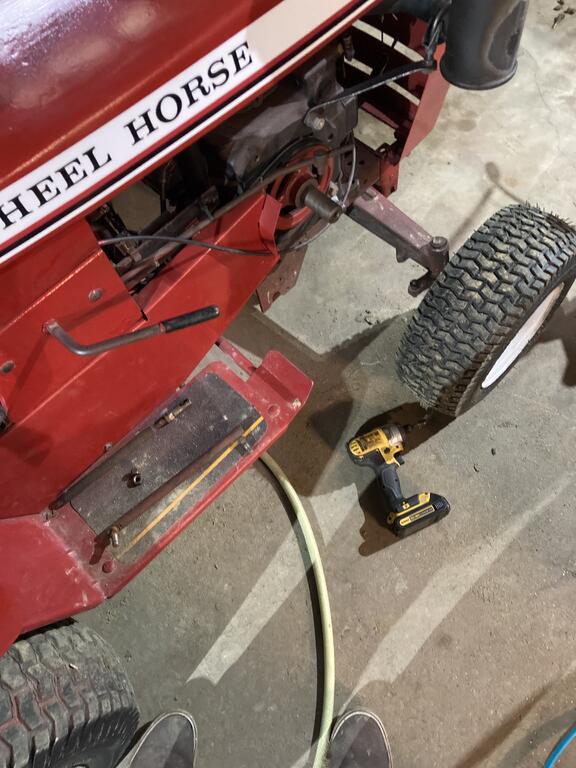

sqrlgtr 4,192 #25763 Posted April 21 (edited) Took hydro foot control off and replaced with steering column controls on the 520H. So much nicer I can actually relax now cruising up and down the happy hills of home. The more I operate this mochine the more I like it. Edited April 21 by sqrlgtr 4 3 Share this post Link to post Share on other sites

sqrlgtr 4,192 #25766 Posted April 21 1 hour ago, kpinnc said: Those foot controllers are sought after, so you can probably find a new home for it easily. 1 hour ago, ineedanother said: Yes! @sqrlgtr , I have been very tempted to adapt that to a Sunstrand and would be interested if you would like to part with it! @Easton Rich has already traded me out of it. I may regret it but I really like the control I have with the steering column control on these hills around here . I did notice today while taking it apart, there was a spring missing (I think) that pulled cam control back into a v shaped piece and returned foot control back to neutral. I might have liked it better if I had tried a spring on there, the way it was it would return to neutral on its on in the flats but I would have to use my heel going down steeper grades to get it to hold back and it just didn't work out well that way. After I got everything adjusted today on the steering column control it works perfect, no creep forwar/backward and foot brake works like it should returning cam control back to neutral when you mash it., and this thing will fly by far fastest Wheel Horse I've ever had. 4 Share this post Link to post Share on other sites
ineedanother 2,885 #25767 Posted April 21 17 minutes ago, sqrlgtr said: @Easton Rich has already traded me out of it. I may regret it but I really like the control I have with the steering column control on these hills around here . I did notice today while taking it apart, there was a spring missing (I think) that pulled cam control back into a v shaped piece and returned foot control back to neutral. I might have liked it better if I had tried a spring on there, the way it was it would return to neutral on its on in the flats but I would have to use my heel going down steeper grades to get it to hold back and it just didn't work out well that way. After I got everything adjusted today on the steering column control it works perfect, no creep forwar/backward and foot brake works like it should returning cam control back to neutral when you mash it., and this thing will fly by far fastest Wheel Horse I've ever had. NIce! I hope that works for you. I need to make a decision about my FEL, auto has to have a foot control or I move the loader onto a 8-speed without the L/S differential and electric clutch. I don't seem to have enough hands and arms to not have a foot control for direction. Kind of hate to do that since my 165 is the tilling machine but we'll see. 2 Share this post Link to post Share on other sites

Handy Don 17,689 #25771 Posted April 22 1 hour ago, sqrlgtr said: I would have to use my heel going down steeper grades to get it to hold back Yep, side effect of having acceleration valves--the hydro doesn’t “lock up” until there is sufficient pressure. That’s close to walking speed in a “free wheeling in neutral” hydro motor . It took me a while to get used to going down hills at a good clip to stay locked up. 1 Share this post Link to post Share on other sites
sqrlgtr 4,192 #25772 Posted April 22 14 minutes ago, Handy Don said: Yep, side effect of having acceleration valves--the hydro doesn’t “lock up” until there is sufficient pressure. That’s close to walking speed in a “free wheeling in neutral” hydro motor . It took me a while to get used to going down hills at a good clip to stay locked up. Don, it doesn't do that now that I got everything put back original. After putting everything back original it will stay at whatever speed I set it to going downhill. 2 1 Share this post Link to post Share on other sites

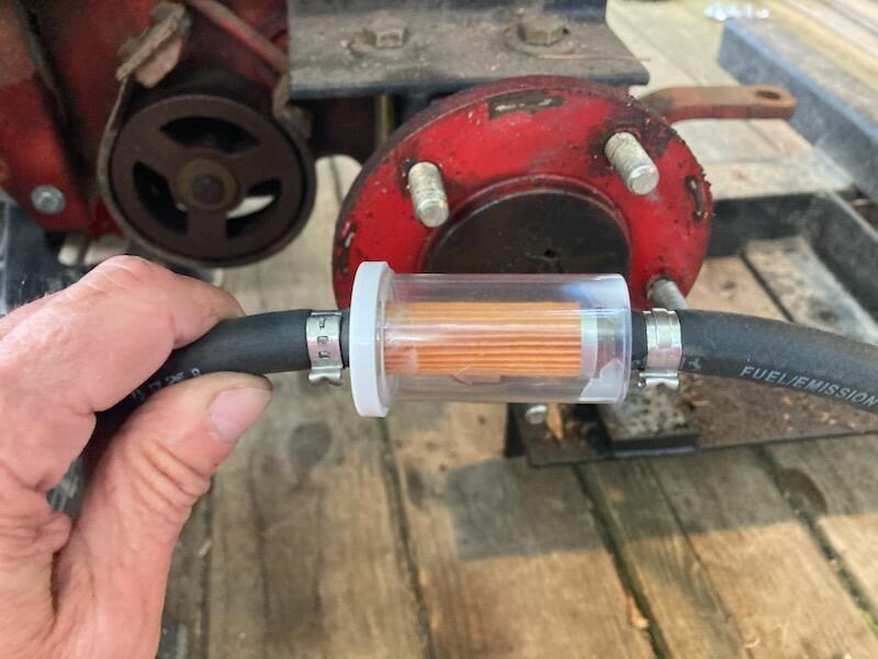

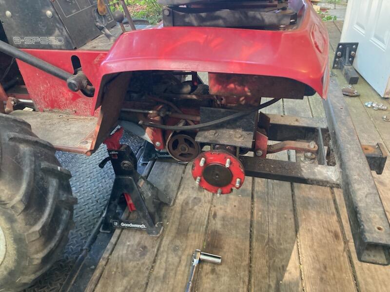

ineedanother 2,885 #25773 Posted April 22 Ordered axle seals for the 312-8 the other day and needed to check the outer bearings just to know what I'm up against. Pulled the rear weights and wheels, bearings are good. Flipped the tow receiver to get more ground clearance there and decided to go ahead and replace the fuel line while I had it up on jack stands. All is good. I'll replace the left seal when it gets here and this one will be back in service. Great machine, one of my favorites! 2 2 Share this post Link to post Share on other sites
