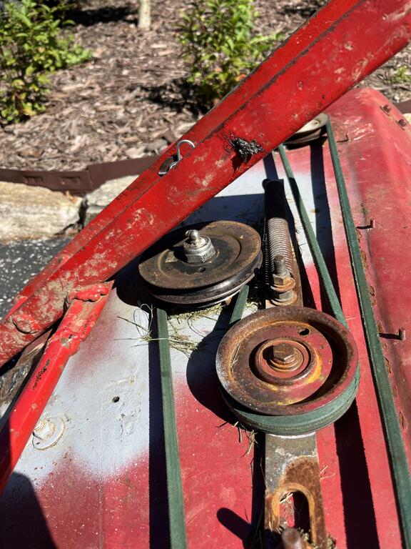

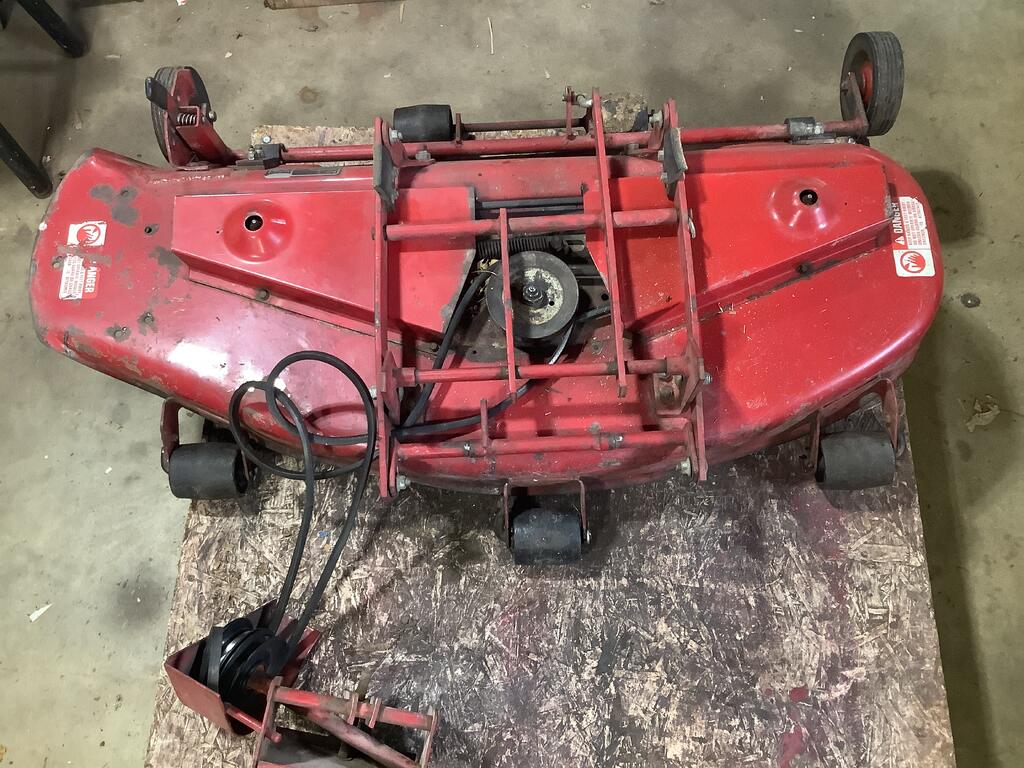

BrianKoch 370 #25503 Posted March 13 (edited) Gentlemen, Today I begin the process to repair my 42" side discharge mower deck for my '68 Charger 12 and could use some help from you all. The issue at hand is I cannot seem to keep the belt from slipping off the center pulley and I do not understand why. A few years back, I modified my Charger to run the deck from a mule drive and have ran the setup without a problem since. However, last season I needed to remove the center spindle assembly and chase the threads on it to better hold the blade retaining nut. Ever since that minor surgery, something is off and the belt slips every time. Based on my photo, does anyone see anything off with the geometry or anything else...(pic is of belt slipped off pulley for the umpteenth time). I'd like to try fixing before searching for another deck, but that's not off the table for me either if anyone has one. Thank you, Brian Edited March 13 by BrianKoch Share this post Link to post Share on other sites

Ed Kennell 47,255 #25505 Posted March 13 Is the belt tensioner working properly? The near bolt seems to be at the end of the slot. Could that broken spot in the upper pulley be catching the belt and throwing it off? I've used broken pulleys but always rounded off any sharp edges so the bels don't catch. 3 Share this post Link to post Share on other sites
Lee1977 7,764 #25506 Posted March 13 That rusty slide might be keeping the belt tightner from working proper., That type of deck should have plastic bushing on the bolts holding the slide. 2 Share this post Link to post Share on other sites
ineedanother 2,861 #25507 Posted March 13 7 hours ago, BrianKoch said: Gentlemen, Today I begin the process to repair my 42" side discharge mower deck for my '68 Charger 12 and could use some help from you all. The issue at hand is I cannot seem to keep the belt from slipping off the center pulley and I do not understand why. A few years back, I modified my Charger to run the deck from a mule drive and have ran the setup without a problem since. However, last season I needed to remove the center spindle assembly and chase the threads on it to better hold the blade retaining nut. Ever since that minor surgery, something is off and the belt slips every time. Based on my photo, does anyone see anything off with the geometry or anything else...(pic is of belt slipped off pulley for the umpteenth time). I'd like to try fixing before searching for another deck, but that's not off the table for me either if anyone has one. Thank you, Brian I would start by removing the belt and sliding the tensioner by hand to see if it slides smoothly and that the spring is applying even pressure. Then I would sight across the deck to make sure the idler pulley is on the same plan as the spindle pullies. If that all checks out and all of it turns freely, I would want to leave the guards off and watch it run to see if I could tell what the cause is. 2 Share this post Link to post Share on other sites
Lane Ranger 12,094 #25508 Posted March 13 (edited) I think your problem is in the metal slide that rides back snd forth! I have had this problem before! The oblong holes in the metal slide bar become wallowed out! You need a new or better used bar. I bought mine new from Toro as i had a good deck i wanted to preserve. That was about 8 years ago and i am still using that 48 inch deck with no belt issues! Replace the nylon busing also if they are worn! The lower hole in your photo shows a knotch that is a worn spot ! Edited March 13 by Lane Ranger 5 Share this post Link to post Share on other sites
WHX?? 58,053 #25509 Posted March 14 FYI @BrianKoch most of those parts mentioned above that may be worn are available from K & B horse parts. 1 3 Share this post Link to post Share on other sites
76c12091520h 4,284 #25510 Posted March 14 7 hours ago, WHX?? said: FYI @BrianKoch most of those parts mentioned above that may be worn are available from K & B horse parts. I have every single piece for that deck in stock 3 4 Share this post Link to post Share on other sites

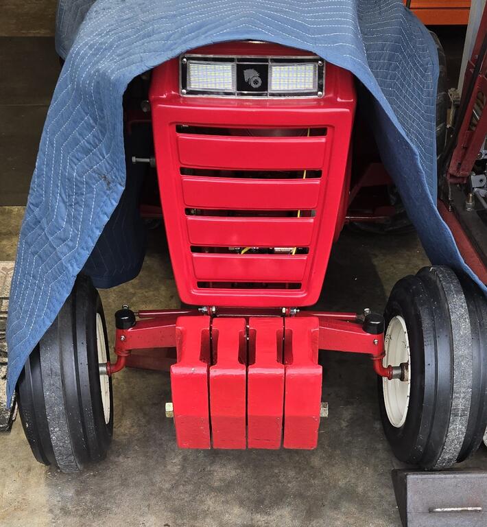

kpinnc 18,939 #25514 Posted March 15 (edited) Fixed my weight bracket and put the suitcase weights back on the Bronco 14. At least they are a bit straighter than before. Edited March 15 by kpinnc 1 17 Share this post Link to post Share on other sites
c-series don 12,421 #25515 Posted March 15 @kpinnc Every time I see that, I think how awesome that looks! 👍🏻 Where did you get those weights? They seem to be perfectly scaled to the tractor in weight, size and shape. 2 1 1 Share this post Link to post Share on other sites

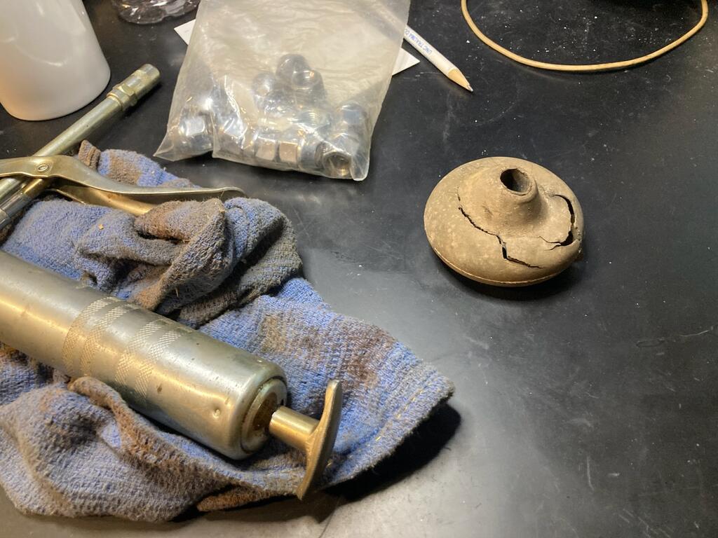

ineedanother 2,861 #25517 Posted March 15 Did some spring greasing and swapped some wheels and tires around to free up a set for a new project Found a cracked shifter boot on the c165 and replaced it with a new one I had on the shelf. It stays under cover but glad I got around to doing some routine maintenance and caught it. 10 2 Share this post Link to post Share on other sites
sqrlgtr 3,860 #25518 Posted March 16 @kpinnc I'm with @c-series don would like to know more about them weights. 1 Share this post Link to post Share on other sites
kpinnc 18,939 #25519 Posted March 16 4 hours ago, c-series don said: @kpinnc Every time I see that, I think how awesome that looks! 👍🏻 Where did you get those weights? They seem to be perfectly scaled to the tractor in weight, size and shape They were on Ebay about 25 years ago. I honestly don't remember who was selling them but I wish I had bought about 10 more. Funny story- this was back when USPS had the flat rate "if it fits it ships" thing going on. 3 different days they were supposed to be delivered, and 3 days I got a "undeliverable" door hangar. So I went to the post office with my feathers all ruffled, and demanded to know why they weren't delivered. ...Turned out the mailman was a very pregnant lady about 5 feet tall and 120lbs. The weights literally weighed more than she did. So when I finally pried my foot out of my mouth they brought 4 flat rate boxes out and gave them to me. Most embarrassing thing I've ever done with the post office at least, and I was apologizing for weeks when the little mail truck pulled up! 2 5 1 Share this post Link to post Share on other sites

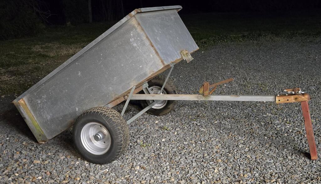

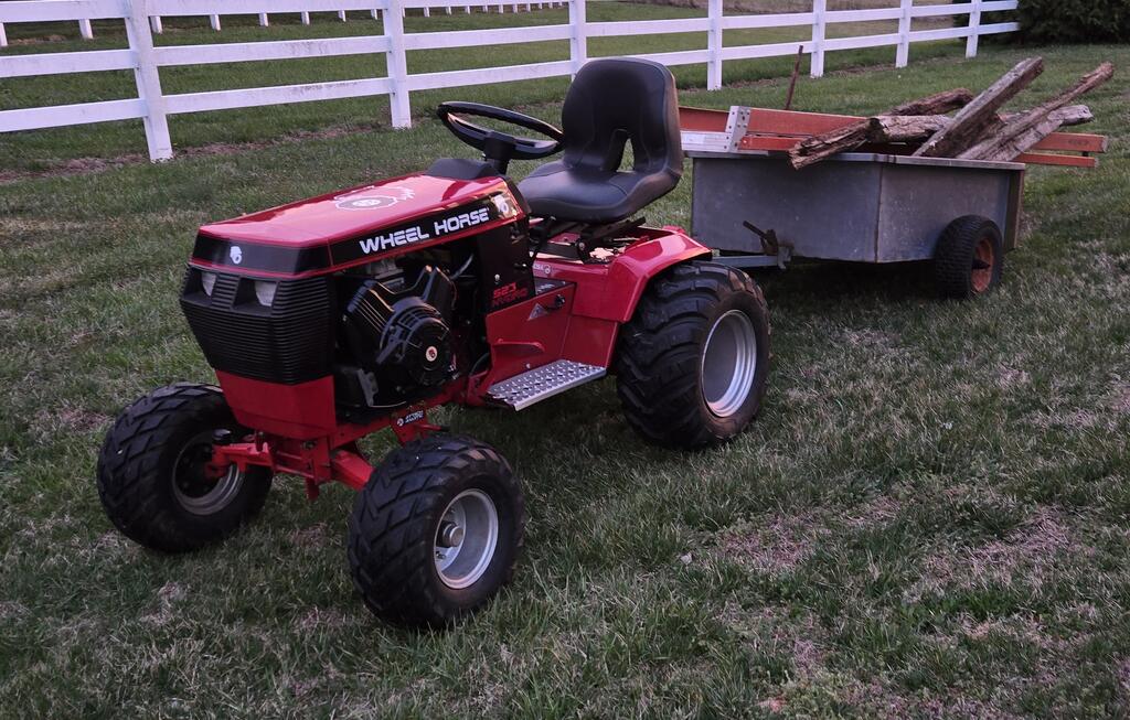

kpinnc 18,939 #25520 Posted March 18 (edited) Not "with" my Wheel Horse, but with some wheel horse parts... My poor old yard trailer needs some love. It's built like a tank, but when my buddy made it for me 20 years ago it had 20x10x8 tires on it, and they just finally fell apart. I had stuck some 8 inch wheels on it, but if it sat low before it nearly drug the ground after. The dump feature was also useless. So one thing about doing tire wheel mods with 520 front ends was that I had a decent set of wheels and tires from one that I could use. So I cut off the axles and welded on a 6 inch extension and bracing, and slapped the 520 wheels on. Not perfect, but it will work great with my heavy rear hitches now and it also will dump properly. It still needs a little cleanup, but full functionality has been restored! First pic is obviously the "before"... Edited March 18 by kpinnc 11 7 Share this post Link to post Share on other sites

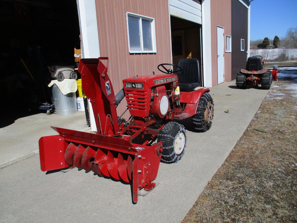

CRF857 926 #25524 Posted March 20 (edited) Removed the snow blade and chains from my C141. Didn’t use it one time this winter. Installed the mower deck, then mulched some leaves that blew in over the winter. Edited March 20 by CRF857 8 Share this post Link to post Share on other sites
