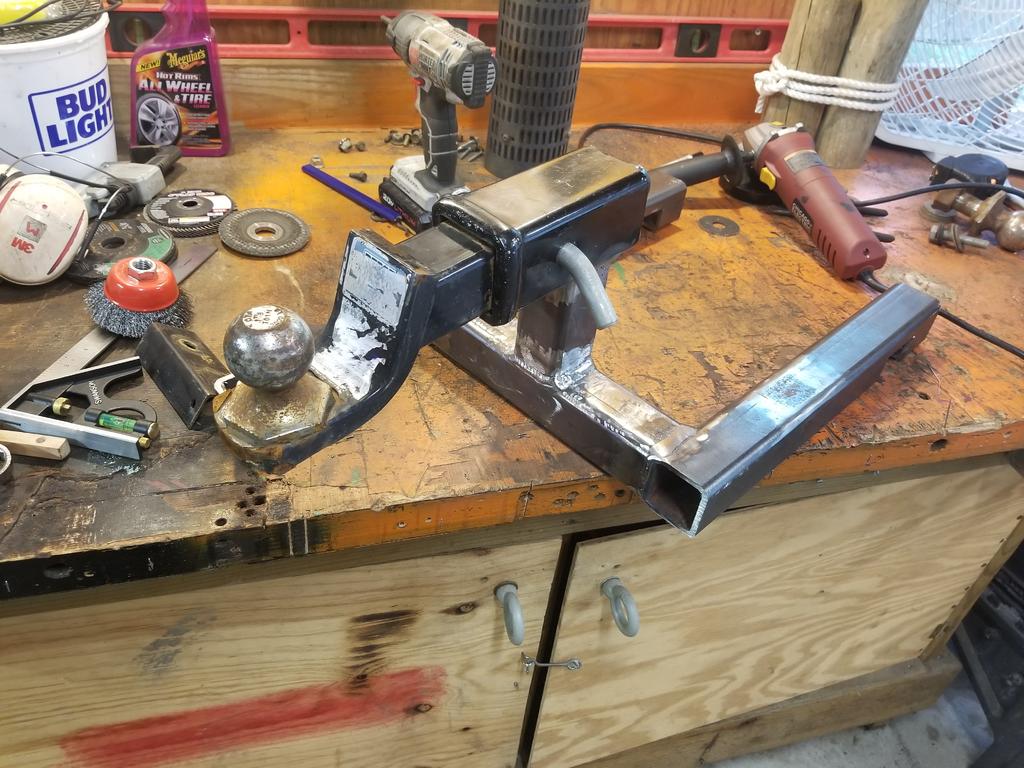

MIGHTYMO 50 #2506 Posted June 17, 2019 (edited) Well the drive belt snapped on my '96 314-8 so I ordered a new one and I oedered an aftermarket muffler so I can make a stack. Also all week I have been working on making a hitch with a 2" receiver. Finished that up on friday right before the belt snapped Edited June 17, 2019 by MIGHTYMO 3 1 Share this post Link to post Share on other sites

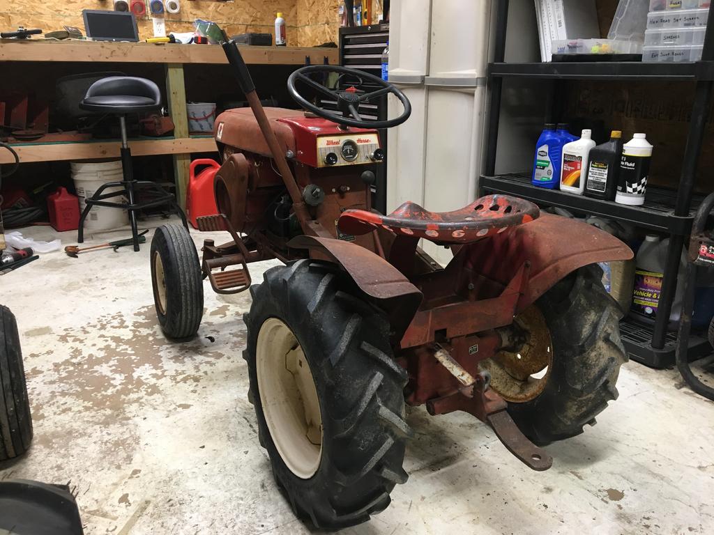

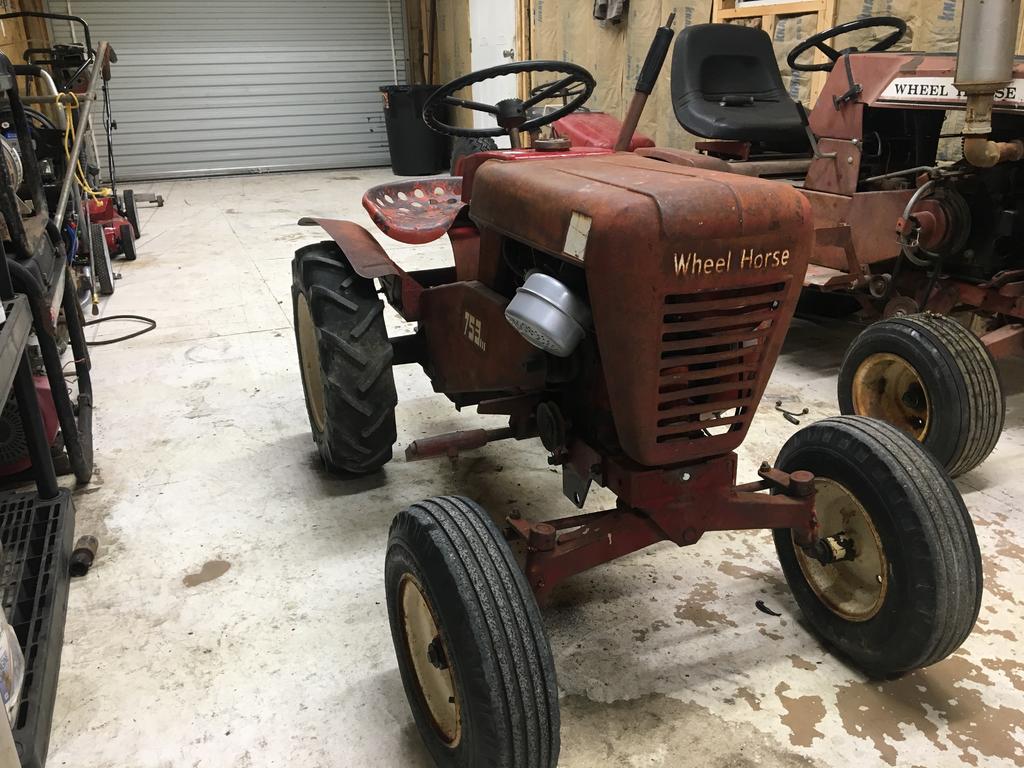

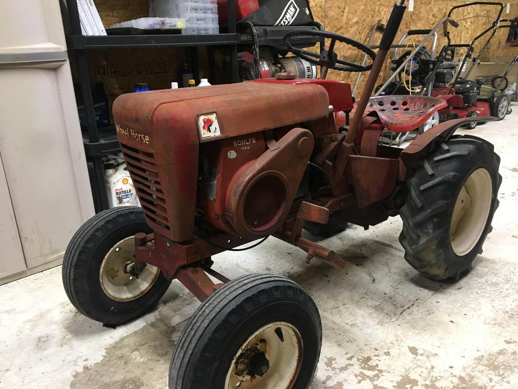

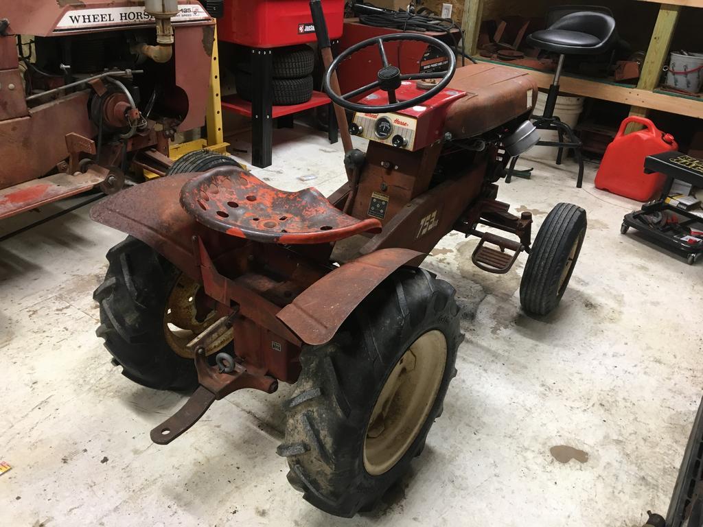

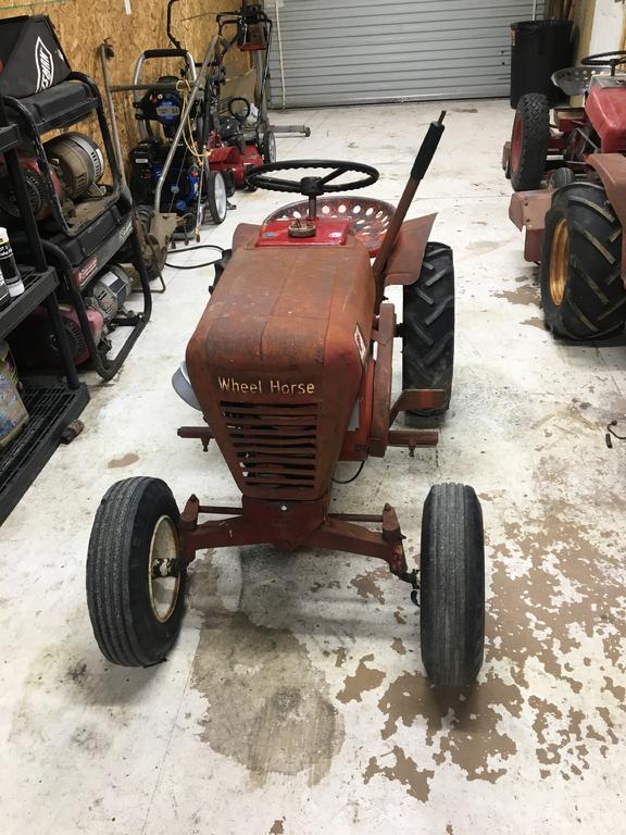

ClassicTractorProfessor 5,455 #2507 Posted June 17, 2019 Finally got the 753 put back together today and everything hooked back up. Bought a new battery for it today, and went ahead and picked up a new drive belt and muffler while I was at the store. Since buying this tractor a few weeks ago I have replaced the fuel tank, completely rewired it, new throttle and choke cables, and a few other odds and ends. Was hoping to be able to get it out and go for a ride this evening, but my ramps to get it out of the shop were over at a friends house, and got talked into staying for dinner when I went over there to get them. But I did run it back and forth in the shop a few times, and all the gears seem to work smoothly. 6 6 1 Share this post Link to post Share on other sites
ebinmaine 80,909 #2508 Posted June 17, 2019 7 hours ago, MIGHTYMO said: working on making a hitch with a 2" receiver Well done!! I'd like to see pics when it's mounted on the tractor if you can. 1 Share this post Link to post Share on other sites

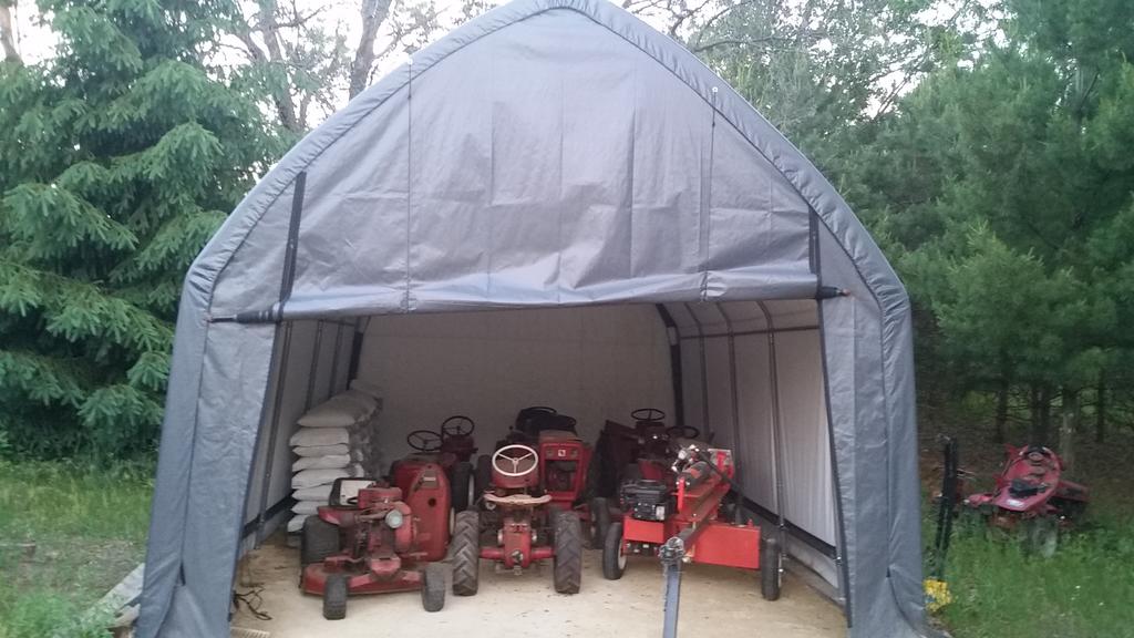

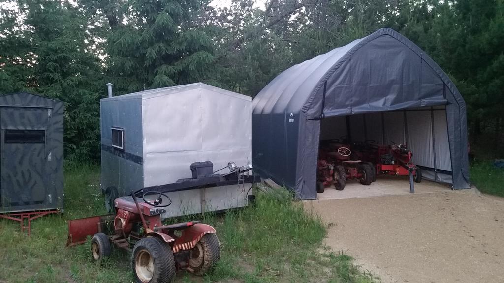

ebinmaine 80,909 #2509 Posted June 18, 2019 (edited) This evening we put a new battery in Trina's first tractor. The 657 known as Pony. This is the one we did the full restoration on last year and it has the 8 horse Briggs engine in it. I replaced the positive cable with a better one and cleaned up a couple terminals and Trina added some felt for spacing in the battery tray. We haven't moved this tractor under its own power for seven or eight months. Put gas in. Set the choke. It turned over maybe two or three times? Started right up. It now lives in the portable garage/stable with the other Wheelhorses. Edited June 18, 2019 by ebinmaine Added pics 7 5 1 Share this post Link to post Share on other sites

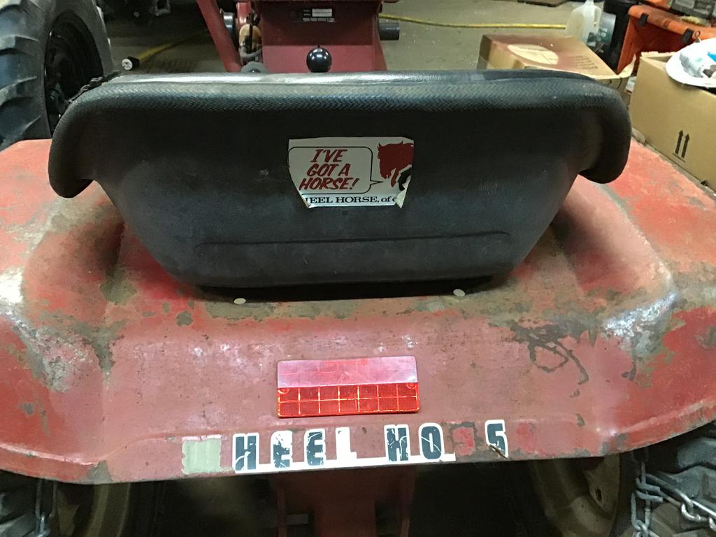

CountryRock 199 #2510 Posted June 18, 2019 Worked on the fender pan for the GT2500 today. Sanded, spot puttied and another couple coats of primer. Just need to do a quick wet sand on it, sand the under side and put some color on it. Don't need to be perfect. Also drained the transmission oil and did a flush with diesel fuel. Letting it sit overnight with diesel fuel in it, gonna drain it and fill with fresh oil tomorrow. 2 1 Share this post Link to post Share on other sites
Herder 2,356 #2511 Posted June 18, 2019 19 minutes ago, ebinmaine said: This evening we put a new battery in Trina's first tractor. The 657 known as Pony. This is the one we did the full restoration on last year and it has the 8 horse Briggs engine in it. I replaced the positive cable with a better one and cleaned up a couple terminals and Trina added some felt for spacing in the battery tray. We haven't moved this tractor under its own power for seven or eight months. Put gas in. Set the choke. It turned over maybe two or three times? Started right up. It now lives in the portable garage/stable with the other Wheelhorses. you would be surprised by how much stuff you can jam into a garage in a box. 3 Share this post Link to post Share on other sites
AMC RULES 37,260 #2512 Posted June 18, 2019 Wondering what kind of snow load they can handle? 1 Share this post Link to post Share on other sites
formariz 12,381 #2513 Posted June 18, 2019 5 minutes ago, AMC RULES said: Wondering what kind of snow load they can handle? That you have to worry about. Last year I neglected to clean snow off mine and sure enough it bent ridge and collapsed. Probably it would be a good idea to put additional supports length wise above "rafters" to prevent tarp from sagging and collecting snow. 1 Share this post Link to post Share on other sites
ebinmaine 80,909 #2514 Posted June 18, 2019 4 minutes ago, AMC RULES said: Wondering what kind of snow load they can handle? We're going to aim for none. We'll be keeping the roof clear. That said.... We're going to add some reinforcement for the times we're away from home While it's snowing. In a heavy storm it could easily snow 15 inches or more during the day. Also will be adding a few pieces of plywood or advantec to the bottom edges. 1 Share this post Link to post Share on other sites
ebinmaine 80,909 #2515 Posted June 18, 2019 26 minutes ago, Herder said: you would be surprised by how much stuff you can jam into a garage in a box. This'll be about it ........... for now. Except for the 2 trailers. We REALLY want to keep it as a drive through building. 1 Share this post Link to post Share on other sites
WHX?? 58,302 #2516 Posted June 18, 2019 29 minutes ago, AMC RULES said: Wondering what kind of snow load they can handle? Mine has no snow load ... alpine roof they call it..I had ten tractors in it over winter BUT the moisture buildup was devastating. No air movement.. Some suffer some extra patina but not where required. Carbs turned dang near white. I left a little opening so the cats could get in and keep the mice at bay. Door stays open now in the summer as it gets hot in ther. 3 Share this post Link to post Share on other sites
WHX?? 58,302 #2517 Posted June 18, 2019 1 hour ago, CountryRock said: Worked on the fender pan for the GT2500 today. Sanded, spot puttied and another couple coats of primer. Just need to do a quick wet sand on it, sand the under side and put some color on it. Don't need to be perfect. Also drained the transmission oil and did a flush with diesel fuel. Letting it sit overnight with diesel fuel in it, gonna drain it and fill with fresh oil tomorrow. We gotta set up you a go fund me site for a new seat??? 3 Share this post Link to post Share on other sites

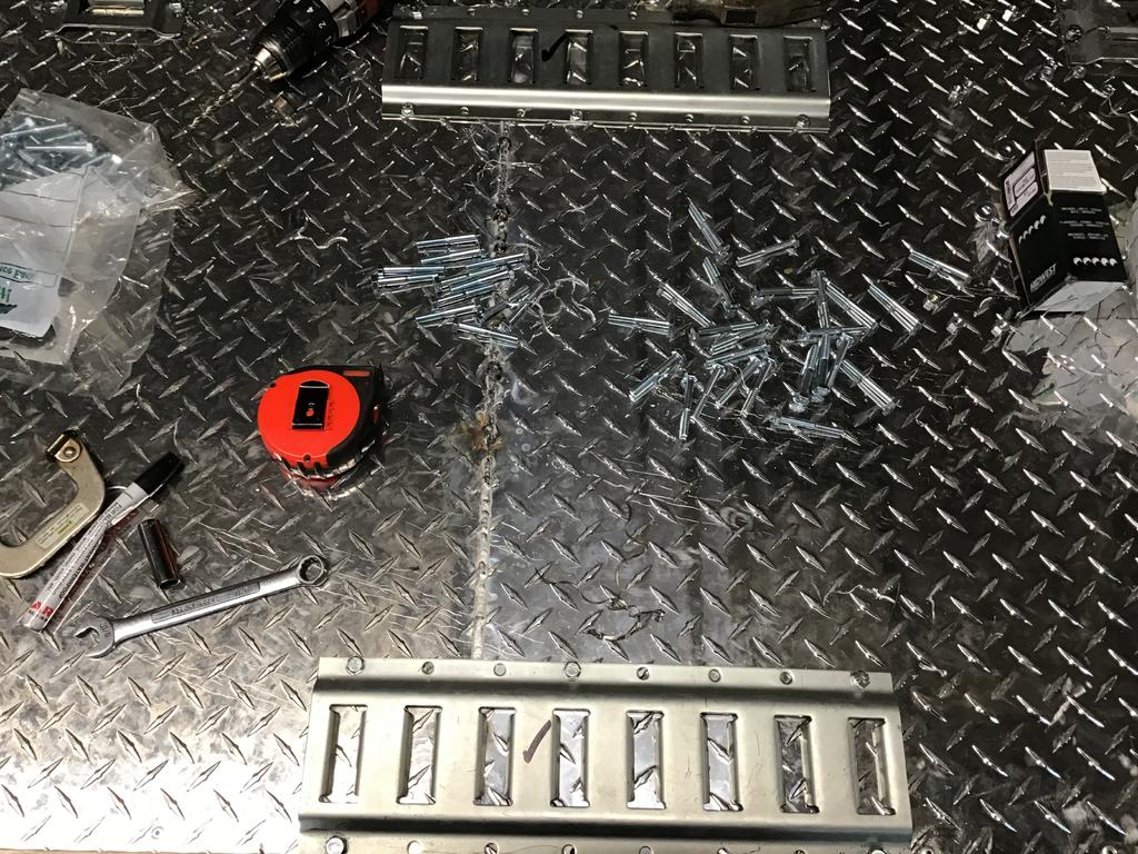

Pullstart 71,359 #2518 Posted June 18, 2019 Still just chimpin’ at the bit to finish the hauler. My wife mentioned leaving tomorrow night to get some miles under us with the big load. Big Show 2019 Here We Come! Only two more bits of E-Track need to be checked off as done! 3 Share this post Link to post Share on other sites
CountryRock 199 #2519 Posted June 18, 2019 (edited) 10 minutes ago, WHX24 said: We gotta set up you a go fund me site for a new seat??? Lol, no, that's just temporary. Gonna grab a new one from northern tool pretty soon. Edited June 18, 2019 by CountryRock 1 Share this post Link to post Share on other sites

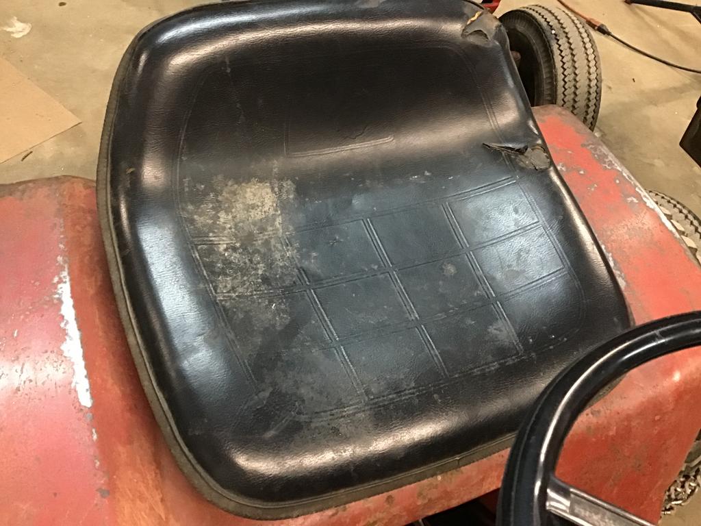

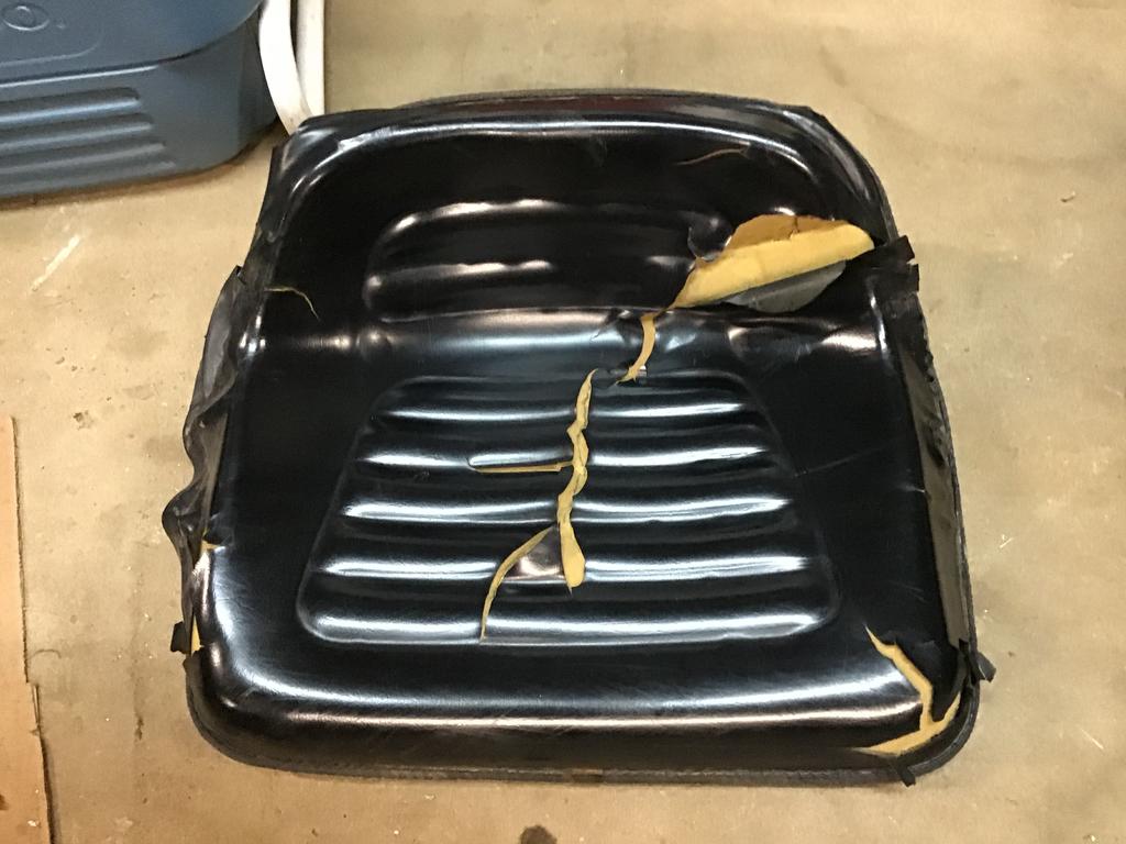

Pullstart 71,359 #2521 Posted June 18, 2019 Rylee’s “Screamin’ Jimmy was in dire need of a better seat. This one I believe came on the Charger 12 that became Frank. I swapped it out and made her smile before bed time. Those girls are so excited to make it to the show! 4 Share this post Link to post Share on other sites

ebinmaine 80,909 #2523 Posted June 18, 2019 6 hours ago, WHX24 said: moisture buildup Do you have a floor barrier? Tarp. Plastic. Etc... Share this post Link to post Share on other sites
pfrederi 21,217 #2524 Posted June 18, 2019 9 hours ago, Herder said: you would be surprised by how much stuff you can jam into a garage in a box. 10 hours ago, ebinmaine said: This evening we put a new battery in Trina's first tractor. The 657 known as Pony. This is the one we did the full restoration on last year and it has the 8 horse Briggs engine in it. I replaced the positive cable with a better one and cleaned up a couple terminals and Trina added some felt for spacing in the battery tray. We haven't moved this tractor under its own power for seven or eight months. Put gas in. Set the choke. It turned over maybe two or three times? Started right up. It now lives in the portable garage/stable with the other Wheelhorses. Eric: You may want to reconsider the felt and use rubber or something. Felt absorbs moisture (especially in unheated storage) and holds it against the metal... Share this post Link to post Share on other sites
ebinmaine 80,909 #2525 Posted June 18, 2019 @pfrederi Good advice there. Thank you. We used it only because that was what was handy. I'll see what we can find for little sheets of rubber. Share this post Link to post Share on other sites
