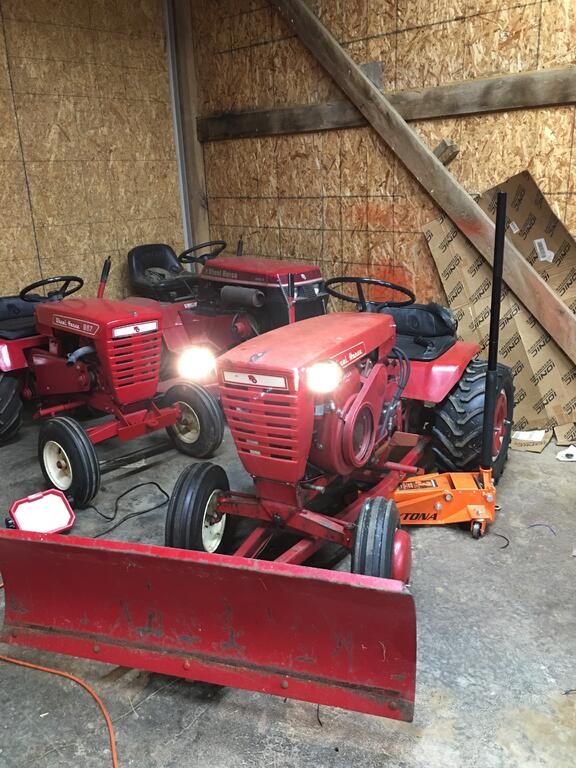

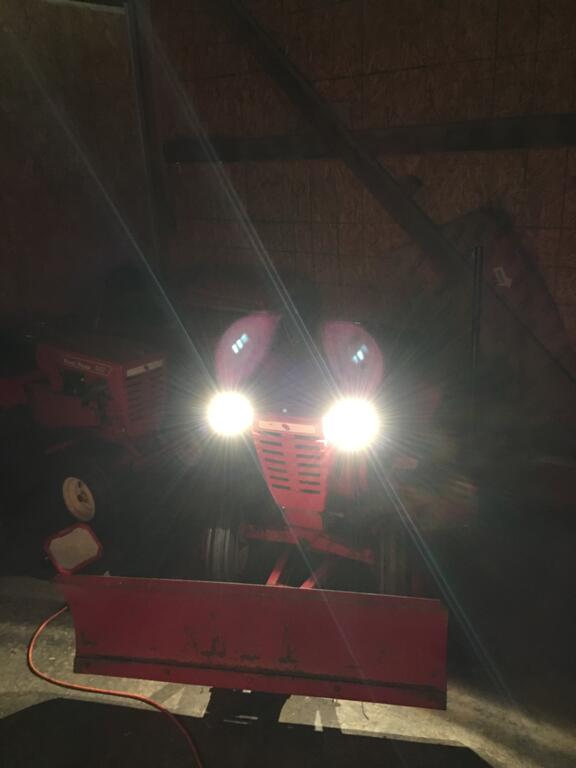

sqrlgtr 3,860 #25201 Posted December 31, 2025 Put juice to my new headlights on 1257 today. Halogen bulbs and pretty bright, 2nd pic is in shop and pitch dark. Dont remember what the watts are. Thought about going with led bulbs but IDK if it would be worth the extra coin. 9 1 Share this post Link to post Share on other sites
kpinnc 18,939 #25202 Posted December 31, 2025 54 minutes ago, sqrlgtr said: Thought about going with led bulbs but IDK if it would be worth the extra coin. I'm a huge fan of LEDs. That being said, so long as the regular bulbs don't over tax your charging system- I'd just use them as they are. They look plenty bright enough. 4 Share this post Link to post Share on other sites

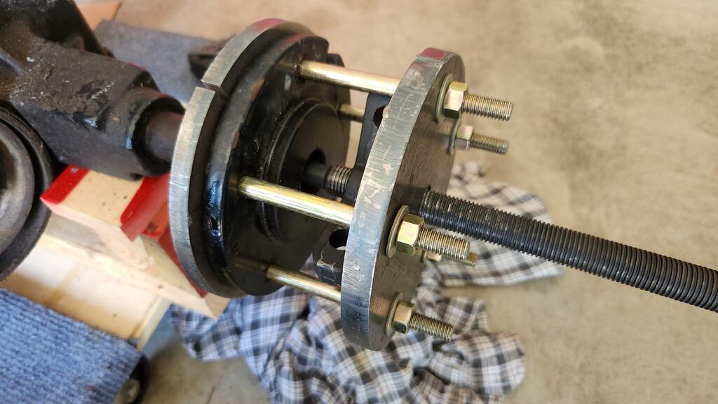

Racinbob 13,134 #25205 Posted January 1 4 hours ago, Blue Chips said: Yeah, I think that redoing it from scratch is the way to go, since adding a spacer might make the puller plate too thick to use with a hub that has been converted to studs, unless I cut some countersinks. I'm up to my elbows with projects at the moment, but if I find some breathing room I'll see if I can crank one out some evening. Thanks for your input. This is what I did. Larger diameter plates with the five bolts to the outside of the hub would let it work with studs but just back them out if you need to remove the hub. I've got another blank plate to make a backer that can fit behind the entire hub but I haven't needed that so it's not drilled out. I will if the need arises or I just feel like it. Sometimes there isn’t the clearance between the hub and tranny case. 7 Share this post Link to post Share on other sites

Racinbob 13,134 #25208 Posted January 1 1 hour ago, ebinmaine said: Is that a 1 1/8 center? Something you made? That backer plate has a 3" hole so it can butt up to the hub flange. I would probably go 1 3/16" on the plate to go around the axle. The plates are a pretty mild steel and I drilled/cut the holes with a quality hole saw and bits. Lots of go-juice to help. 3 & 4 speeds and all hydros were tight to the case. 6 & 8 speeds have room. Unless the hub has been pushed back tight. I've had a couple like that. 1 1 Share this post Link to post Share on other sites

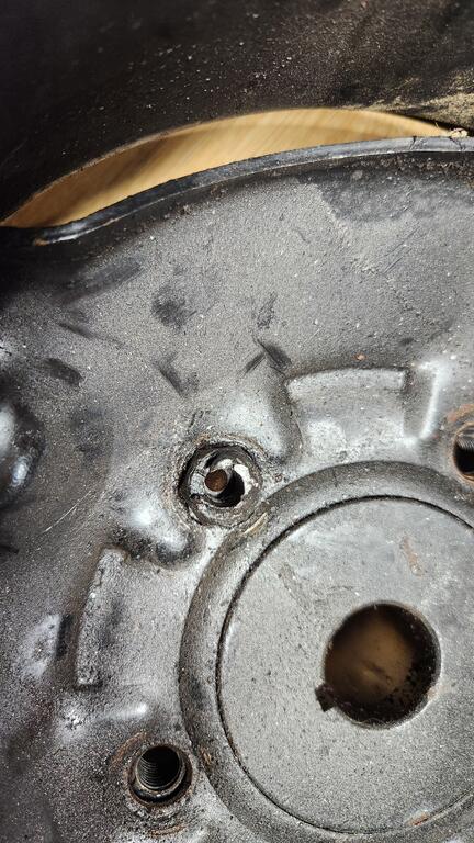

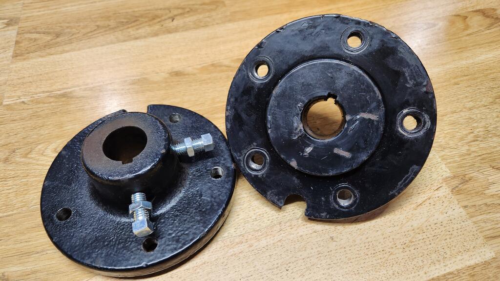

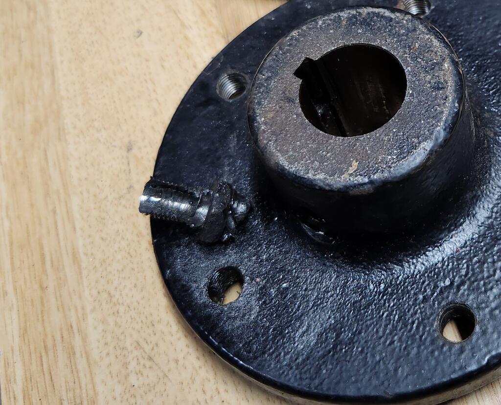

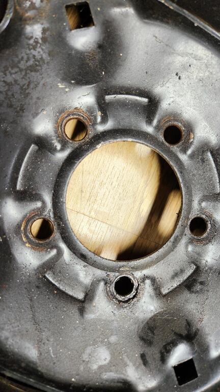

Racinbob 13,134 #25209 Posted January 1 This is a good spot for this. You may remember me struggling to get a lug bolt out of a wheel a while back. It was a regular 7/16" bolt apparently driven in with an impact wrench WAAAAAY too tight. It was from a 68 Raider 9 that I have parted out. I tried everything up to welding a nut on it that was my last attempt at failing before I just set it aside to regain some form of sanity. Even though I doubt that I will be needing them I try real hard to save wheels that have the correct setback for Wheel Horses. They are a bit of an oddball. The same goes for saving hubs. These especially as they are the heavy hubs with factory double setscrews. Over the weeks of it just sitting in the garage I decided that the hubs were more important if I couldn't save both. I already had the bolt drilled out to something under 3/8". This morning I went ahead and drilled it to 3/8" which was as far as I wanted with hoped of not damaging the threads. It looked like this. I set it on 4x4's and smacked the hub opposite of the stuck bolt. It actually didn't take much. It snapped off clean and the culprit came right out. The hub threads didn't look bad at all. I chased them all with a 7/16" tap and a 3/8" for the setscrews and these hubs are in dandy shape! An added bonus is that the wheel is fine as well. You can see where the jammed bolt was but it's not harmed. Bottom hole. My only New Years resolution is to never make resolutions. But I'd say this is a good start. Happy New Years! 6 7 Share this post Link to post Share on other sites
sqrlgtr 3,860 #25210 Posted January 1 25 minutes ago, Racinbob said: I set it on 4x4's and smacked the hub opposite of the stuck bolt. It actually didn't take much. It snapped off clean and the culprit came right out. Are you saying you drove it out from the hub backside or? Share this post Link to post Share on other sites
Racinbob 13,134 #25211 Posted January 1 (edited) 8 minutes ago, sqrlgtr said: Are you saying you drove it out from the hub backside or? From the front forcing the hub back. Hitting opposite to the stuck lug had quite a bit of leverage on the bolt and with it drilled out there wasn't much left to fight me. It just snapped. Edited January 1 by Racinbob 2 1 Share this post Link to post Share on other sites

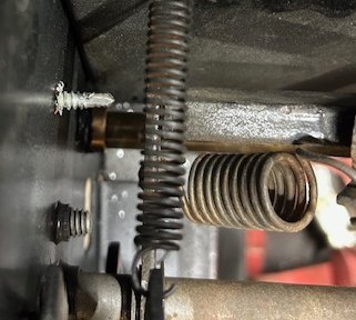

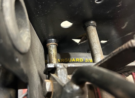

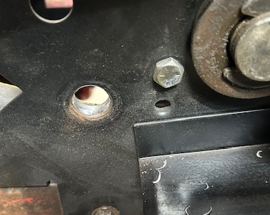

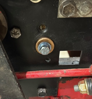

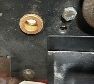

JoeM 10,246 #25213 Posted January 1 Put some bushing in a hydro belt take up. The old ones were shot. Got some bunting flange bearings at Amazon. reamed out the hole with a 5/8 drill, but started in straight with a step drill first. Worked okay was trying to keep it simple. I did add a keeper bolt threaded in the end to keep it all together due to eliminating the e clips on the shaft to accept the thicker flange bearings. Bearing were $3 and change each. 7 7 Share this post Link to post Share on other sites

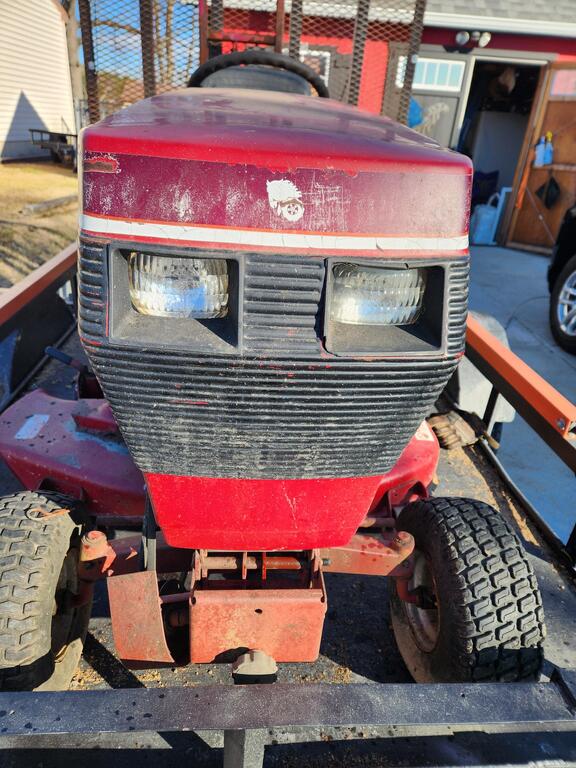

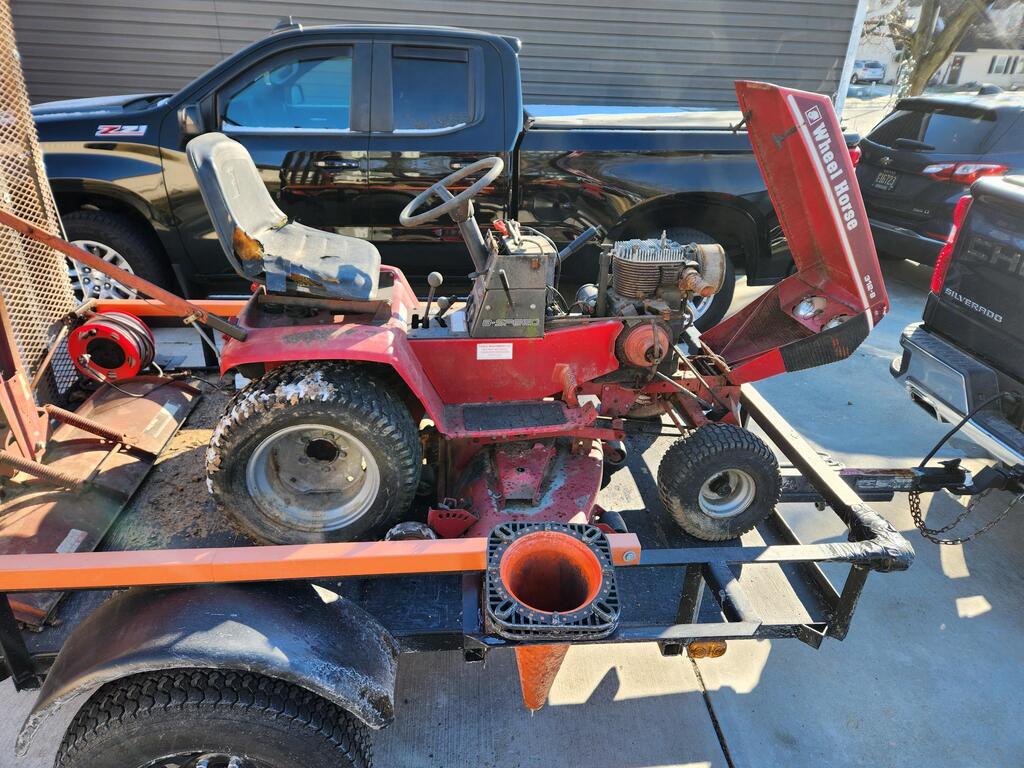

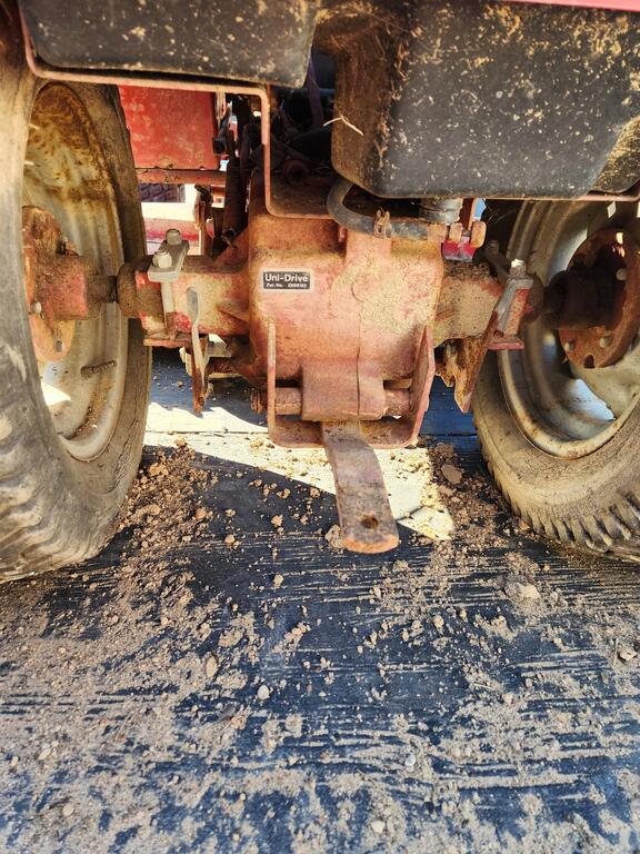

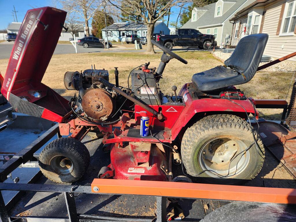

CD Long Jr 203 #25214 Posted January 1 Bought one, 1992 312-8 with deck and front blade. Engine needs work. 5 1 Share this post Link to post Share on other sites

kpinnc 18,939 #25217 Posted January 1 30 minutes ago, CD Long Jr said: Bought one, 1992 312-8 with deck and front blade. Engine needs work. That Magnum 12 is definitely worth getting back running. And a 312-8 is an awesome "middle of the road" tractor. It can run a 48 inch deck, a rear tiller, and a snow blower with ease. Very solid machines! 2 1 Share this post Link to post Share on other sites
peter lena 10,046 #25218 Posted January 1 @JoeM thats what i,m talking about ! its like people dent even think about bushings / bearings , often say , make the rust run out ! like red aerosol spray tube lube , to get into areas , also have been a fan of SUPER LUBE , HYDRAULIC OIL / GREASE , incredible temp range . how dare you take care of a neglected area ! just kidding , do that all the time , just got in from plowing , with my graphite sprayed blade , ridiculous angular slide off , another experiment , on my heavily improved plow blade frame , did that years ago , heim joints , steering quadrant , lever detailing , for smooth easy , blade swing . your improvement area , is what you want to get after , like a REPEDITIVE PROBLEM ? take it apart and kill it ! very common to find problem , a functional stage issue , a collection of neglect . good job , keep in touch , pete 4 Share this post Link to post Share on other sites
peter lena 10,046 #25219 Posted January 1 @CD Long Jr welcome ! what's goin on ? status of any / all issues ? what kind of work area do you have ,? makes a world of difference , a closed shop heat / light , lots of baseline areas , what's your mechanical background ? let us know we can give you a hand . pete 1 Share this post Link to post Share on other sites
CD Long Jr 203 #25220 Posted January 1 Thank you all for your replies. I have a packed shed with propane heater & lights. I can move my snowblower & Cub Cadet out to work on the Wheel Horse. I can work in the cold when I have to. I;m retired but my career was in Industrial Services. I was outside. My current issue is getting the correct ignition module. The engine shroud was not on the tractor & I'm seeing 2 modules for the 1992 M12. The PTO issue has been resolved, I hope. Engine has to be running to engage the PTO at idle. Have to free up the choke cable & get ignition keys. 1 Share this post Link to post Share on other sites
peter lena 10,046 #25221 Posted January 1 @CD Long Jr worked at PFIZER 30 yr as a maintenance millwright , some chassis / model # ,s on the underseat area , probably steer you in the right direction , for now a good penetrant soaking and attempt to move , that choke cable , unhook it so its a vertical drop down soaking / creep . engine has to be running to engage / drive clutch on pto set up , lots of small enhancements makes that set up work with ease . think you will fit right into this groupe , pete Share this post Link to post Share on other sites
peter lena 10,046 #25222 Posted January 1 @CD Long Jr worked at PFIZER 30 yr as a maintenance millwright , some chassis / model # ,s on the underseat area , probably steer you in the right direction , for now a good penetrant soaking and attempt to move , that choke cable , unhook it so its a vertical drop down soaking / creep . engine has to be running to engage / drive clutch on pto set up , lots of small enhancements makes that set up work with ease . think you will fit right into this groupe , https://www.google.com/search?q=1992+wheel+horse+ignition+module+%2C+12+hp&rlz=1C1CHBF_enUS866US866&oq=1992+wheel+horse+ignition+module+%2C+12+hp+&gs_lcrp=EgZjaHJvbWUyBggAEEUYOTIHCAEQIRigATIHCAIQIRigATIHCAMQIRigATIHCAQQIRigATIHCAUQIRigATIHCAYQIRirAjIHCAcQIRirAtIBCTI0NDg3ajBqNKgCAbACAfEFFT2vAQlK13M&sourceid=chrome&ie=UTF-8 pete 1 Share this post Link to post Share on other sites

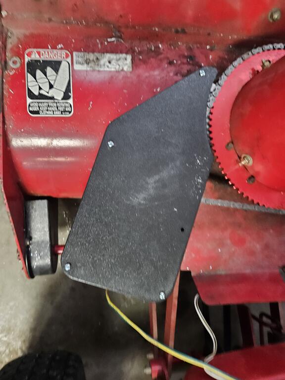

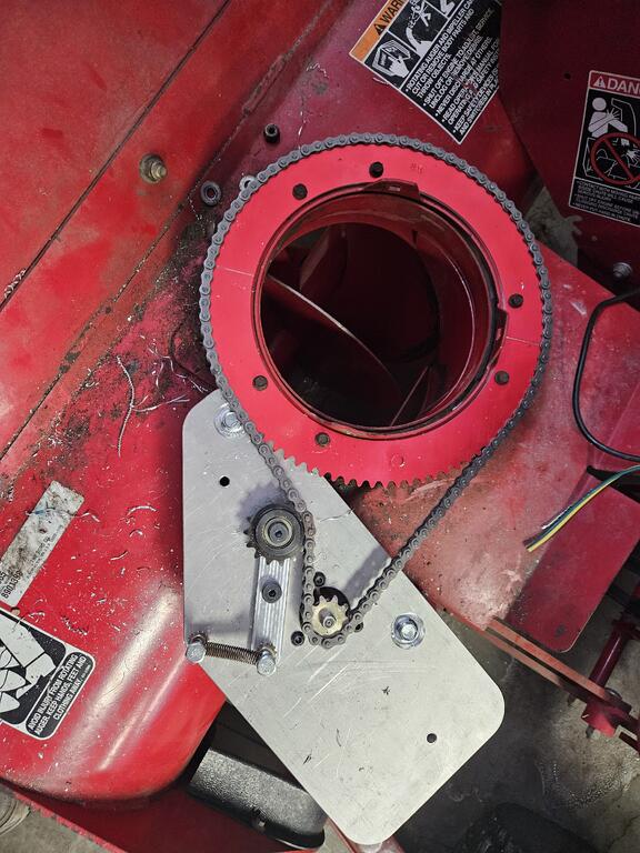

Shynon 7,676 #25223 Posted January 2 Changed out the powered worm gear snowblower chute with a powered chain drive. 5 12 Share this post Link to post Share on other sites

peter lena 10,046 #25225 Posted January 2 @Shynon awesome ! thats what i,m talking about ! sure you have already done a detail functional check out , NAPA has MAC,S chain / cable lube , for that chain set up . makes / keeps chains moving like they should , also hit that chain , idler pulley , bearings fail regularly , oil slick is better than rust . maybe CABLE WRAP for that , wiring set up ? , try a lot of experiments , look for any issues now , no sarcasm intended . make it seamless , good job , pete 2 Share this post Link to post Share on other sites
