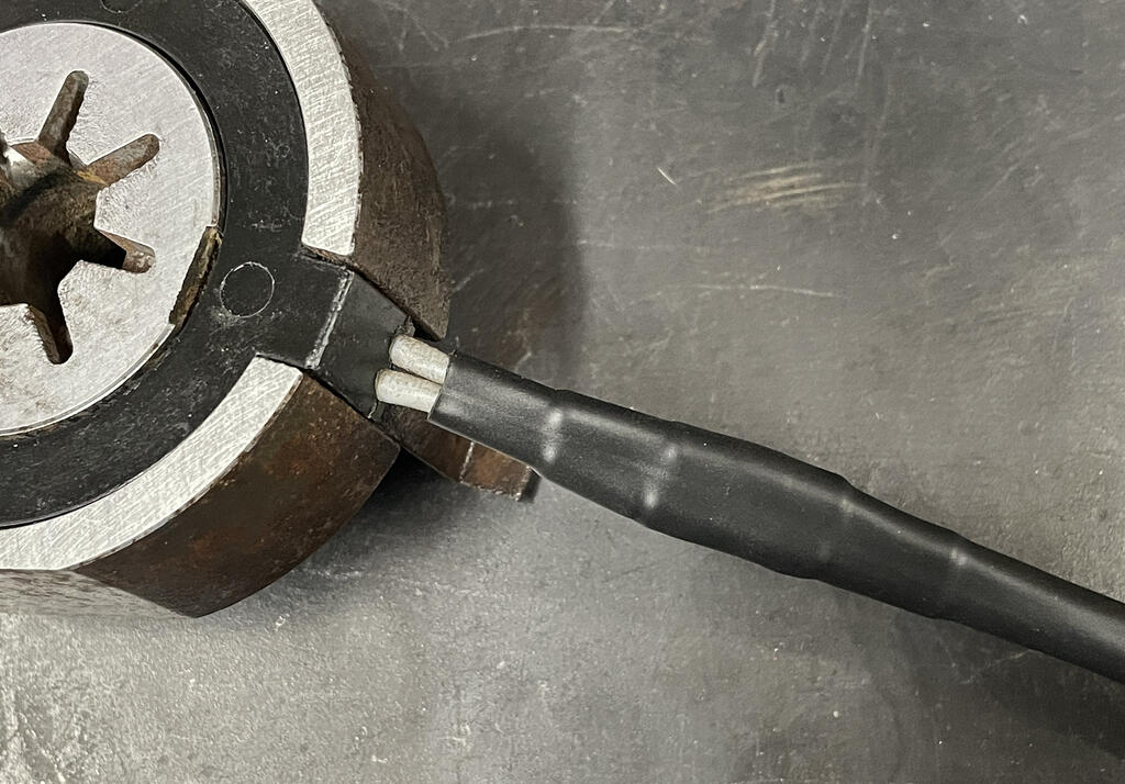

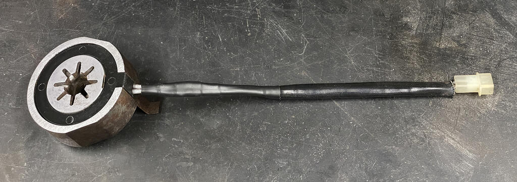

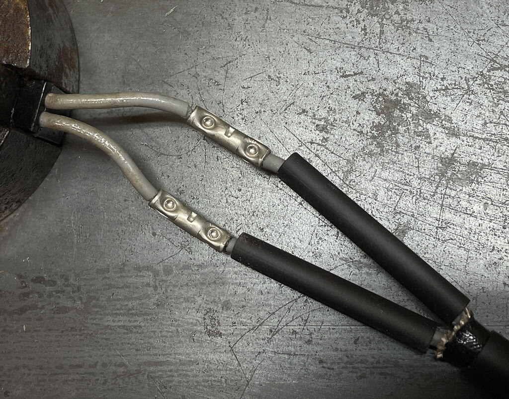

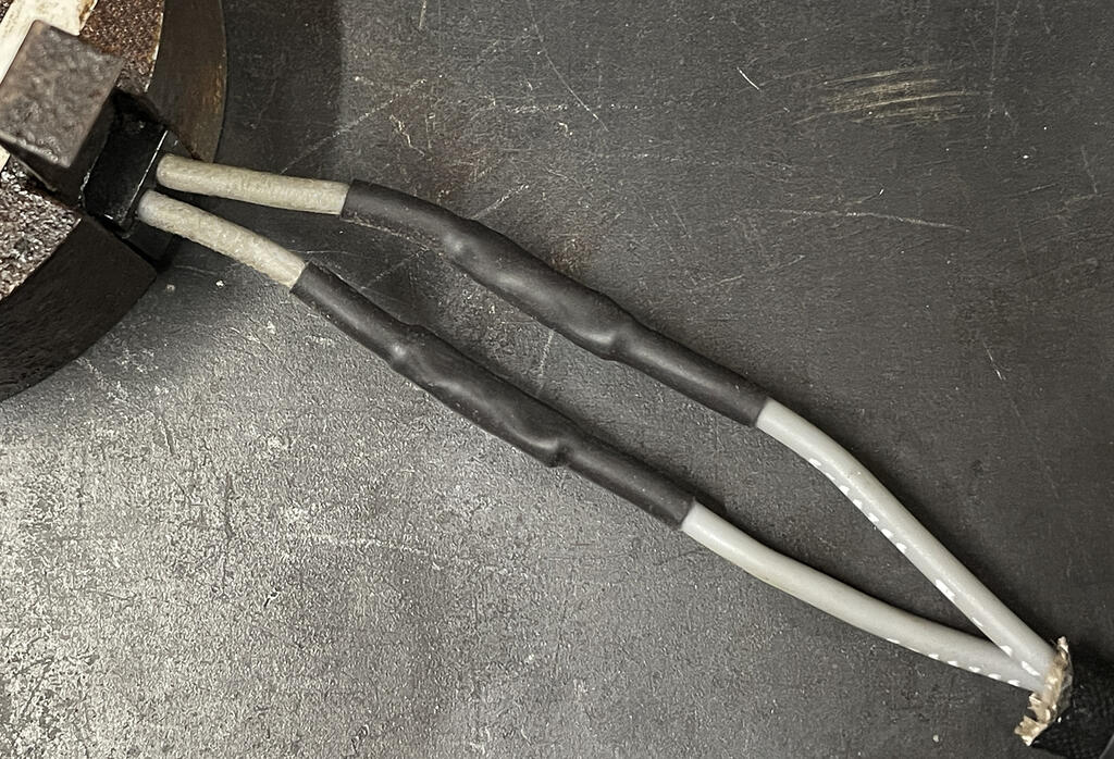

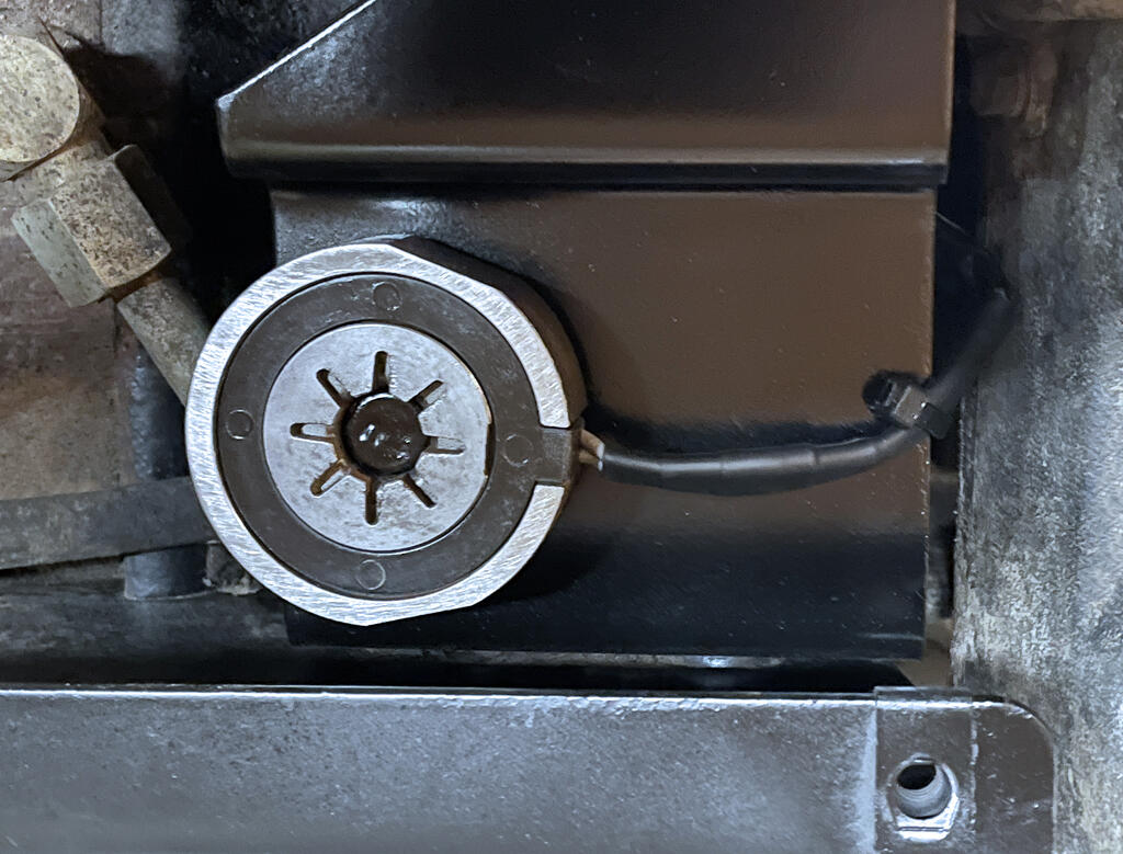

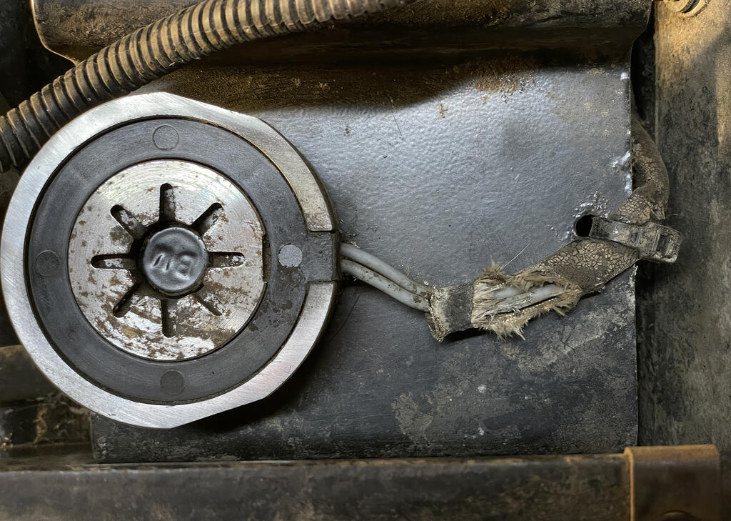

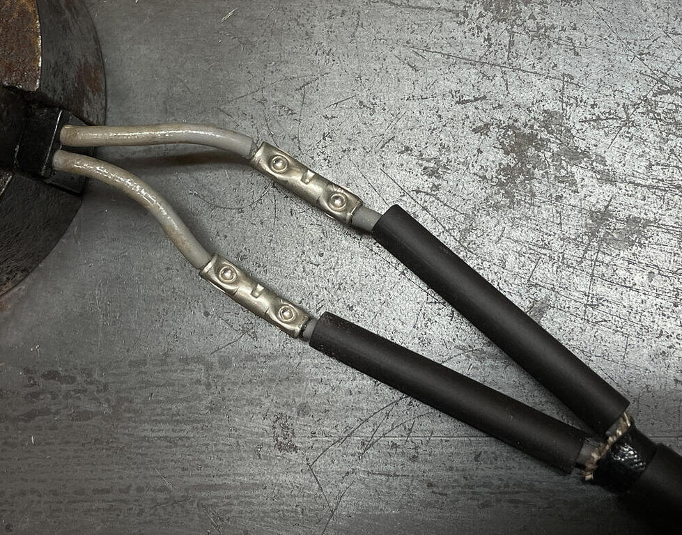

Blue Chips 854 #25183 Posted December 30, 2025 (edited) The leads going to the cruise control electromagnet on my 522xi showed definite signs of having served as a meal or nesting material for a mouse or some small furry critter. All but one or two strands of the wire were chewed through: Not a difficult repair job. Cut/strip/crimp: First layer of heat-shrink tubing: Second layer of heat-shrink tubing: Wires fixed. I managed to clean and save most of the original outer jacket/loom: Electromagnet reinstalled: Rounded up the usual suspects, but had to let this one go for lack of evidence: Edited December 30, 2025 by Blue Chips 2 4 12 Share this post Link to post Share on other sites

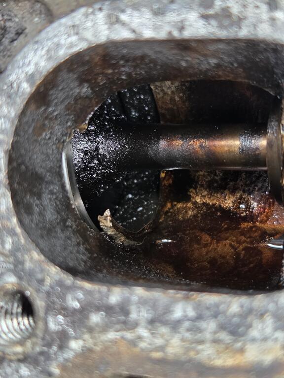

Red Stallion 231 #25184 Posted December 30, 2025 Tried to stayed optimistic... that's the outcome of today. 5 Share this post Link to post Share on other sites
Bill D 3,139 #25185 Posted December 30, 2025 1 hour ago, Red Stallion said: Tried to stayed optimistic... that's the outcome of today. Is there an automotive machine shop nearby? Oversized valve seats are available. The block can be welded and machined for a new valve seat. @lynnmor may have some ideas. If repair is not an option look for a good P216. They generally have less problems and you probably won't miss the 4 HP. 2 Share this post Link to post Share on other sites

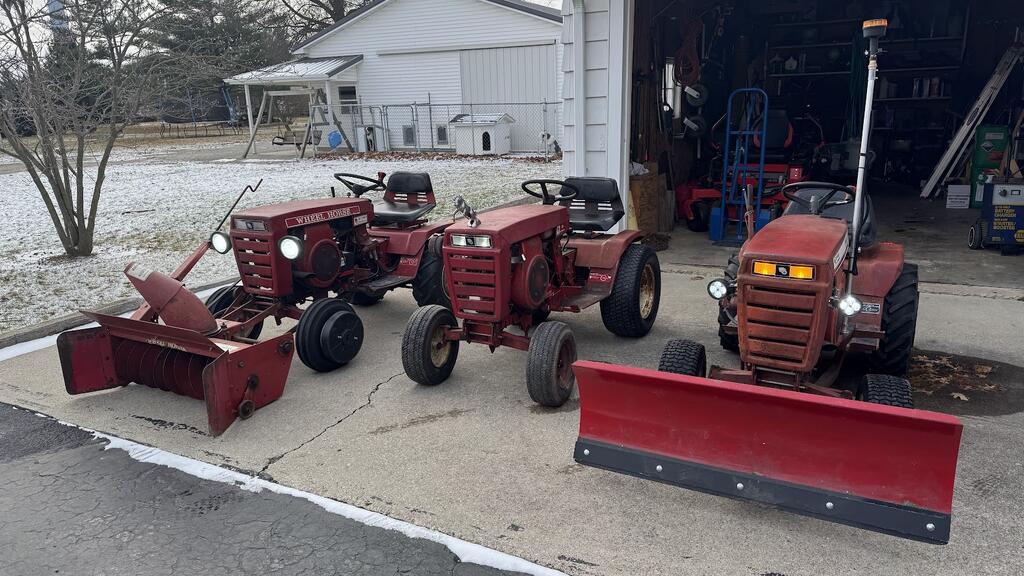

Bar Nuthin 3,157 #25186 Posted December 30, 2025 Rearranged my horses in the garage in order of likelihood of them seeing use. Mounted a set of tri-ribs for the C-141 and stole the front weights off the C-120 and put on it. Moved Johnny over to the cold side of the garage until I get some hydraulic lines for the lift. First time all 3 tractors have been up and going at the same time! 3 8 Share this post Link to post Share on other sites
sqrlgtr 3,860 #25187 Posted December 30, 2025 (edited) 47 minutes ago, Bar Nuthin said: Rearranged my horses in the garage in order of likelihood of them seeing use. Mounted a set of tri-ribs for the C-141 and stole the front weights off the C-120 and put on it. Moved Johnny over to the cold side of the garage until I get some hydraulic lines for the lift. First time all 3 tractors have been up and going at the same time! Who is wearing the snow plow and what size is it, 48 or ? and has it got a plastic cutting edge? Inquiring minds want to know. Edited December 30, 2025 by sqrlgtr Share this post Link to post Share on other sites
lynnmor 9,037 #25188 Posted December 30, 2025 (edited) 14 hours ago, Red Stallion said: Tried to stayed optimistic... that's the outcome of today. OUCH! Remove the valve and seat then take some more photos. Maybe we can offer better advice. Often a good automotive machine shop can repair seats. This site did offer oversize seats. Edited December 30, 2025 by lynnmor 2 Share this post Link to post Share on other sites

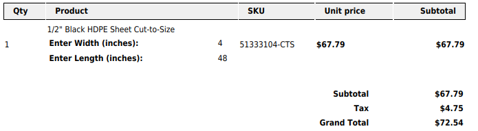

Bar Nuthin 3,157 #25190 Posted December 31, 2025 (edited) 3 hours ago, sqrlgtr said: Who is wearing the snow plow and what size is it, 48 or ? and has it got a plastic cutting edge? Inquiring minds want to know. The C-120 was my original choice for the 48" plow, but axle and hub failure mid-plowing got the plow moved over to the C-141. My original plan was to have the snow thrower on it for standby. But I didn't feel like swapping them out, so I just moved the front weights over. Maybe if it warms up, I'll make the switch. Or if I pick up hydraulic lines for the 16-Auto, I might move it there. Yes, that's 6" strip of HDPE plastic. Edited December 31, 2025 by Bar Nuthin typo 1 7 Share this post Link to post Share on other sites
sqrlgtr 3,860 #25191 Posted December 31, 2025 31 minutes ago, Bar Nuthin said: Yes, that's 6" strip of HDPE plastic. @Bar NuthinI have been thinking about doing that to my plow, just in case i need to plow a concrete driveway. Where would be good source for sumin like that? 1 Share this post Link to post Share on other sites
sqrlgtr 3,860 #25192 Posted December 31, 2025 2 hours ago, 953 nut said: @sqrlgtr, please kill that bug on your posts, I have finger smudges all over my screen trying to kill it. @953 nut my teenage niece put that on there and I just about wore my screen out trying to kill it also until I figured out it wasn't alive. 7 Share this post Link to post Share on other sites
Bar Nuthin 3,157 #25193 Posted December 31, 2025 (edited) 2 hours ago, sqrlgtr said: Where would be good source for sumin like that? I'll have to dig into my memory bank and see if I can remember where I got it. Cut-to-Size Plastic | Polycarbonate, Plexiglass, HDPE | ShapesPlastics I stand corrected on the size. FREE shipping. Edited December 31, 2025 by Bar Nuthin 4 1 Share this post Link to post Share on other sites

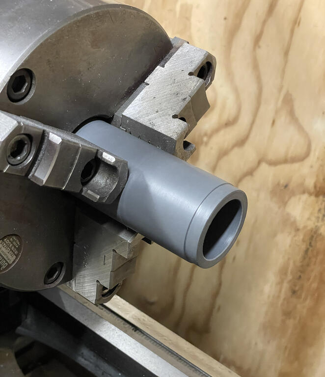

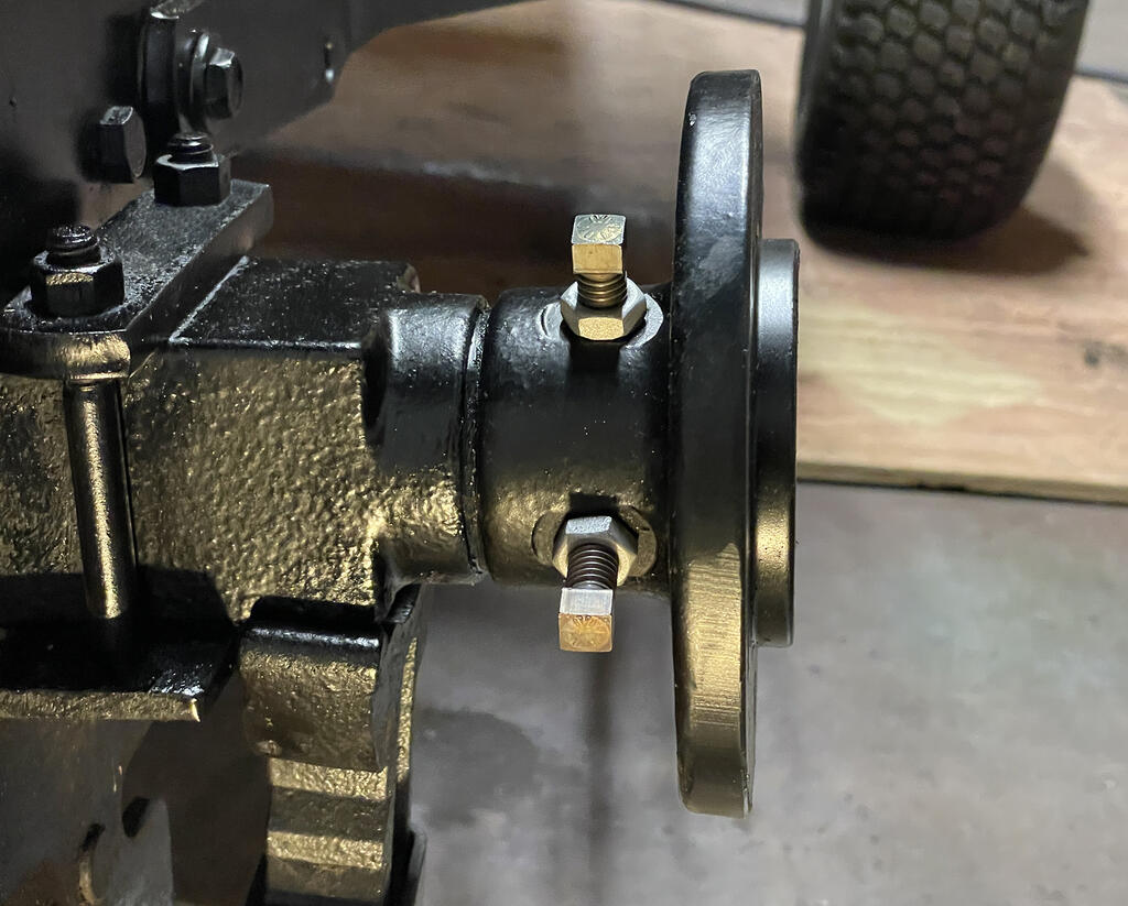

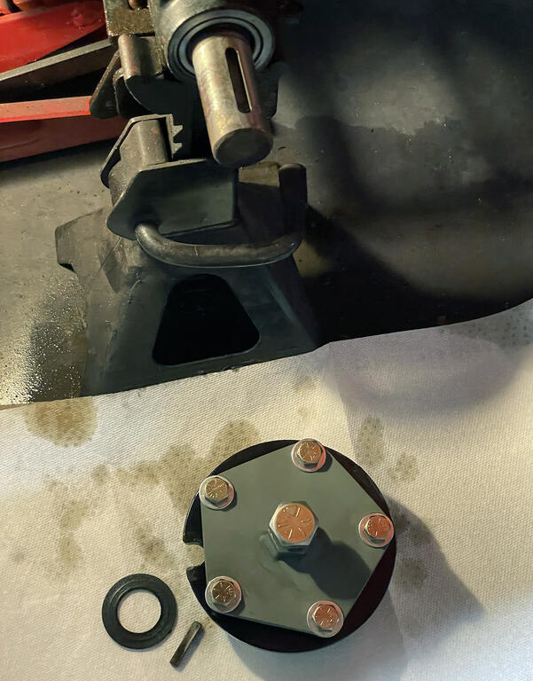

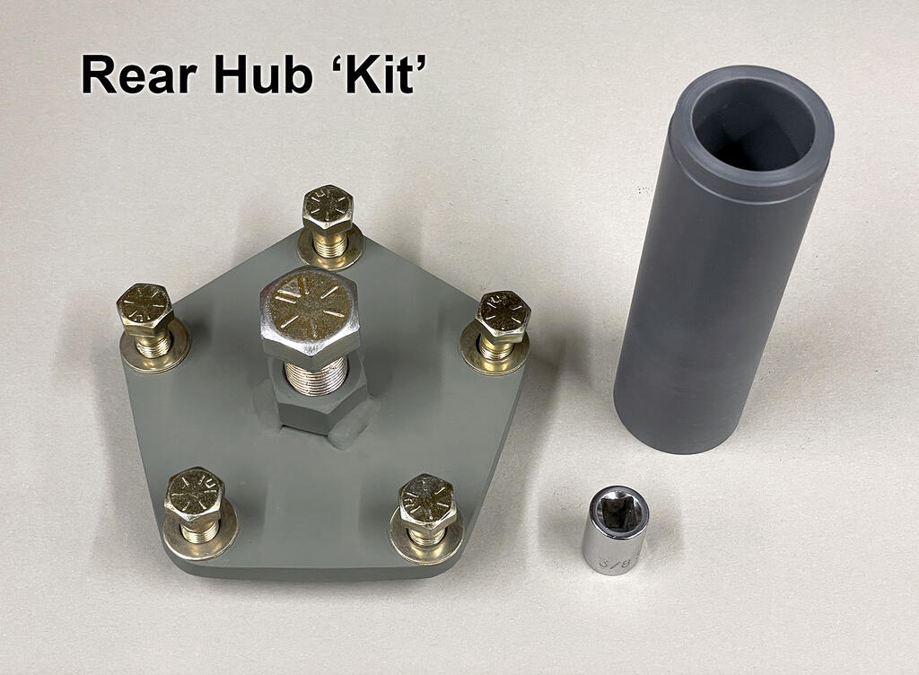

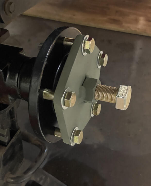

Blue Chips 854 #25194 Posted December 31, 2025 (edited) The right-rear axle seal in my 522xi failed rather suddenly, as evidenced by the oil slick that appeared overnight on the garage floor. I jacked up the rear end and checked for play in the bearing, as well as end play in the axle. All was snug and smooth, so I figured that the rubber portion of the seal probably split or became detached from its metal ring. So, off with the hub. I loosened the set-screw jam nuts, heated the set screws just enough to soften up the factory-applied thread-locking compound, and removed them, using a 3/8” square (4-point) socket. I was going to use a three-jaw puller to remove the hub, as shown in the service manual. However, the hub appears to be cast iron, and I saw that some forum members had broken a hub flange with a puller. I could have used a bearing separator to pull the hub by flipping the jaws front-to-back and placing it directly right behind the flange, contacting the hub reasonably close to the center, but I opted for a more ‘elegant’ solution: I made a custom hub-puller that I could use again for future repairs if/when needed. It didn't take long to make. I traced the wheel hole pattern onto a scrap piece of 3/8" steel plate, drilled five 15/32” holes (for 7/16” bolts), drilled a 25/32” hole in the center, and welded a 3/4” grade 8 nut to the plate. I would have made the plate round, but I didn't have a wide enough piece of 3/8" plate, so it's in the shape of a pentagon. I figured that pulling from five points instead of three, and with those points closer to the center of the hub than its edge, there wasn’t much chance of breaking the casting. Also, before applying any pulling force, I snugged up all five of the 7/16” bolts finger-tight to make sure it would pull evenly from all five points. It worked “slick as snot on a glass doorknob,” as an old employer of mine used to say. As I suspected, the rubber portion of the seal had partially separated from its steel outer ring. I pried the seal out, being careful not to scratch the axle or transmission mating surfaces. I also checked for burrs on the axle, to avoid scratching the new seal when installing it. I made a simple seal installation tool by turning down a piece of schedule 80 PVC pipe in my lathe, which worked fine for installing the new seal. I’ll improve that tool later by inserting a thin sleeve inside it for a closer fit over the axle. Here's my hub service 'kit,' consisting of the puller, the 3/8" square socket, and the plastic seal installer, which I'll keep together in a bin for later use. I re-installed the original plastic thrust washer, which had a few thousandths of wear, but was still in good condition. I also installed a new key, even though the old one looked fine, and I cleaned and dried the set screw threads in the hub, so that the Loctite would work properly. The hub was still a snug fit on the axle, and I tapped it into place with a dead-blow plastic hammer to the point where there was only about .002 or .003 inch of end play in the axle (in other words, I tapped the hub far enough on to the axle to make up for the slight wear in the plastic thrust washer). I then installed new grade 8 square-head set screws with Loctite 271, torqued them per the service manual specs (28-32 ft. lbs.) and tightened the jam nuts. Done, no leaks, and I have a tool that will make any future hub work easier. Edited December 31, 2025 by Blue Chips 2 16 Share this post Link to post Share on other sites
Red Stallion 231 #25195 Posted December 31, 2025 18 hours ago, lynnmor said: OUCH! Remove the valve and seat then take some more photos. Maybe we can offer better advice. Often a good automotive machine shop can repair seats. This site did offer oversize seats. Thanks, but looks like its all sold out! I'll keep am eye.on them in case the lack of stock is temporary. But frieghy to Australia is gping to kill me again! Share this post Link to post Share on other sites
WHX?? 58,052 #25196 Posted December 31, 2025 2 hours ago, Blue Chips said: 3/8” square (4-point) socket. I need to get me one of them. 3/8 combo wrenches are just too small and can't gettem goodentite. Be sure to recheck them for tight ness after a couple of laps. 2 hours ago, Blue Chips said: members had broken a hub flange with a puller. That style you needn't worry about it's the older "star" style hubs that are a bit fragiley. Looks like you got a nice puller should the need arise. 2 Share this post Link to post Share on other sites
ranger 1,862 #25197 Posted December 31, 2025 3 hours ago, Blue Chips said: The right-rear axle seal in my 522xi failed rather suddenly, as evidenced by the oil slick that appeared overnight on the garage floor. I jacked up the rear end and checked for play in the bearing, as well as end play in the axle. All was snug and smooth, so I figured that the rubber portion of the seal probably split or became detached from its metal ring. So, off with the hub. I loosened the set-screw jam nuts, heated the set screws just enough to soften up the factory-applied thread-locking compound, and removed them, using a 3/8” square (4-point) socket. I was going to use a three-jaw puller to remove the hub, as shown in the service manual. However, the hub appears to be cast iron, and I saw that some forum members had broken a hub flange with a puller. I could have used a bearing separator to pull the hub by flipping the jaws front-to-back and placing it directly right behind the flange, contacting the hub reasonably close to the center, but I opted for a more ‘elegant’ solution: I made a custom hub-puller that I could use again for future repairs if/when needed. It didn't take long to make. I traced the wheel hole pattern onto a scrap piece of 3/8" steel plate, drilled five 15/32” holes (for 7/16” bolts), drilled a 25/32” hole in the center, and welded a 3/4” grade 8 nut to the plate. I would have made the plate round, but I didn't have a wide enough piece of 3/8" plate, so it's in the shape of a pentagon. I figured that pulling from five points instead of three, and with those points closer to the center of the hub than its edge, there wasn’t much chance of breaking the casting. Also, before applying any pulling force, I snugged up all five of the 7/16” bolts finger-tight to make sure it would pull evenly from all five points. It worked “slick as snot on a glass doorknob,” as an old employer of mine used to say. As I suspected, the rubber portion of the seal had partially separated from its steel outer ring. I pried the seal out, being careful not to scratch the axle or transmission mating surfaces. I also checked for burrs on the axle, to avoid scratching the new seal when installing it. I made a simple seal installation tool by turning down a piece of schedule 80 PVC pipe in my lathe, which worked fine for installing the new seal. I’ll improve that tool later by inserting a thin sleeve inside it for a closer fit over the axle. Here's my hub service 'kit,' consisting of the puller, the 3/8" square socket, and the plastic seal installer, which I'll keep together in a bin for later use. I re-installed the original plastic thrust washer, which had a few thousandths of wear, but was still in good condition. I also installed a new key, even though the old one looked fine, and I cleaned and dried the set screw threads in the hub, so that the Loctite would work properly. The hub was still a snug fit on the axle, and I tapped it into place with a dead-blow plastic hammer to the point where there was only about .002 or .003 inch of end play in the axle (in other words, I tapped the hub far enough on to the axle to make up for the slight wear in the plastic thrust washer). I then installed new grade 8 square-head set screws with Loctite 271, torqued them per the service manual specs (28-32 ft. lbs.) and tightened the jam nuts. Done, no leaks, and I have a tool that will make any future hub work easier. Very nice👍 I have not had to remove a stuck hub yet, but I have often thought of something along these lines. One thing I think I would probably do would be to bore the centre of the puller to suit the diameter of the hub spigot, and then weld something across to carry the forcing screw. Or insert a suitable wheel spacer between the hub and the puller. The idea being to provide a continuous support around the whole hub face? 3 Share this post Link to post Share on other sites

Blue Chips 854 #25199 Posted December 31, 2025 (edited) 1 hour ago, ranger said: Very nice👍 I have not had to remove a stuck hub yet, but I have often thought of something along these lines. One thing I think I would probably do would be to bore the centre of the puller to suit the diameter of the hub spigot, and then weld something across to carry the forcing screw. Or insert a suitable wheel spacer between the hub and the puller. The idea being to provide a continuous support around the whole hub face? I think the pulling force is fairly well equalized if all five of the 7/16" bolts are snugged up finger tight before pulling, but I have an idea for an improvement to the puller that incorporates a structure similar to what you suggested, which would place the surface of the puller flat against the face of the hub, and which would work for hubs that have been converted to studs as well as for hubs that still are set up for tapered bolts. It would involve a thick ring with five holes for 7/16" bolts (or studs), a large circular cutout in the center, a short section of pipe...maybe an inch long...with a diameter to match the cutout and welded on, a circular plate welded to the pipe, a hole drilled in the plate, a 3/4" nut welded to the plate, and a long 3/4" bolt. The shape of the puller would sort of resemble a top hat. If I can find some time I may give it a shot. Edited December 31, 2025 by Blue Chips Share this post Link to post Share on other sites
ranger 1,862 #25200 Posted December 31, 2025 41 minutes ago, Blue Chips said: I think the pulling force is fairly well equalized if all five of the 7/16" bolts are snugged up finger tight before pulling, but I have an idea for an improvement to the puller that incorporates a structure similar to what you suggested, which would place the surface of the puller flat against the face of the hub, and which would work for hubs that have been converted to studs as well as for hubs that still are set up for tapered bolts. It would involve a thick ring with five holes for 7/16" bolts (or studs), a large circular cutout in the center, a short section of pipe...maybe an inch long...with a diameter to match the cutout and welded on, a circular plate welded to the pipe, a hole drilled in the plate, a 3/4" nut welded to the plate, and a long 3/4" bolt. The shape of the puller would sort of resemble a top hat. If I can find some time I may give it a shot. Yes, that’s what I was getting at, having solid contact across the hub flange and puller faces, so when all wheel bolts? are tight, there is no gap between the hub and puller. The hub flange then becomes effectively much more rigid. A spacer to match his puller, but bored to clear the hub spigot would work, as he already has the puller made, but as you say, if you were building one from scratch, then your suggestion, in my opinion, would be the way to go. 2 Share this post Link to post Share on other sites
